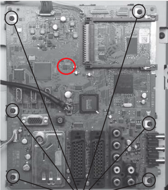

            there has to be another flash of some sort besides this 24c02, to load the firmware. Because this IC is very small in memory. We are taking 2kbits here.
                Yes, there is: I mentioned it in my previous post. It's the one within the CI slot - at least that's what it looks like in the picture. It's the one I said would be impossible to recover (unless ripped from another TV at which point I'd just swap the boards since they HAVE to be identical for this to work anyway and sometimes even that's not enough with Sonys - the firmware has to match to get a picture)

                  impossible to recover? Why? Folks swapping them no problem. Take is off, read it, erase it, blank check, see if that chip is faulty, program chip with, put it back in it's place. You can find dumps on the internet, maybe ask...
                  I've taken these out before, read it, reprogrammed it and put it back in. It isn't bad.

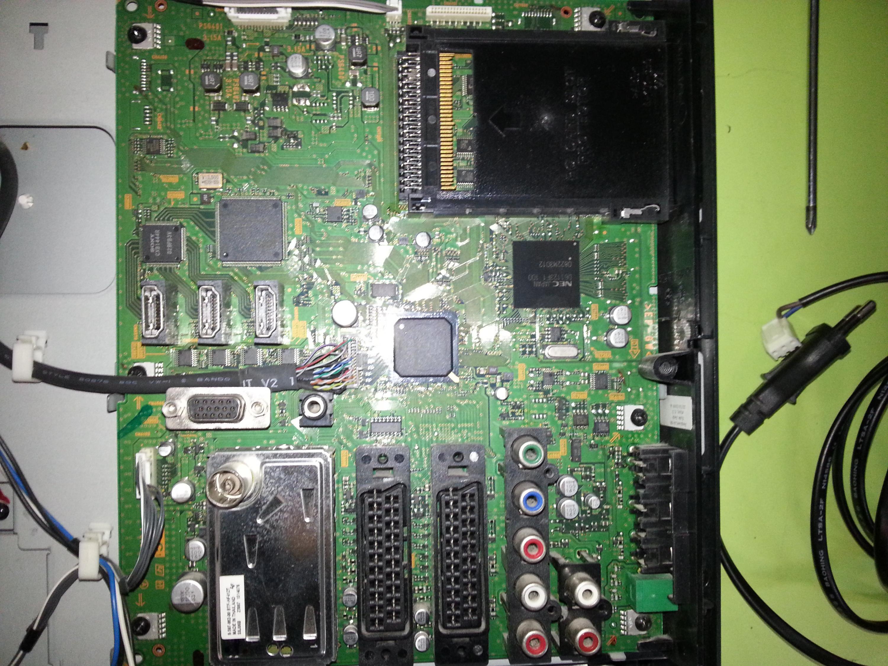

                          Re: Sony Memory Stick formatter tool (for KDL-26U4000)
                          Just out of curiosity - here's the main board....blurry AF I know Is this a tuner issue or a decoder issue ? The Digital decoder seems to be a separate chip on the board according to the manual. If that's toast, no amount of firmware will help.
                          EDIT: just got hold of a memory stick and tried the upgrade procedure: the TV just stays there with a blank screen and no LEDs...still waiting for it to do something. Sure hope it's not bricked at this point...that would be a fuckin' disaster...

                          • CapLeaker
                            Leaking Member
                            • Dec 2014
                            • 8351
                            does the analog tuner work to start with?
                            • Dannyx
                              CertifiedAxhole
                              • Aug 2016
                              • 3912
                              • Romania
                              Yes it does and thankfully it also didn't brick - unplugged it and plugged it back in and it sort-of reset, displaying the "first time setup" screen. Still no digital reception though and I'm sometimes having a hard time getting it to tune analog also - the menu disappears when I hit OK and doesn't take my "start scan" command...something's f-ed up there....
                              Worth noting: before punching "08" in the TT service menu which is the command for reset, I punched 88 instead which the manual identifies as "Digital shipping conditions (Clear tune database)". Interestingly, I came across another forum thread somewhere where a chap messed with this 88 command and subsequently he had no digital reception either, though when I got the TV it didn't pick up anything to begin with, so it was probably not my fault - bad memory blocks is what I'm thinking. There's a bunch of different settings there, but I don't dare going back in there again because I just managed to get it to pick up some analog channels and want to return it as such. At least the stripe is gone so it wasn't all in vain, though if anyone still has any ideas I'd be willing to hear them out.
                              Also worth noting: the card I used wasn't mine - I borrowed it from a co-worker who told me not to format it or delete any of the hidden files from it because it was formatted inside a Sony camera for precisely the purpose of flashing TVs (which apparently is the same as using the tool which TVs "like"), so I used it "as such". It was blank indeed, except for two hidden files...don't know if it had an effect though or if it would've done the same if I had formatted with the tool you guys suggested.
                              Wattevah...
