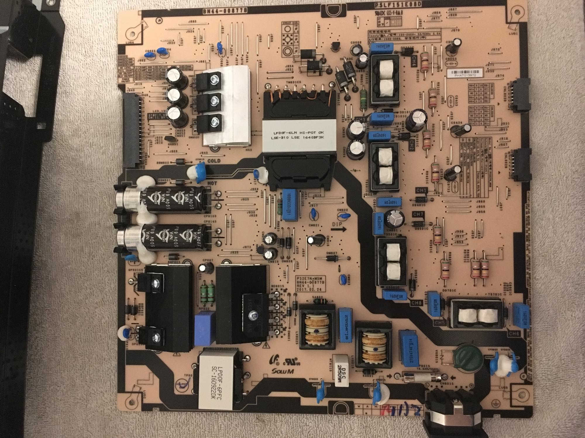

    So - The symptoms for both are that when plugged in there is no power, nothing, Nada - no standby LED and no response to any buttons.

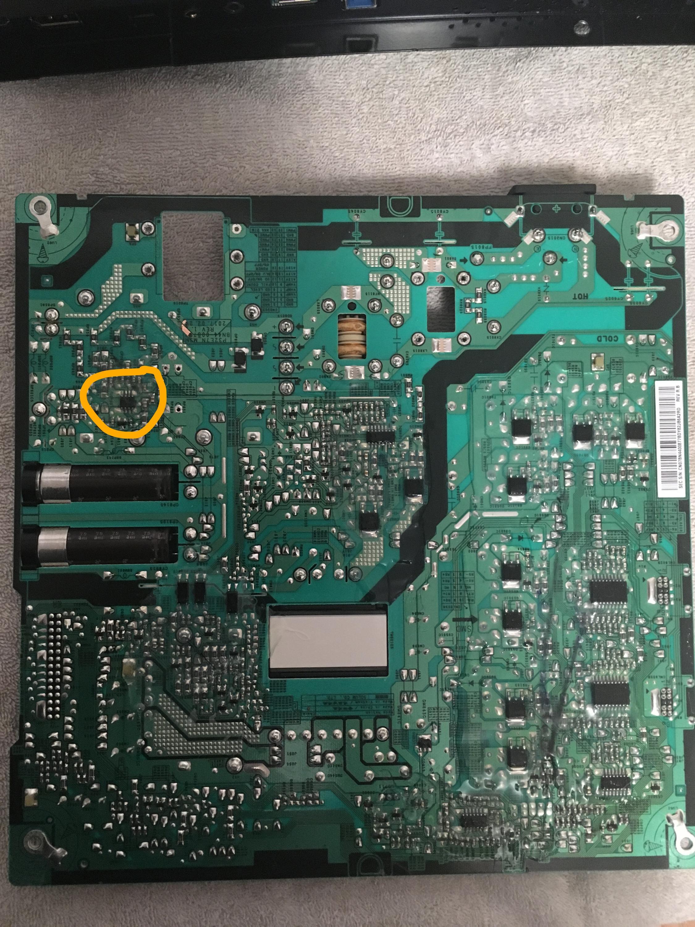

    I looked at the power board (BN44-00877B) and the 5A fuse is blown - so I bridged this with some copper wire (with the backlight LED’s disconnected) to see if could get the standby LED to come on.
    This turned out to be a bad idea - as soon as the set was plugged in, the two small, white transformers (?) on the hot side of the board started smoking.

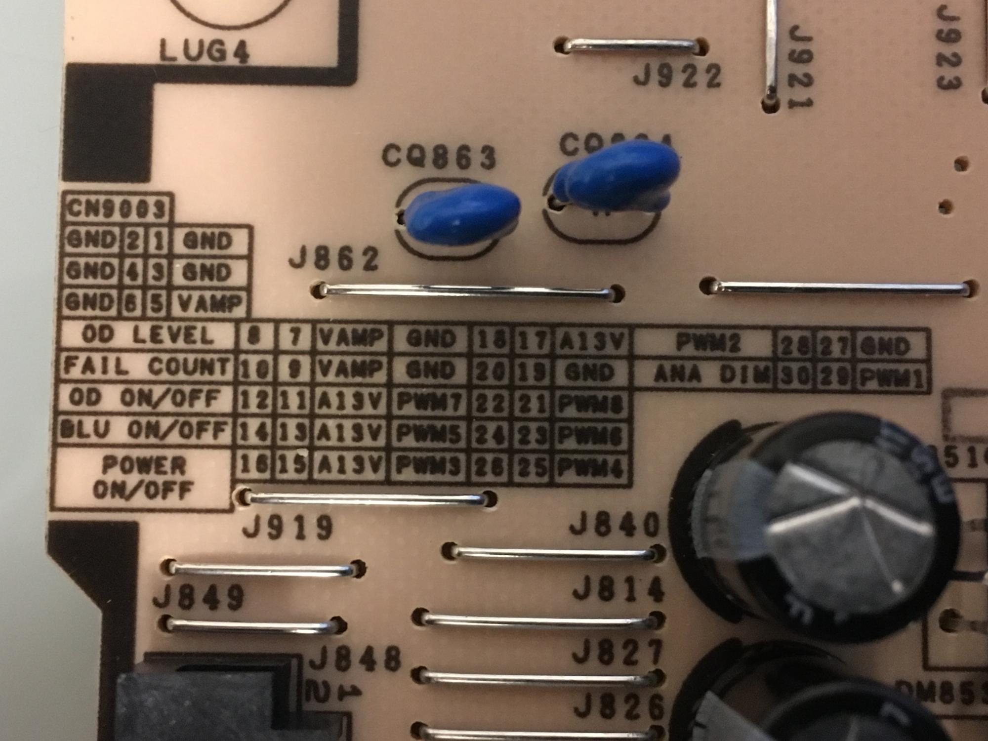

    Note: Picture of underside of the board is with the larger white transformer (LPD05-6PFC) and the small transformer (SQH2210S KS-1736CAK) removed. You will also note there is some exposed trace in the upper left section of the board – Im not sure if I caused this with my fuse-stupidity or if it was like this when I got it?
    There are some markings on these components: SQH2210S KS-1736CAK which I have tried to find on the internet to no avail. Does anyone know what these actually are and if there is any way to test / replace them with something equivalent?

        Quick update - I have been probing around and have identified that the mosfet on the left of the board (a Magnachip 60R190QS) has gone bad.
        At the same time i also removed the bridge rectifier and the rectifier diode and both of these test good.

          Those are input filtering inductors,not transformers,they seem to have melted the insulation partially,bad for the board but should not cause more issues,and these SA are also inductors.
          If they melted,your problem is much more probably on the primary(hot) side of the board.

            I took out one of the SA designated little black inductors and it looks like it is Open circuit. i'll check the other one today.

              Oh,they could also be MEGAOHMs resistors,check if the color code makes sense with any resistance you measure from them,if they were inductors and are now open it was surely because of the improper copper bridge.
              They filter input noise from AC lines such as harmonics,not mandatory for the board to fuction,you can still repair it.
                Re: Samsung C32HG70 Curved Gaming Monitor - No Power
                SA = Surge Arrester, it should show open circuit.
                No need to mess with those part, the circuit does not need those SA to function.
                So the power MOSFET for the PFC shorted out, you will need to replace the MOSFET and the PFC IC at the same time, and may be the Common mode Line filter choke too.

                  I have highlighted what i assume is the PFC IC?
                    That is the PFC Controller IC.

                          So i have tried to identify the PFC IC but the only numbers i can make out are:
                          1762 1A5 / 1752 1A5 which i am struggling to trace on the internet. Does anyone have any idea what this could be?

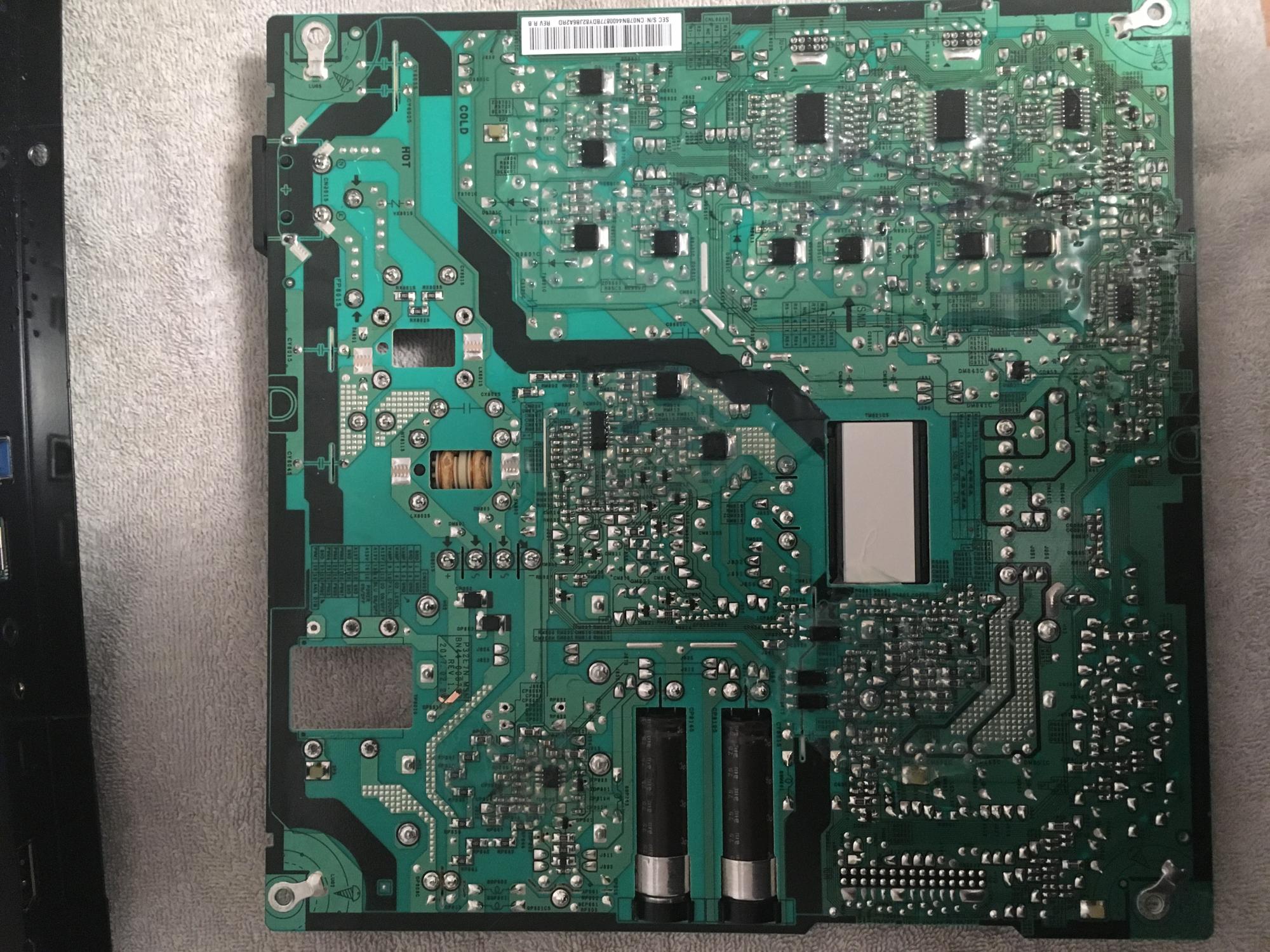

                              So the working PSU arrived which allowed me to test both monitors and confirm both have failed PSU's.
                              I have now pulled the second Monitors PSU and it does not have the same problem. The fuse on the second set is not blown and i have checked that there is approx 160V across the capacitors on the hot side of the board when plugged in.
                              Again, i have checked all of the diodes and all are working, but still i get no standby LED.
                              Interestingly, this board has a different MOSFET (24N60M2) and PFC IC, but again it looks like the numbers on the IC have been almost removed to the point where i can just make out "1793 1A5"

                                But does the power supply board have at least standby Voltage? If not, then that will be the first thing you have to fix.

                                  I tried probing the test point on the PSU yesterday that provides the standby voltage and it fluctuates between 3 and 9v. Any recommendations on the best place to take readings?

                                        So i used the test point to the top left of the top side of the board which says:
                                        "STBY: 7.5V ON: 11.5V"
                                        Measurements with only mainboard (used the same main board in both tests) connected:
                                        Good PSU: Standby: ~8.8V and 12.6V at power on
                                        Bad PSU: Fluctuated between 5v and 16v & No standby LED.
                                        Bad PSU with nothing connected , again fluctuates between 3V and 16V
