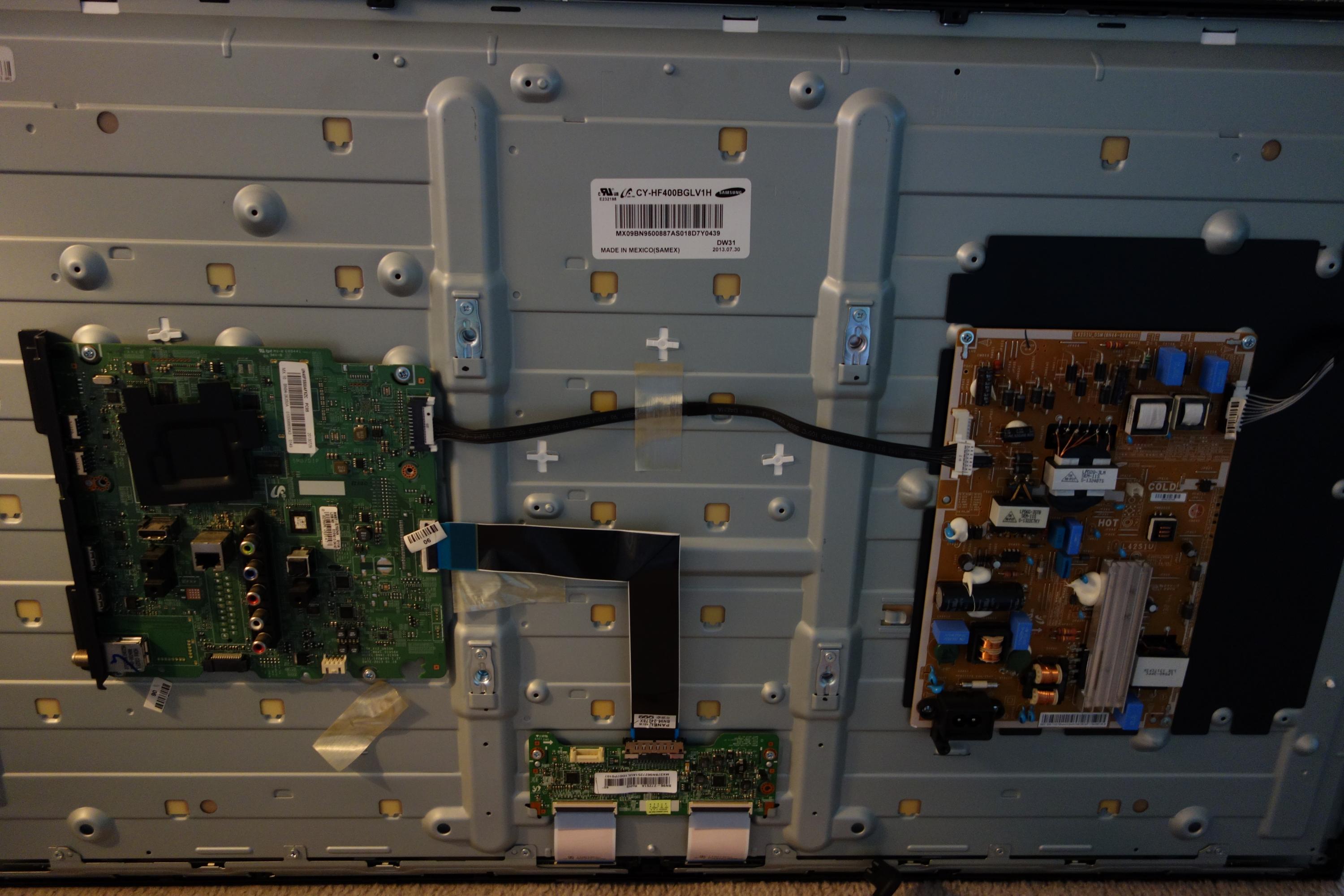

    When the power button is pushed, the front LED blinks but the TV doesn't turn on. Unplugging the main board from the power supply, the backlight flickers. Checking the strips with an LED tester, they all test good.
    PFC voltage on main caps is 392V and drifts a couple hundred of millivolts. B5V is stable at 5.2V. B13V is around 11V, not stable and drifts +/-1V. Since this supplies the LED driver IC, I believe either the PFC or 13V supply side is the main suspect.

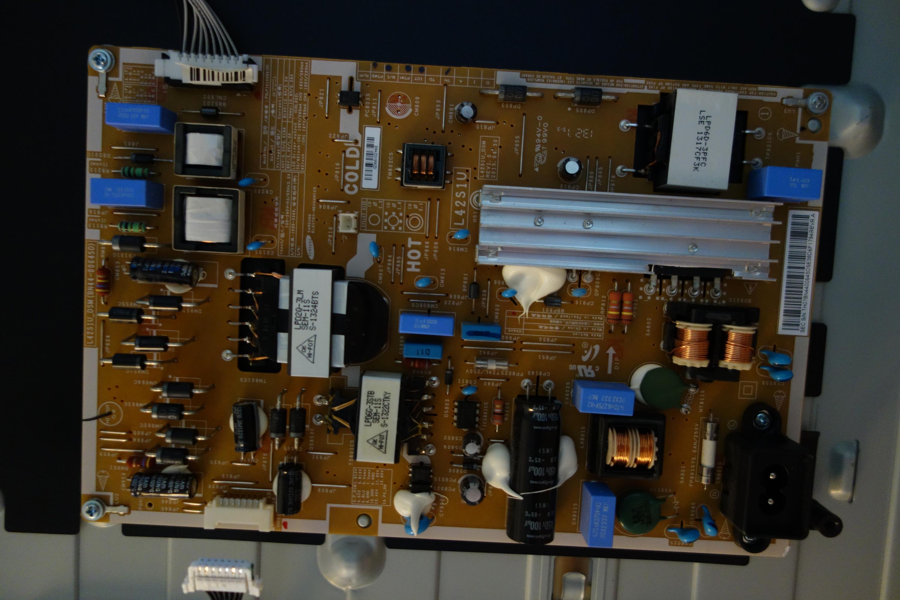

    PS is BN44-00645D. BN44-00645A schematic should be close.

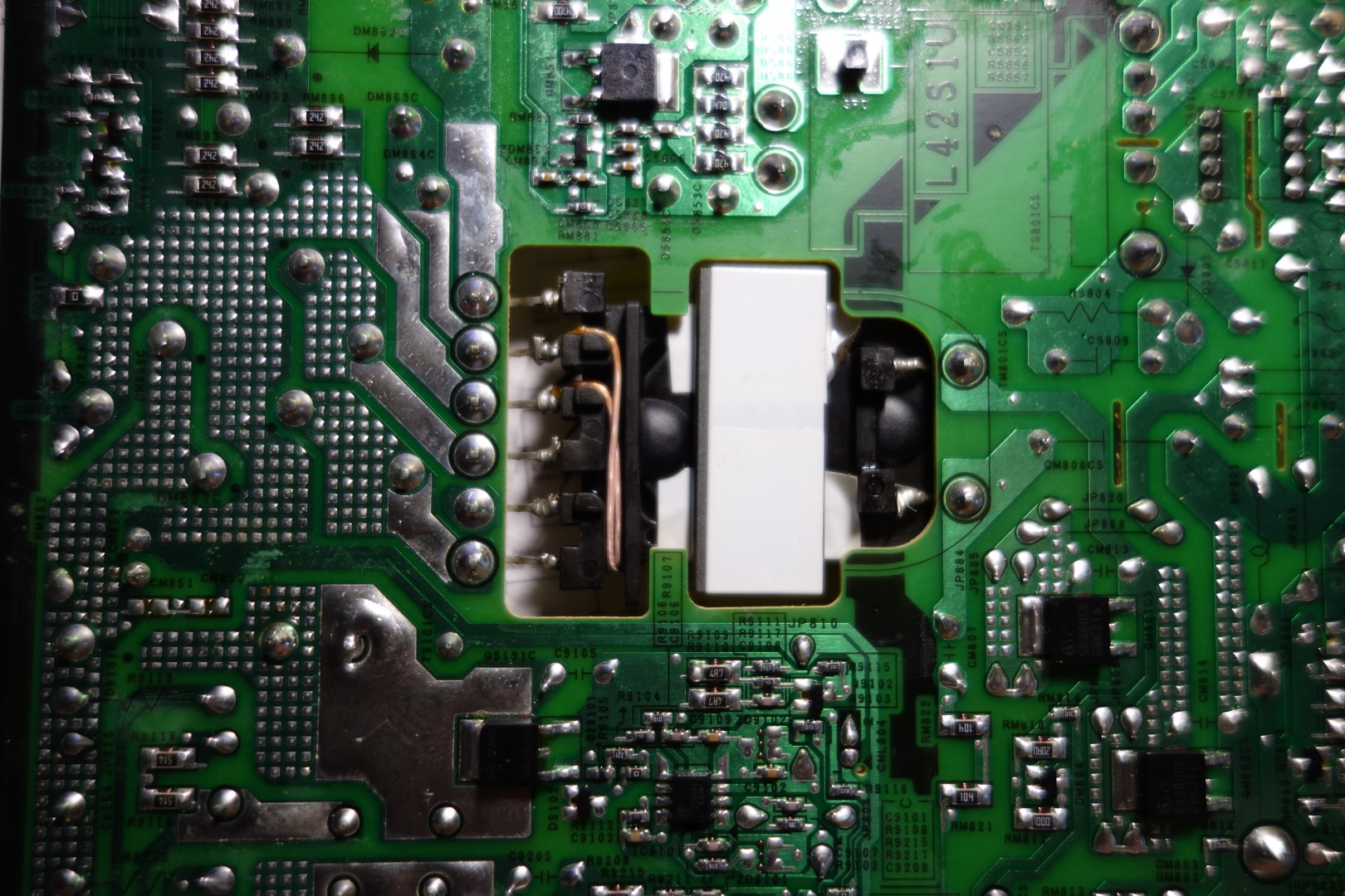

        Inspect the solder joints of that T81CS transformer (it is for 13v supply and LED power supplies) legs, especially those with riveted through hole solder joints, also inspect other solder joints as well. Those through hole rivet solder joints do fail a lot.
          Re: UN40F5500AF Doen't Turn On - Flickering
          Solder joints look good and show good connectivity with ohmmeter. Measured resistance across B13V and seems a bit low at 180 ohms.

            Found a service manual online for this model but no schematics and flow chart solution is to replace the power supply board. Flickering is likely caused when the 12V supply drops below minimum threshold for the supply on the LED driver ICs. I'll have to check the components that drive TM801CS. The output cap on the 13V line tested good as well as the diodes. There are quite a few differences from the A to D versions on that board.
              Gave up and ordered a new PS board. Both outputs of TM801CS weren't stable. Checked all the rectangular poly caps and ceramic disk caps in that section and they all tested ok. Got 3.4V on VCC of ICM801. New board should fix it.
                New power supply arrived and tv is fixed. Bought from Aliexpress seller. Probably safer to buy on ebay with money back guarantee.
