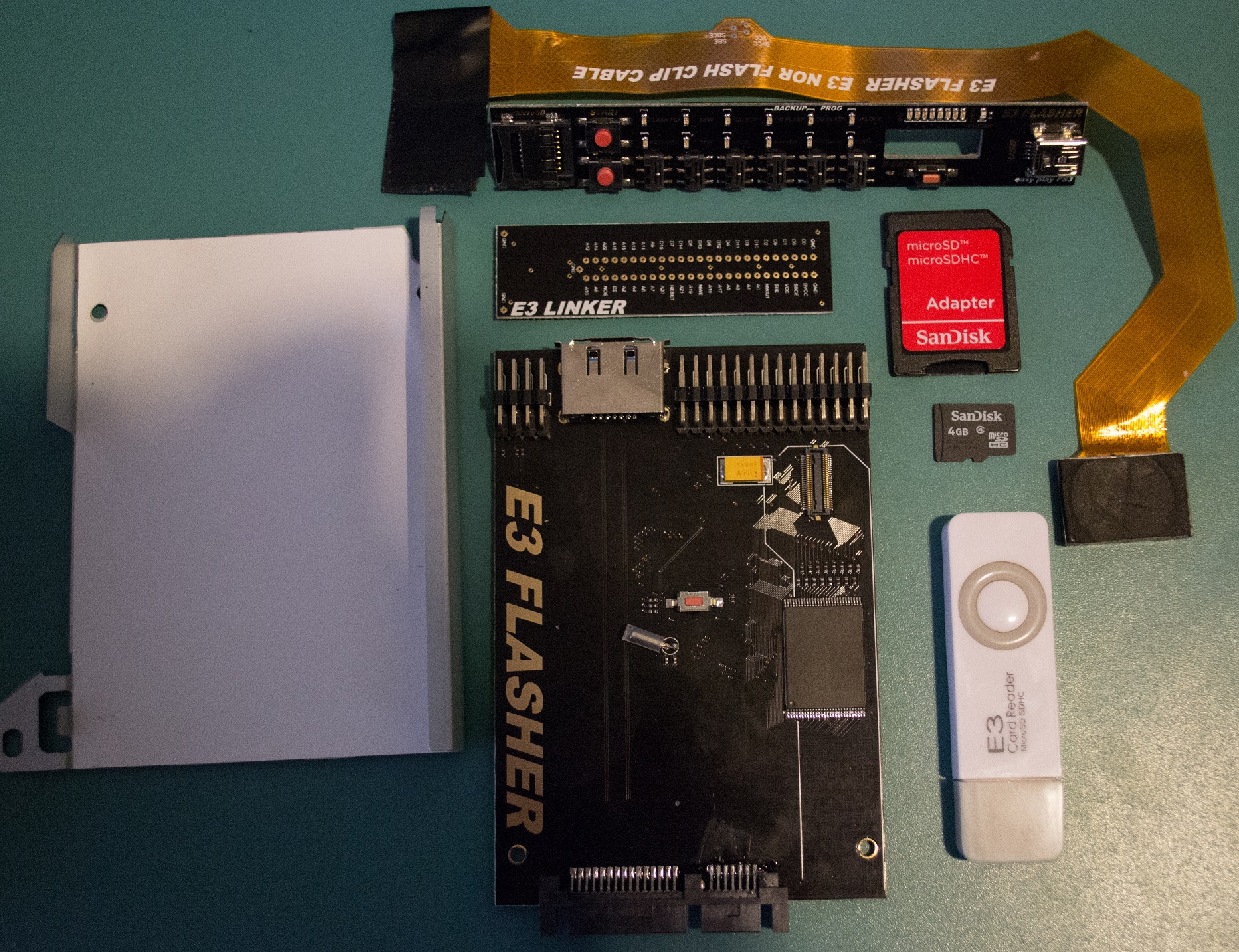

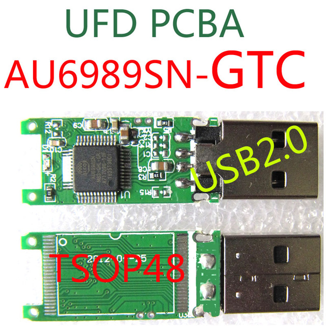

            It stays on with main isolated. I wonder if i could use a old usb flash drive to program it like in the photo below. i also have a e3 flasher for a ps3. Would be cool if i could freeze it from below while dumping it with the e3. I also wonder if a TSOP48 chip from a ps3 or flash drive would work. Its gotta be possible data is data right like zeos and ones.

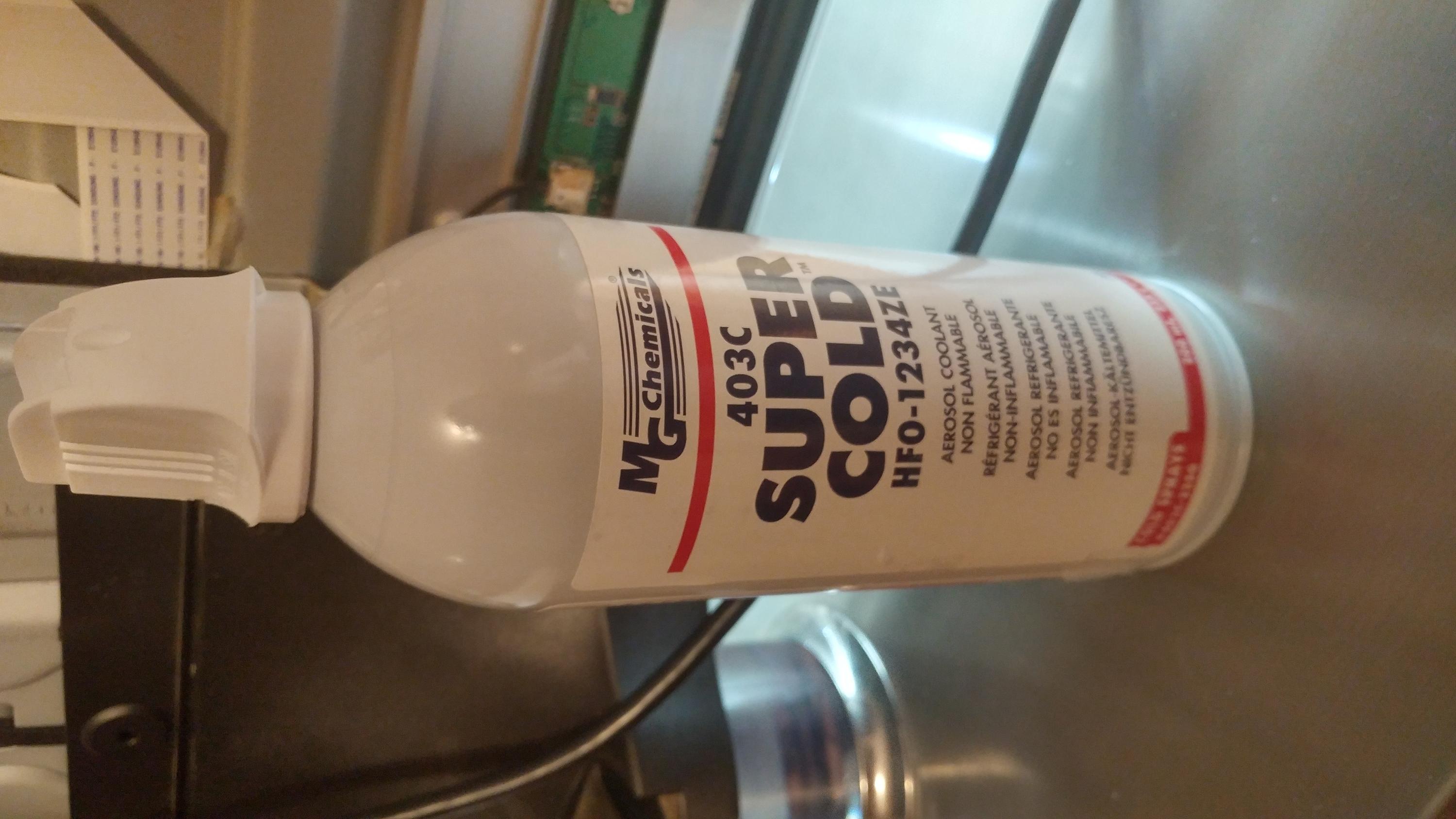

                I got my freeze spray in yesterday. I dont trust duster on this main so i bought some mg chemicals 403c super cold HFO-1234ze areosole coolant. I soaked it and it did not work the first time then i douced the whole board then ic1302 for a couple second longer.it worked for 5 mins then it went out. was hopeing it would stay on After the freeze. Now i wonder if i should freeze n dump ,buy chip, both .

                  If you have the files to reflash the chip, do that, obtaining a dump from this NAND even if it's frozen and flashing it with that doesn't seem reliable, but if done correctly I don't see how it could damage anything, at worst it's a waste of time.
                  The board started working only after freeze spraying IC1302 or at everything?

                    I douced all the chips then back to ic 1302 for a few second more to get it going. Gonna try just ic1302 but it also soaks the chip below.
