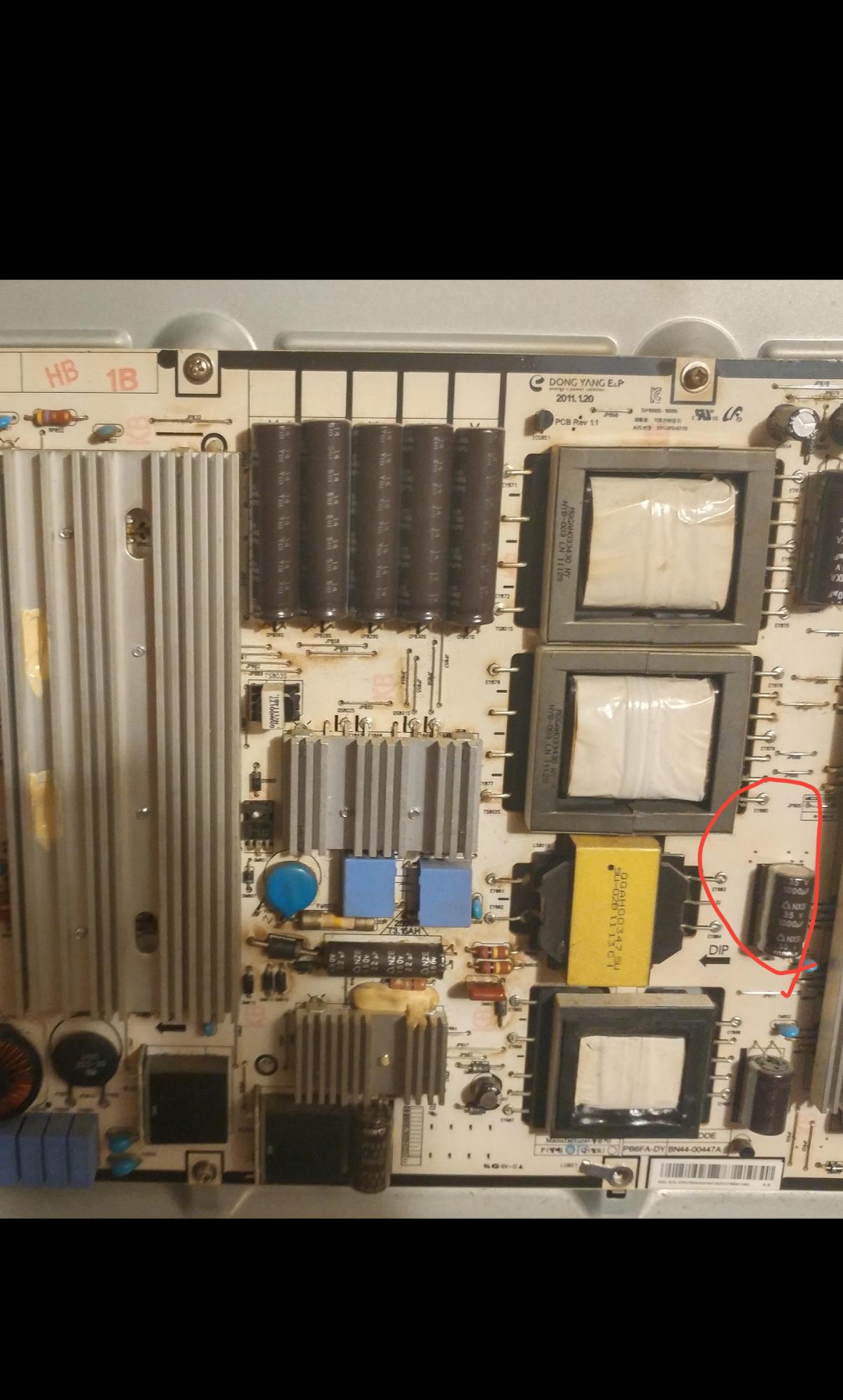

                        All solder points look good on y and xmain next is to inspect power supply but voltages are stable but did not test 15v on ymain . I disconnected x main and logic board detected. I tested capacitance to be good on the y man but dont feel like taking them off for esr. Maybe if i know the panel is good id repair them as backups. I did not see any crack in panel but i hear these 2011 d models like to leak out the edges. If i take the frame off will the pannel fall out? These panel connectors are flaky and look like solder poins could easily fail so maybe ill reflow those. Im really thinking of ordering x and y mains but dont feel like throwing money away. I think its safe to say they wont damage one or another since they are not shorted? The 5 psu. Caps read 386. The one at bottom is 50v 680uf reading 718 bottom right middle 35v 1000uf reads 870 uf ! I would upload pictures but dont remeber how .

                          Most of the caps actually teted above there uf with multimeter. I was able to test the green 275v 150 uf on ymain but now my meter wont read them so im letting my batteries charge. The 35v 1000uf is now reading ol, it's the one circled in red. I just rembered how to upload pics!

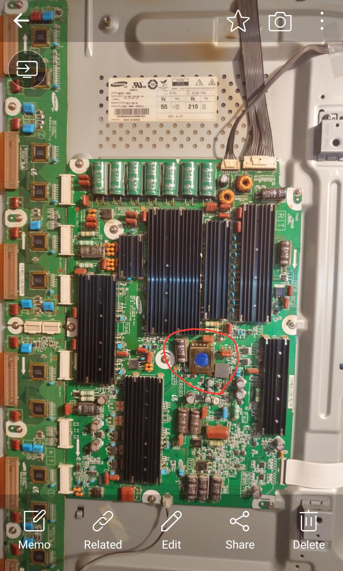

                                The loud buzzing is comeing from the transformer on ymain circled in the pic. I taped on it and i think it went away.more of a arcing noise and not buzzing

                                  Did you check the solder joints on that Xformer? I wouldn't run it if those solder joints are bad, that could burn the board up.
                                  This the exact same y-main that's in my D550. It's on the fritz too.

                                    No cigar,Got the new ymain and the transformers still makes arcing noise. I think it dosent reeboot anymore with main board isolated .with main isolated dose make the arcing while the panel primes then the sound goes away with the prime. still havent got freeze spray. It between panel , bottom buffers , logic, xmain. I feel some buffer ics getting warmer than other so im gonna try just top or bottom. Removed bottom y buffer arcing noise is more quiet. Im starting to lean towards logic board, bottom buffers then panel. The 2011 d series panels are garbage and just about to throw it out.

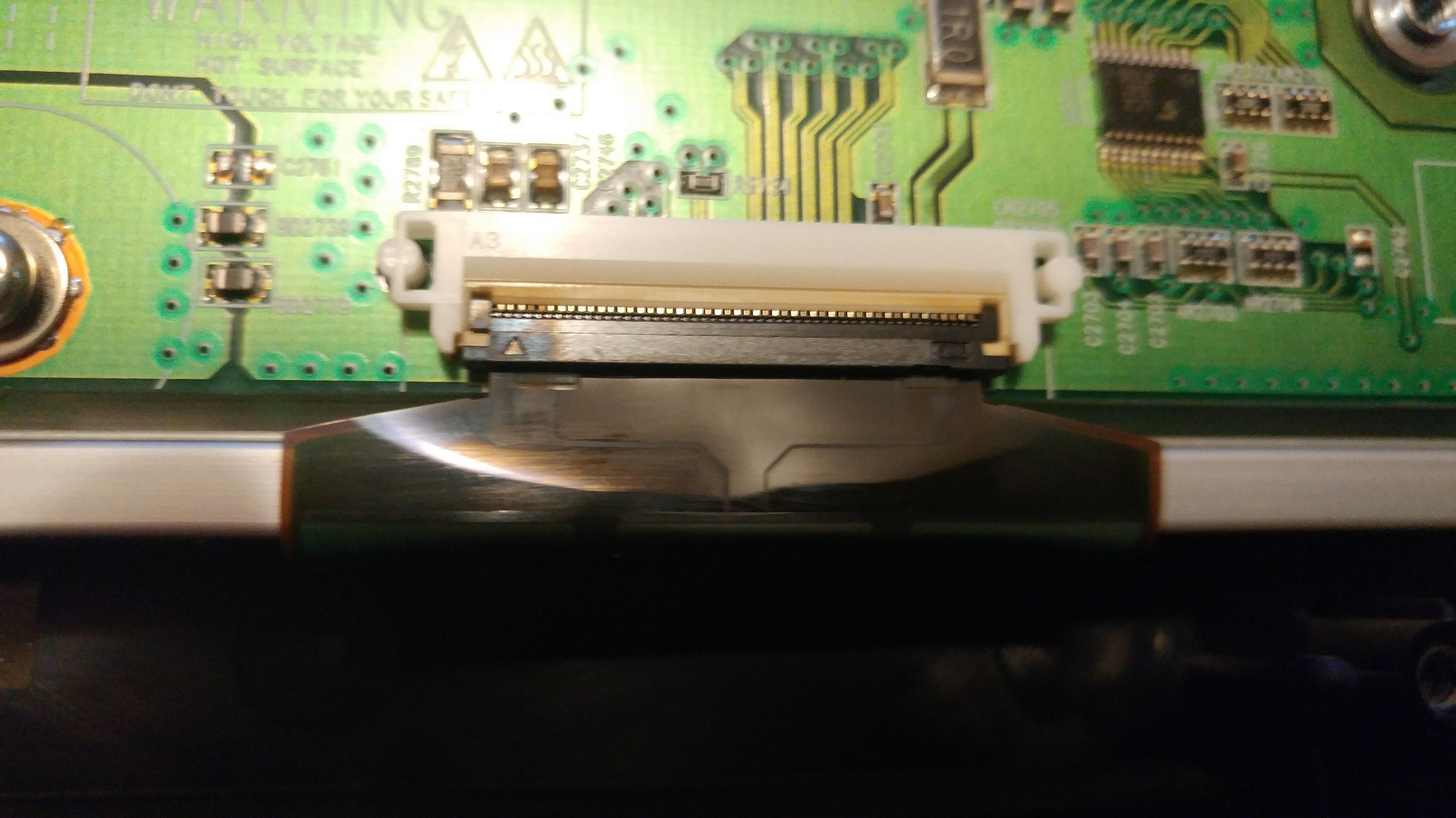

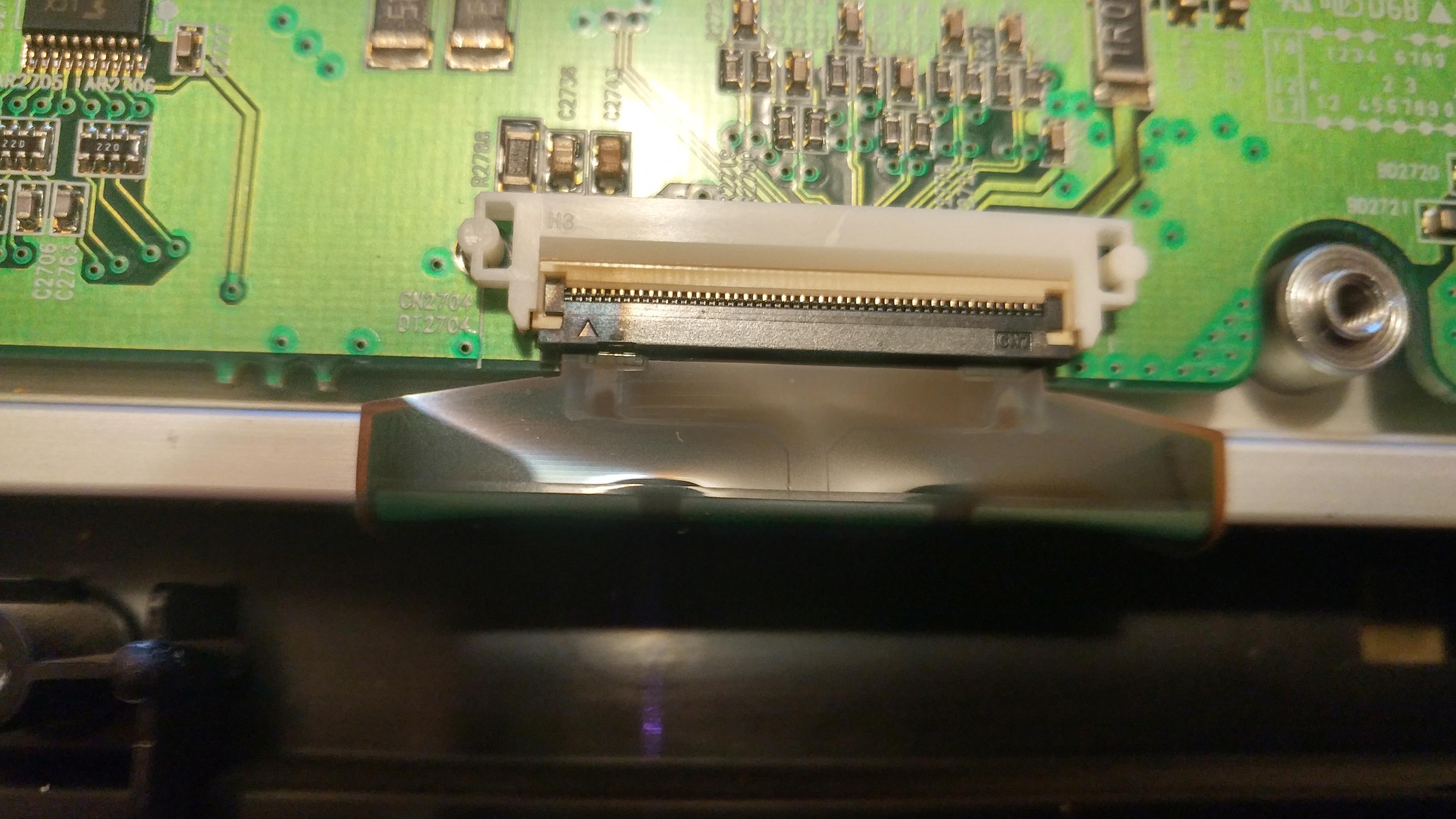

                                      Left side facing from pannel z drivers tabs and connections look clean . the right side how ever shows signs of soot,Burning, heat! Panel has no cracks or water damage

                                        Disconnected midde z.buffer and seen blue sprkly line .might be the logic board since there is no patterns. Gonna buy freeze spray tommrow and freeze all the nand chips on main and logic.
