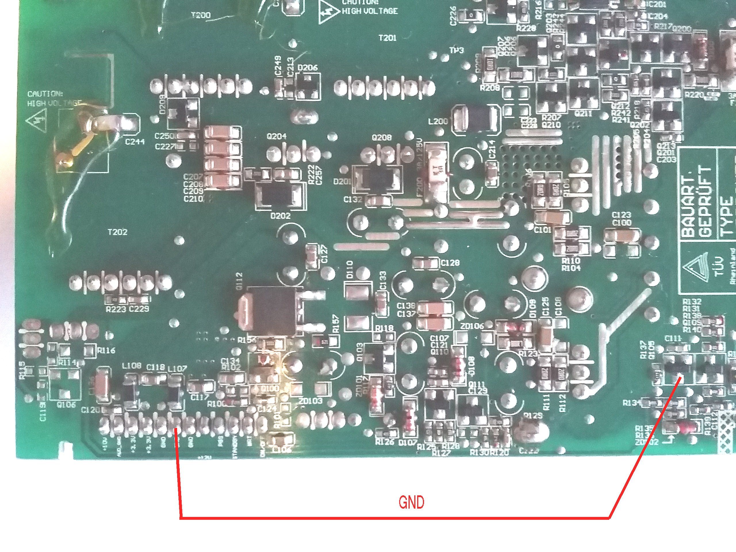

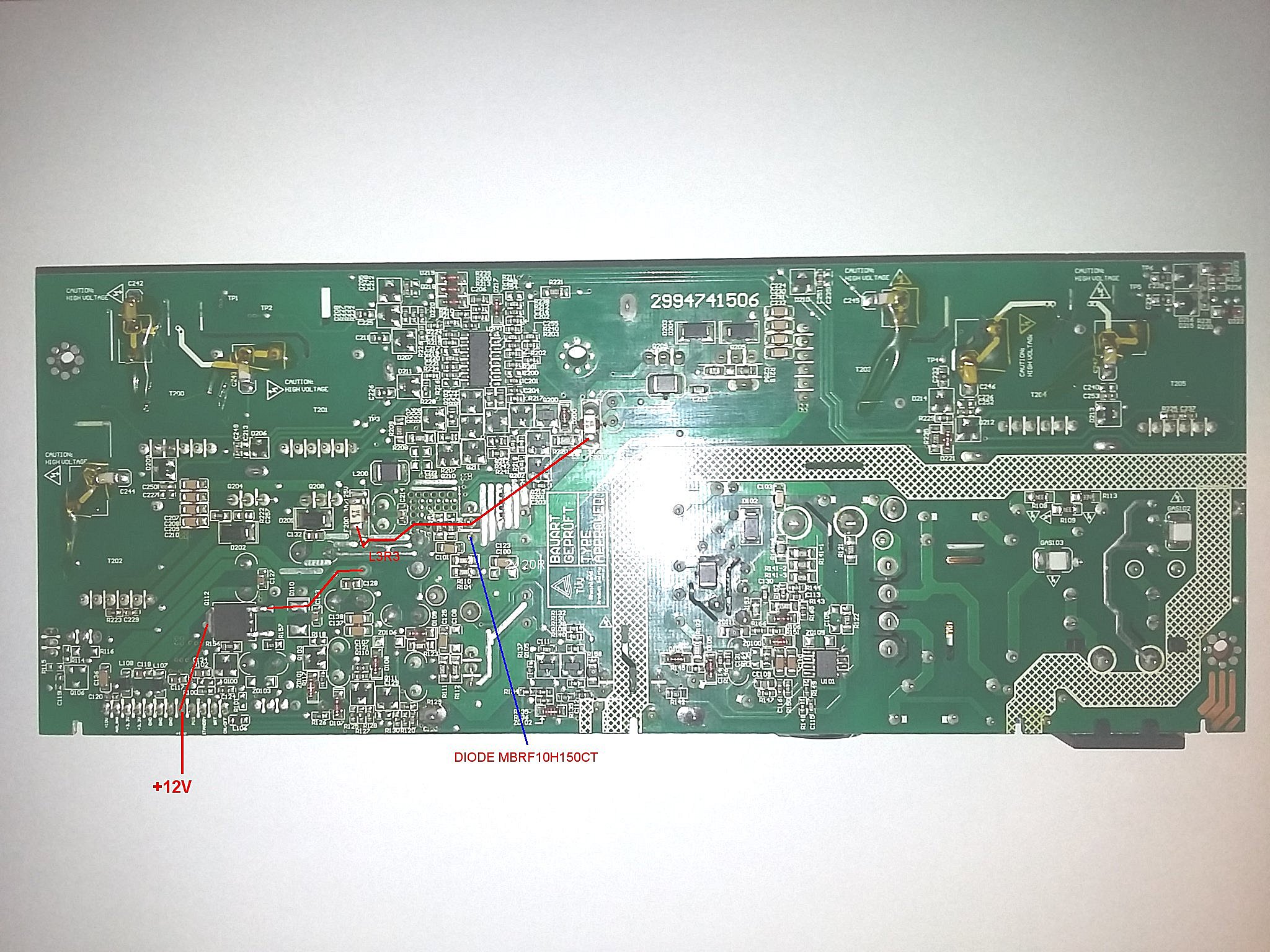

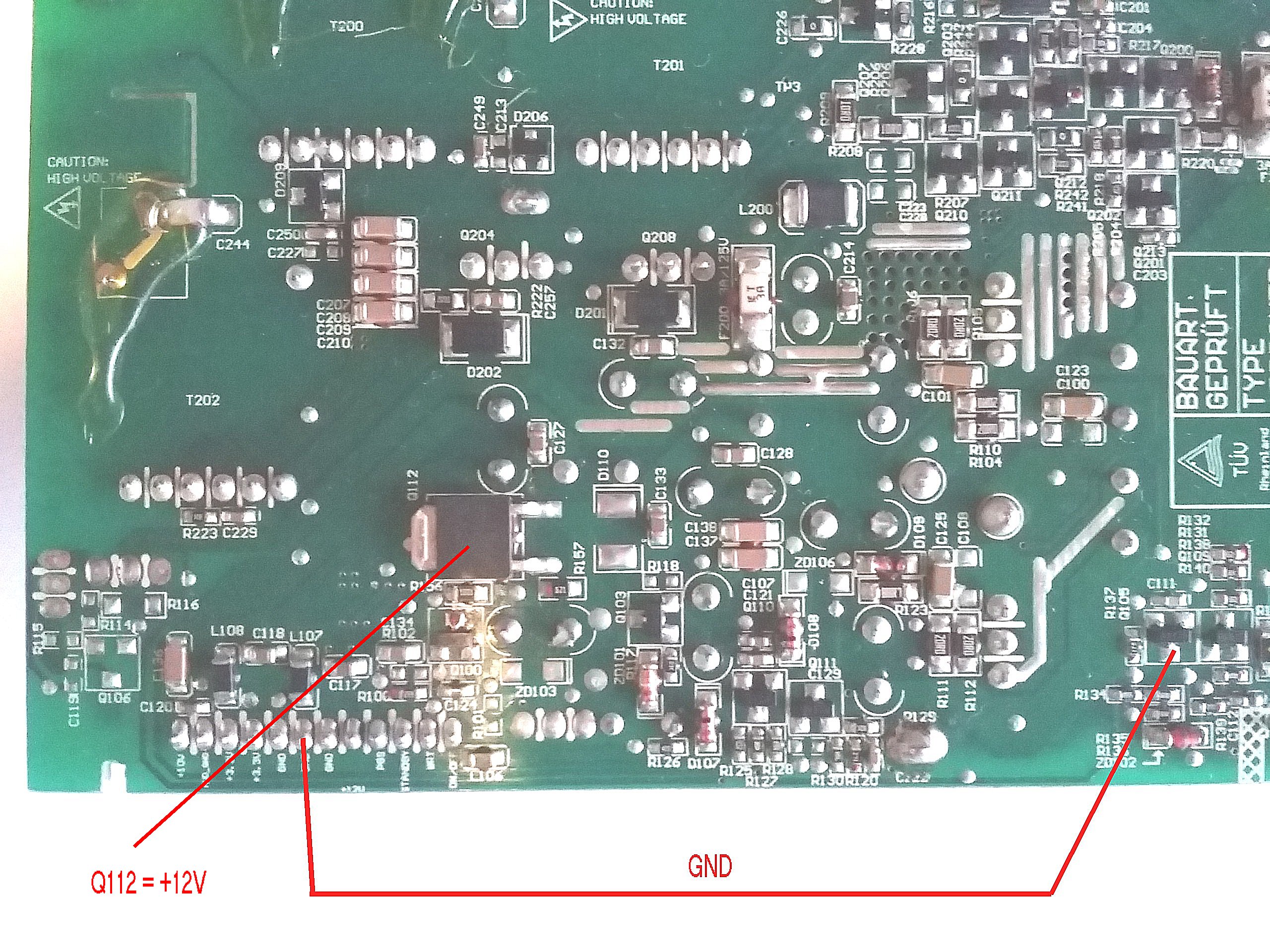

                #47
                Re: Philips 20PF4121/58 power inverter board problem
                I mark with red lines.

                  #48
                  I check all loads are high, no shorts or heavy loads.
                  +12V fuses are OK.
                  What can be wrong here?

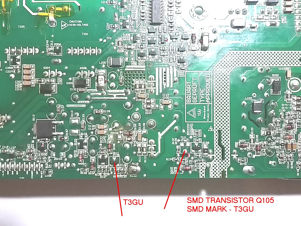

                      #50
                      R J.
                      I need your help, i think i found the problem.
                      I found faulty SMD transistor with SMD mark T3GU, position Q105.
                      Ther are 2 transistors on this board, measuring the second good transistor Q111 with analog ohm meter
                      shows PNP darlington type.
                      Now i search replacement for this transistor.

                          #52
                          Hi.
                          I finally found the fault and now big problem to decode this part.
                          I check TL431 readings with ohm meter, not even close to good T3GU.
                          The silkscreen show Q for transistor, for voltage reference should be U or something.
                          And TL431 have 431 mark.

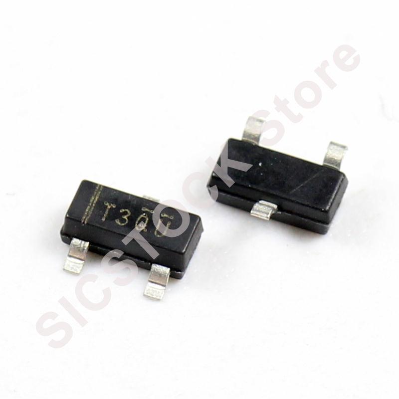

                          • R_J
                            • Jun 2012
                            • 9608
                            #53
                            This pdf shows the T3GU marking for a sot23-3 on page 36
                            The other site I linked to also mentioned that part as being a Precision Programmable Reference
                            You might need to draw out the circuit for that area to see how it is used
                            Usually that area of the secondary near the optocoupler, can have a 3 pin reference, they may have been lazy and labeled it Q
                            Does one of the leads go to ground? which one? Also was the original one shorted?
                            Do the letters look like this picture?

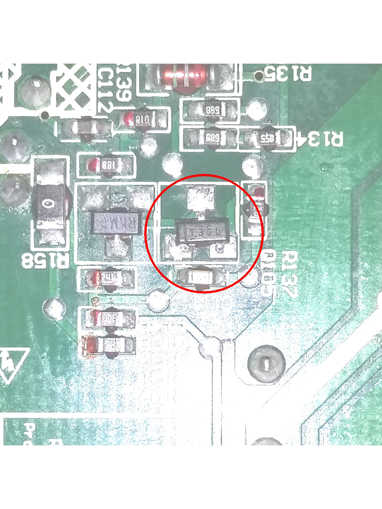

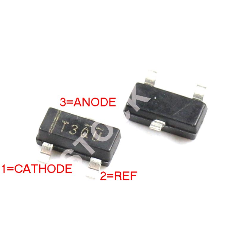

                            • JohnNovak
                              • Nov 2018
                              • 72
                              • Slovenia
                              #54
                              It looks the same to me like on the picture.
                              I make some photo but very hard to make good quality picture.
                              I have 10ohm readings at Q105, pin 1 and pin3 in both direction so i desolder out this part,
                              looks is damaged.
                              Pin3 goes to gnd, yes. Looks we have voltage reference here.
                              Q105 have pin3 to gnd, Q111 have no grounded pin.
                              I put pin out on the picture, should be correct?

                                  #56
                                  R J, i have some good news.
                                  Today i replace Q105 with TL431 i got power up with DC outputs:
                                  +10V = 12.42V ???
                                  +3.3V = 3.51V is OK
                                  +12V = 15.36V should be 14.4V ??
                                  I'm a little worried about +12V and +10V high outputs.
                                  I will replace Q111 and Q105 with new TL431 and then will see what outputs will be.
                                  TV works normal.

                                          #60
                                          Thanks for reply.
                                          I measure DC outputs when TV is turn off.
                                          +10V = 12.35V
                                          +3.3V = 3.57V
                                          +12V = 3.57V
                                          So the only voltage which goes down is +12V.
                                          Switch FET=Q112
