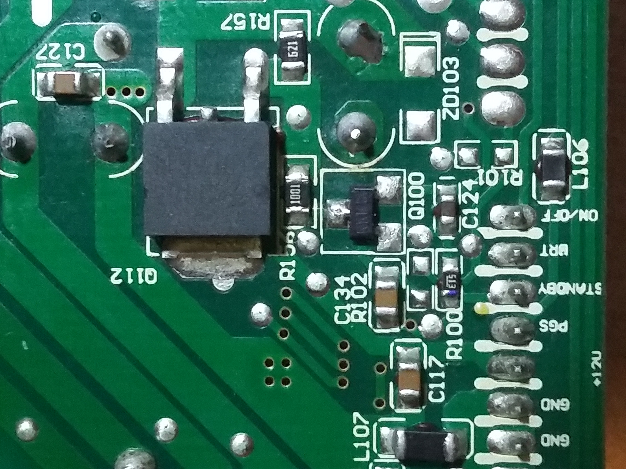

                            I found suspect part which is connected to st.by
                            line and which turn on 12V power.
                            The mark is RKM25 can not found any info.
                            What can replace this transistor?
                            Position Q100 on the picture.

                              This LCD have 3 power options.
                              NO LED is power off with power button on TV.
                              RED LED is on st.by position when you use remote to power off.
                              GREEN LED is power on TV.
                              So maybe if this voltage is missing (Q100 faulty) the power board stay in power off position.

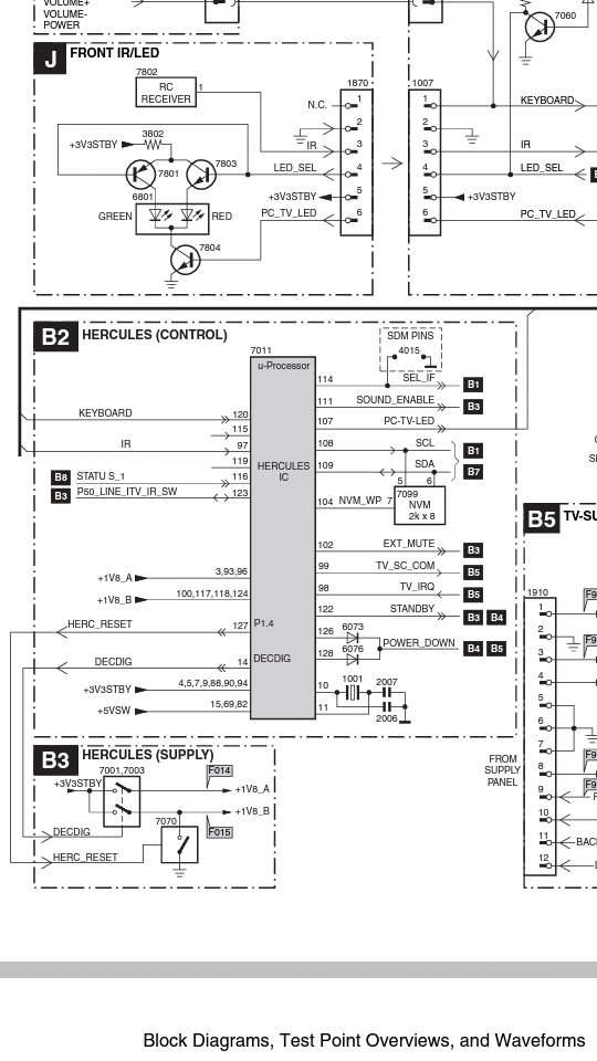

                                          To u-processor IC7011.
                                          There is 1.8V voltage to processor, and where is this voltage on power board?
