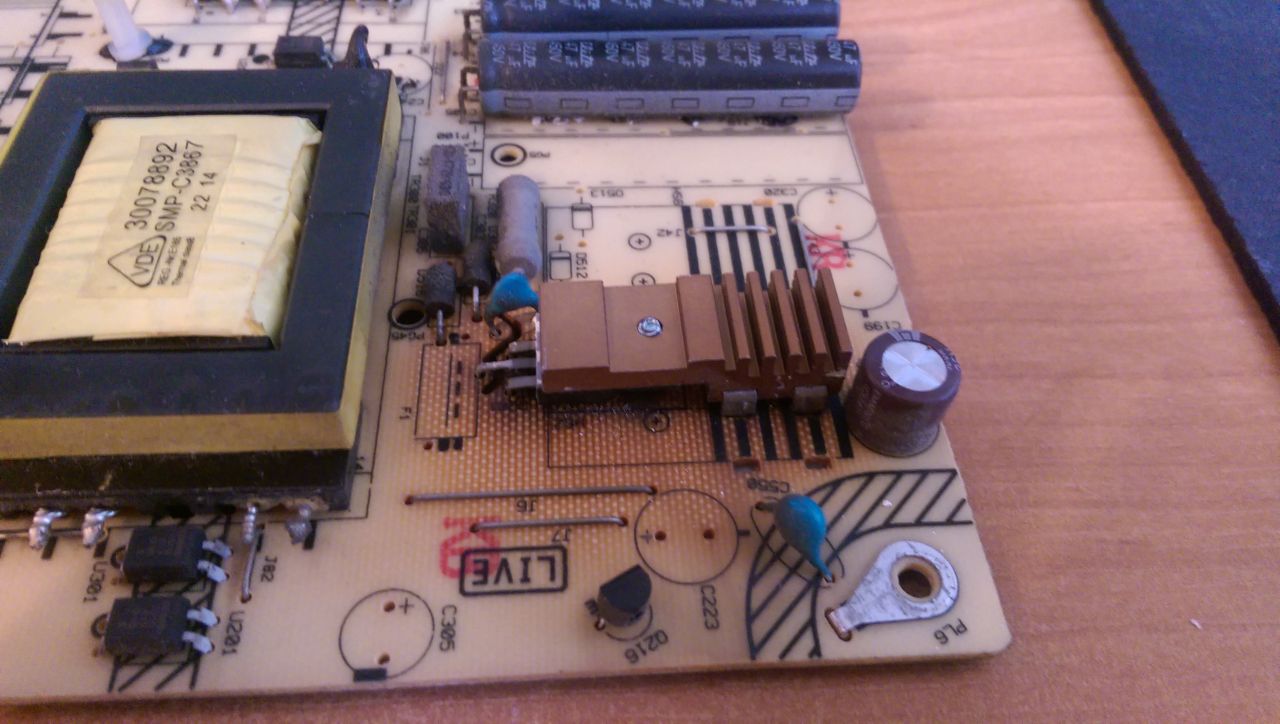

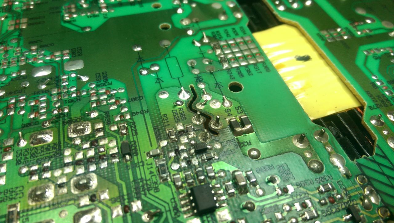

    Sorry for my english.
    Toshiba 40L3433DG, Vestel 17IPS20R6.
    TV not working, only led blinking. I find shorted Q301 on psu. I change it to similar. I don't find any other damage. Now works fine, picture are very good, but Q301 is extremely very hot.
    Where look for other damage?

      Re: Toshiba 40L3433DG - very hot Q301 on PSU board
      I don't know what exactly temperature is, but I can't touch this. Original was FQP7N80C and now is STP20NM60.
      Also I add pictures before repair.
        Try to get something like a temperature measuring 'gun' or a thermocouple or something like that. The replacement device is rated for a max of 150C operating temperature.
        Also, do you have another FQP7N80C you could try?
                  Well, I can think of a couple reasons:
                  1) The replacement part is different, and thus will run hotter
                  2) The original part operated hot in the first place
                  I think it's more of reason 2, because it has a heatsink on it to help dissipate heat. Could you try adding a fan to blow some air onto that heatsink?
                        A big heatsink will help.
                        You may see there is enough room for bigger one.
                        Encountered few times same problem,MOSFET short on G-S,replaced with original but very hot in short time.
                        So I remove old heatsink and replace with one that fit in that area.
                        After few hours of working heatsink was at ~45-50 °C
                        On PCB there is footprint for bigger heatsink but they use a little very small one.
                          Check the gate resistor and gate pulldown resistor are not damaged. If the MOSFET failed these can be damaged causing poor performance of the new MOSFET.
                              Vcc on U300 (NCP1380D) is 18,3V.
                              Vgs is max 3,5V.
                              Voltage drop on R320 (0,47R) is max 0,08V.
                              Any ideas? :/
