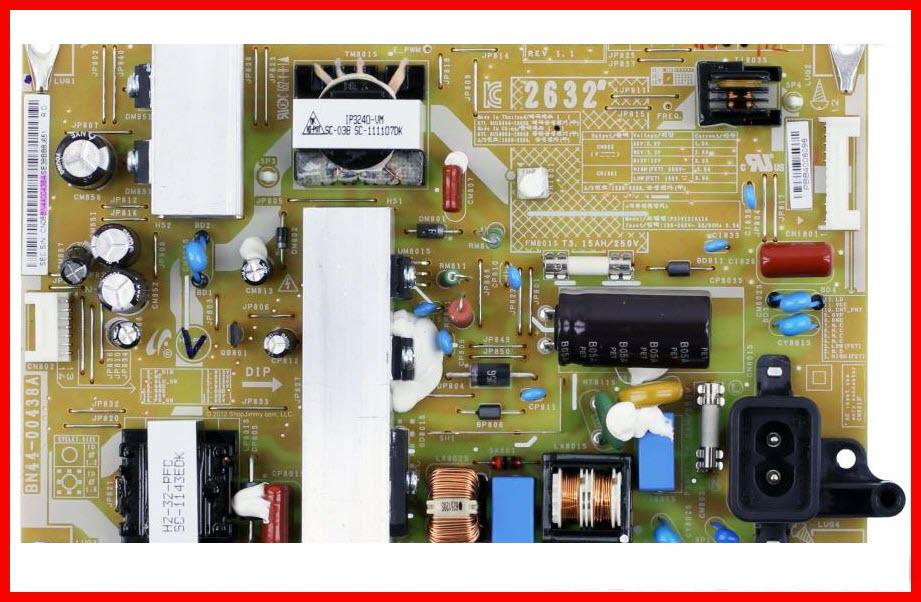

    Hi all. I am 'the new guy' to this site. I stumble across this site awhile back while looking for some information on an Samsung TV. Really enjoyed reading everyone's input; which helped me repair that TV.
    Now, I have a Samsung TV model- LN32D403E4DXZA version SP01 that had a bad power board among other issues. Power board's circuit from the main cap to the back light inverter blew and the board was damaged beyond repair. I got a replacement board (BN44-00438a) that failed while still testing the TV. I used the attached schematics (2 different schematic for this board. The board is a mix of both of them) to determine that the transistor located at QM854 was bad. After replacing it, the power board worked again.
    Now, when the TV starts up, the back light flashes for about 20 seconds then stays on steady. The center 'weak or no signal' (I have no input attached) is somewhat bright, but dims in stages over the next 30 seconds. I reset the TV and updated the software, but this flickering and dimming still occurs. I don't have the ECO setting on. I am guessing it is the main board, but the high FET reading on my power board is lower than I think it should be.
    I have searched your forums for information on this TV but came up short. I would love anyone's input on what the problem could be. If you know which component on the board might be an issue, please tell me that too.

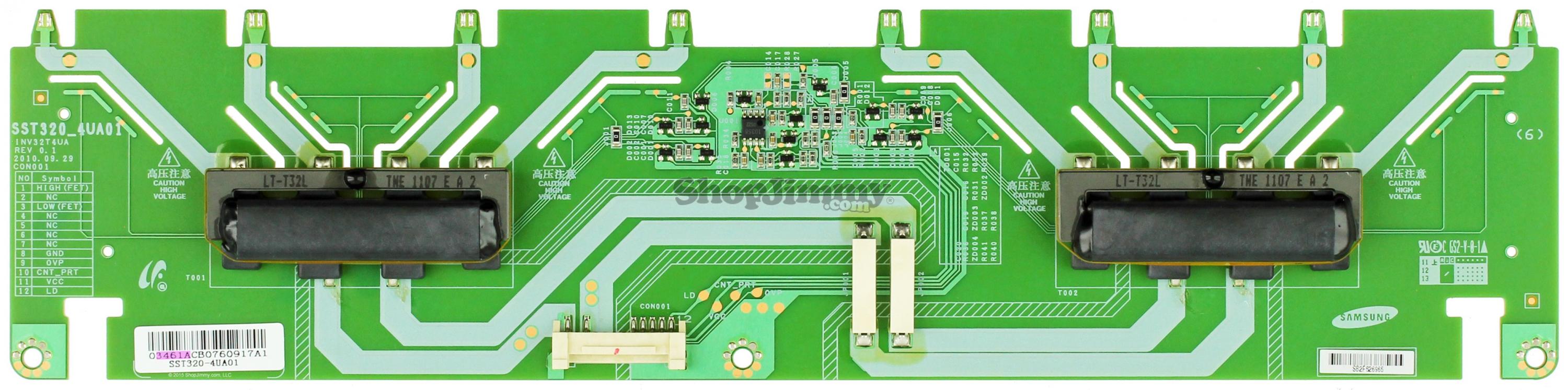

    Inverter Board (SST320-4UA01) (LJ97-03461A) Attached pic Shop Jimmy
    Transformer:
    Primary - 1.6 ohms
    Secondary - .94 Kohms

    Pin 6 - BLU_ON - 104-107mV Don't look good too low.

      Would you happen to know what the voltage of Pin 6 should be?

        You're checking with tv plugged in power button off which is standby, then you hit power button and get that reading too, they can vary but usually you need 2.5+volts which comes from the mainboard, which turns backlights on, at 107 mv seems too low to turn m on.

          https://www.shopjimmy.com/samsung-bn...upply-unit.htm picture of powersupply

            I would unplug powersupply from mainboard and do the jump with resistor to see if that voltage comes up, on this one I think you need to jump ps on with 5 volt standby and blu-on, better double check with one of the pros tho, to be sure.

              Thank you for all the information. I re checked Pin 6 (Blu_on) and got 5.1V. My mistake.
              On CN 1801, Pin 1 (High Fet) should it be higher than 185V?

                I think it says high 280 on your board map/legend, seems low?
