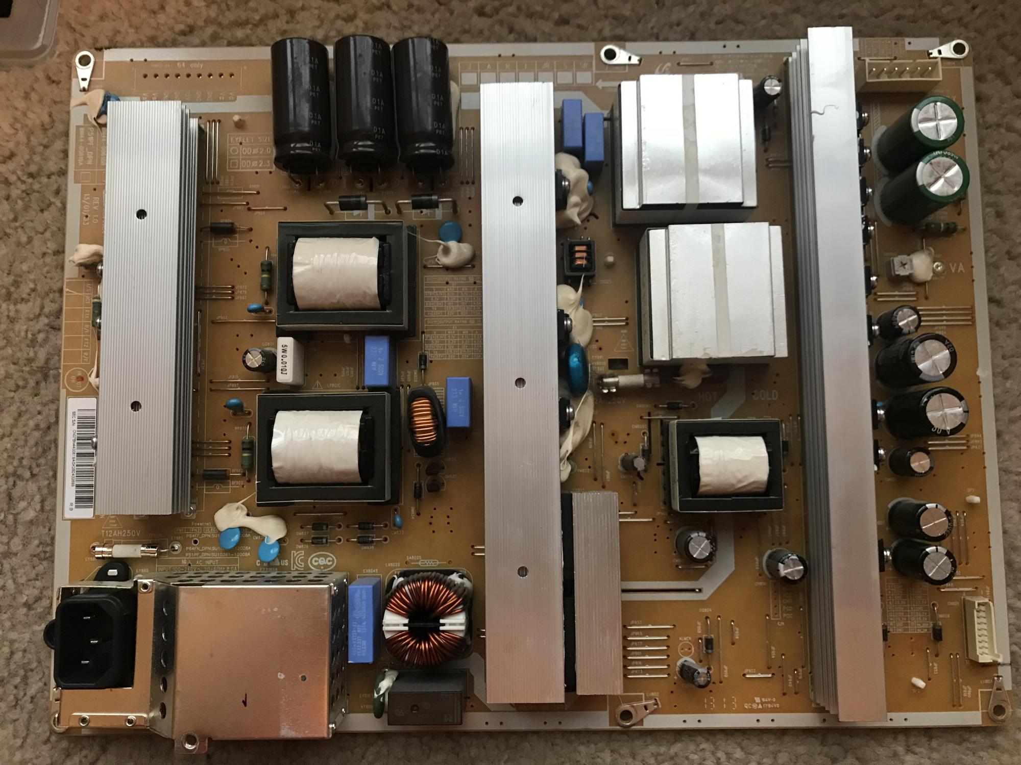

What type of fuse is this?

      Check the RESISTANCE reading between the two legs (+ and - legs) of any one of the three main filter caps (3 large caps laying on its side), report the reading.
          That wouldn’t cause blown fuses would it?
            Re: What type of fuse is this?
            shorted main caps would blow the fuse
                Getting ~46k ohms on the filter caps.

                    Now the reading on the filter caps has changed. ~11M ohms.

                      did you test all diodes for short ?

                        Yes, none of them are shorted unless there are some under the cage by the power inlet. I can’t really see what’s in there.
                          I am looking for shorted load which will be connected in parallel with the filter caps.
                          So now you need to test the resistance between the two inner legs of the Bridge rectifier.
                          I need to get good clear high res straight shot pictures of the whole top and bottom side of that power supply board, right now I cannot read the P/N of that power supply board.

                            Sorry bud, just got this. I’ll get better pictures tomorrow. The board number is bn44-00619a.

                              This is the best picture I can get with my phone.
                              Which is the bridge rectifier?

                                The parts in the 15 piece repair kit are: DS808, DS810, QS802C, QS804C, RS819, RS833, RS827, RS835, DS813, DS807, DS809, DS814, FS801S, RS854 and RS855.

                                        That kit only applies if QS802C and QS804C are shorted.
                                        Possibly something under that metal cage at the AC inlet is shorted. Maybe a varistor?

                                          I guess I can remove it and check.
