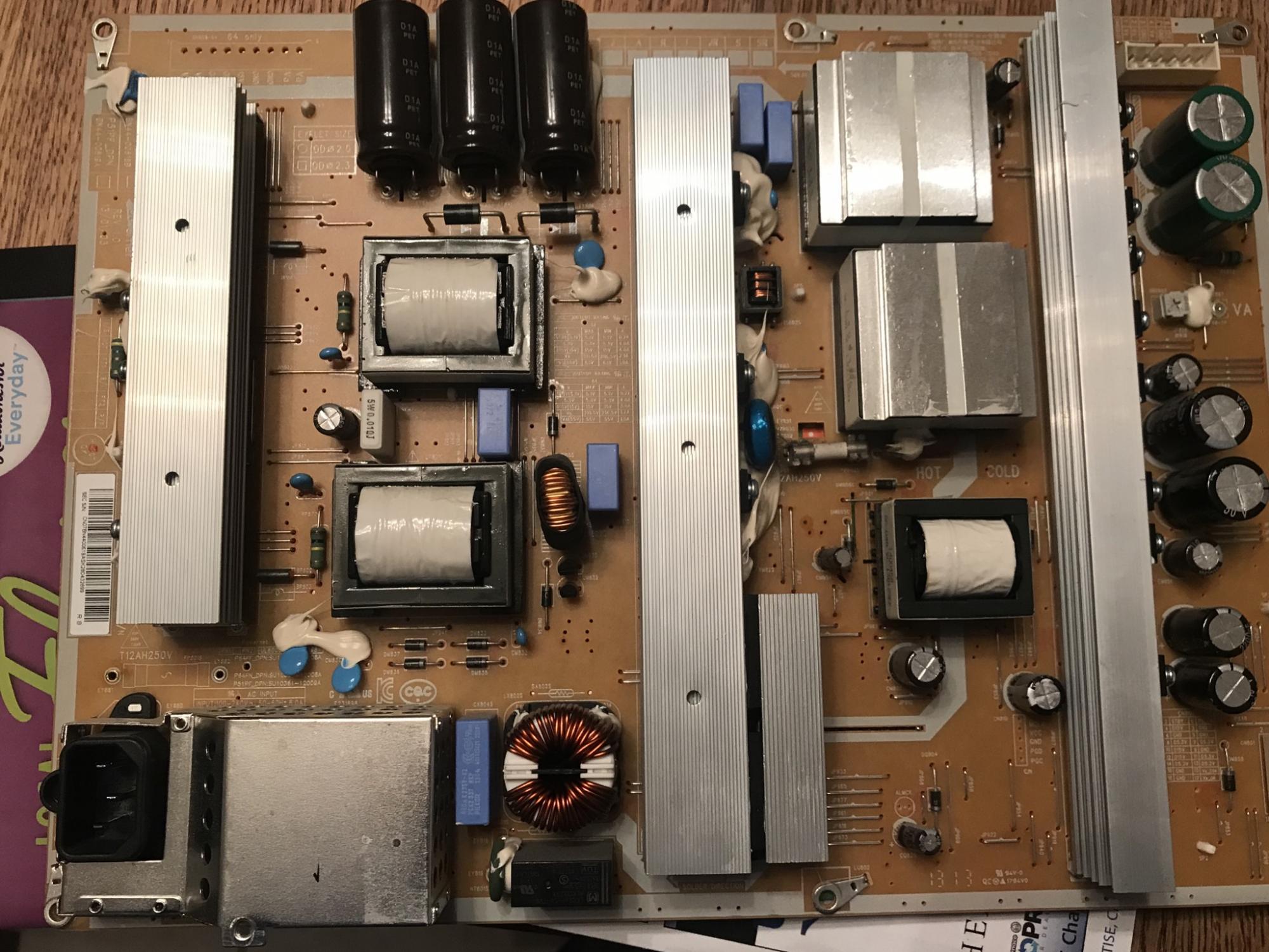

    What type of fuse is this?
    Picked up a Samsung PN51F8500 that the owner said wouldn't turn on.

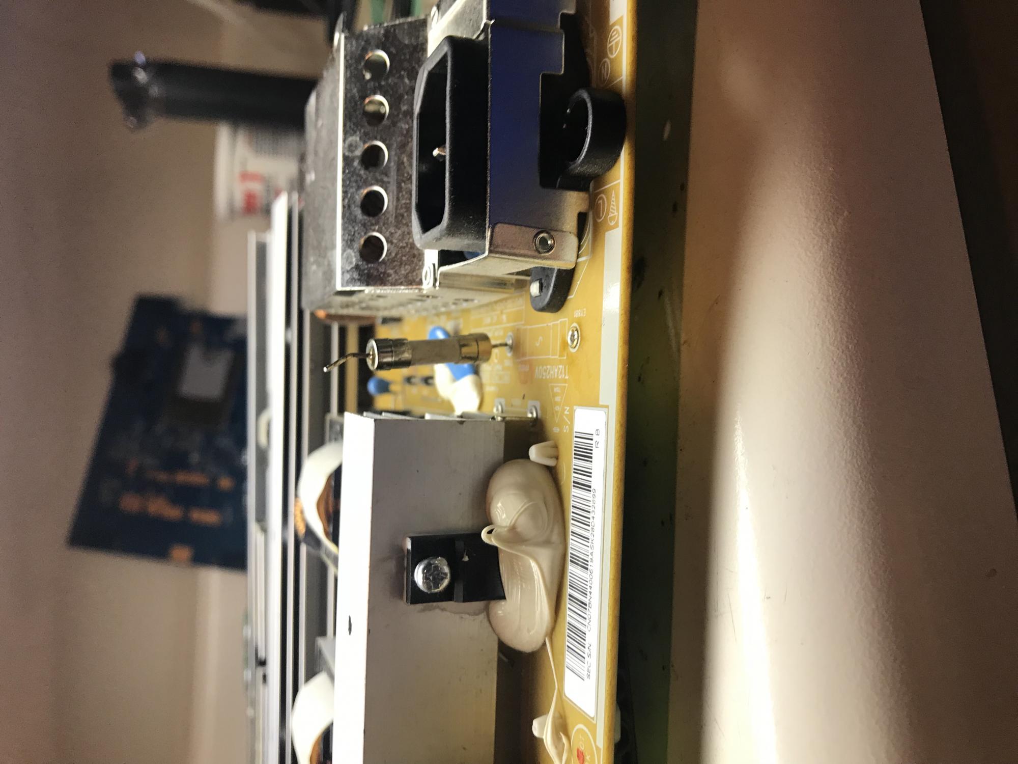

    First thing I noticed is that the fuse right after the power is blown.
    It is a T12AH 250v. I thought that it was held on the board with a holder that is soldered in, so I unsoldered one end to replace the fuse but it's sll one piece.
    What is it called so I can try to buy one?

    ceramic 12A delay/slow-blow 32mm with pigtails.

      12A 250V ceramic. Just has wires soldered to the ends instead of using a fuse holder. Blown fuses typically means shorted FETs so check them before replacing the fuse.

        Something like this:

          Thanks.
          I already ordered the fuses. A 5 pack for $10. They were listed as axial fuses.
          I probably won’t bother with anything else if it blows a fuse again.
          I don’t remember how to test the fets and not sure I want to spend more on it.
          Edit: I see a repair kit with two fets and the fuse is on eBay for less than I paid for the 5 fuses.
          How do I check which are shorted? There are more than 2 on the psu.

            dont waste money on special fuses . get some 12 amp fuse wire but watch for fire it is sure to blow again . or solder to a regular time delay fuse
              They will typically short gate to drain. Just probe with a multimeter. Usually a TO220 package mounted on a heatsink.

                That’s what I thought. The two listed in the repair pack on eBay are testing fine.
                Since I already ordered the fuses, I’ll try one. If it blows, I’ve lost $2.

                  check diodes and bridge rectifier for shorts

                    Thanks. Since the fuses have already be ordered, I will try that first. Not sure which the bridge rectifies are. Lol.
                    I can check the diodes.

                      square block near power inlet on pcb . 4 legs . unless it uses 4 diodes instead .

                        you can also measure the resistance from the fuse to hot side ground to confirm the short. Rectifier pins should be marked ac + - ac . Check the resitance between + and -

                          With my limited skill, I can only determine a blown fuse which is missing right above the power inlet.

                            check all diodes and the other fuse .

                              Everything else checks out.

                                replace fuse and check ohms across power lead

                                  What should I be looking for?

                                    Replaced the fuse, the minute I plugged the power in, the fuse blew.

                                      just as predicted then .

                                        Yup, but only cost $2. Should I try one with the other boards disconnected from the psu? To make sure they aren’t causing it to blow?
                                        I hate to spend too much. The tv cost me $20. Probably couldn’t get more that $125 for it.
