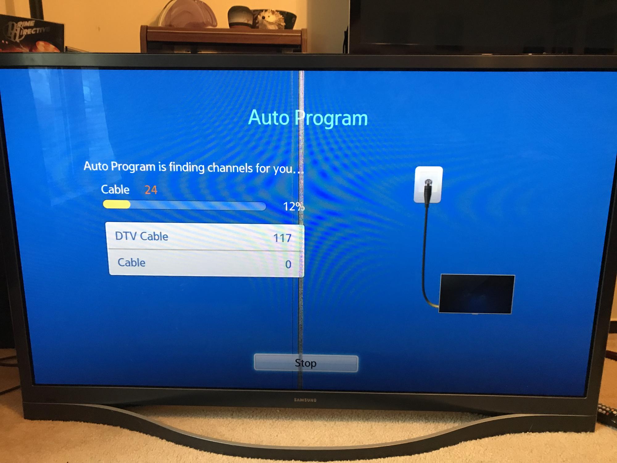

                                Good news. Replacing the 2 MOSFET's fixed the issue.
                                The bad news, see the attached picture.
                                  #76
                                  Re: What type of fuse is this?
                                  Bad panel. Sorry to see that.
                                  It seems that these are really nice Samsung panels but very poor life.
                                  Small chance that when power supply faulted it caused damage to address/data drivers -- but bad design if so.
