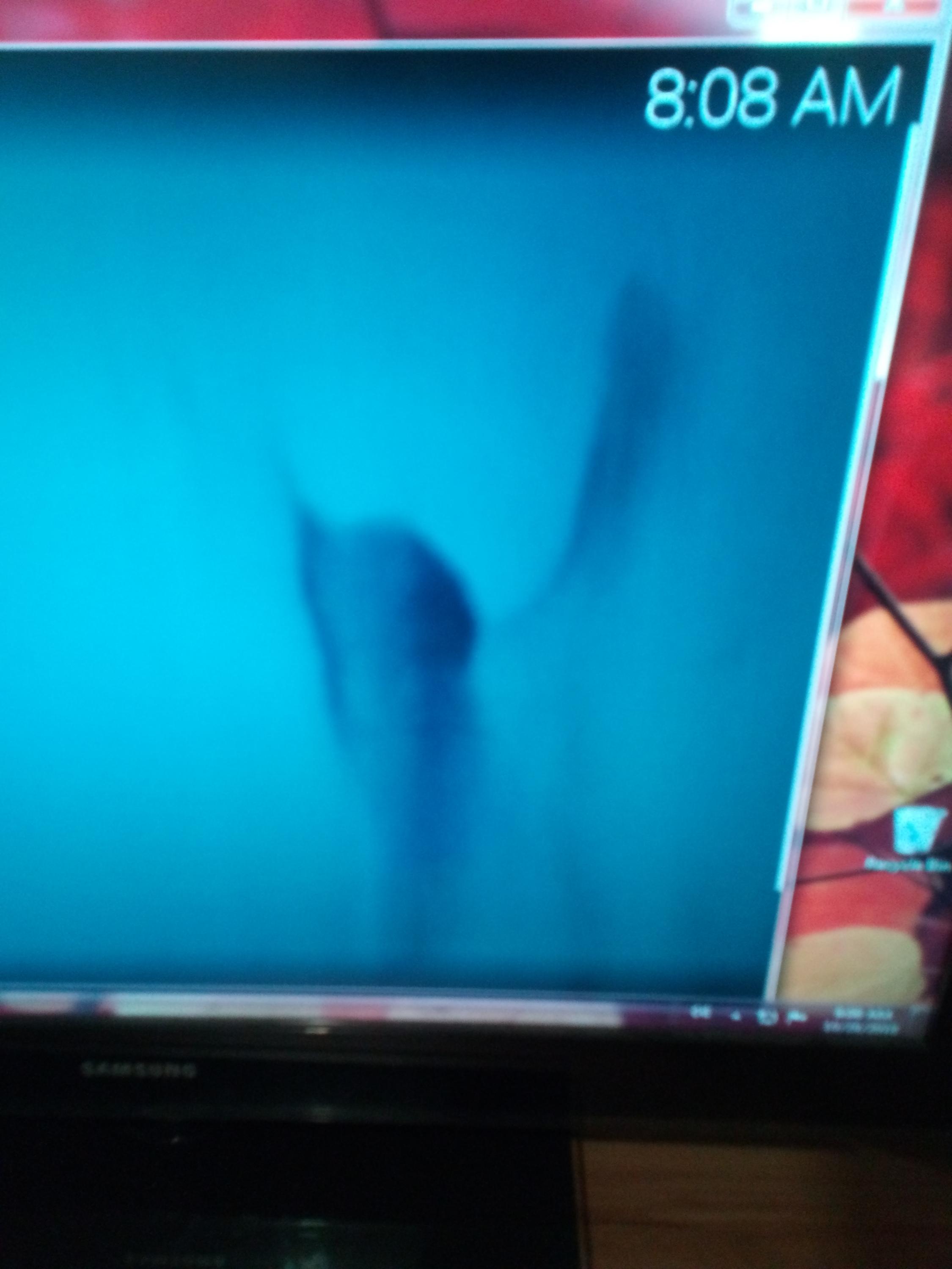

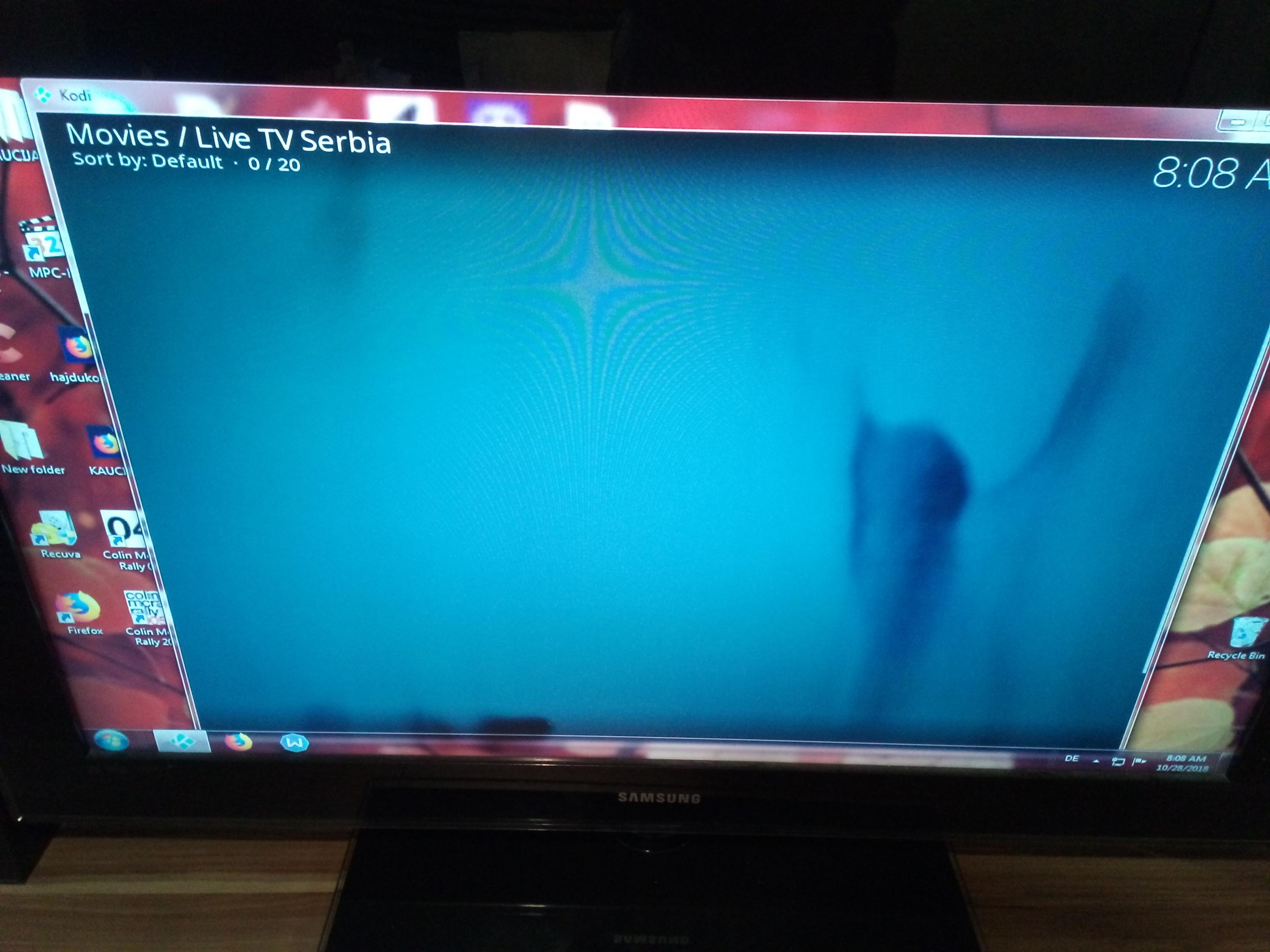

    Hi everyone!
    Got this TV, has on-screen black stains which look like clouds.
    Is this actually a screen problem or something that could be repaired?
    Screen is not cracked or anything, and picture is normally visible beneath stains.
    Thanks a lot!

    Re: SAMSUNG LE40B620.... clouding?
    I had a 32 inch Samsung with that problem. Screen was bad.
      ...and I have noticed that, when static image is long-time on screen (YouTube),
      then silhouettes of the image (rectangles) are visible over the
      new screen (cable TV) in the clouded area.
        Bad screen for sure.
        • jetadm123
          • 2169
          Damaged screen. Looks like someone hit the screen or had something heavy leaning against/sitting on top of the screen. See a fair amount of this on computer screens. When people move, they usually have it face up and junk piled on top of it! Or, standing upright and heavy objects leaning against the screen.
            Bad panel.
              Many thanks, guys.
              Will just keep using it, as it don`t bother me that much.
