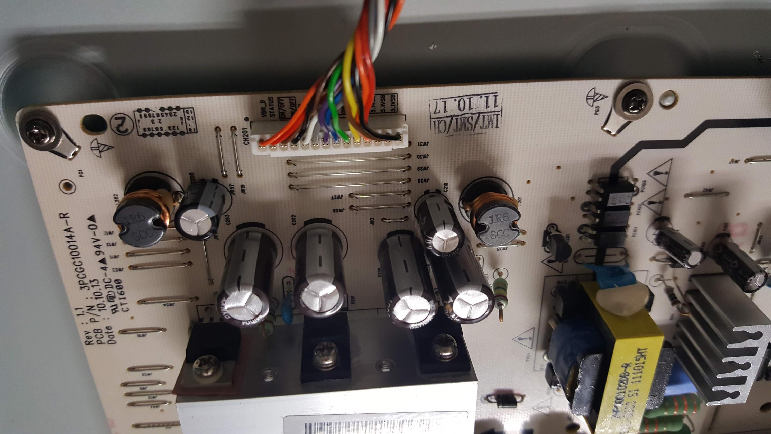

    I've been making progress with a Vizio E321VL that was victimized by an apparent power surge. On the PSU it took out the fuse, a SMPS IC (FSQ0465R), and a MOSFET (FQP13N06L). Now I have two seconds to black. After replacing those components, all the power at the cable going to the main board seems proper, except VBR_B drops from 3.3v to 2v gradually after the backlight goes out.
    I've poured over other threads here to get some clues, but none appear to have a solution for the same problem. I've tried disconnecting the IR receiver board; it didn't work.

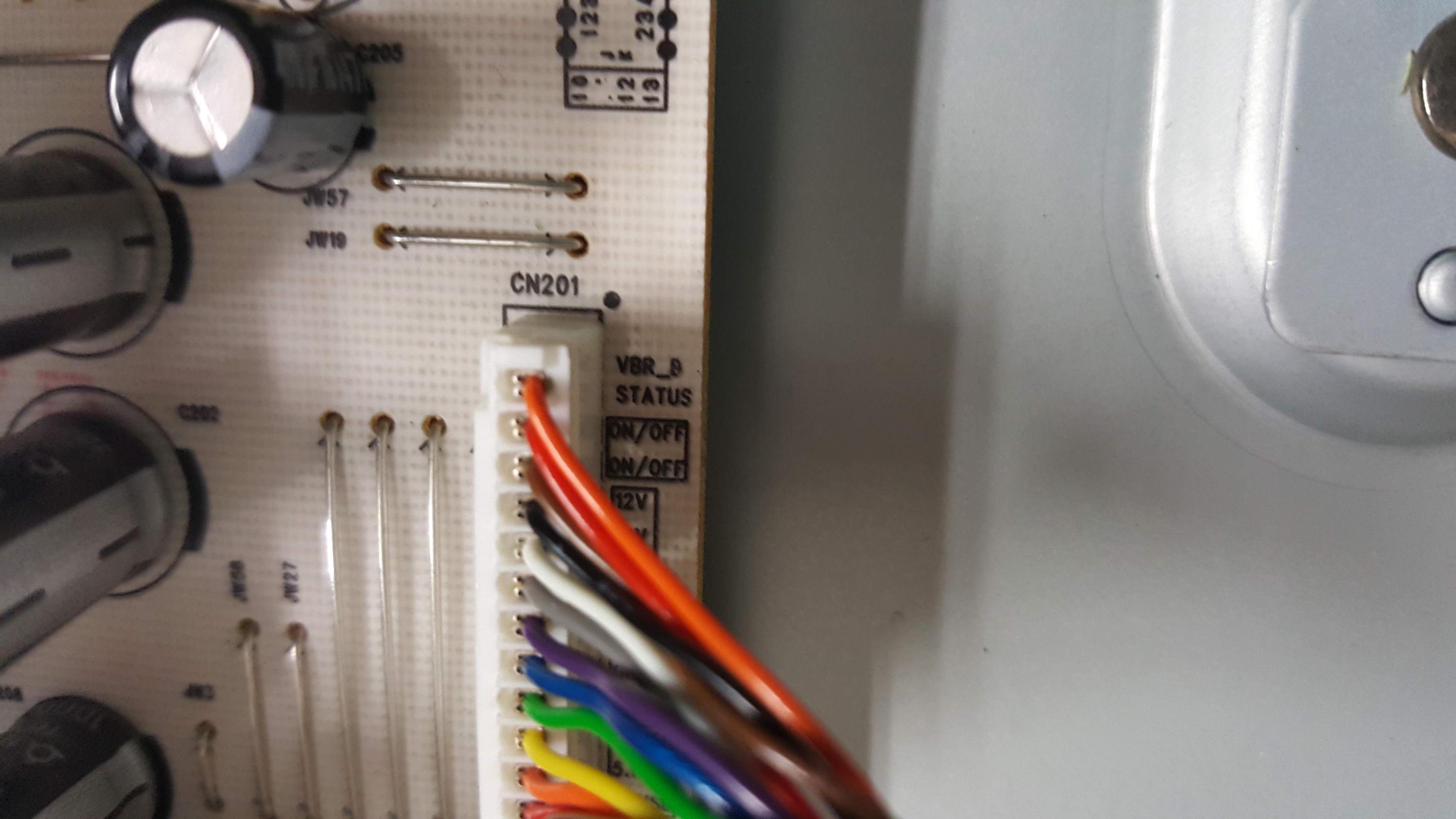

        Does anyone happen to know what VBR_B stands for? What its purpose is?
        Thanks for looking.
          Re: Vizio E321VL - 2 Seconds to Black
          Back lights dimming control signal.

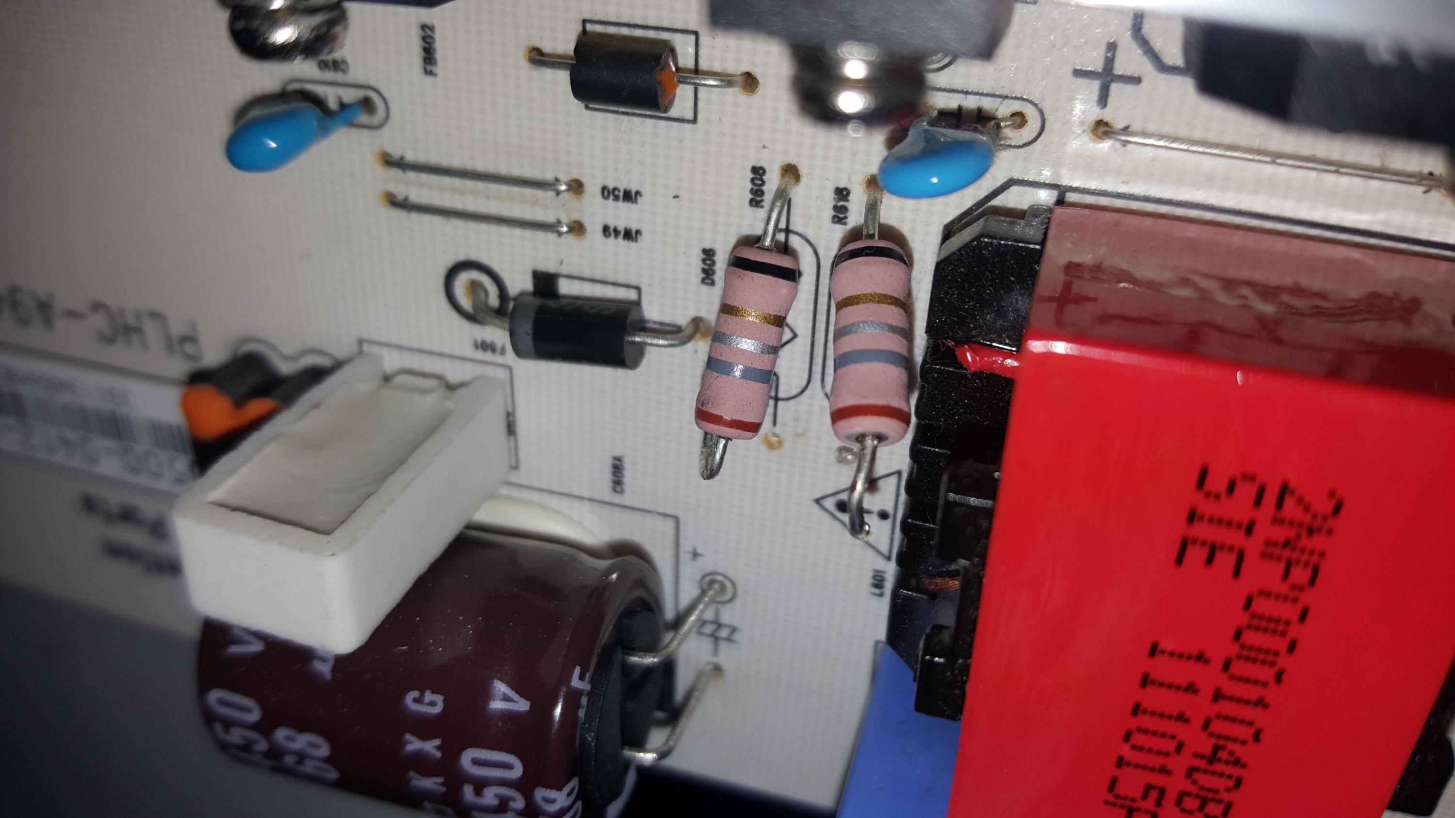

            I pulled up these two resistors that are both reading .8 ohm. I can't deduce the value based on the color bands. Is it possible I have failed short resistors? That would be a first for me.
              Resistors are fine.

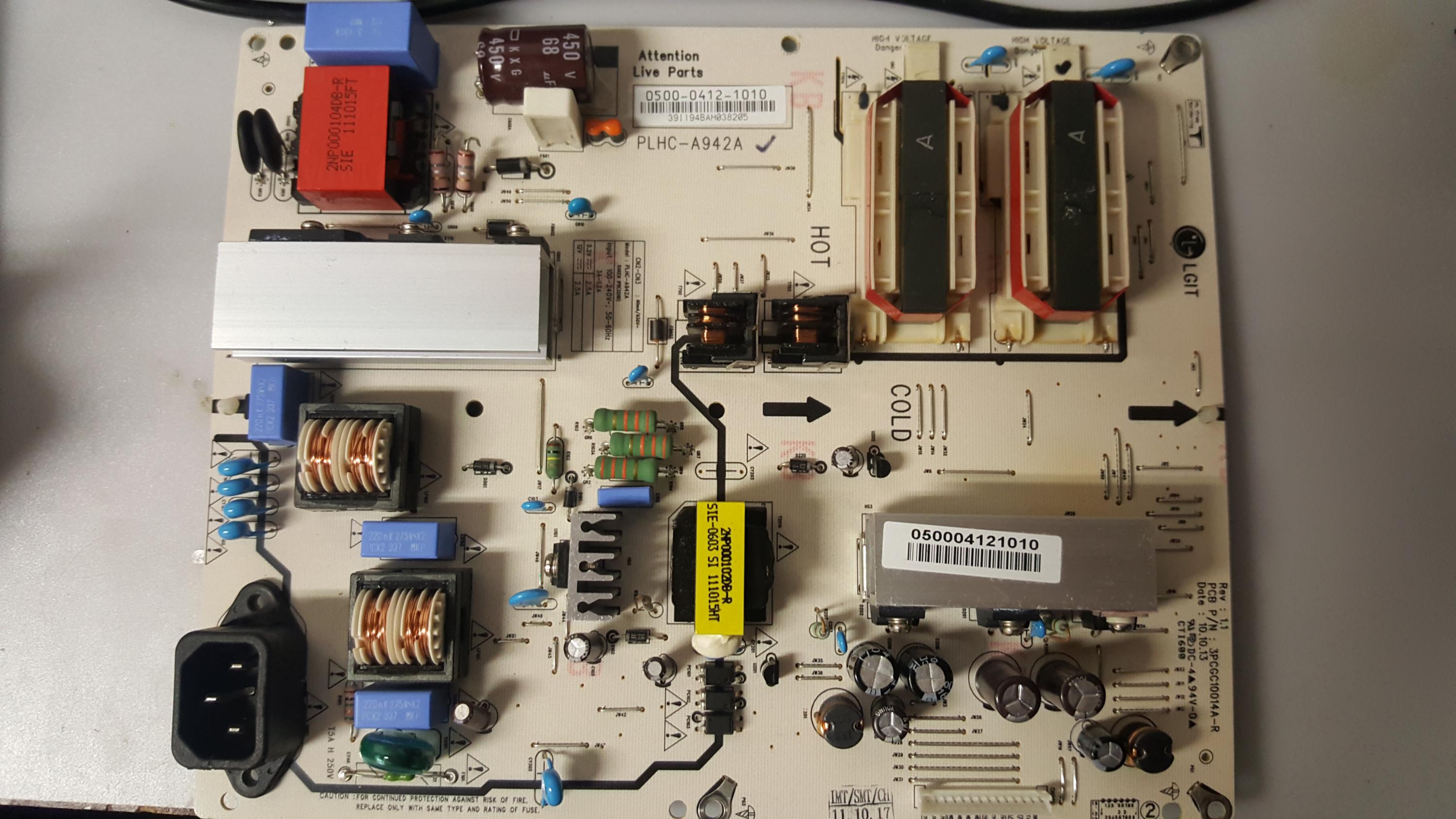

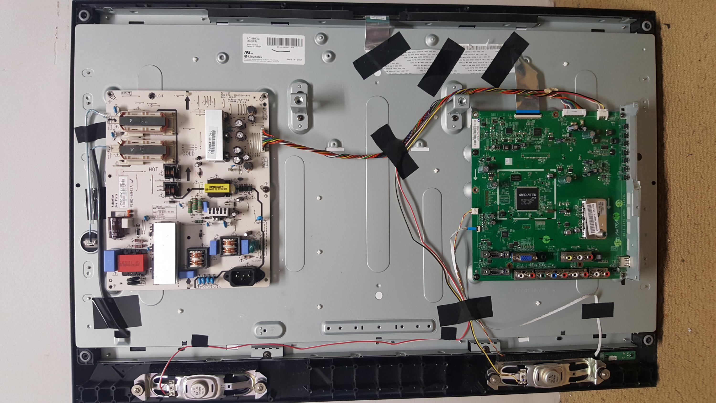

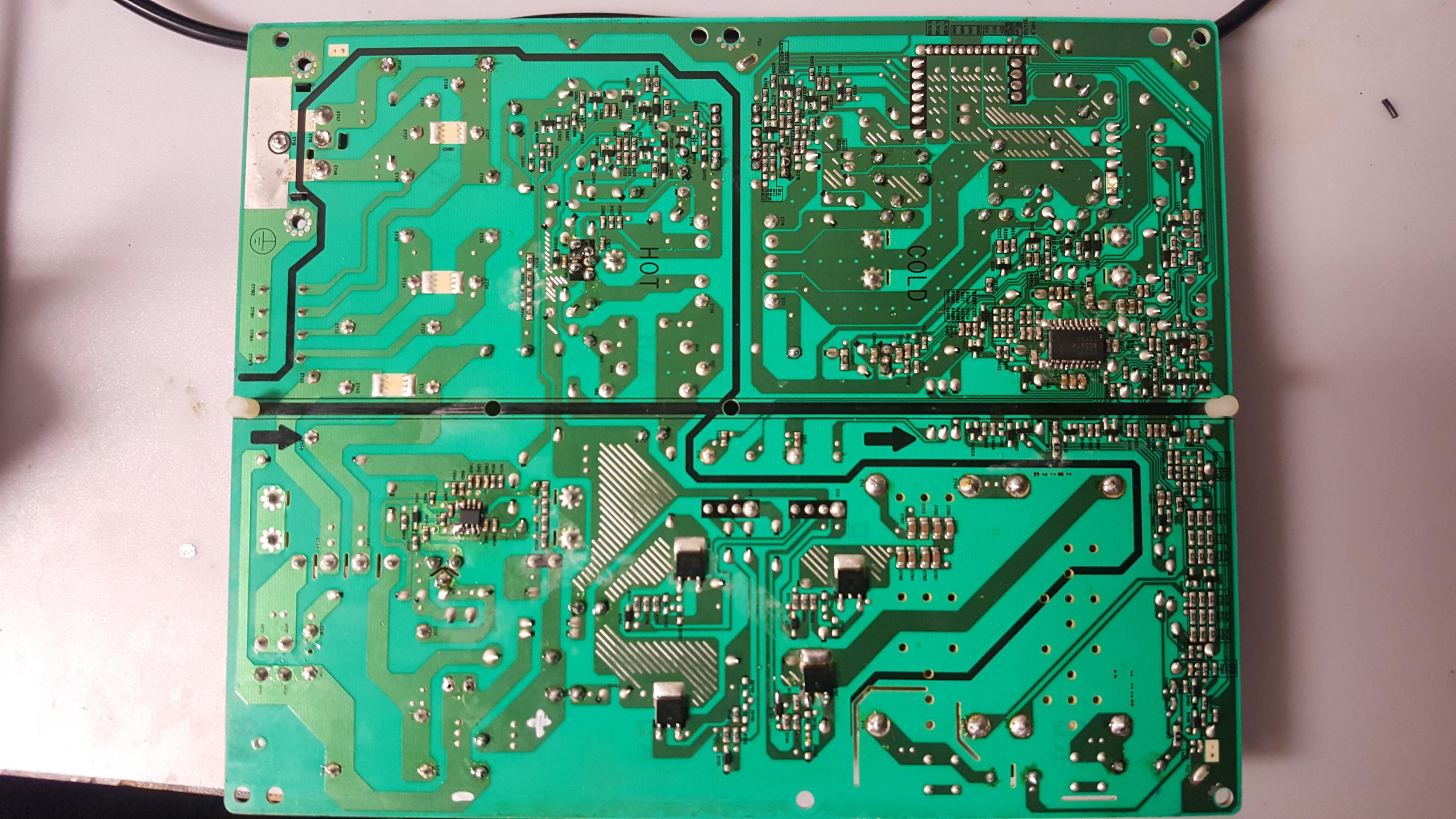

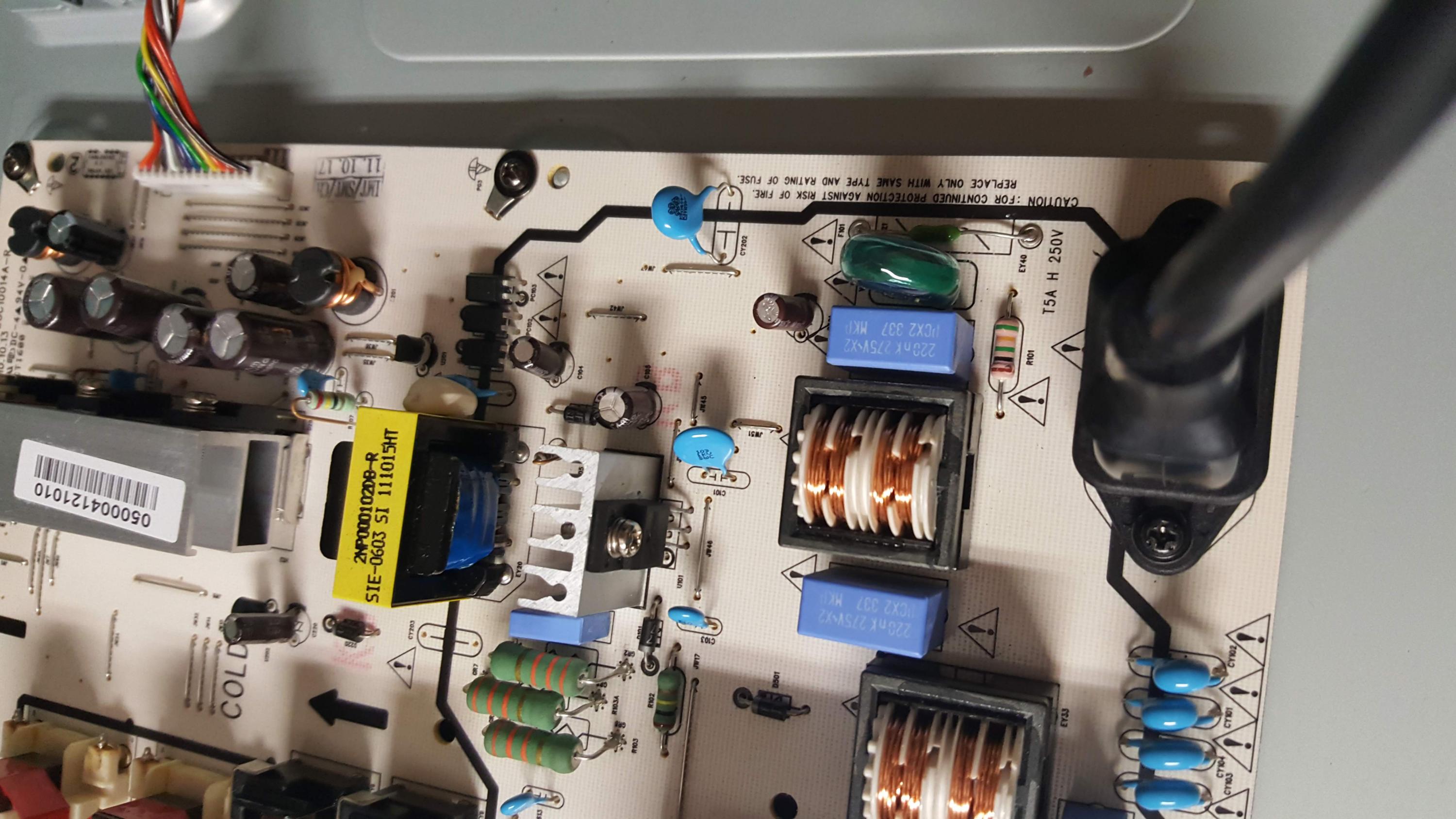

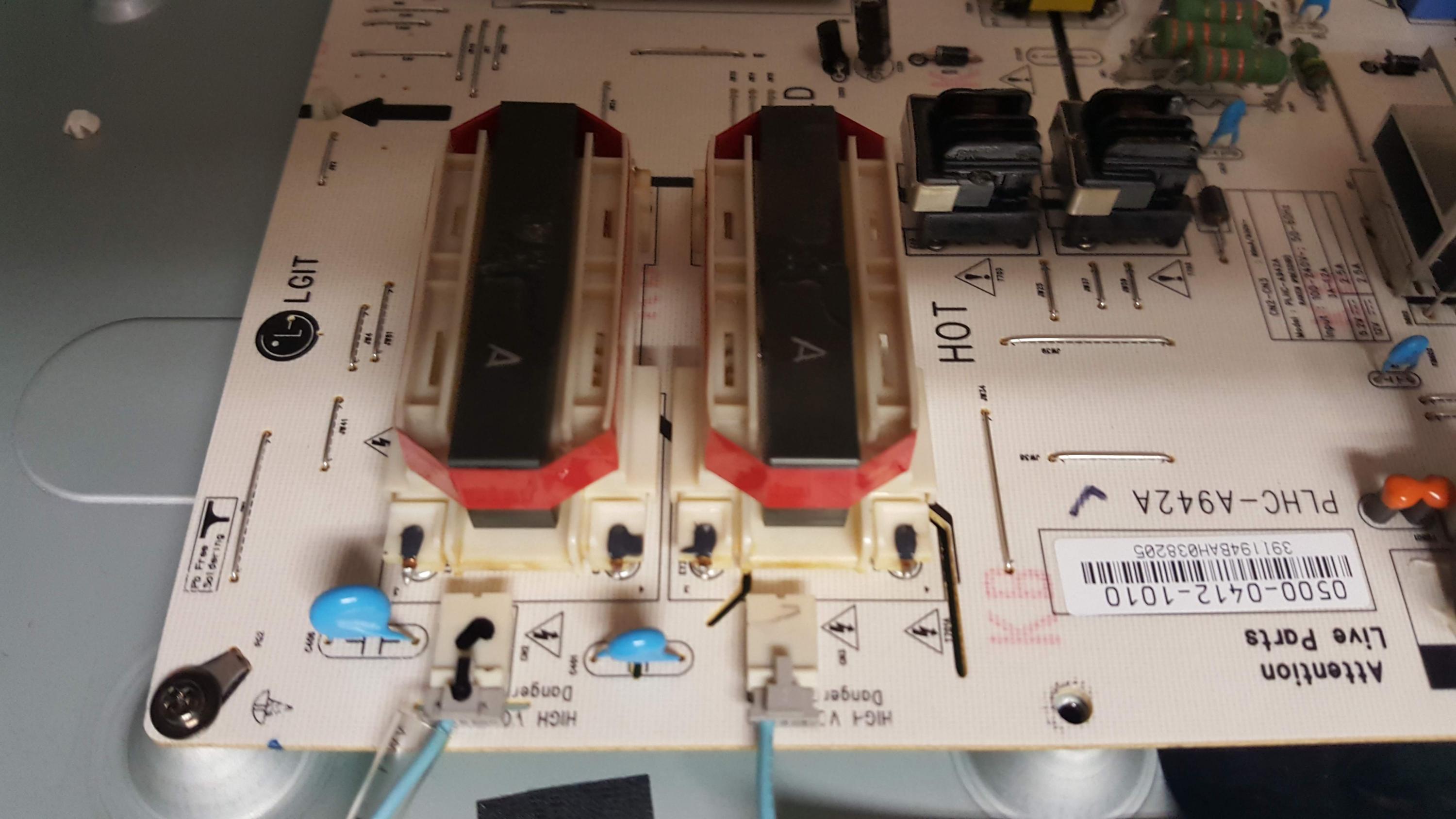

              1) We need good clear straight shot pictures of the whole top and the bottom side of the power supply/inverter board. We also need the pictures of the whole backside of the TV showing all the boards.
              2) What are the designator for these two parts you replaced: SMPS IC (FSQ0465R), and a MOSFET (FQP13N06L)? IC (or U) 123? Q123?
              3) What dc Voltage do you get when measure right between the two legs of the main filter cap (68uF 450VDC) when power switch is activated? around 380 ~ 400VDC?

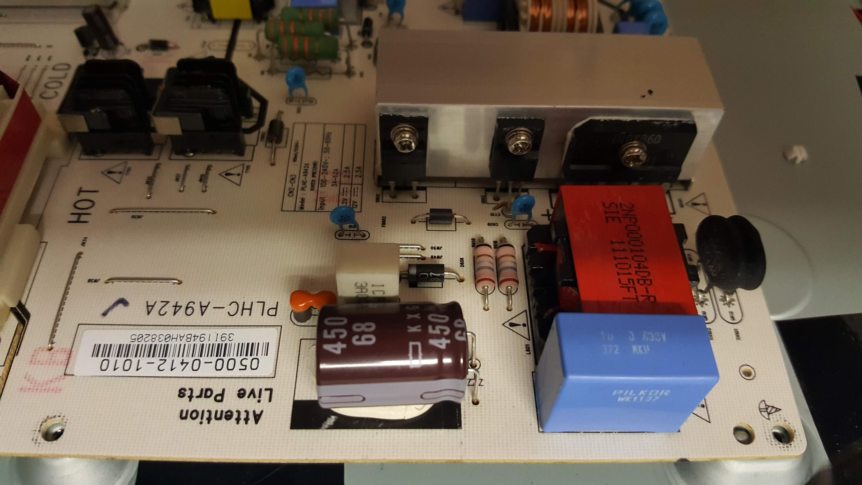

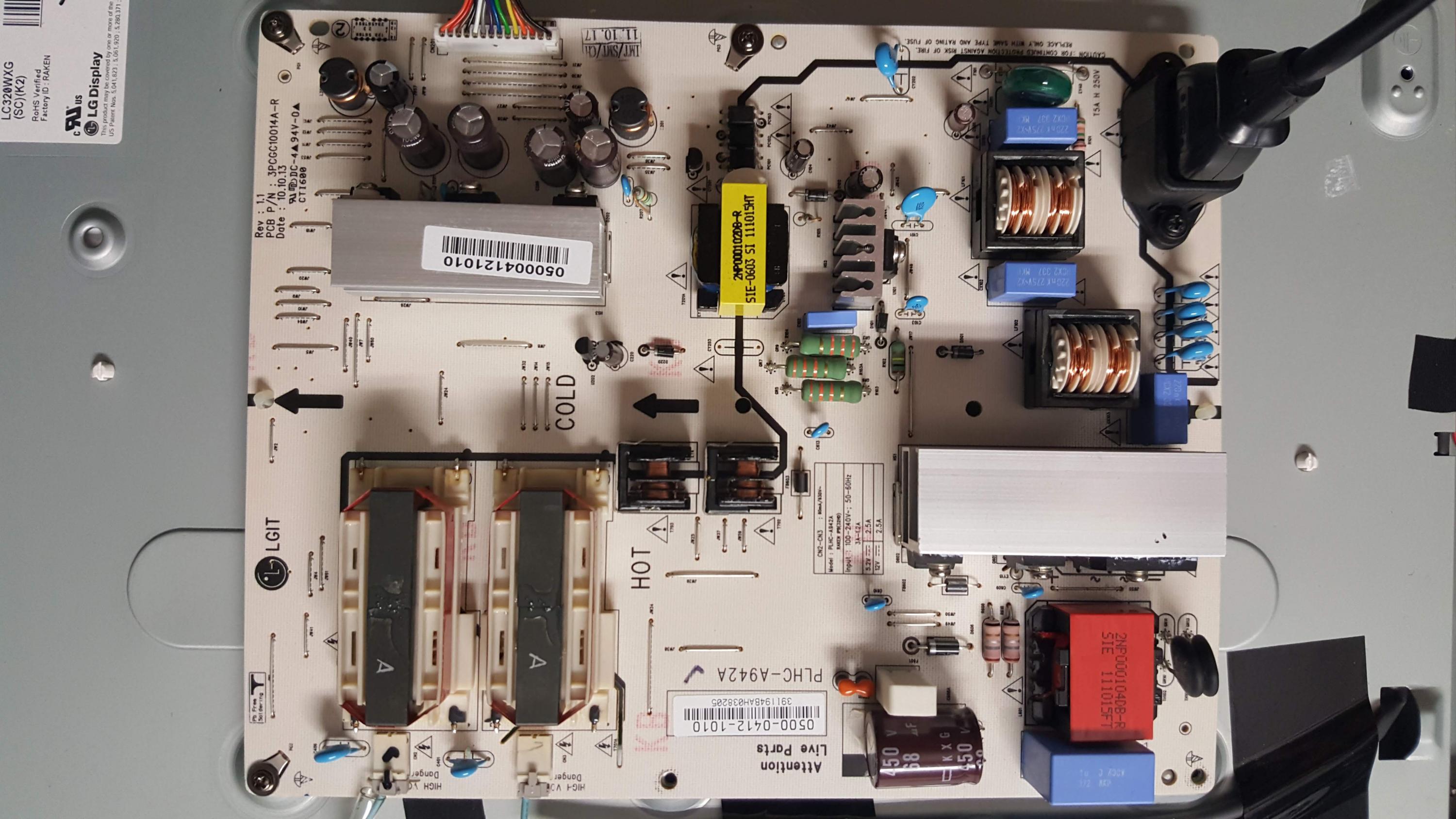

                Filter cap has 172v with the TV off, 158v with the TV and backlight on, and 168v after the backlight goes out.
                I took these pictures before I soldered those resistors near the filter cap back. I know my SMA job isn't the best, but it's a new practice for me.
                  "Filter cap has 172v with the TV off, 158v with the TV and backlight on, and 168v after the backlight goes out."
                  If that measurement is correct, that means the PFC Voltage booster is not working, it should have about 380 ~ 400DVC between the two legs of that main filter cap. The inverter circuit needs that boosted Voltage to run correctly.
                  https://www.badcaps.net/forum/attach...3&d=1542418212
                  Did you solder those two resistors in that PFC section in place where the main filter cap is?
                  You also need to check the resistance of that white rectangular fusible resistor next to the filter cap.

                    I soldered the resistors and took the readings after I took that photo. I took the readings twice with the same results using a Craftsman DMM. That white resistor read 1 ohm.
                    • bobbyskillz
                      • Dec 2010
                      • 76
                      Thanks for putting me in the right direction, budm! I found the problem was a MOSFET (k8a60da). I previously checked the diode function between the source and drain and it was fine. I now found low resistance between the source and gate. I replaced the MOSFET and have good functionality. My lesson has been learned.
