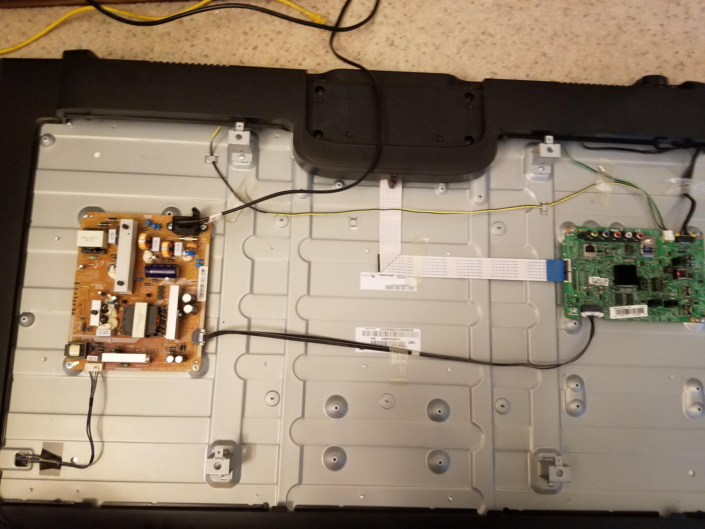

    Hi folks,
    I just got this Samsung TV, and all I get out of it is 6 blinks of the red standby light. TV seems responsive to remote and button.
    I started a bit backwards and went right to the LED strips. 90% dead, only 6 LEDs work. I replaced all strips with a new set. Tested with an external tester and they all light up. Put the TV back together and same thing - 6 blinks of the standby light.
    I'd like to rule out the Power Supply board - there is no 'STBY' pin to main board. Can anyone suggest a way to force the backlight on, or help me troubleshoot this TV?

    Re: Samsung UN50H5203 Blinking Standby light
    Unplugging the cable between main board and power supply board should cause the backlight to come on. Samsungs don't have blink codes. The blinking is the main board booting up. If the backlights come on with the cable disconnected, the main board is suspect.
      Thanks... backlight does not come on with power cable disconnected between main board and power board

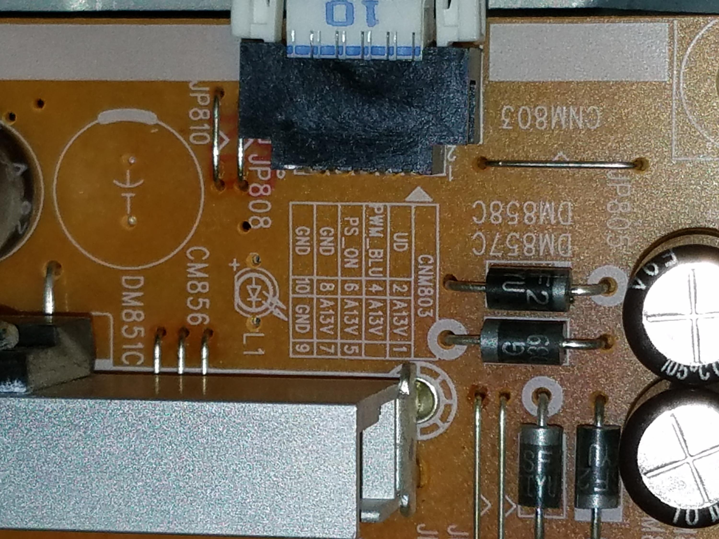

              I don't see a DRV_ON signal. Is this the UD pin from Main?
              • neilc6
                • Nov 2015
                • 1550
                This post says UD/OD may be an error signal so the board may not have a separate BL_ON signal. I would try replacing the PS but buy from a seller that takes returns.
                https://www.badcaps.net/forum/showth...7&highlight=ud
                                        https://www.badcaps.net/forum/attach...1&d=1538256450
                                        I just look at the picture, it looks like that section of LED driver gets around the diode D9XXand the ferrite beads inductor (B8xxx), please verify that the diode is OK, check it in diode mode and Ohm mode.
                                        Also check that rectangular cap with '2j 104j' printed on top, that cap is connected between D+ and D-, you have to remove the cap and check the resistance (not ESR) to see if it has bad leakage resistance or not.
                                        This is tough troubleshooting without the schematic, I will have to find time to trace out the circuit.
