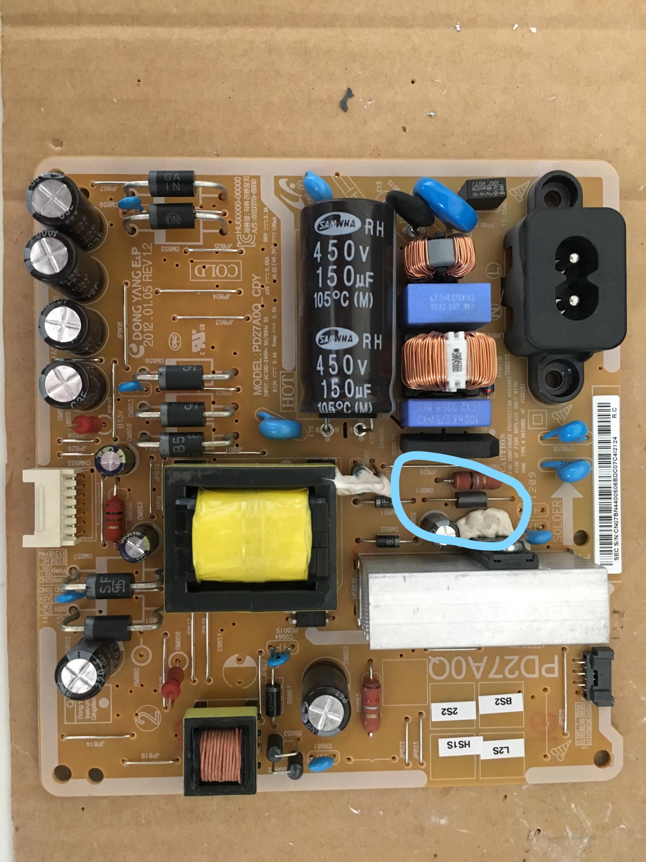

    Help please.
    I have a Samsung power board PD27A0Q, BN44-00506B that I am trying to identify the component BM801.
    I Have attached a picture of the board with the component circled.
    Thanks in advance for any assistance.

    Its a ferrite beed. Just carbon around a wire jumper.
      Re: PD27A0Q Identify Component
      It is just small one turn inductor using Ferrite bead as the core.
      So what is the TV not doing?
        Thank you for the replies.
        it was a second hand board I picked up with a failed voltage regulator and blown ceramic capacitor but the mentioned component had been removed, hence the question what is it, but if it is just a jumper then happy days.
          It might be there to stop some electrical interference on some other part.
              Hello, I have an equal plate and the DM852 and DM853 diodes are missing. Someone could tell me your values or reference.
                SB5150 will solve the problem for you.
