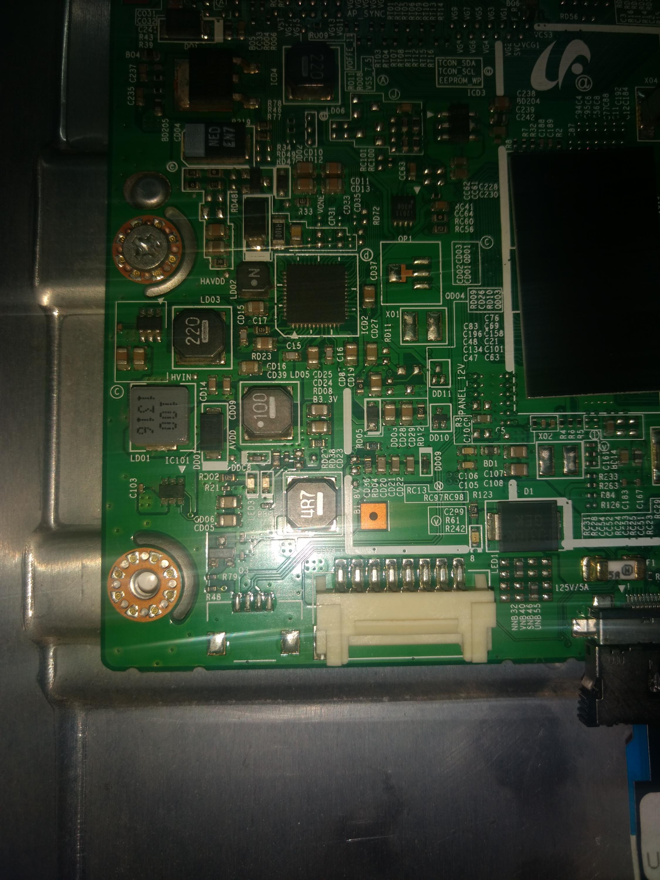

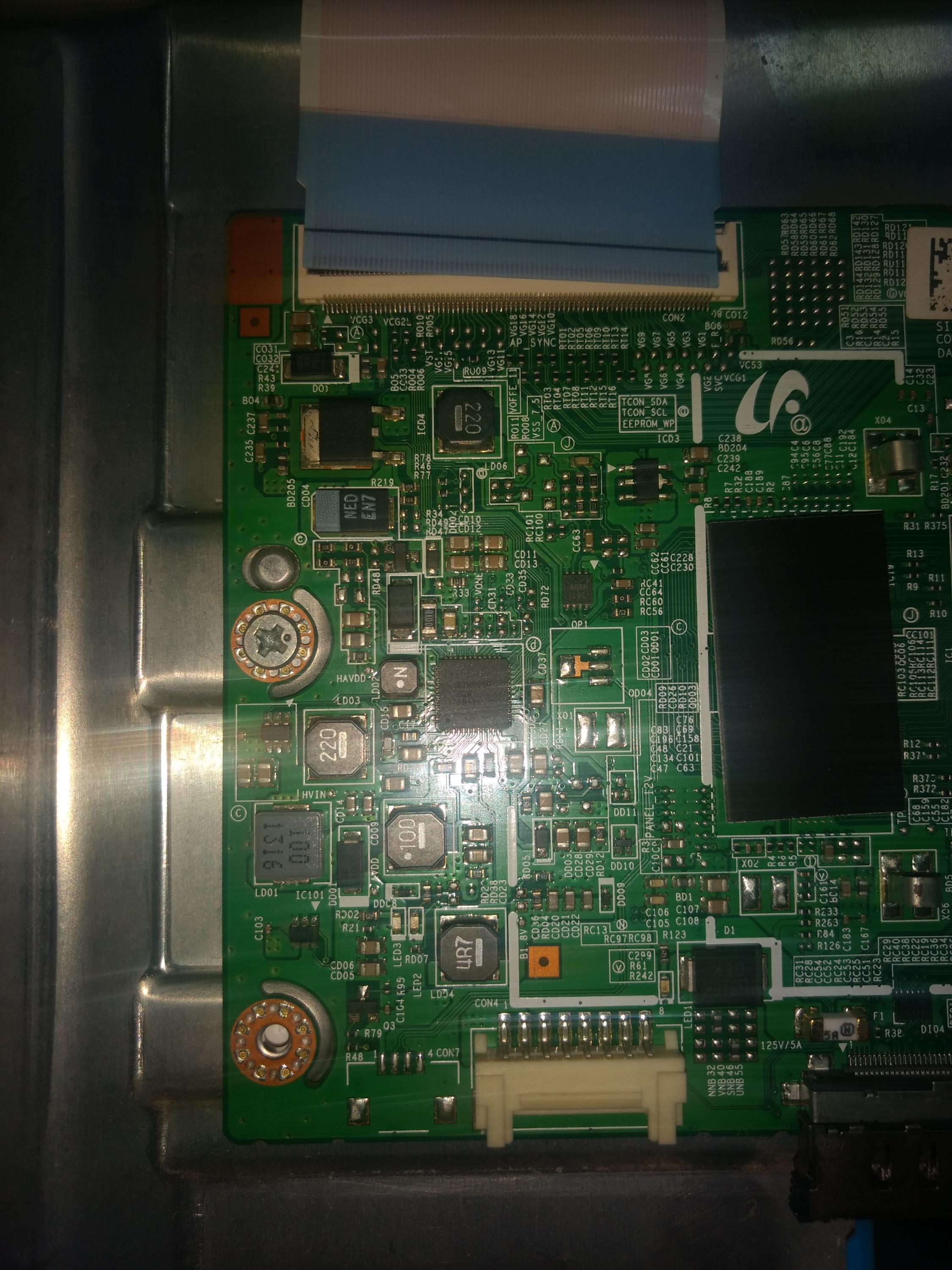

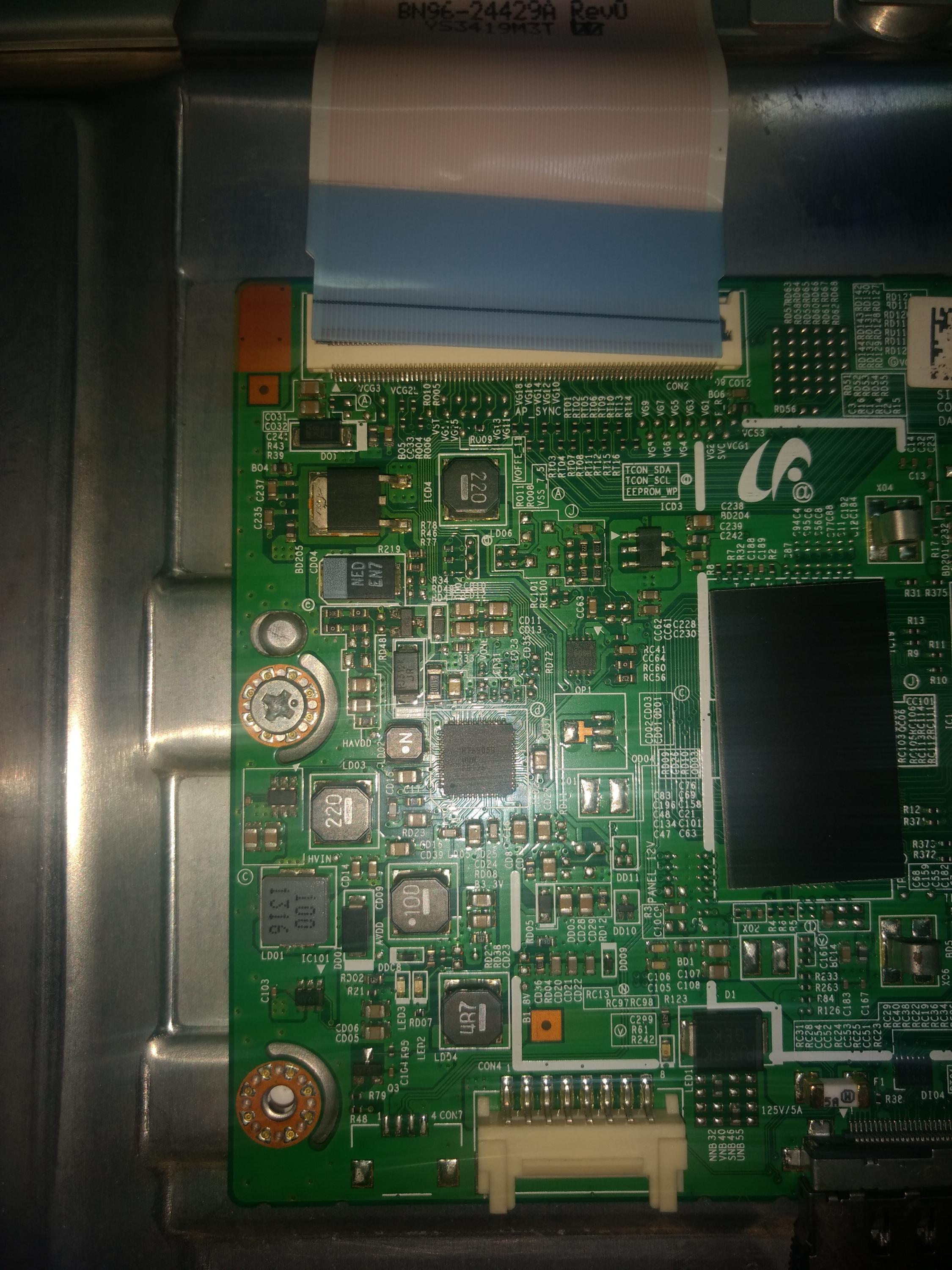

    I m aashik naik from Vadodara,India.

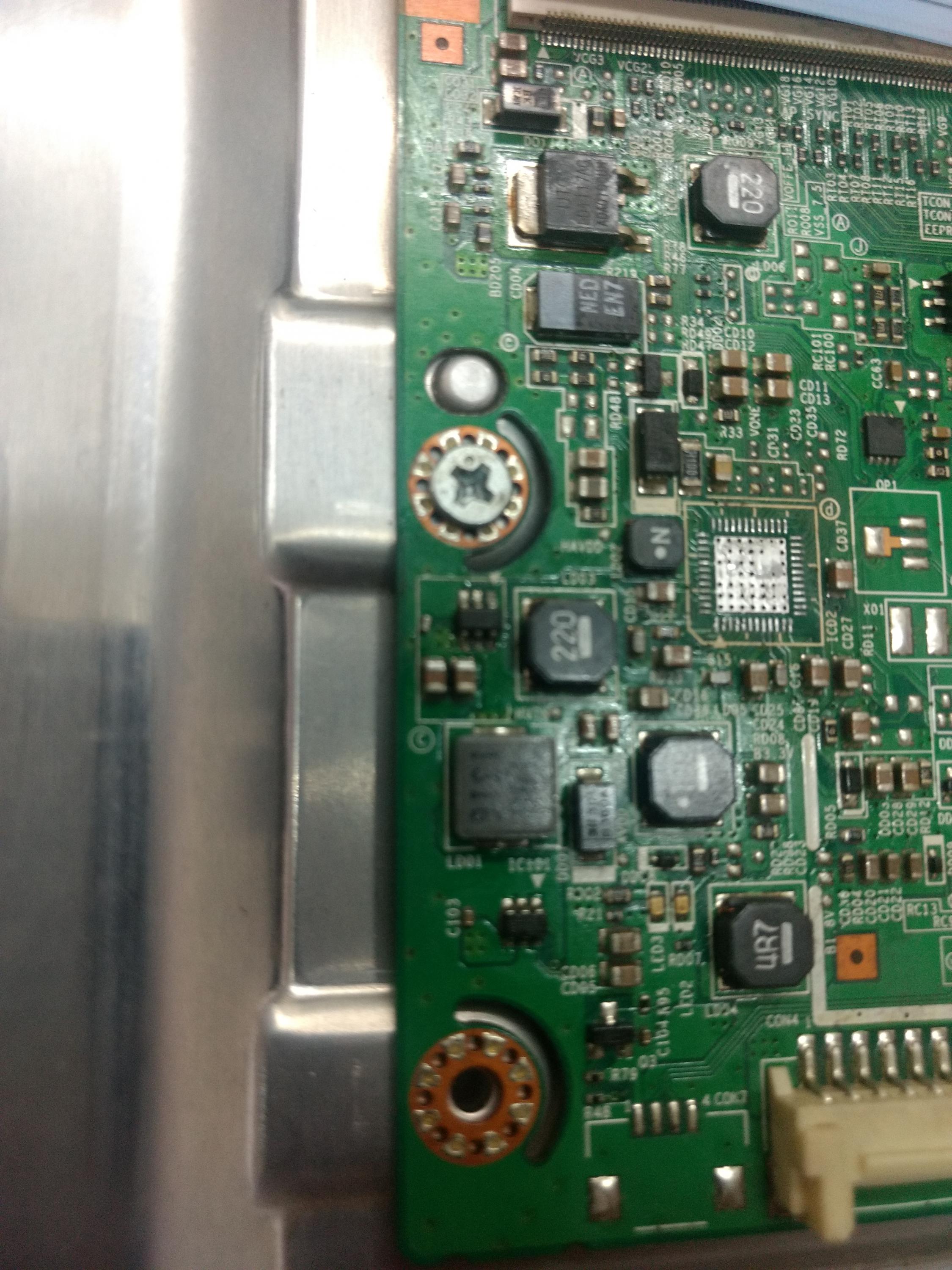

    I m facing problem of dark picture with my SAMSUNG UA40F7500 TV.
    The T con board is BN41-01939B.
    CN 98BN950 0963AL229 DS40892.
    Backlight working.
    Sound ok.
    If room lights are off then can see the dark image and able to select source from menu,all commands visible but too dark.
    Checked T-CON BOARD..
    T-CON input voltage as well as IC input voltages are 12.5 v which is correct.
    Here i have noticed less voltage at V ONE it is +10.2v i think it should be 27to 28v .
    Other voltages are.
    HVADD: 5 V
    AVDD: 10.1V
    HVIN: 10.3V
    VG1 : 9V
    VG2: 4V
    & SO ON
    3.3V is available.
    But all other voltages seems less.
    DC TO DC CONVERTER IC is RT6905B GQW.
    PIN 35 is giving V ONE 10.3 v dc output. which seems less as i told.
    Can anybody tell me that this can be resolved by changing ic ?
    Or anybody can guide what other thing i shall check?
    I bought another T CON board but that's having different ic and is little different.(ic-SM4152LA).With that as i thought the display brightness ok but picture double and color not ok and can't be used as replacement.But here i noticed that
    VONE 27.2V
    HVADD 8.2V
    AVDD 16.5V
    HVIN 12.5V
    VG1 16.3V
    VG2 14.2V
    to me it means bright picture can be achieved by getting these voltages are in this line.
    Request tech masters to help me.
    Snaps of T CON board 3 pics attached if it helps.
    Awaiting for your response,
    AASHIK NAIK

        With those voltages surely tcon is not working properly, i suggest you not to change the IC but inspect why you have an HVIN so low, it feeds current from tcon input supply voltage to the regulators, but between HVIN and VIN can be something wrong, for example a power switch like some i have seen, that switch feeds some panel voltages while VCore for processor and Vcc for memories are always present.
          Re: Ua40f7500 samsung tv dark picture
          This how RT6905 is being used, as you can see the HVIN is fed from switch MOSFET to supply 12V to run the IC.
          BTW, can we see the screen shot of what the pictures look like?
          Please also provide the pictures of the whole back side of the TV showing all the boards.

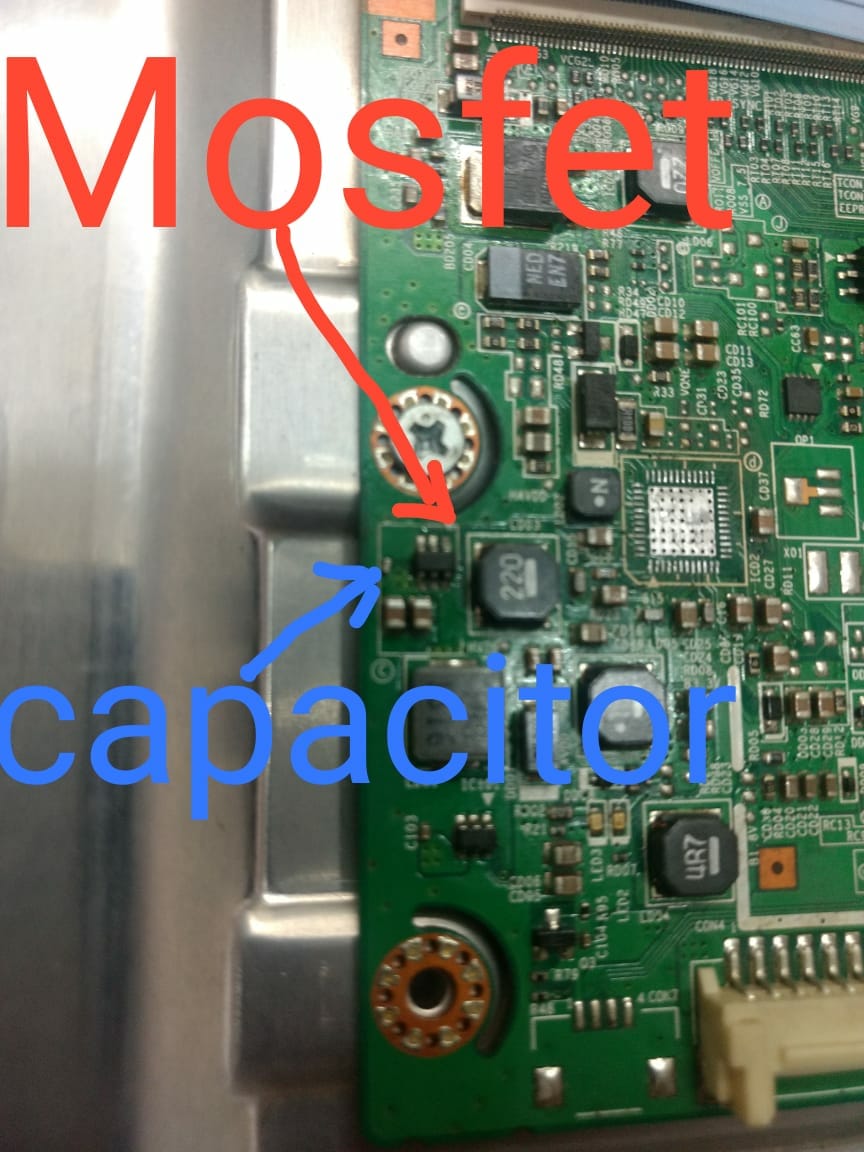

                  yes, you are right. MOSFET output comes to 10.43V @ 22u coil shown in RT9605 diagram which you have sent.
                  I have removed IC RT6905 before i show these posts.But it seems that the problem is with MOSFET or surrounding circuit.
                  AT source S it shows 12.6 V but at D it shows 10.43V.
                  At G it does not show any voltage. there is 1 resistor & 1 capacitor in series It doesn't show any voltage at resistor or gate but at capacitor input 12.5 v available.
                  WHAT VOLTAGES WE shall get @ gate as per opinion?
                  I will fix IC once i get 12v at HVIN.
                  Thanks,
                  AashikNaik

                    The voltage on gate terminal has to be negative respect to the drain. So change the mosfet or test it apart. I warn you that when tcon will be fixed you could have a bad surprise because even with a wrong tcon double image it's not normal..

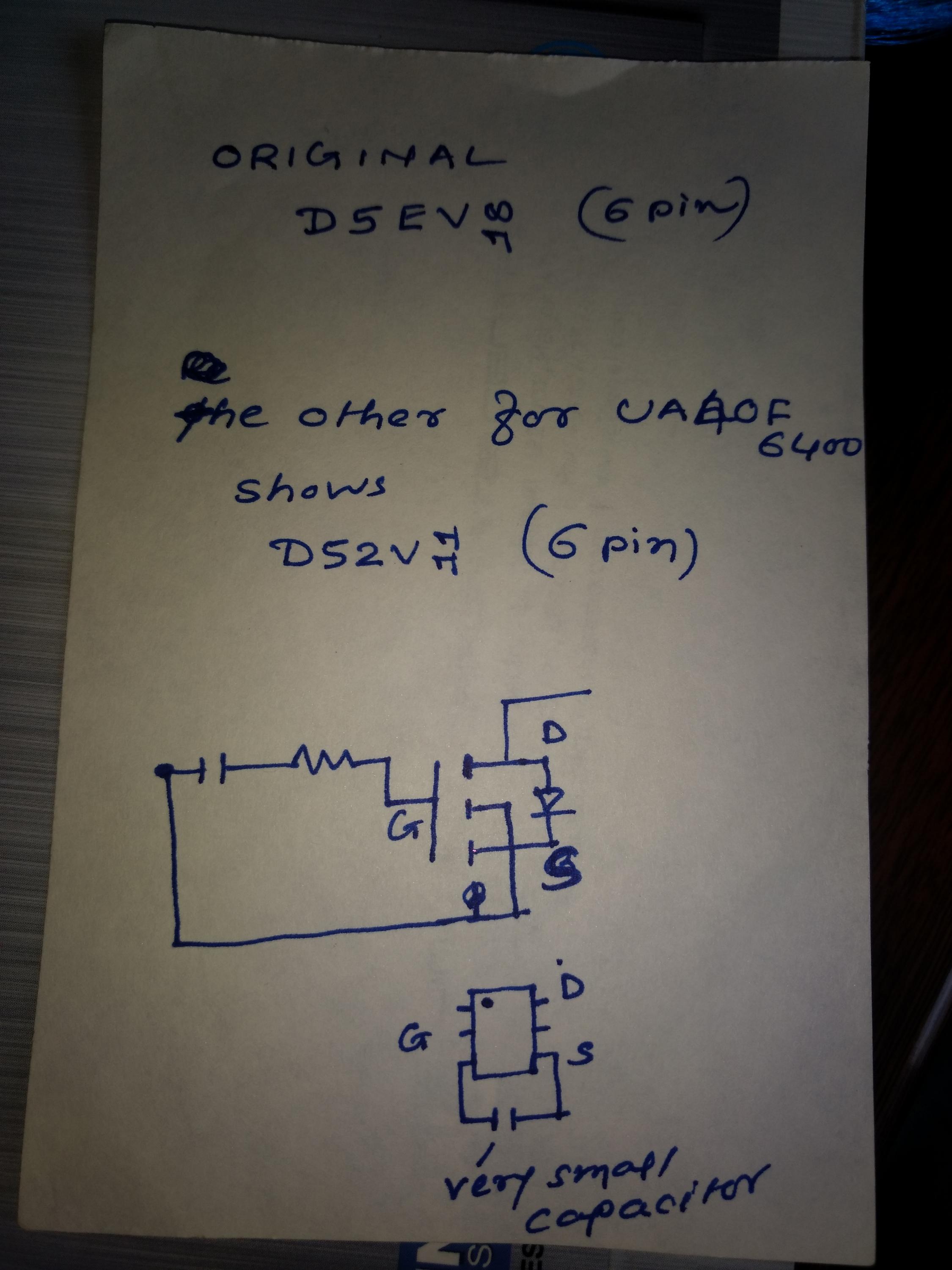

                      I tried one more t con of same pcb but of different model and got 2 images up and down section.But it was not dark as found in original t con.That T CON is suitable for UA40F6400.A very small capacitor is there between S and opposite terminal of 6 pin MOSFET.
                      The other T CON WHICH is suitable for UA40F6400 Model is giving 12.5v @hvin.
                      I tried to use MOSFET of that T CON but found no voltage at Drain.so, i replaced with original one. With original one i again got 10.43V.
                      Original MOSFET - D5EV. & the other one having MOSFET D52V.
                      How to get this MOSFET? Can i replace the original with the other one?
                      Thanks for your replies
                        So what is the designator of the MOSFET for the swithced HV12V, Q???
                        Can I see the pictures of that area where that MOSFET is?
                        The GATE of that MOSFET should be driven by the RT IC via GD pin as shown in the diagram that you are using as the guide, Q109 is the reference as shown in the diagram.
                          As i searched for D5 in s-manuals it shows PNP & NPN Digital transistor.
                          The images attached but the IC is removed.
                          • aashiknaik
                            • Sep 2018
                            • 11
                            • India
                            marked what i assumed.
                            As per your post Gate voltages shall be supplied by RT6905 GD point i think first i should fix IC
