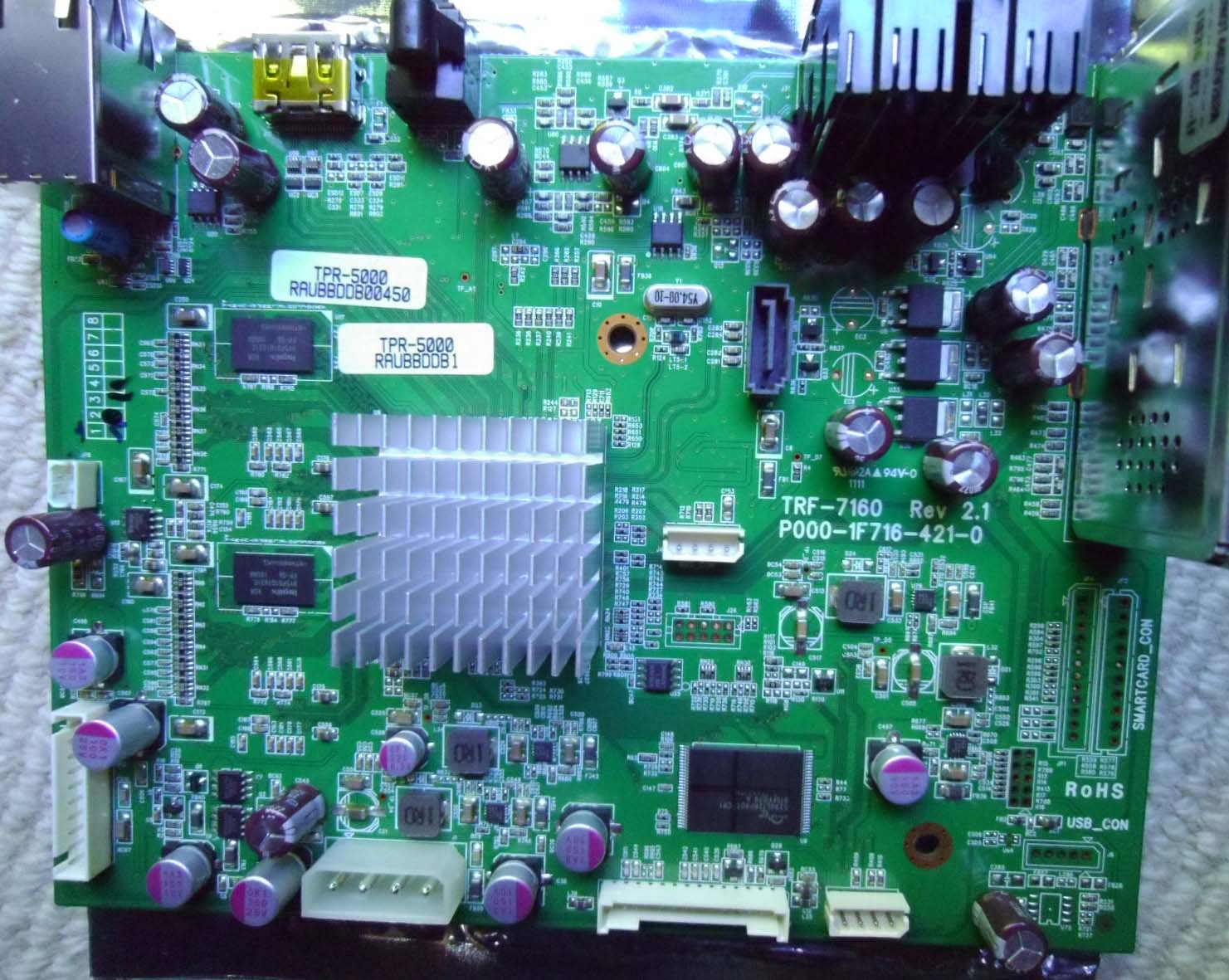

    Notorious "Service not running or scrambled" problem has gone from intermittent to hard on my Toppro TPR-5000 PVR
    So I opened it up to check out capacitors
    Seeing all electrolytics were 85° rated, I replaced most with known 105° Japanese, before running out of replacements
    Left the others alone, assuming they're reliable polymers
    Also left alone the visually OK Samwha electrolytics in the power supply
    Gave it a try at that point, still "Service not running or scrambled"
    TV has no problem with reception, getting signal from TPR-5000's Antenna Out - also no problem if I simply plug Antenna In and Antenna Out cables together, instead of both into PVR
    Next effort was resolder all connections from tuner module (marked DNOT44QZV262A) to mainboard
    Easier said than done - whatever lead-free solder was used by manufacturer, it sure is difficult to melt
    After that, I had reception
    Satisfaction didn't last long - a day later, "Service not running or scrambled"
    So what do I do now?
    Give in to planned obsolescence and buy another PVR?
    Or think about replacing tuner module? - are these even available?

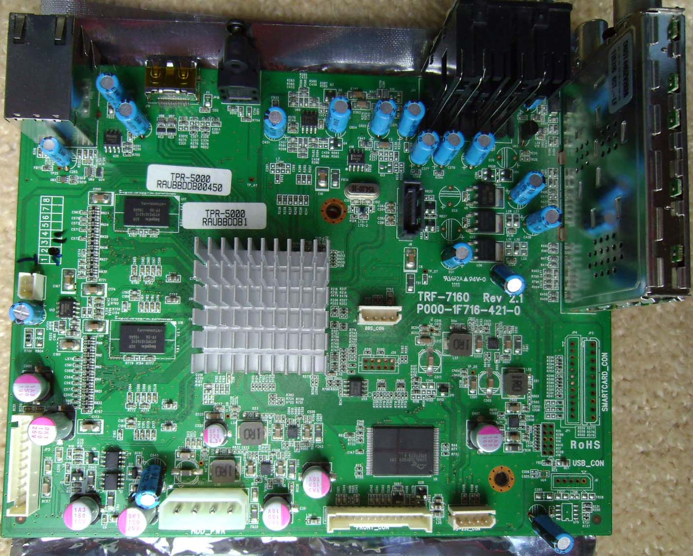

    Here's completed electrolytic recap - Chemicon KY all around
    Also recapped come of the Samwha in its power supply after seeing a tip on a Topfield (=Toppro) forum
    Then disappointed, although not surprised, still "Service not running or scrambled"

      Re: Toppro TPR-5000 PVR - TRF-7160 mainboard
      probably more bad caps inside the tuner module?
        I tried unsuccessfully to remove the tuner module - 40 soldered connections, plus another 6 fixing legs of its cover to main board
        So replacement's not an option for me, even if spare part was available
        After that, I unclipped cover in situ, just enough to see inside
        No sign of any caps, just a solitary QFP IC
        Anyway, moot point now, I bought another PVR today
