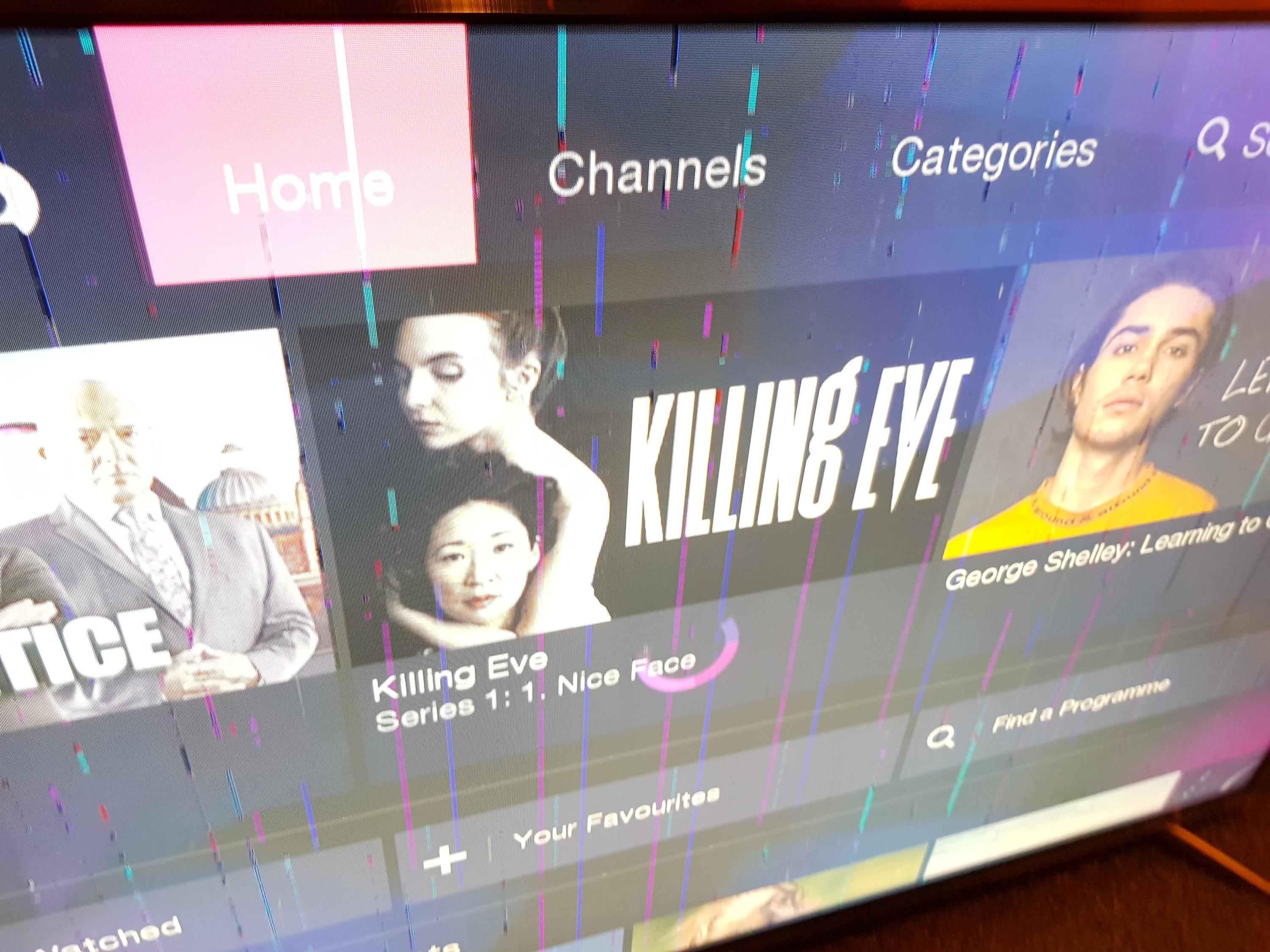

      Re: Samsung UE55F6800SB
      Yes hopefully they can !!
      The test card picture i can not see any lines hoping this will be a menu issue or software problem ?
      • ronhayes
        TV Engineer
        • Mar 2014
        • 458
        #103
        I am thinking this is maybe a ribbon connection issue ?
        And as these lines are across the the whole screen I think it is the ribbon from main board to T-con.
        The only way for me to find out is to try a replacement one.

                If I'm not mistaken, from the video you posted i recall those blurred vertical blue lines weren't there
                Therefore either you introduced the problem by dis aligning the ribbons or the replacement T-CON board did
                  in the video ive just re watched the lines are their more sparkly type lines though but certainly there so maybe this is a different issue?
                    Yes it seems they are there but look more sparkly.
                    I have also checked the ribbons and they look correctly seated.

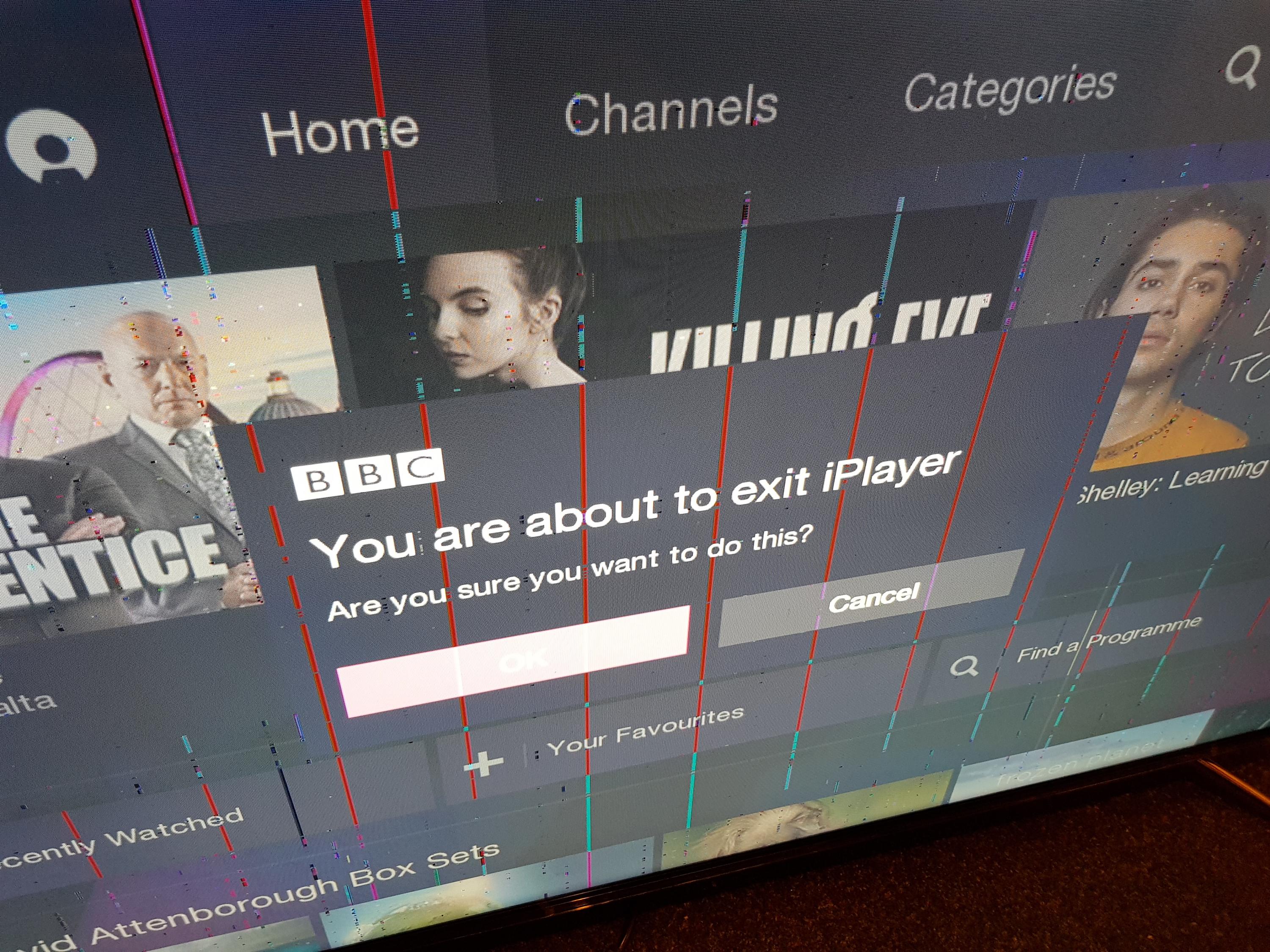

                          Also, to me it they appear to be just (or mainly) blue, and static (as if with memory, i.e. if the image changes they will move).
                          Do you confirm?
                            No as when i first had set it was always doing the off/on booting but for short while on looked like sparkly' s on screen.
                            I have took a couple more pictures of darker screen and lines are more prominent in these pictures seeing blue and red.
                            I really think this is from P/S board maybe a faulty cap don't think main board as i have tried both main boards.
                            Thinking of changing caps in the power supply .
                              Originally posted by ronhayes
                              Thinking of changing caps in the power supply.
                              imo, if they were random and sparkly only, then it might point to the PSU;
                              But they form a distinct vertical path and therefore PSU caps are not the first, neither a likely, approach!
                              Furthermore, with static saturated color test pattern (20181004_122653.jpg) they aren't (much) visible.
                              Therefore it's either the T-CON, the ribbons from the T-CON to the display, or, in the worst case scenario, the display itself.

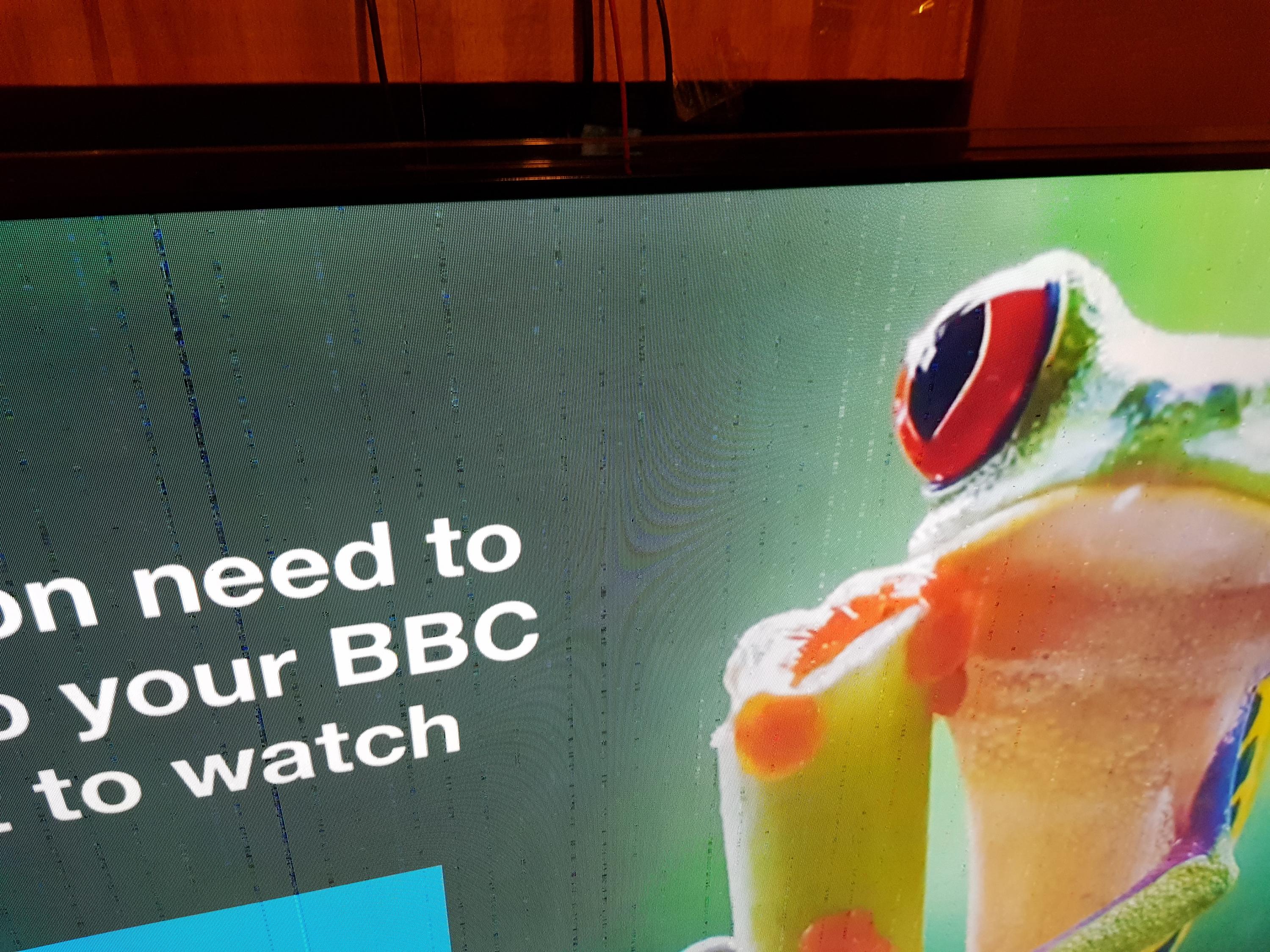

                                I suspect the replacement T- con because the first wrong T-con you put in did not cause the vertical streaks like you are seeing on the screen right now with the correct board.
                                  Nice catch @budm... very assertive
                                  Also comes to my mind that quite often LCD TVs have an option on the secret hidden service menu to set the LCD panel, from a panel list (with Samsung and Sony TVs i've confirmed).
                                  Thus i think you should first check it out
                                    EDIT ! please ignore this i was looking at the wrong pictures,
                                    in pictures three and four post 75 showing the wrong t con fitted, it still has the sparkly type lines though its a odd fault ive not seen before.

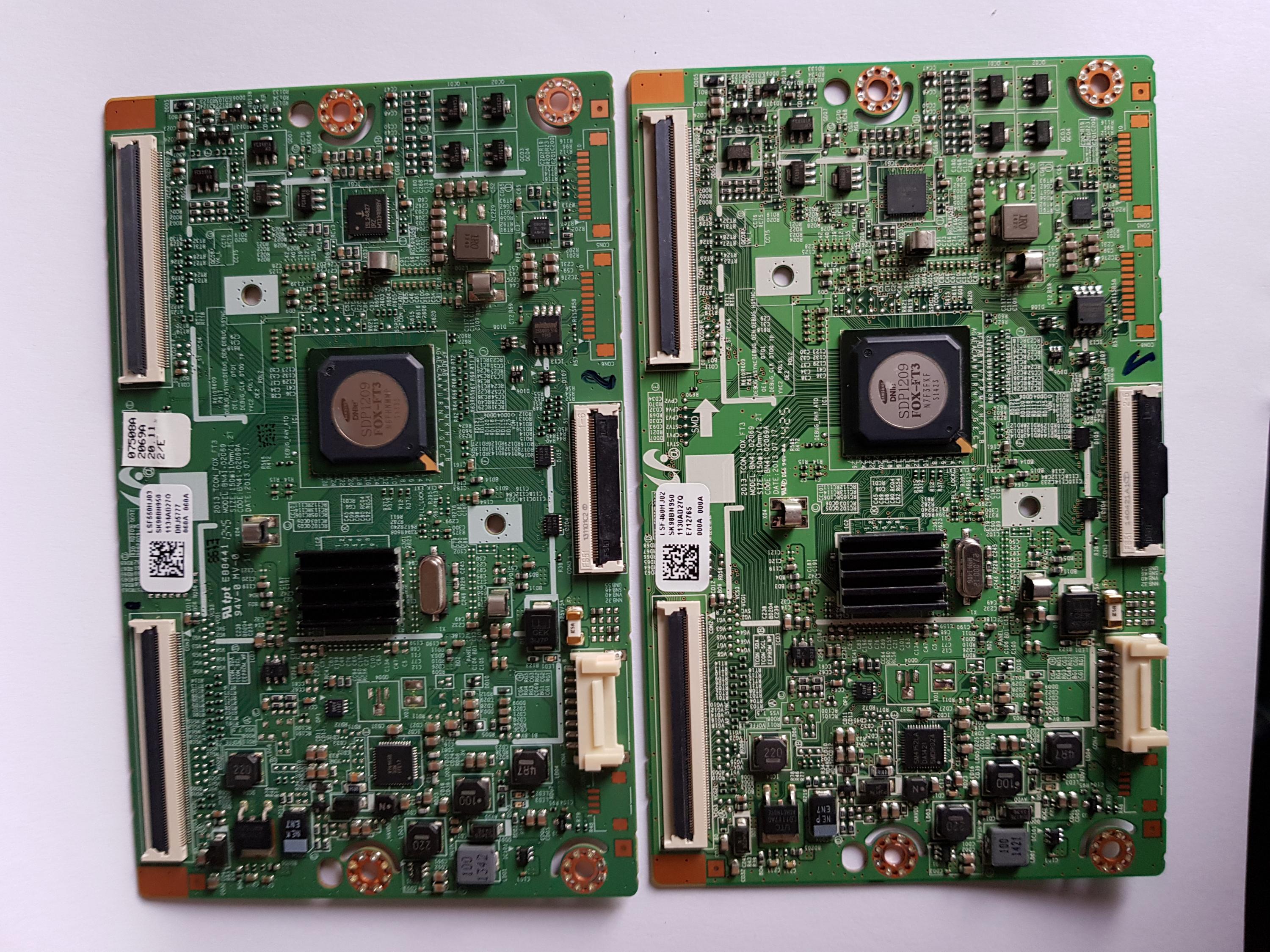

                                      Thank you budm,megaraider
                                      When you say check it out do you mean go into this secret hidden menu and try other panel settings?
                                      If so how do i do this ?
                                      And would i set the panel as a 46" to see if picture is clear with the 46 T-Con board ?
                                      Or should i find another T-Con board if possible ?
                                      I have included a picture of both my faulty 55" and the wrong 46" T-Con's as you can see they look identical apart from the numbers on the SDP1209 processor .
                                      Would swopping these processors over maybe repair my faulty T-Con board ?
                                      And is there anyone who could do this ?
