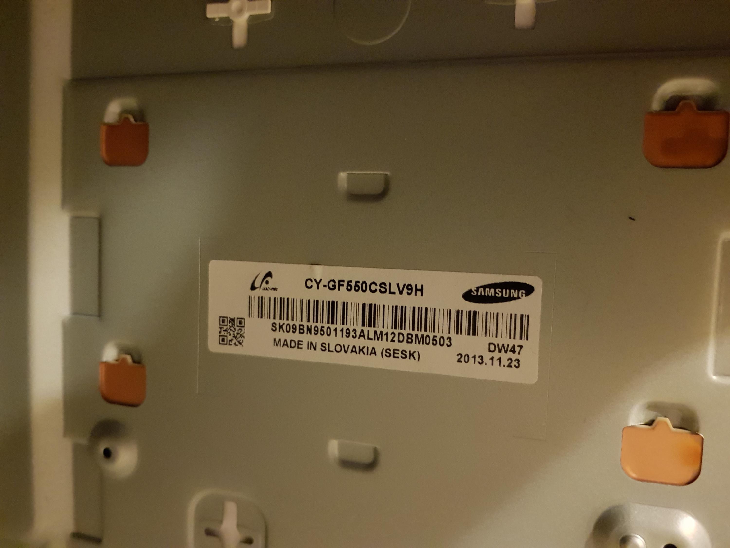

    This is the label on the LCD panel
    • ronhayes
      TV Engineer
      • Mar 2014
      • 458
      #82
      Re: Samsung UE55F6800SB
      Yes UE55F6800SBXXU
        #83
        Samsung P/N for your panel is BN95-01193A.

                cy-gf550cslv9h is this the correct lcd panel number? im on my phone so hard to see

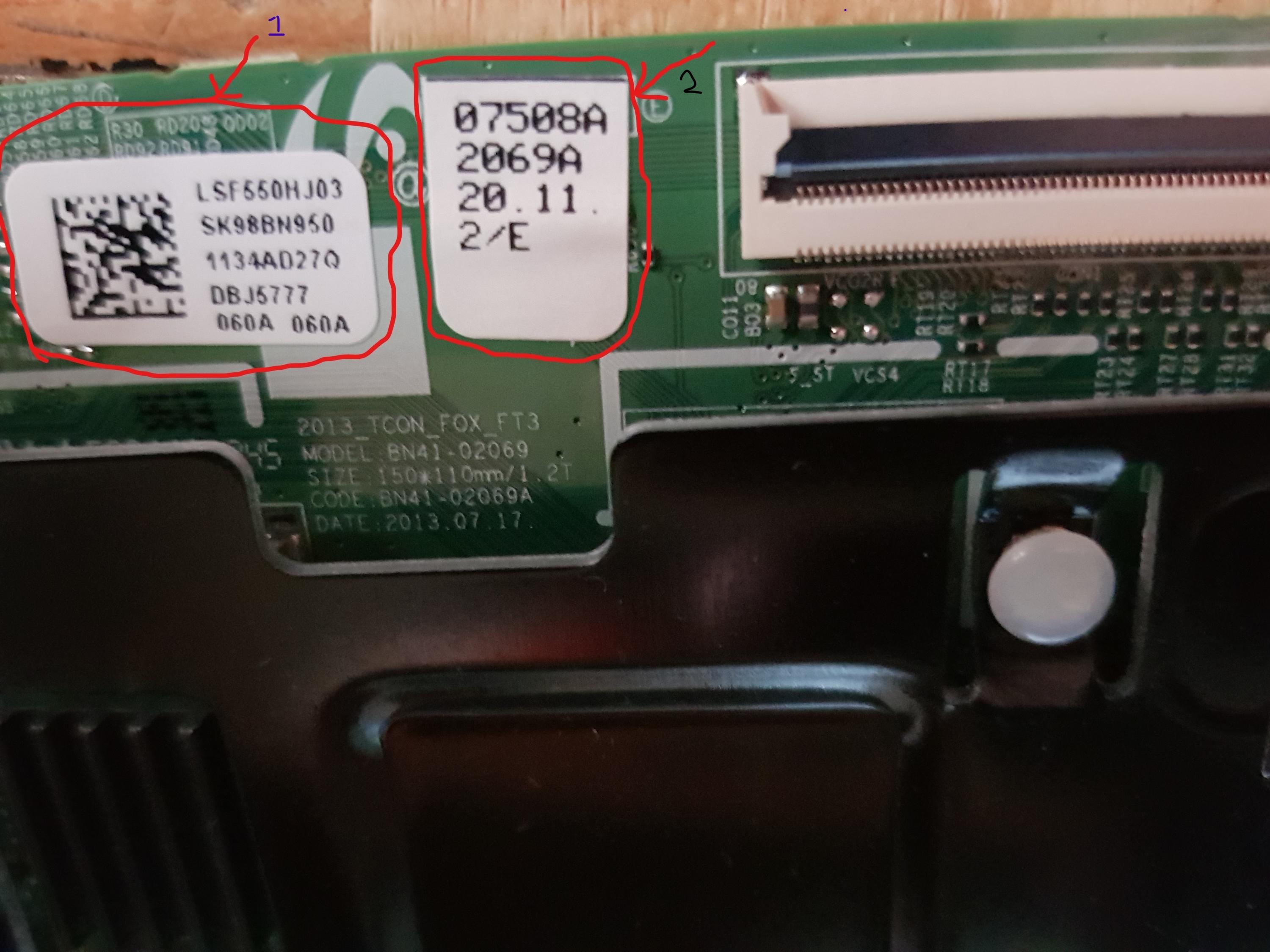

                • ronhayes
                  TV Engineer
                  • Mar 2014
                  • 458
                  #88
                  zomi thank you i have contacted one of them just waiting for a reply the other one listed with emos i had contacted them a couple of days ago they did not have one in stock.
                  Vince sorry late getting back to you went to collect some medicine .

                      #90
                      budm
                      You said that the T-Con board i required was BN95-01193A.
                      But on the label of my T-Con the BD number is BN95-01134A.
                      Do you think that may be this had been changed in the past and the wrong board fitted? or is this number compatible ?
                      • ronhayes
                        TV Engineer
                        • Mar 2014
                        • 458
                        #91
                        I apologize to any one if i appear to be pushy with this repair but i am due to go in hospital early November for 4 weeks for my stem cell transplant and will be very poorly for a few months so wanted to sort it out hopefully before then .
                          #92
                          Originally posted by ronhayes
                          budm
                          https://www.badcaps.net/forum/attach...5&d=1538434946
                          Your panel P/N is BN95-01193A as you can see in your picture of the LCD panel sticker.
                          https://www.badcaps.net/forum/attach...9&d=1538484737
                          T-CON board P/N is BN95-01134A as shown in your picture.

                            #93
                            Sorry budm
                            Thought you were saying i needed BN95-01193A p/n for my T-Con board.
                            Some times i don't see the wood for the trees silly me
                              #94
                              Thank you for that info i have phoned them they do not have one in stock and when i explained the issue and that when i tried another board the TV stayed on but with my board it was tripping even when ribbons to lcd panel removed either both or one at a time and did not reboot loop with ribbon from main board disconnected . I told him i had tried another board although not the right one he agreed it does appear to be a T-Con board fault, They had not had to carry out that fault before but if all failed i could send it to them and they would have a look. But he said if i clicked on notify me when in stock they have a good turn over and it would stand a good chance with in a week but no promises .
                              You need to ask them if BN95-01134A is the correct P/N as printed on the sticker, also show them the pictures of the board.

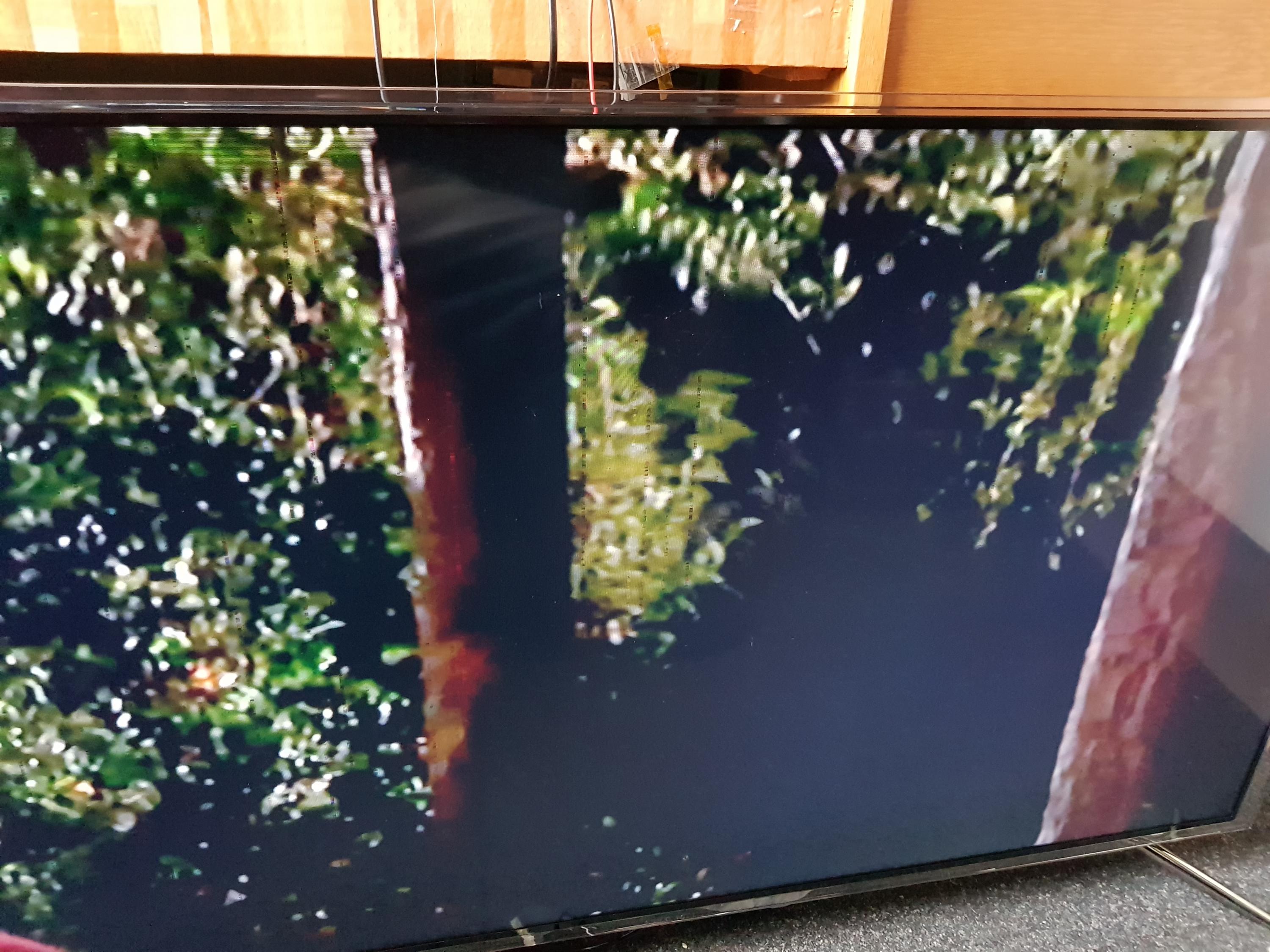

                                    #97

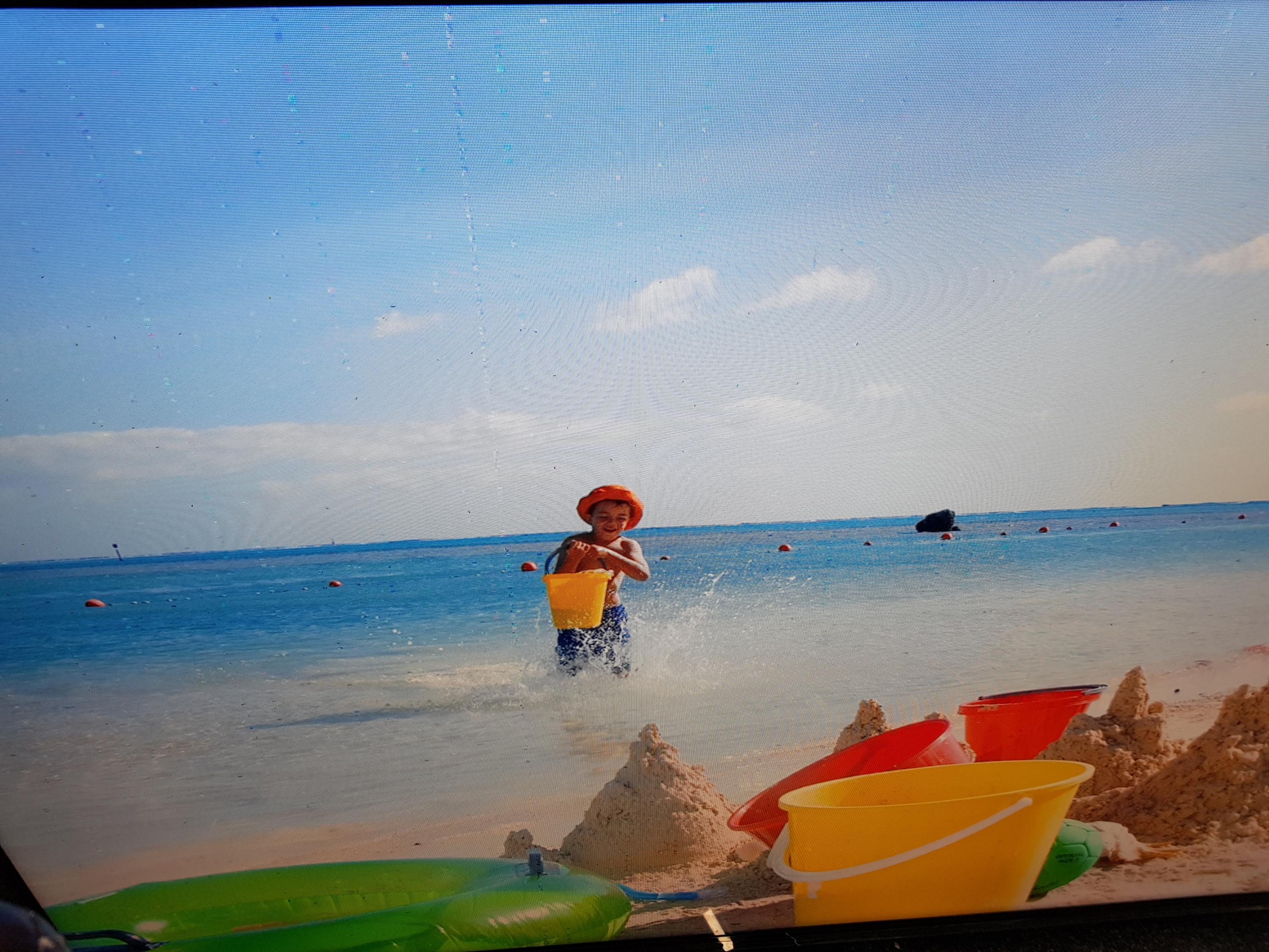

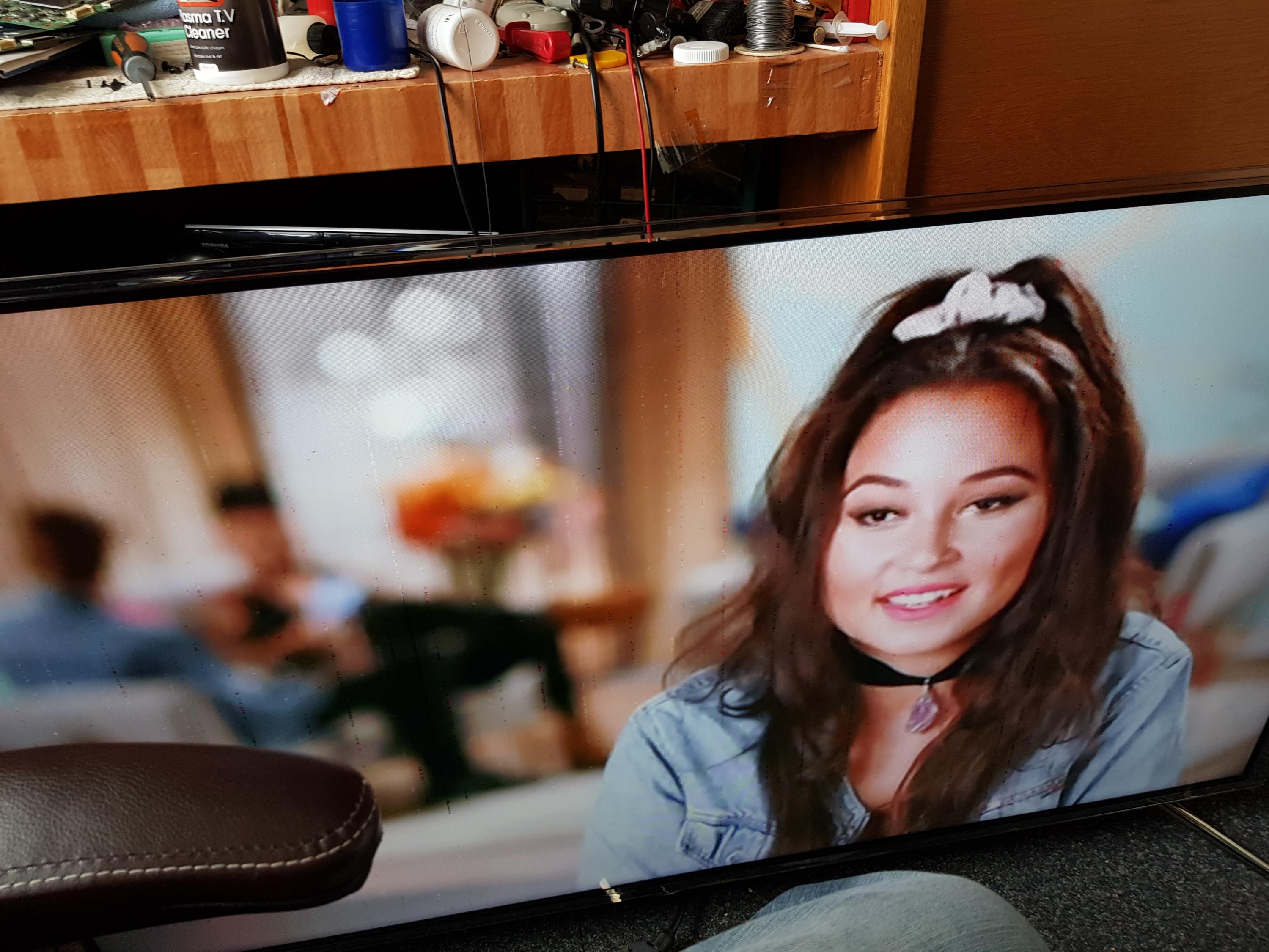

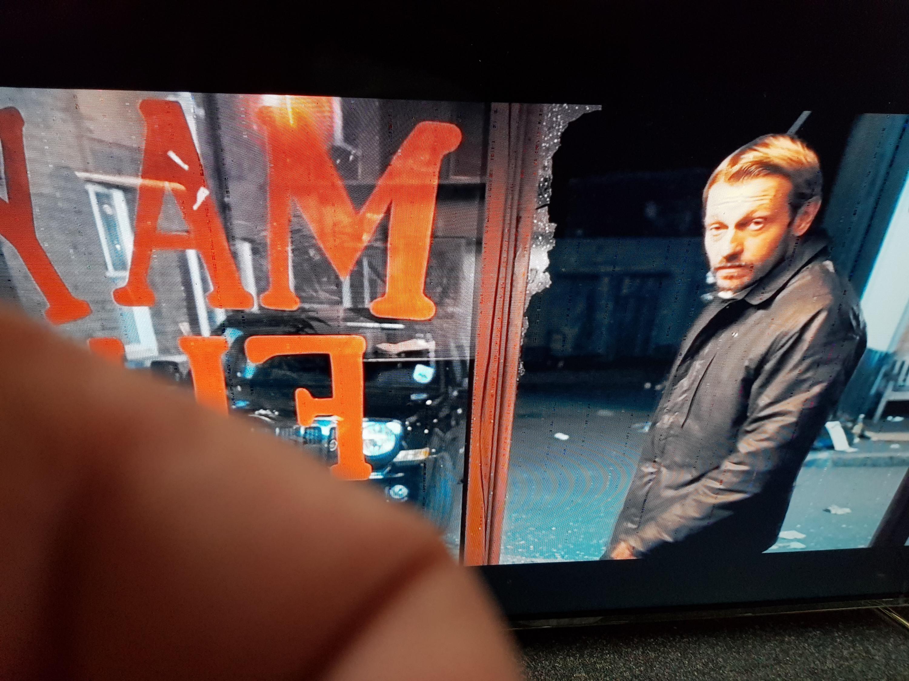

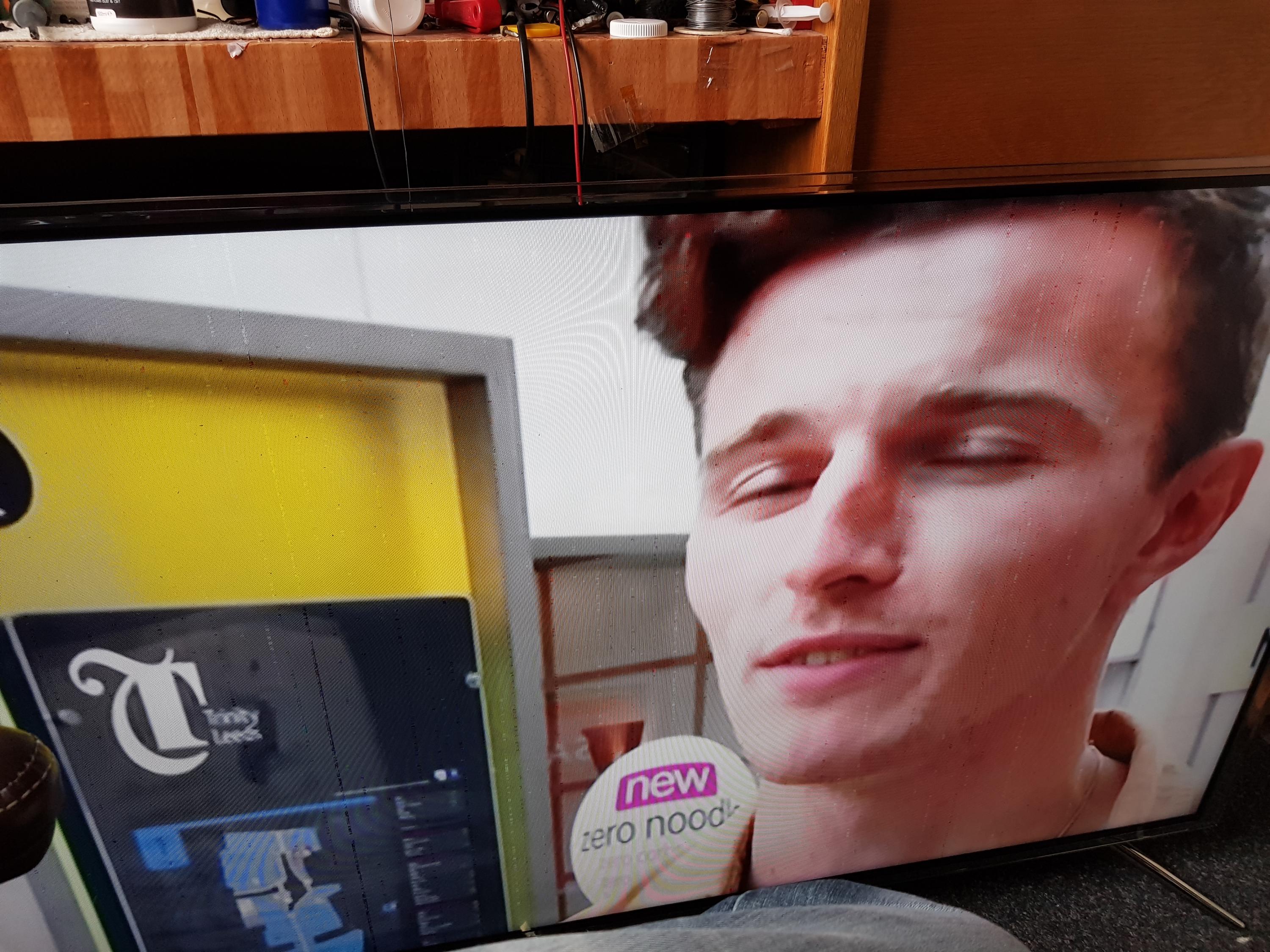

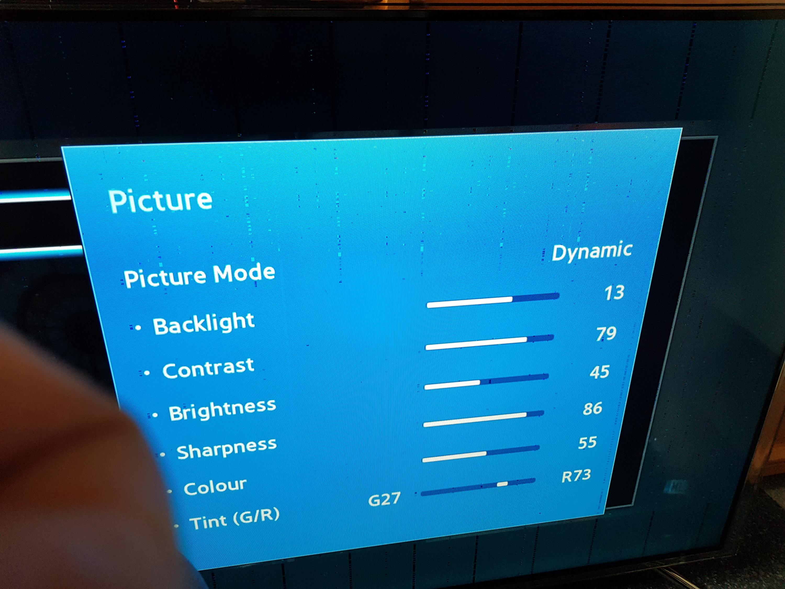

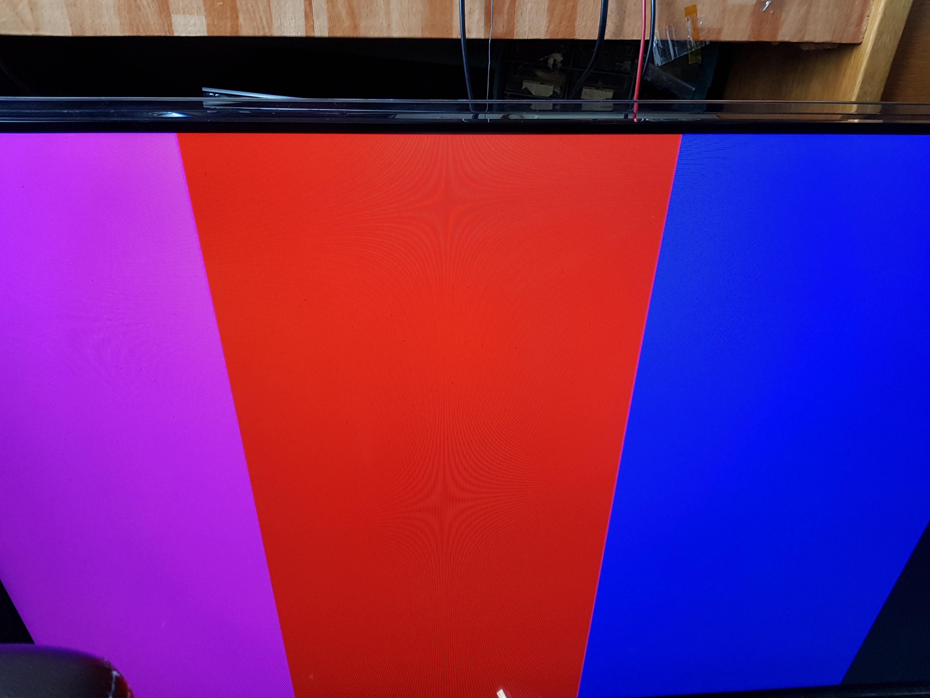

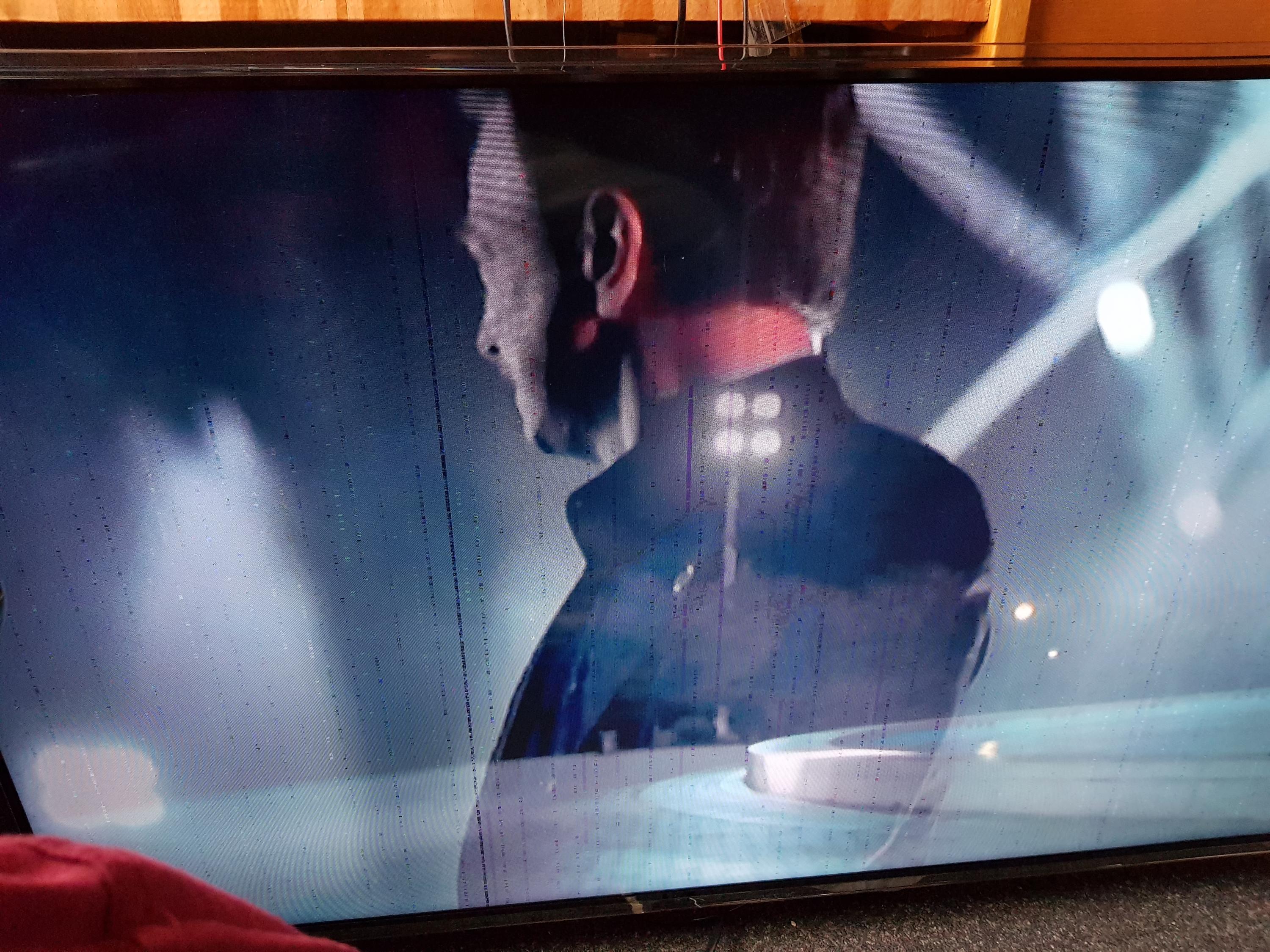

                                    Morning vince and all

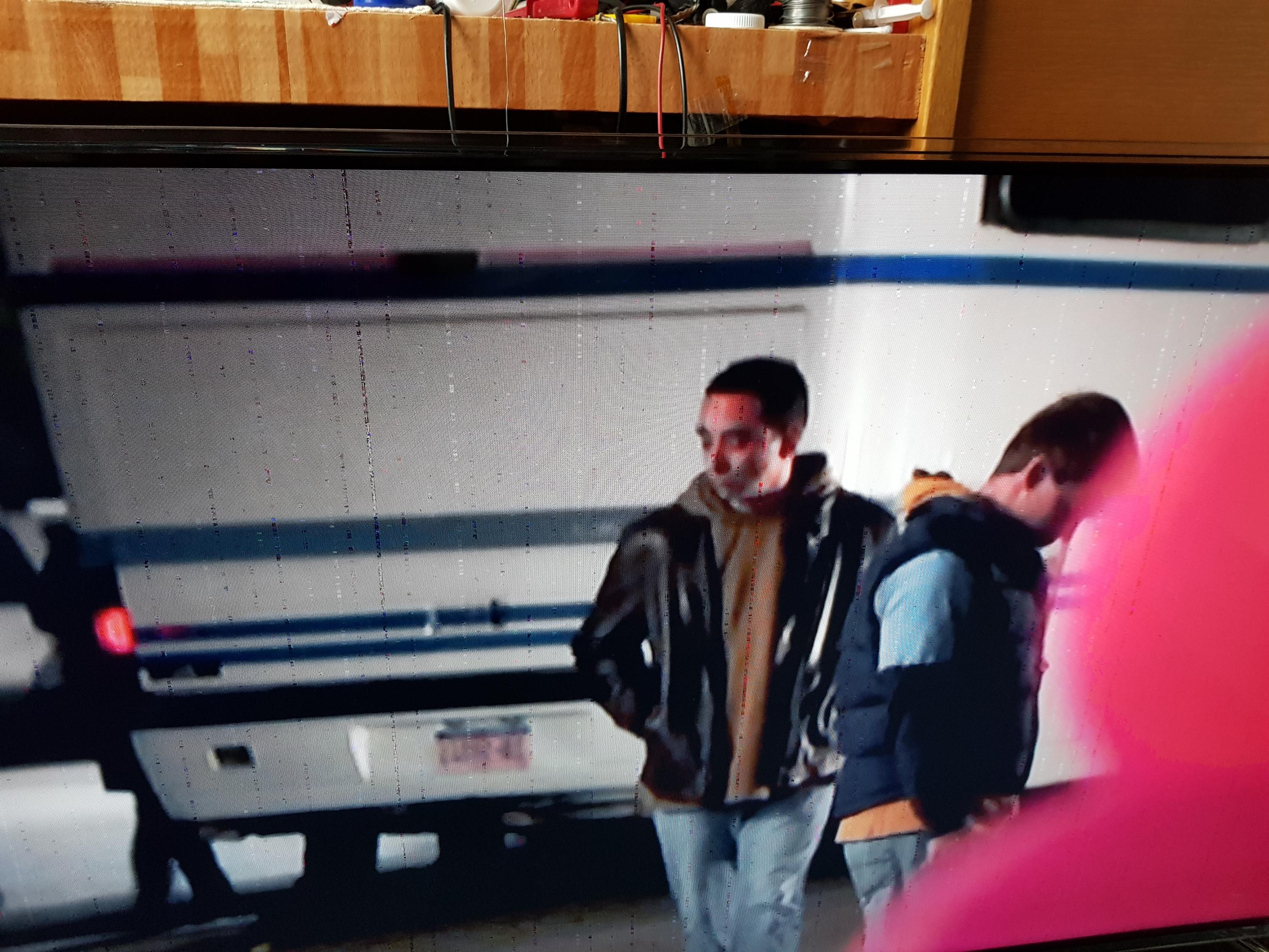

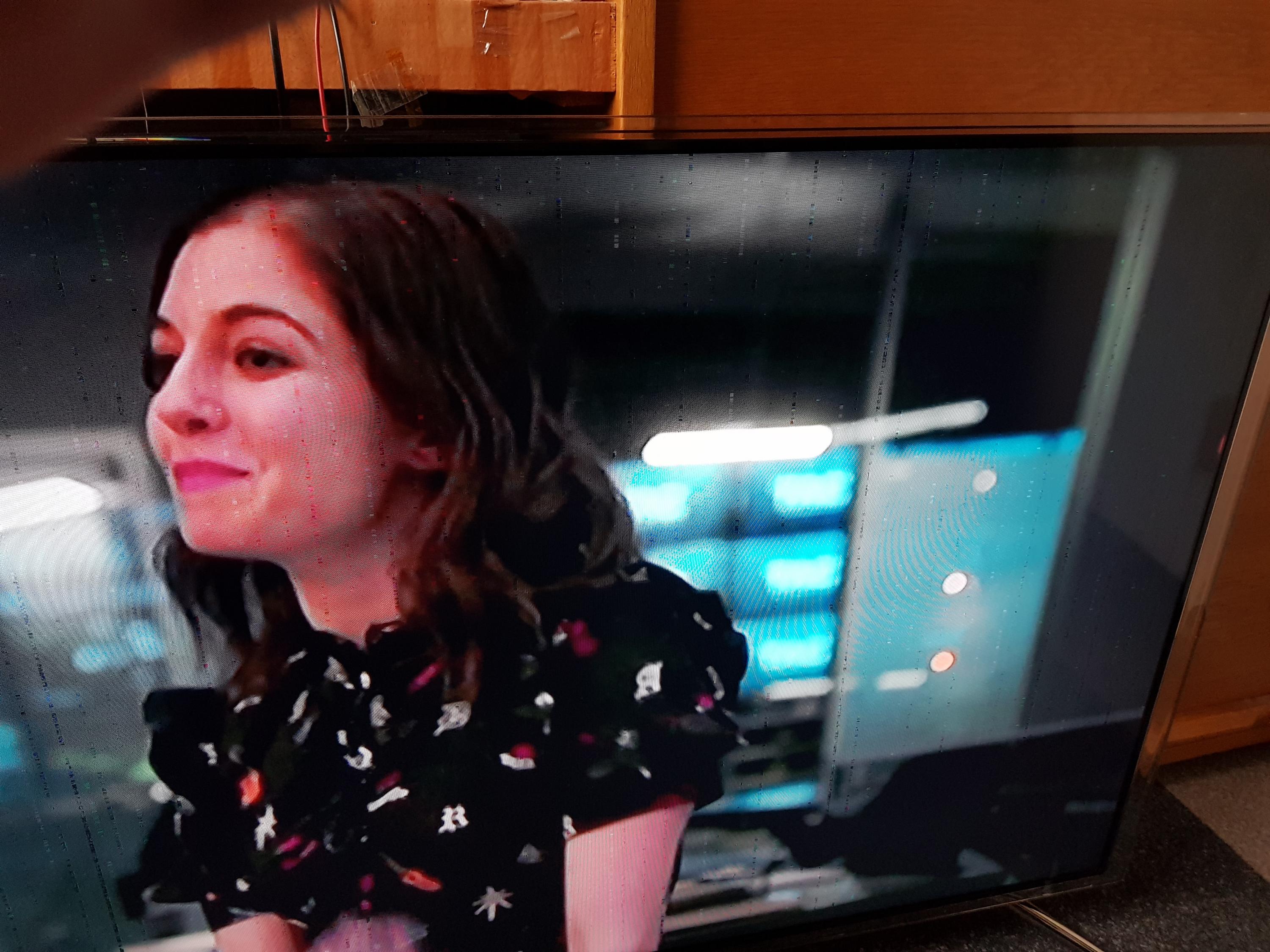

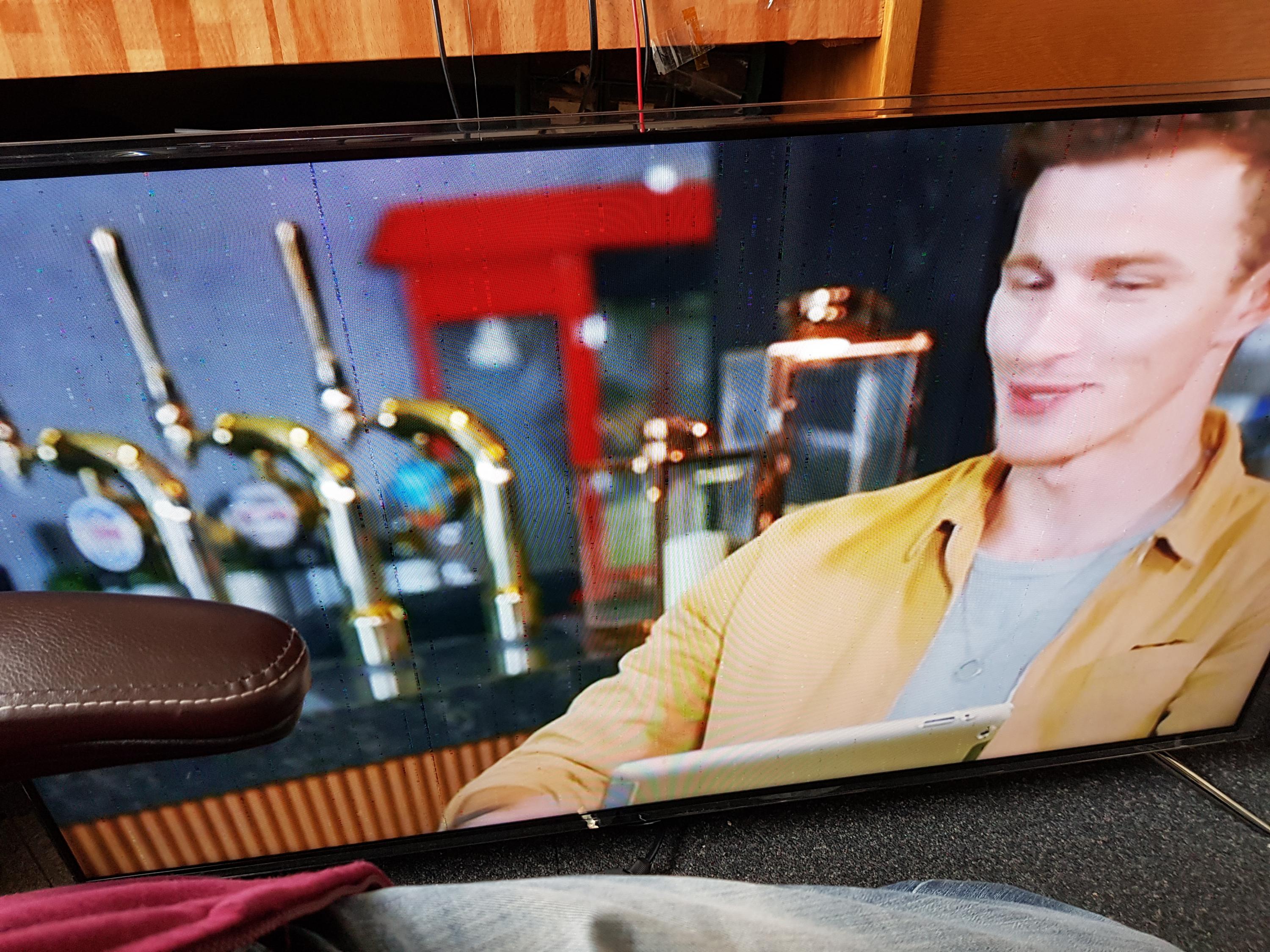

                                    Update for this TV i managed to locate a T-Con with the same numbers as mine
                                    LSF550H J03 BN95-01134A. From Spares2Repairs for £24.00.

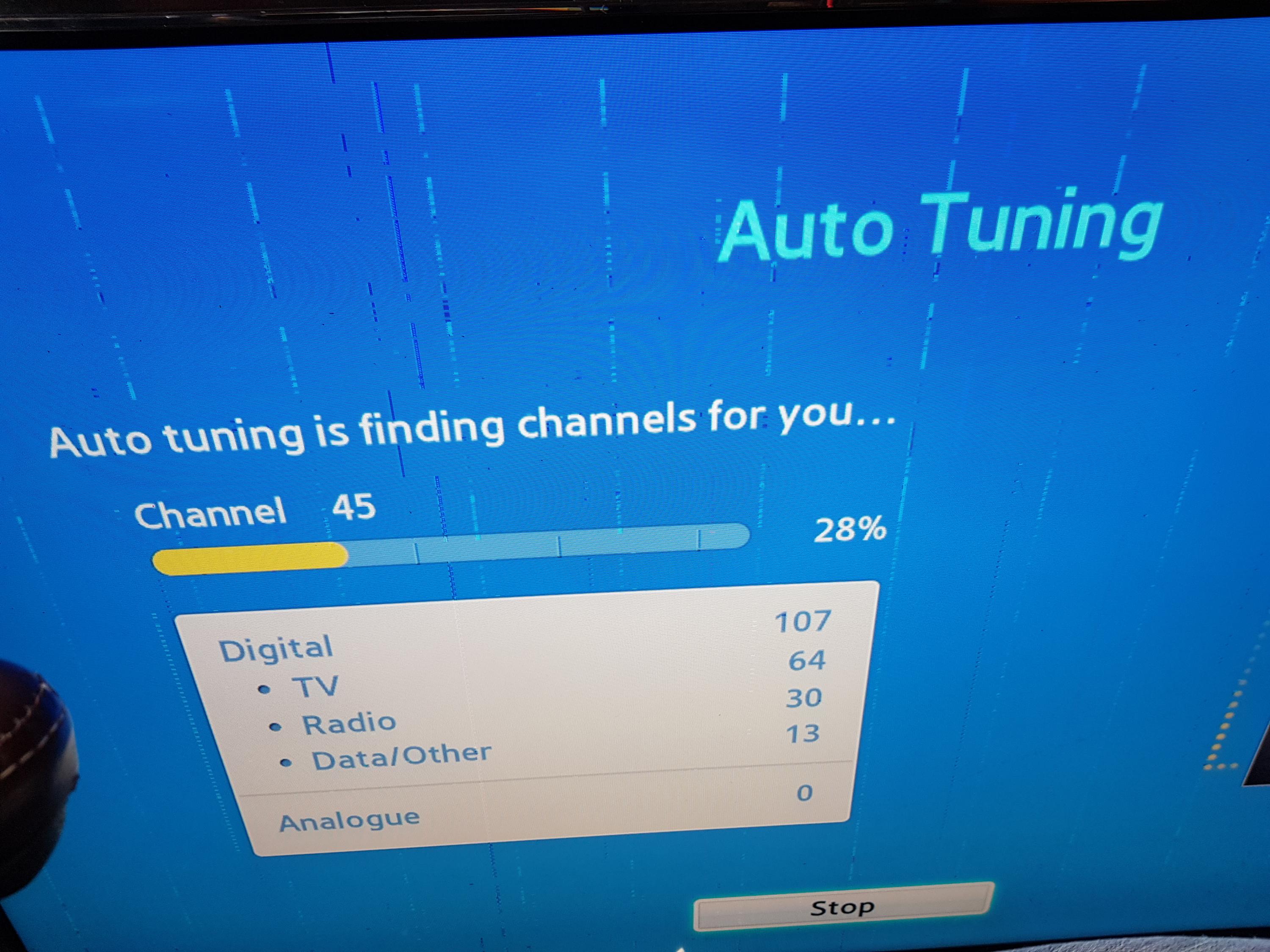

                                    Now the TV comes on in St/By when you press power button on remote and it stays on, it does not go off/on repeatedly as it did with my original T-Con.
                                    But i still have a issue with the picture as you will see from the photo's included.
                                    I have carried out all tuning to the TV and have even connected it to the internet and all works fine.
                                    The picture is a nice picture as you can see in the photo's but for these lines more prominent on a lighter screen. I have tried altering the settings in display menu but can not loose the lines ?
                                    Does any one have any idea what is causing this issue ?
                                    Or maybe i need to go into a service menu to set it up ? any ideas would be much appreciated.

                                      #98
                                      I have now changed back to my original AV main board to see if that would give me any better results ?
                                      But still the same ?
                                      • vinceroger69
                                        • Mar 2012
                                        • 6714
                                        • uk
                                        #99
                                        thats a odd fault maybe check/clean the cables going from the mainboard to tcon and also the ribbon cables going too the panel pcb from the tcon. I wonder what that tcon board fix on ebay i sent you the link for, does that fix solve the lines issues? maybe worth messaging that person and include a picture for them too see.Now you see that both mainboards are working ok you could probably re sell one if you wanted too get some money back.

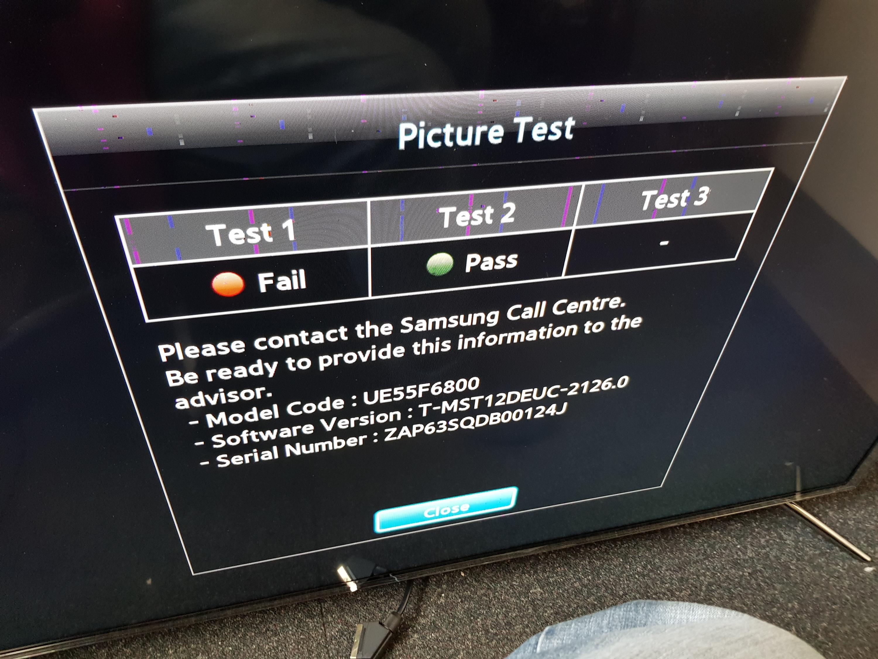

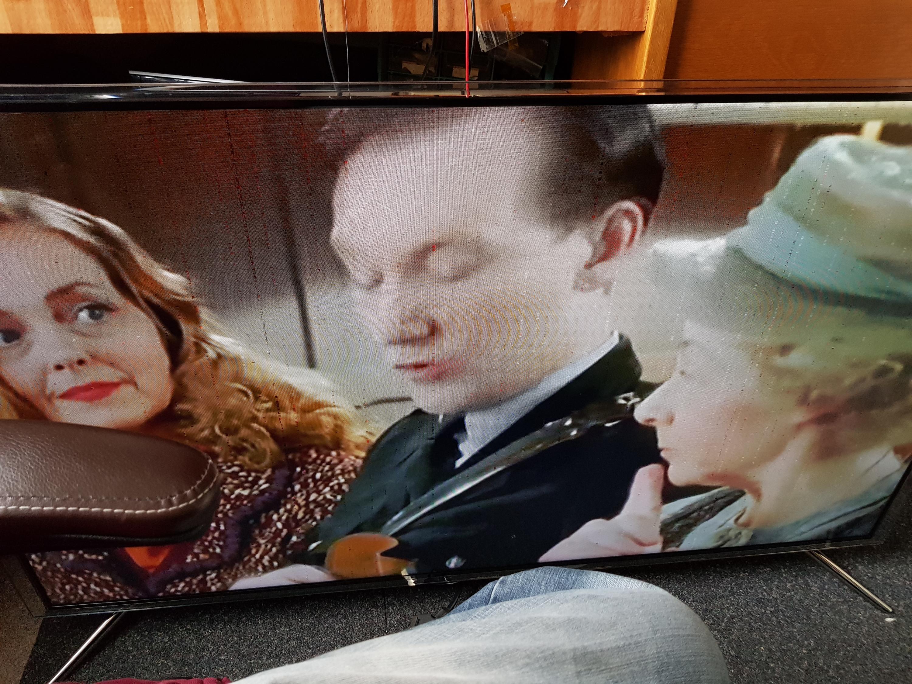

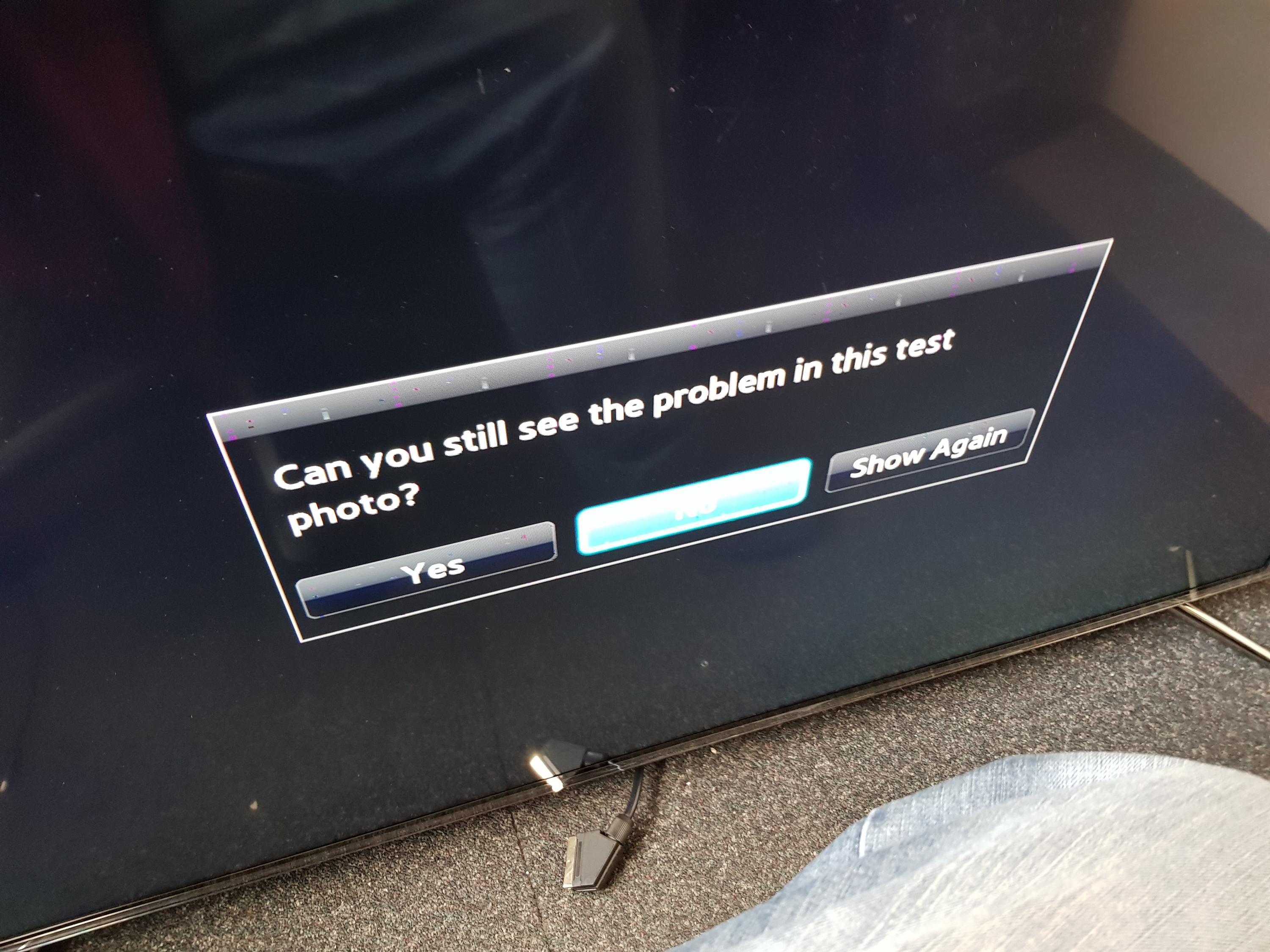

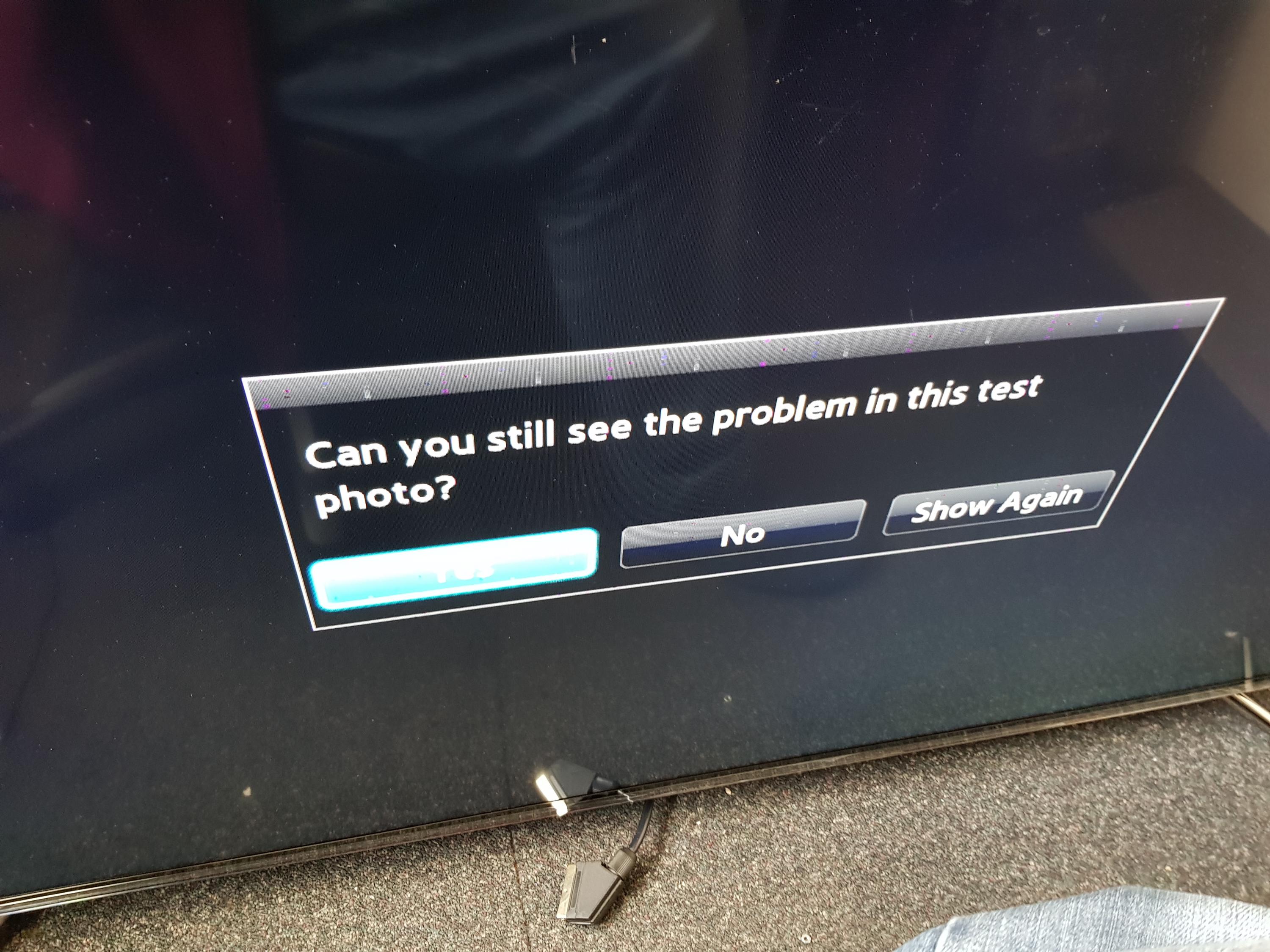

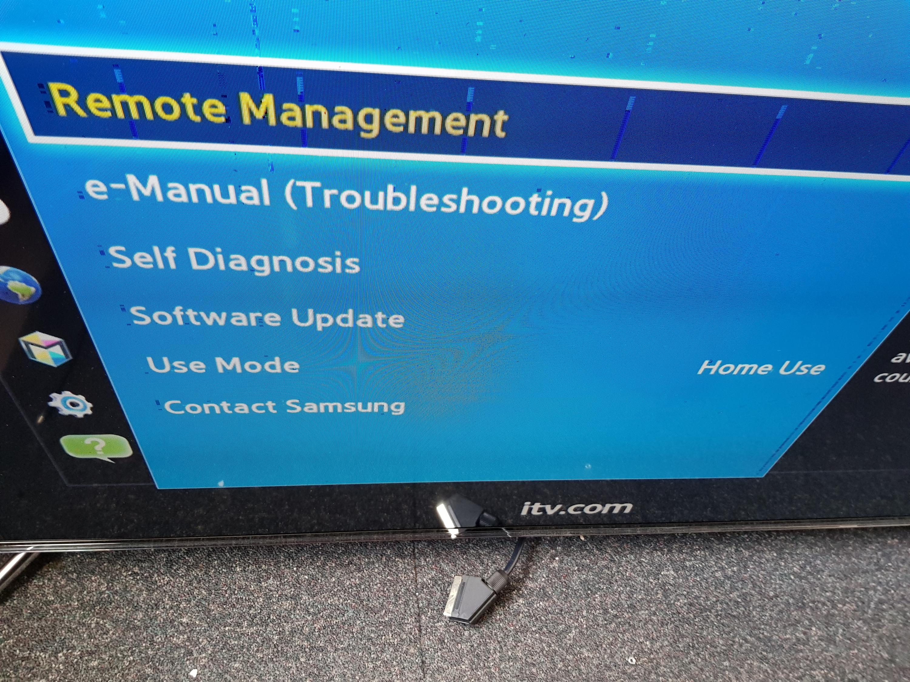

                                          #100

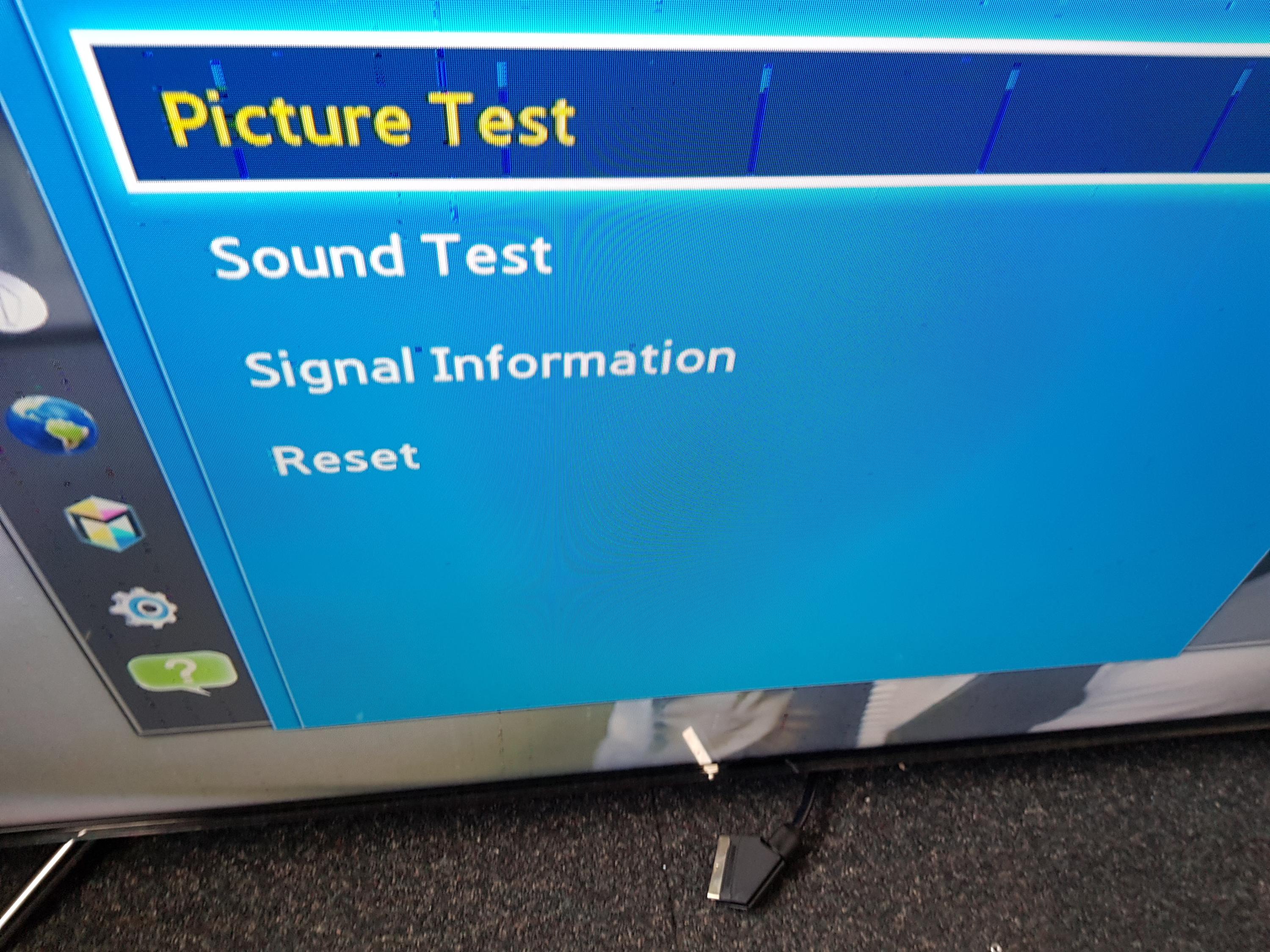

                                          I have just gone into a self diagnostic menu where you can carry out a test on picture ,sound etc.
                                          Take a look at these photo's and see what you think. I think the photo display still shows the lines but the colour pattern test looks to be better display ?
                                          Who agrees? I answered yes to the first question (can you still see the problem in this test photo ) And then answered no to the next question fort displaying the test card (can you still see the problem in this test photo )
                                          Then it displays a screen saying please contact the Samsung call centre .
