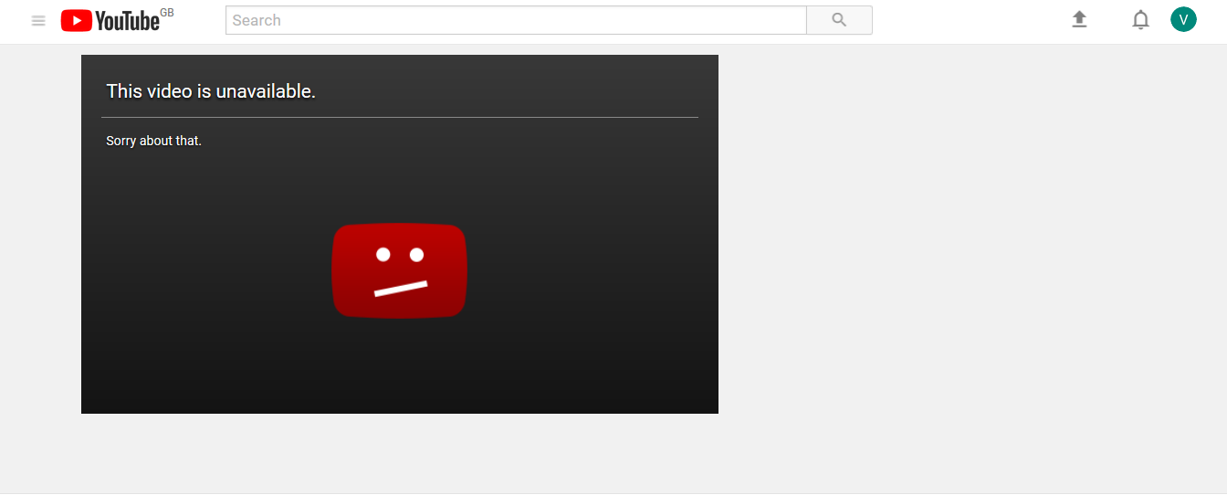

                              #54
                              Re: Samsung UE55F6800SB
                              Hope this works.
                              The picture was better quality when it was on its stand and with outer casing on.
                              https://youtu.be/QVlZxXMVn9Q
                              • ronhayes
                                TV Engineer
                                • Mar 2014
                                • 458
                                #55
                                If any one can tell me what they think ?
                                But i am thinking it is the T-Con board that maybe at fault.
                                I do appreciate what Zombi is saying that it looks like a main board issue . But what i do find strange is that a replacement main board is giving the exact same fault , surely there are many faults that can happen but the exact same fault !! I am not convinced.
                                • ronhayes
                                  TV Engineer
                                  • Mar 2014
                                  • 458
                                  #56
                                  megaraider
                                  I have not used my analog meter in a long time ?
                                  And my oscilloscope is a really old one not sure if it still works ?
                                  • vinceroger69
                                    • Mar 2012
                                    • 6714
                                    • uk
                                    #57
                                    Originally posted by ronhayes
                                    Hope this works.
                                    ron the youtube link isnt working just says video unavailable?
                                    • ronhayes
                                      TV Engineer
                                      • Mar 2014
                                      • 458
                                      #58
                                      Vince
                                      I have just clicked on it in the post and it opens and plays for me ?
                                      • vinceroger69
                                        • Mar 2012
                                        • 6714
                                        • uk
                                        #59
                                        check the settings and make sure its set to public as you may have it set so only you can view it.
                                        • ronhayes
                                          TV Engineer
                                          • Mar 2014
                                          • 458
                                          #60
                                          See if that works Vince.
