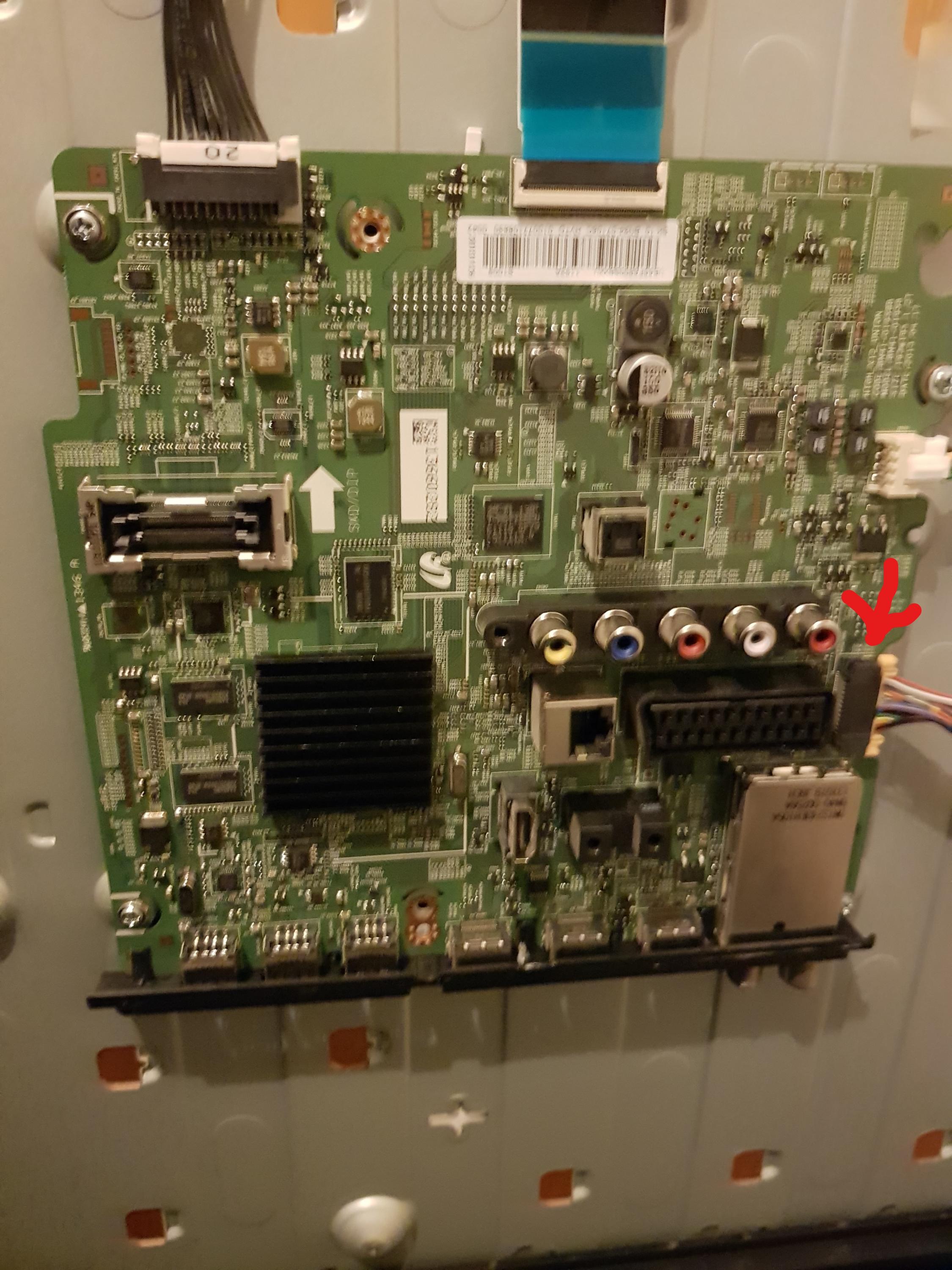

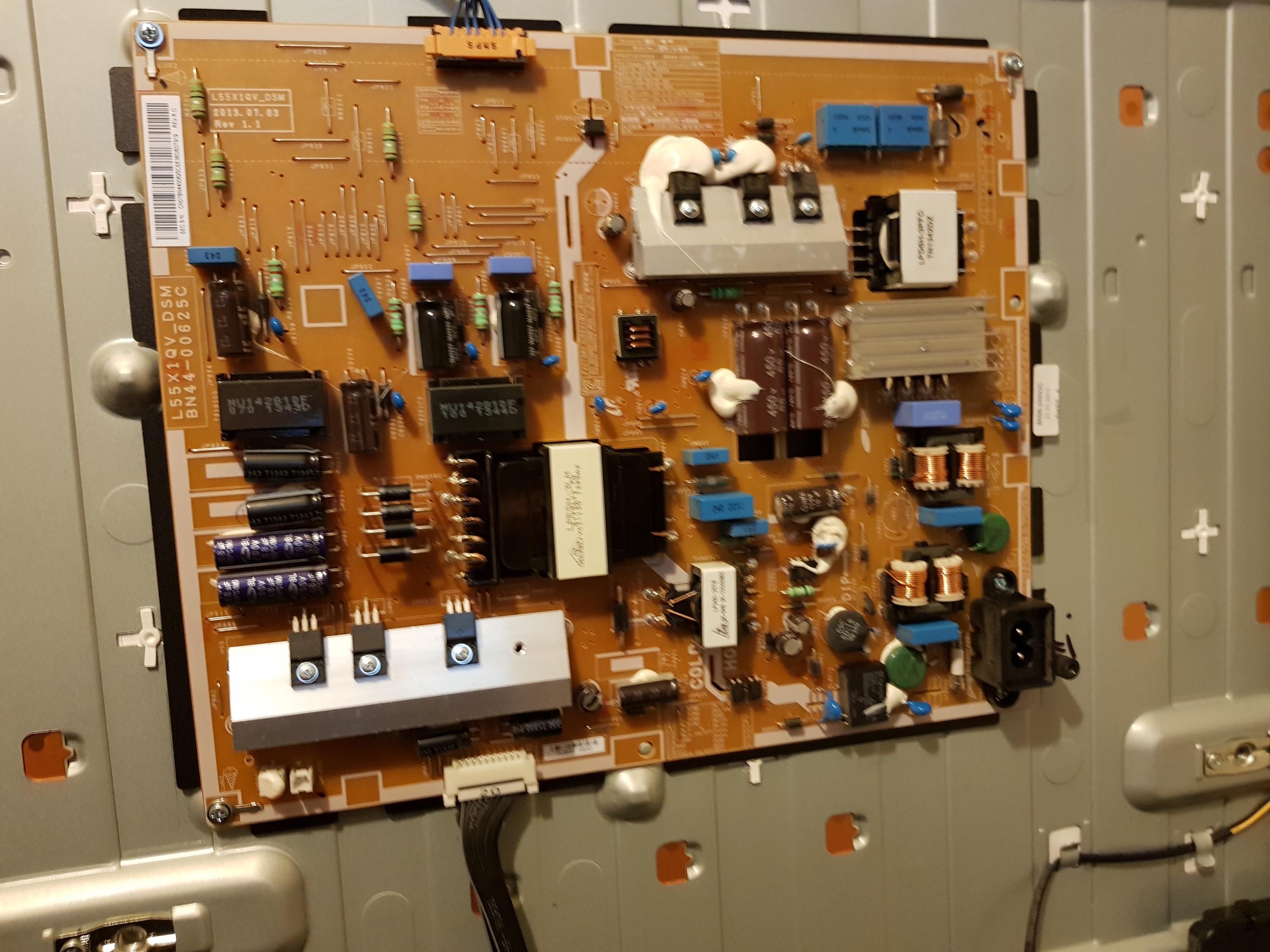

    Any way i have this Samsung 55" smart tv model ue55f6800sb that is constantly turning on/off.
    Has any one come across this problem before ?
    I will include pictures of the p/s board and the main board.
    Any help much appreciated.

    Re: Samsung UE55F6800SB
    What happens if you disconnect the mainboard
    does it power on and back lights stay on ?
      Yes it does
      Well back lights come on and stay on?
        I would replace the main baord
        sounds like it has gone bad.

              Try disconnecting the wifi module.
                Just to be sure, you should inspect both ends of the cable that goes between power supply and the main board to see if there are over heated pin.
                  I have checked both ends of the cable going to between p/s and main board and both ends look okay can't see any burnt pins.
                  neilc6
                  Can you confirm that this is the wifi module connection.
                  • ronhayes
                    TV Engineer
                    • Mar 2014
                    • 458
                    I have removed the connecter and connected a video source to the TV and when plugging in i get full picture and sound. But TV still keeps switching on and off.
                    So would that confirm the wifi board is ok and my problem is the main board as zomi advised .
                    My other question is does and one have a link to where i could get this mother board the only one i have seen was on Ebay but the BN number did not match mine and it was very expensive.
                      Yup bad main board
                      There's 2 on ebay one for 80 one for 65
                      Main is to match the model number
                      off the white sticker.
                      The bn numbers can vary
                      its just how it is some boards can be pricey and rare,
                      I once had to wait nearly a year for a board for a panasonic 55as802 and I had to pay quite a high price for it as it was so rare and rarely came up and it..

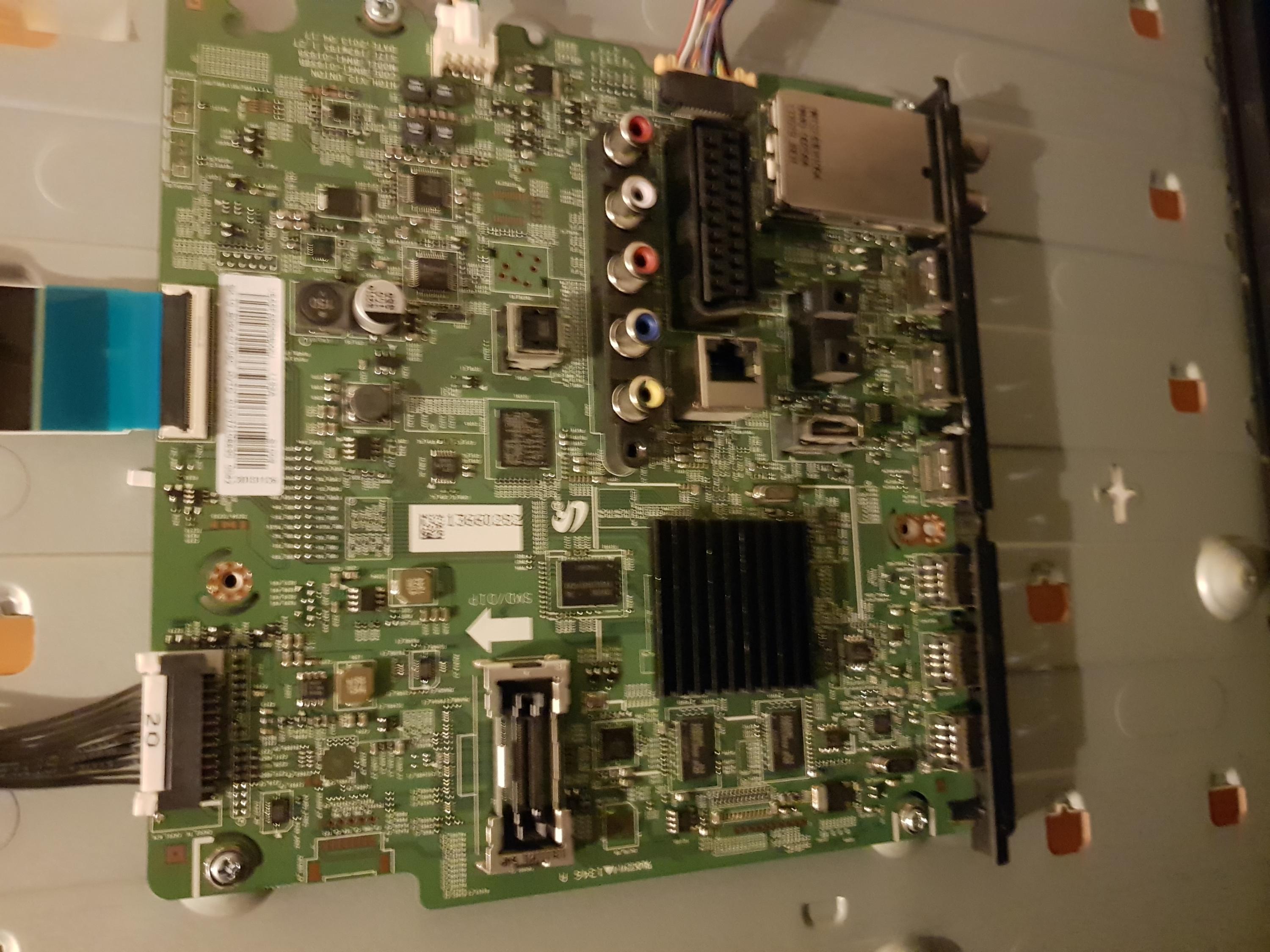

                        Yes
                        I have seen those boards the £80 one the BN numbers printed on the board are an exact match and the size and date match.
                        I have sent them a message showing the numbers on my board and asking if they can do me a better price on it i can hope. (although it does say it is new) so if they don't discount it i will probably go ahead and buy it.

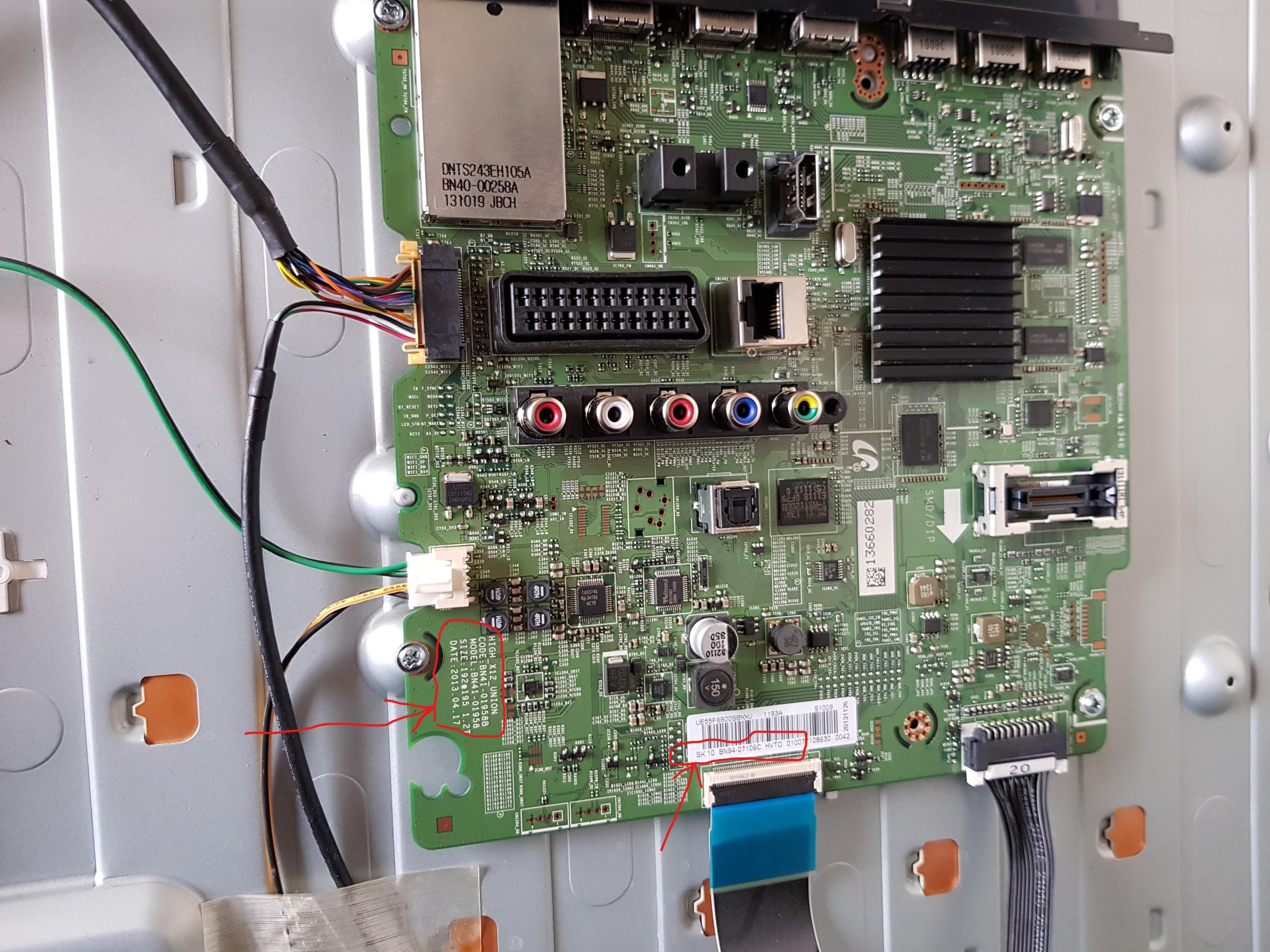

                          Can you show us a little close up of the numbers?
                            Yes
                            And if you expand the picture you can see a lot of burn patches near s/m resisters and ic's
