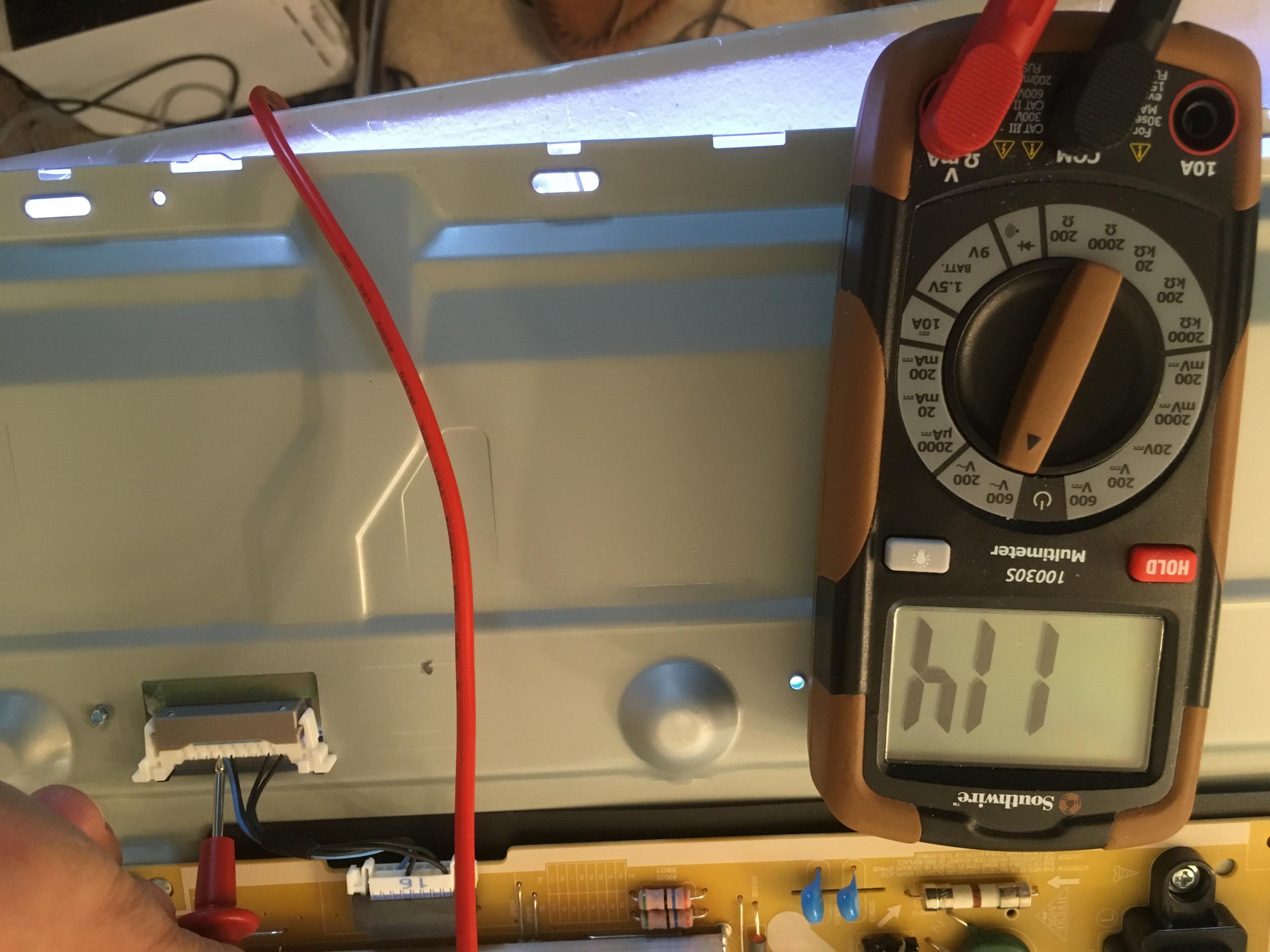

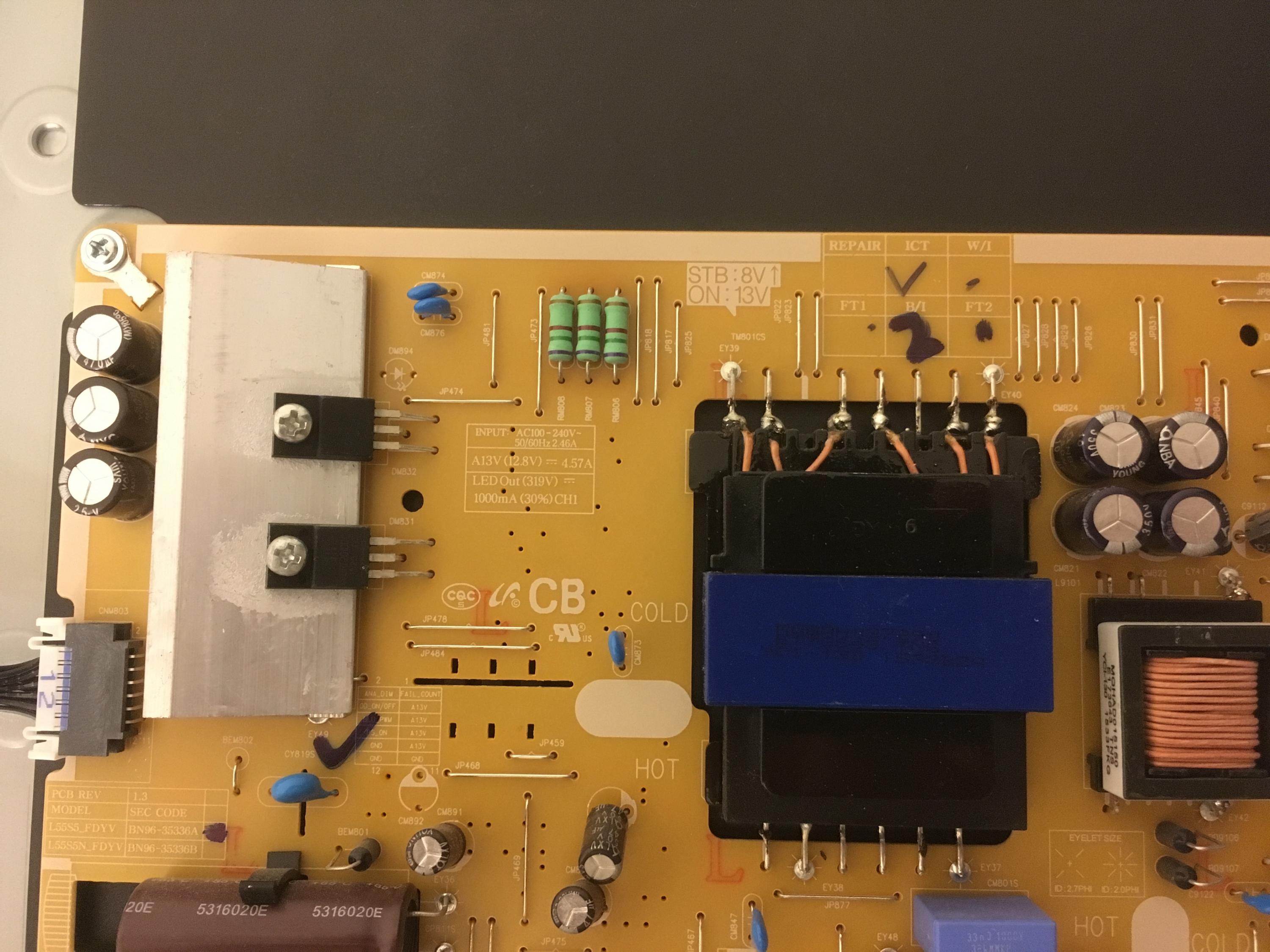

    I've lurked on these boards for a while and learned a lot. However, I'm having issues with a UN48JU6400 Power Supply board.
    When I power it on, the LEDS will flick briefly with very little light and go out. I've tested the LEDs with a LED tester and there are no blown LEDs.
    I've replaced the cable going from the PSU to the LED strips with no improvement.
    Also when I do power it on, the LED will blink 4-5 times.

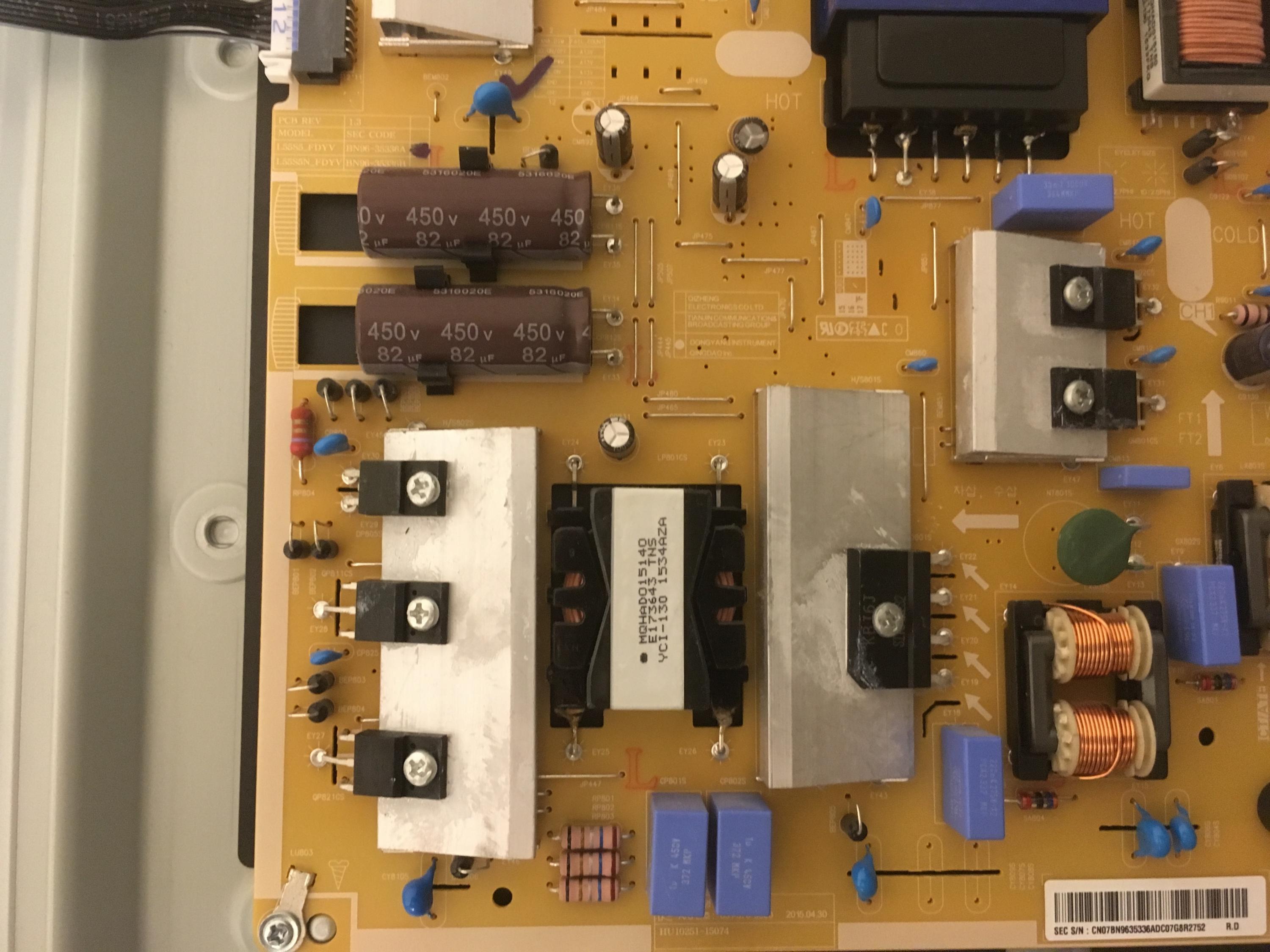

    I've looked over the PS Board and there are no noticeable blown Caps.
    I've also bought a replacement board with no improvement to the LEDs lighting up. So Either I have 2 bad Power supply boards or something else is up with the boards that is not visible.
    I do have a Multimeter but not sure where to start.
    and I'm not good at reading Schematics.

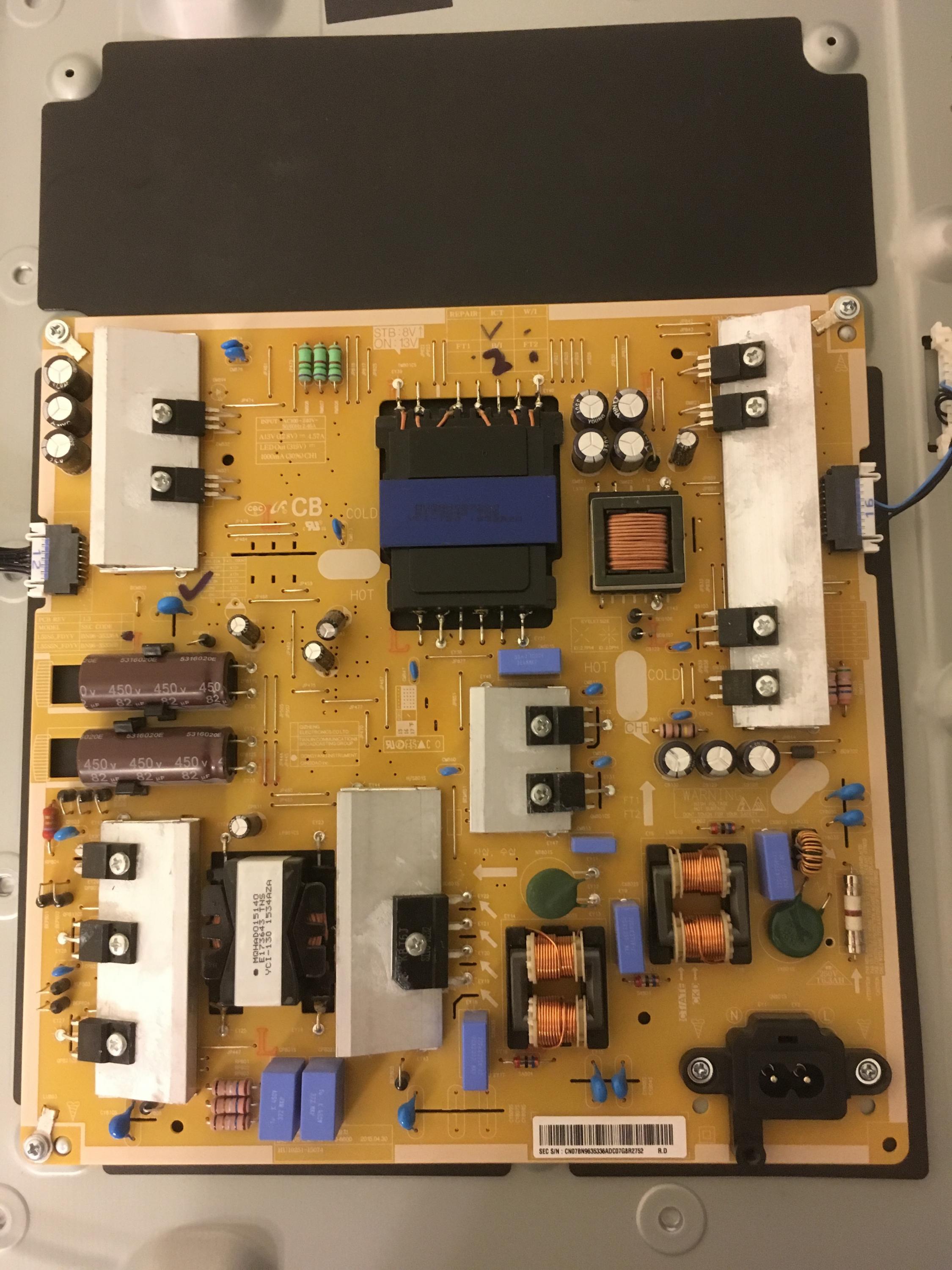

      Is this your board?
      Samsung BN96-35336A Power Supply
      http://www.shopjimmy.com/samsung-bn9...wer-supply.htm

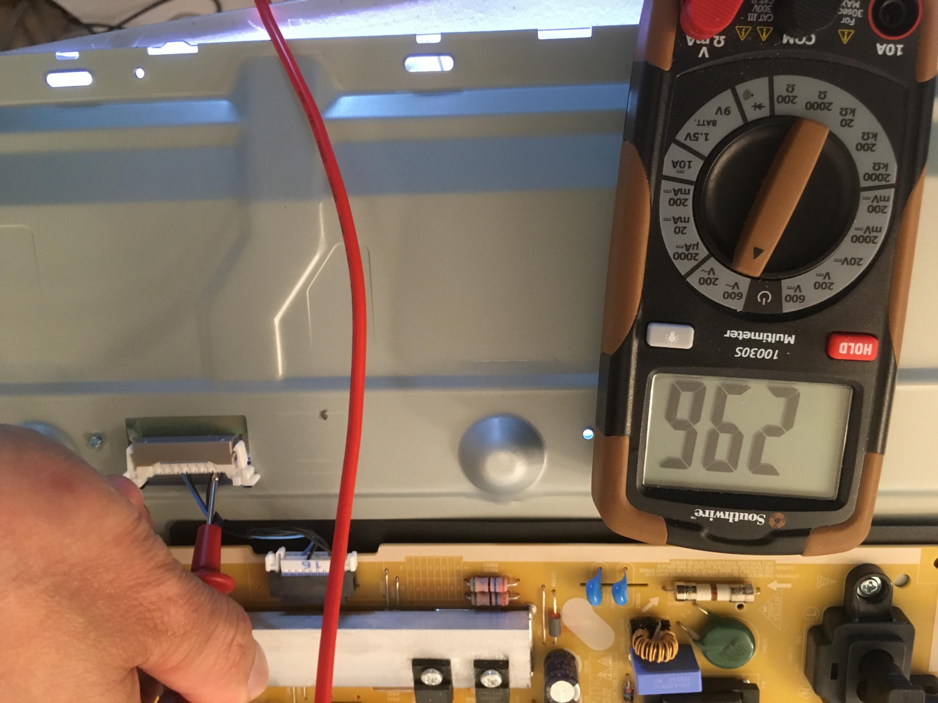

        Re: UN48JU6400 LEDS lightly flicker but won't stay on
        You need to teat the Voltage at each pin of the LED connector EVERY TIME you turn on the TV to see how high the Voltage jumps up to and how low it goes down to after 10 seconds, you will have to do that 4 times with LED connector in place and 4 times without LED connector in place because you have 4 wires on that LED connector, you must follow the instructions.
        You will have to leave Black probe on the chassis and red probe on each pin each time.
          Originally posted by budm
          Is this your board?
          Yes
                By LED connector in place and without it in place, I've tested it with the connectors in place. Out of place....Where am I Putting the Multimeter? on the PS Board pin? or just unplugging the LED Connector from the Plug to the Lights and still testing the Same spot on the LED connector?
                Also, Here's what I got from testing with the LED Connector in place. One of the Wires(The blue one) only goes to about 114 Volts when powered on. The others all went to about 296 Volts.
                Interestingly, When I use the multimeter to test the wires, the lights came on full power.

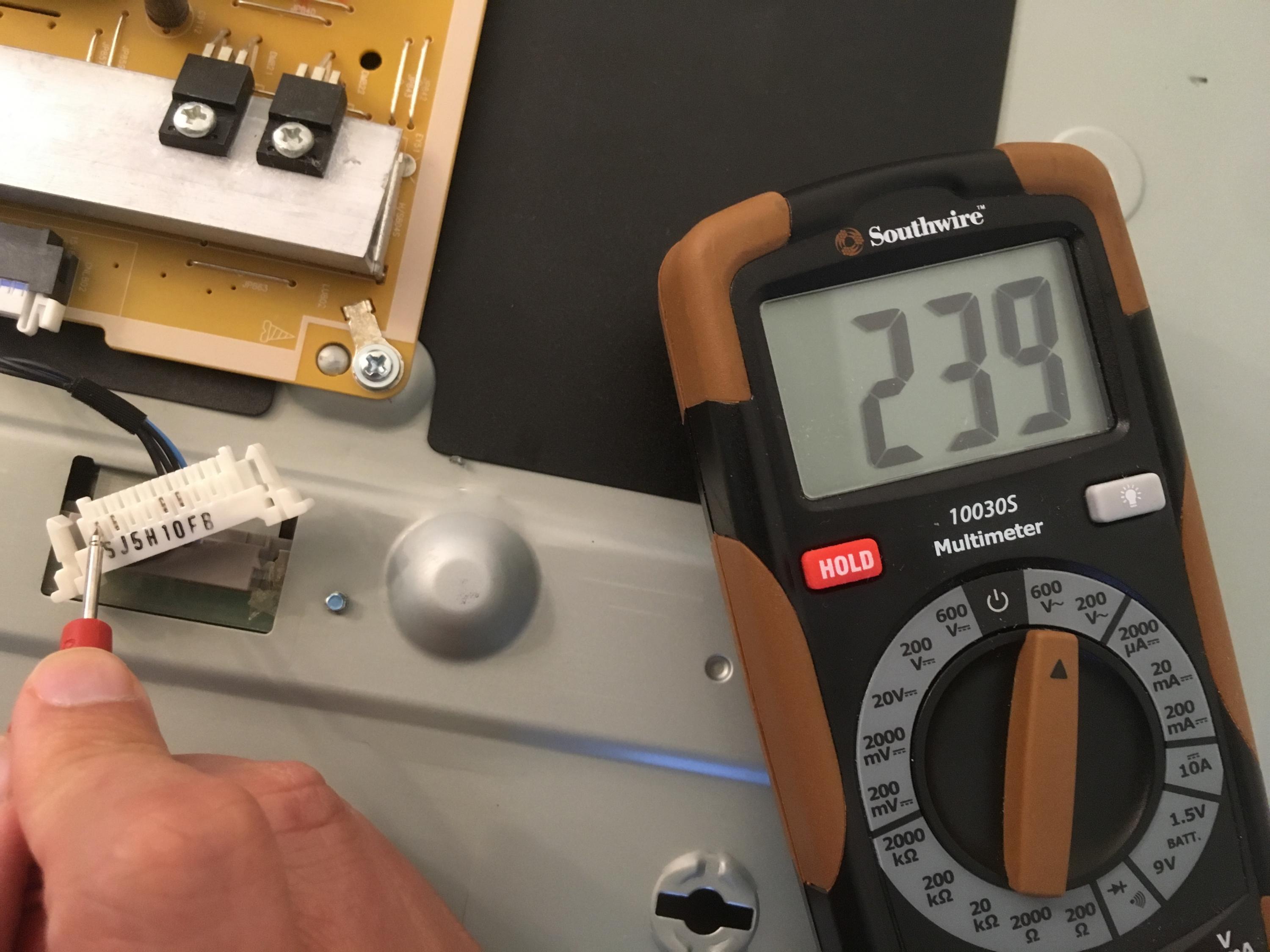

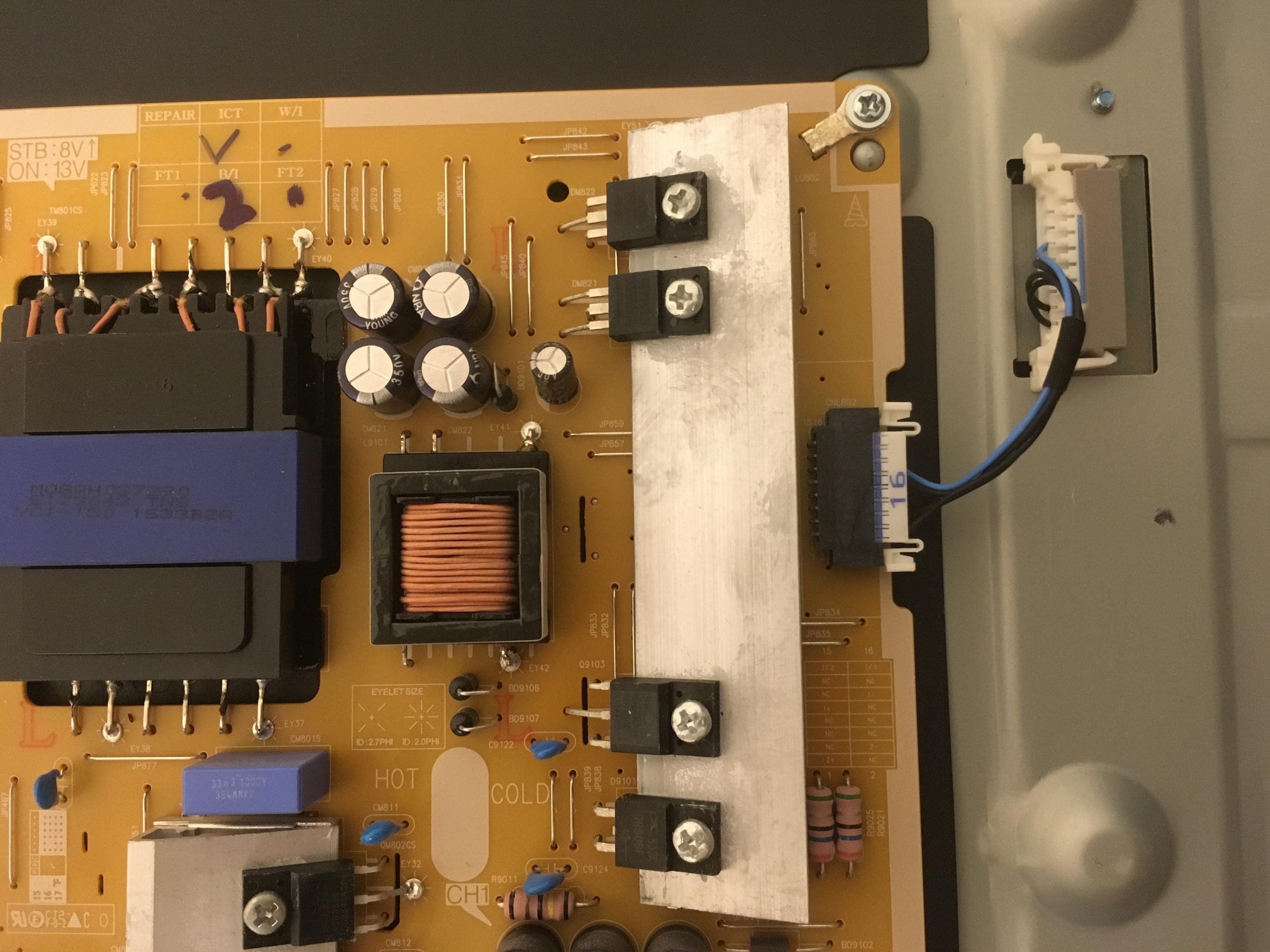

                  Ok Testing the LED Connector not connected to Lights. The 1st wire (pictured) goes Out of limits for my Multi meter when powered on. When I Turn TV off, the Voltage drops down to about 240 volts and stays there. The other 3 LED wires produce a 0 Voltage which I'm guessing would make sense since the power is in series and guessing the 1st wire powers the other 3.

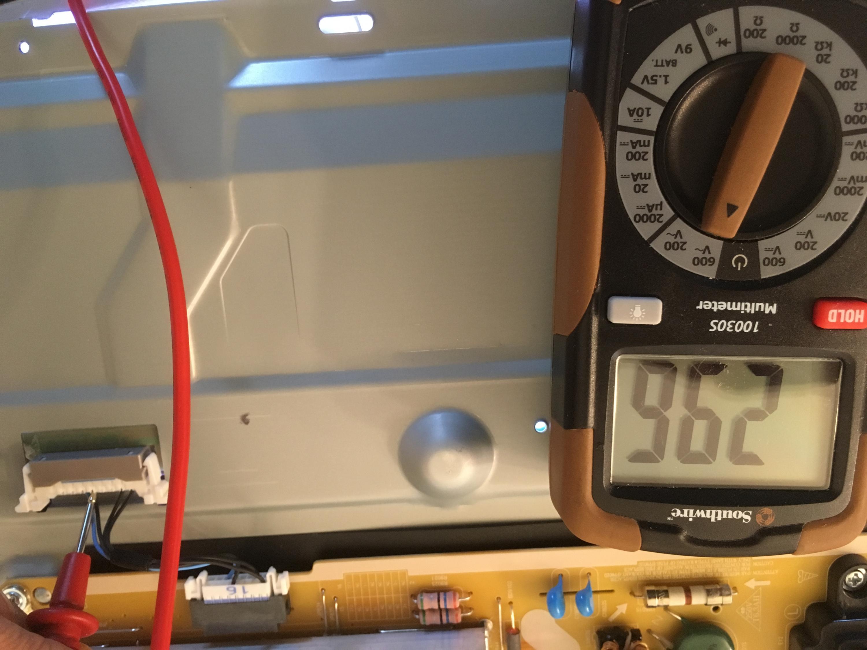

                    Also initially when powered on, the power spikes to about 600 volts then drops to 296 volts for each of those wires aside from the blue wire.

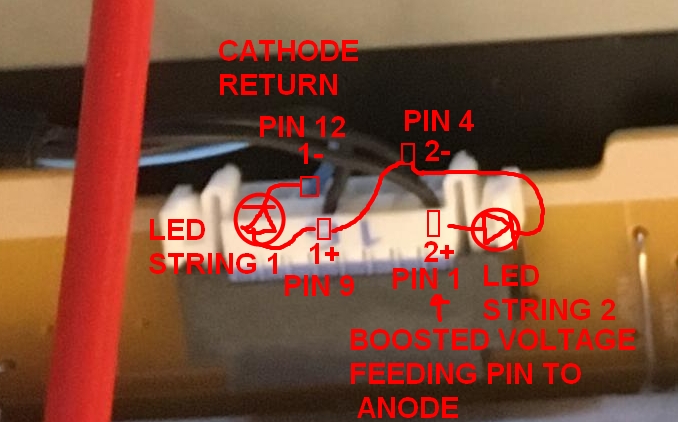

                      1) Please look at the LED connector pin chart as printed on the board, you can see pin names: 1+, 1-, 2+, and 2 -.
                      2) Put the LED connector back in place and retest those 4 pins again as instructed before, but this time report the pin name and pin number for each pin.
                      3) "Interestingly, When I use the multimeter to test the wires, the lights came on full power." That means the female connector is not making good contact with the male pin on the board, so inspect the wire termination on the female end and on the male pins which are soldered to the board. The female sockets on the connector may have been expanded too much so it causes poor connection to the male pins.
                      4) When you use tester to test the LED you need to test the whole string, means you put the tester on the female pin of the connector to test each LED string, I.E LED string # 1 by putting the tester in 1+ and 1 -, 2+ and 2 -.
                        UGH. Lol turns out, the connector was bad. I replaced it with another i had. And this time the LED lights worked. IDK I thought I had done it before, but who knows.
                        so put it all back together. functioning as well as can be.
                        thank you for the help sir.
