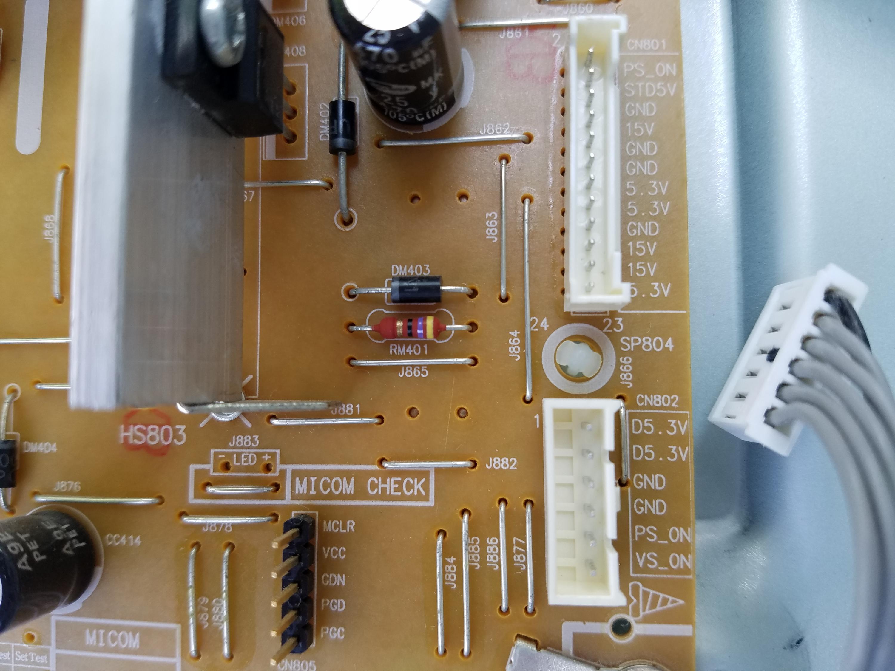

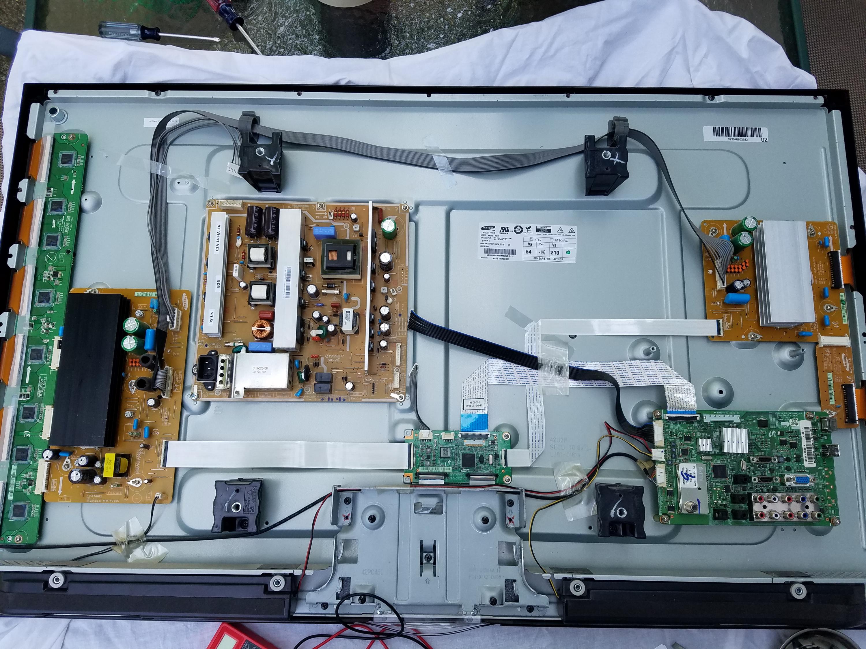

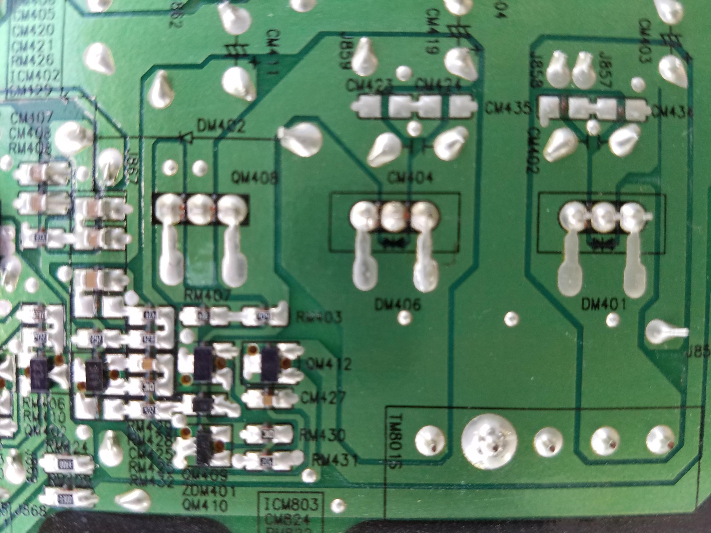

    I have a Samsung PN42C450 B1DXZA where the red standby LED lights, but will not power on. When plugged in it will do a double click within a sec and then a couple seconds later you get a quieter single click. This sequence happens twice.
    When you hit the power button this click sequence repeats, PS_ON has 3.25 V at stand by and drops to .06 V then rises to 3.25 between the two click series and then again after the second series. This process can be repeated a few time before the "standby" voltage stays at .06. My understanding is that this TV has a high standby voltage and energizes when PS_ON is pulled low. If so, then it is trying to energize and fails; it tries twice then stops. Then after multiple attempts the system shuts down and will not try further without pulling the plug to reset. Does this seem correct?

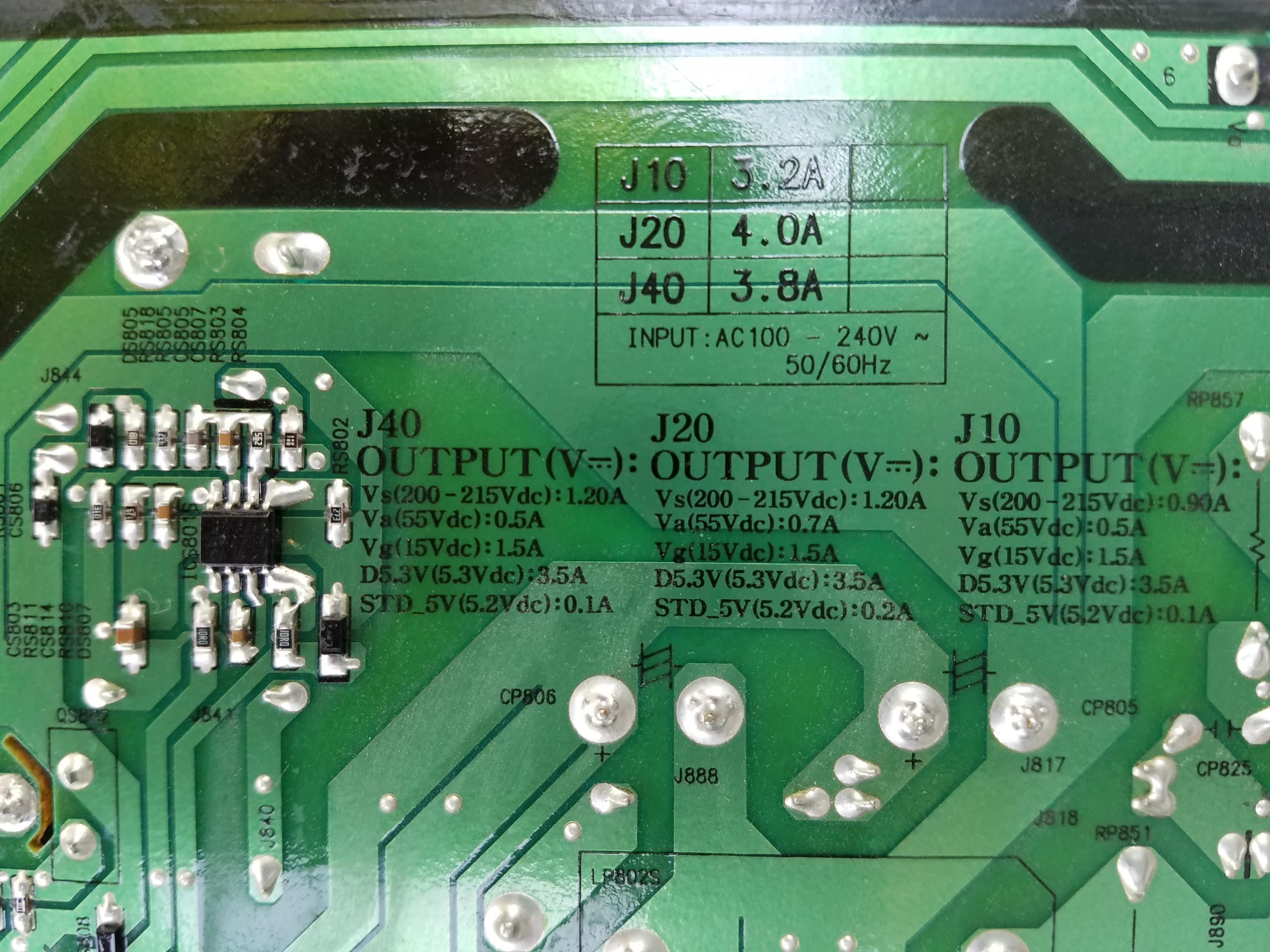

    Attached are photos of the TV and boards as well as voltage readings. I only have 3.25 V PS_ON and STD 5.21 V. Since no other voltages are generated I am also assuming that the power board is bad. Does this seem correct?
    Also where I can look for the schematics for this TV?

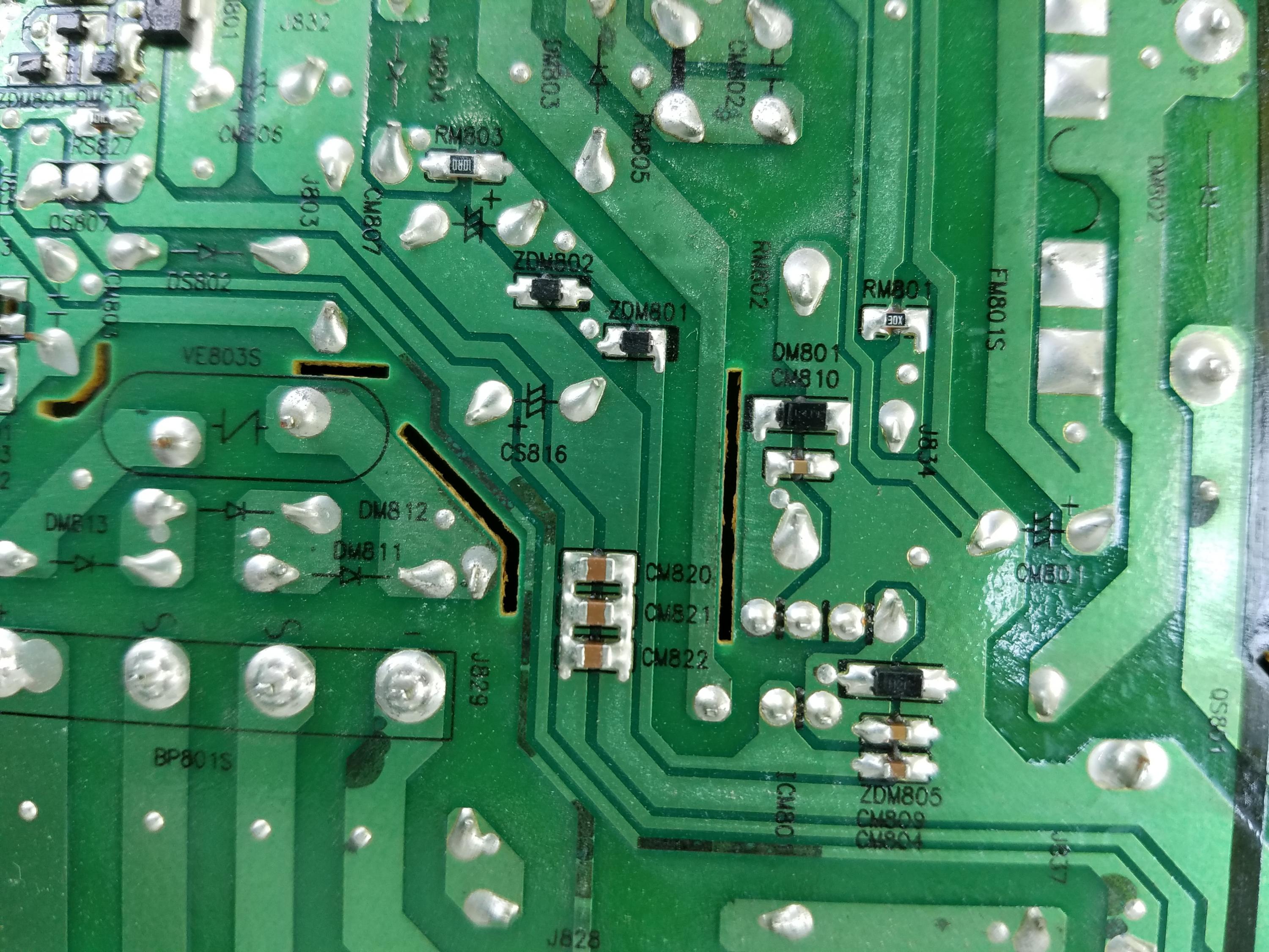

    The Problem Trace photo is more of a questions. The traces are dark in spots under around the CM 820-2 area of the board. Does this indicate a problem?

    Re: Samsung PN42C450 B1DXZA Doesn't Power On
    Start by reflowing/adding a bit of fresh solder too all the devices attached to the heatsinks also to any of the larger parts like transformers etc as we have seen in the past as bad soldered joints (cant always see with naked eye) will cause issues like this.

        Just heat up each joint with a solder iron and put some fresh leaded solder on.

          Thanks TV Timmy. Any thoughts about the trace lines in the Trace problems picture? Are these ok or do they show a problem?
            When in doubt, whip it out! Your multimeter that is. Put it in continuity mode and put one probe on a solder spot and go past the suspected bad trace to another solder spot on it and listen for the beep. Beep is good.

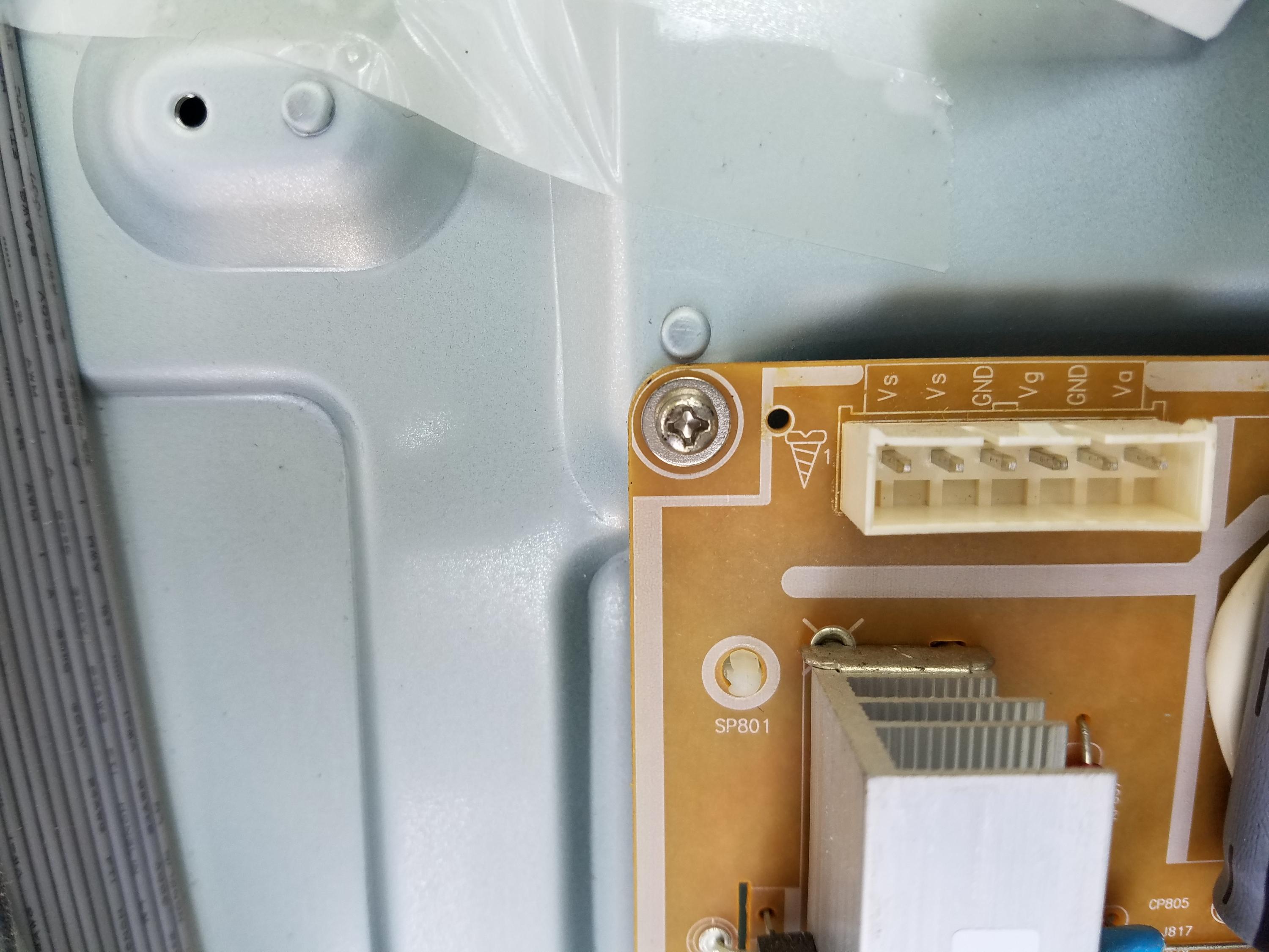

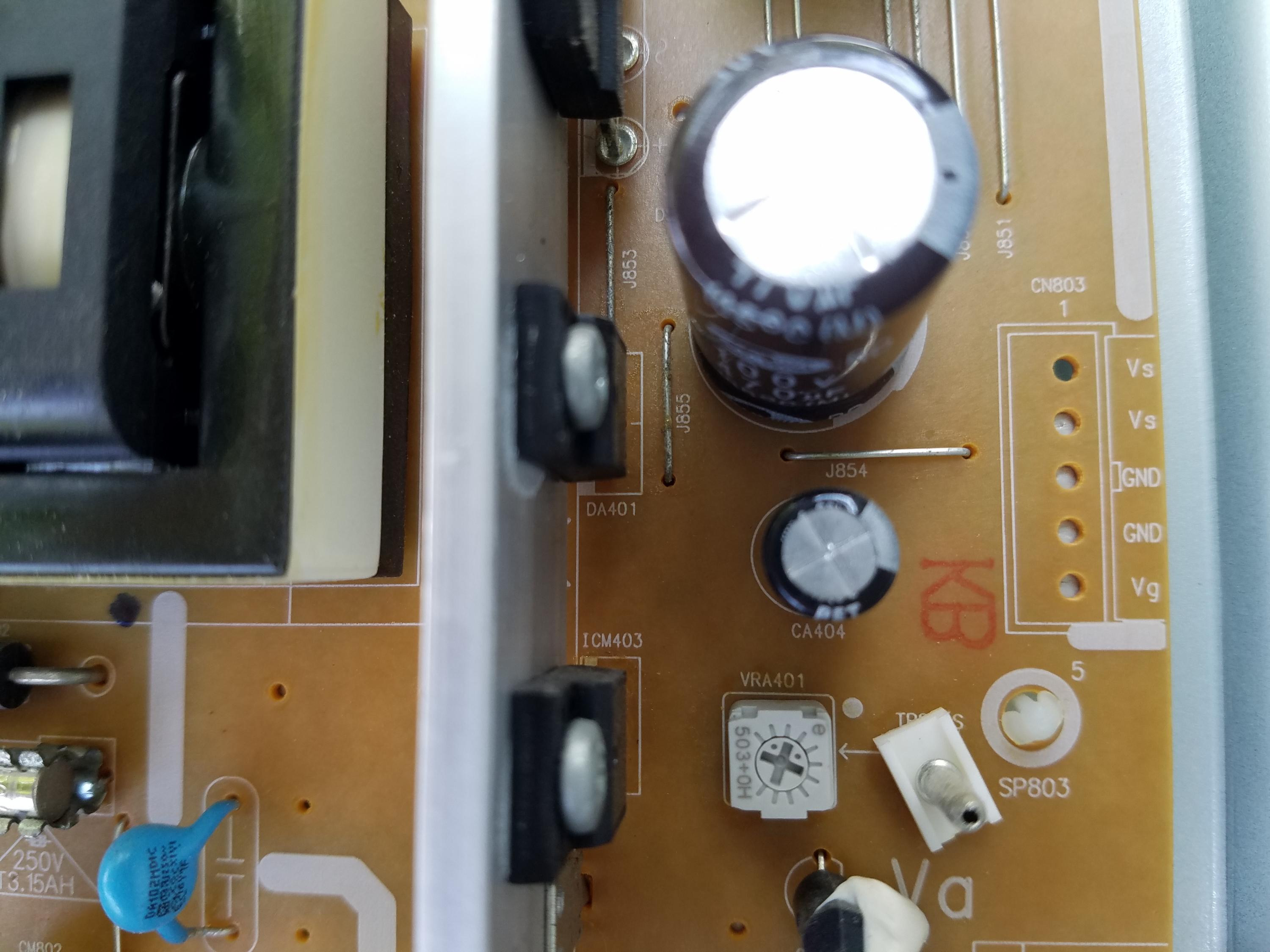

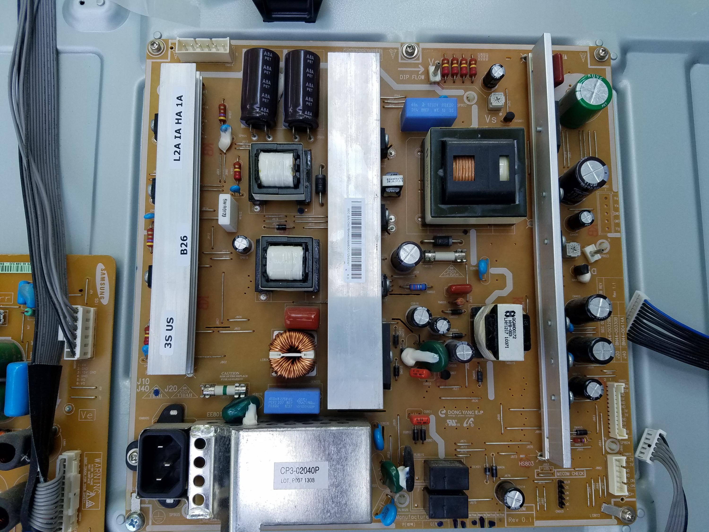

              I looked at the power board to determine which pins to resolder. As I looked at the board, a number of the pins are very close to each other and adding more solder seems like it will end up making a blob of solder across the pins (see attached photo of the pitch between the pins).
              Your thoughts and suggestions would be appreciated.

                I would suspect a fault on the Y-sus or Z-sus board, before the power supply. Have you tried monitoring the Vs voltage when you first turn on the tv and see if it comes up for a second.
                with all the plugs connected check CN804 VS. If you are checking the VS without a load it may not come up due to ovp circuit.
                With power off, you could also check the resistance across VS and ground for a short, or check the fets on the Y-sus and Z-sus to see if any are shorted
                  So would you expect the voltages to be present if these boards were disconnected?
                  I will test this.
                  How do I identify the field effect transistors and how do I test them?
                    Likely not, unless you use a load on the power supply VS. You can use two 60-100 watt incandescent lamps in series from ground to VS as a load, the lamps will light if the VS is there.
                    they are usually black plastic with three legs and mounted to the heatsink, thats the large black piece of aluminum. Using diode test, check that there are no shorts between the three legs, Or use google

                      The 2 household light bulbs in series as a load for the VS, with the VS connector disconnected from the Y and X Bds is a good way to tell if your PSU is producing VS voltage. The bulbs MUST light up bright and with the bulbs lighting, measure the other voltages that are produced by the PSU like 15,17,5V for example.
                        With all connectors plugged in I checked VS when the set is plugged in and when the power button is pressed, but no reading. I also checked VS_ON, connector 802, pin 6, under the same conditions and it gets around 3 VDC for a second or so then goes to 0. The LED on the logic board also comes on at the same time.
                        Resistance between VS and ground is 1 ohm.
                          You have a short on the VS line, very likely shorted fets on y 0r z(x) board

                            There are 5 transistors on the Y sustain and they read in the Mega Ohm range so I assume they are OK. On the Z Sustain (X Main) there are 5 transistors and the top and bottom ones are shorted (Q4001 and Q4007). Both are labeled:
                            G
                            RJH30E2
                            071B
                            The bottom one shows 0 ohms in all combinations the top one shows 36 ohms between bottom and middle and bottom and top legs. Middle to top legs show 0 ohms.
                            What would cause these two transistors to blow out?
