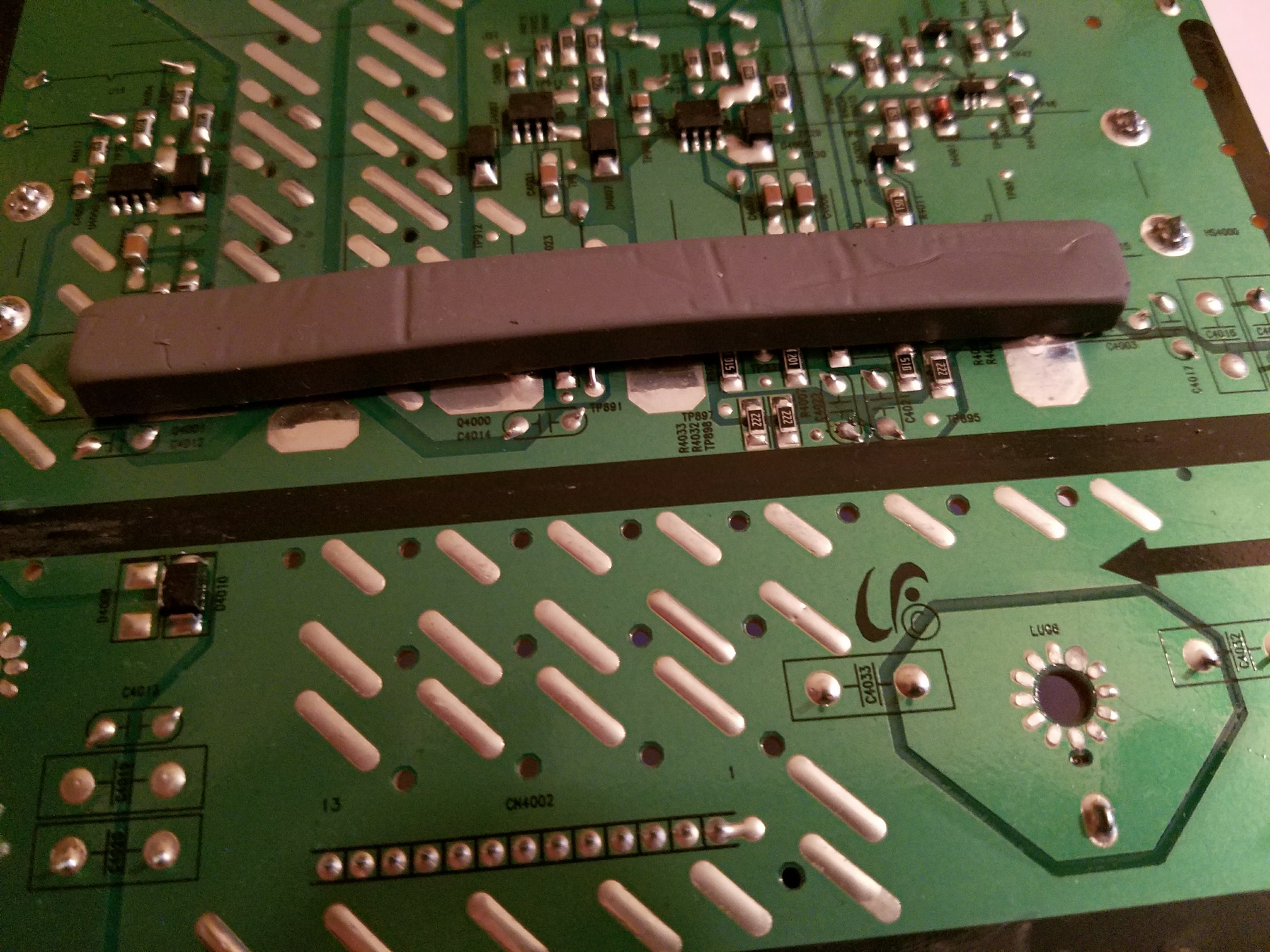

                #47
                Re: Samsung PN42C450 B1DXZA Doesn't Power On
                When replacing the two transistors on the X Main board how do I deal with mounting to the heat sinks?
                • Is the thermal paste the same that is used for mounting cpu's to a motherboard?
                • Do I need to scrape the old paste off?
                • Or do I just place the transistor onto the paste that is left over on the sink?
                Any other advise for the replacement effort?

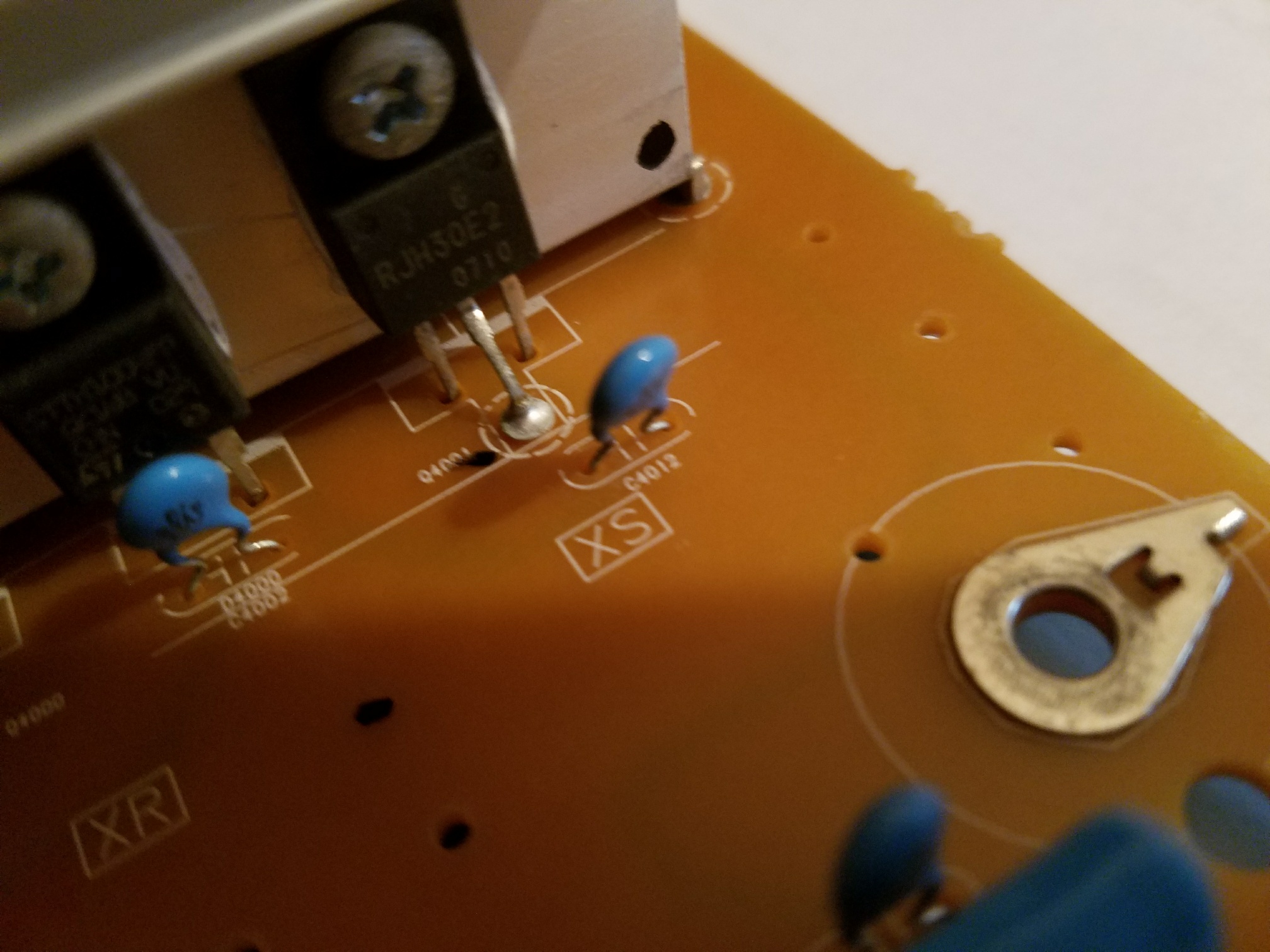

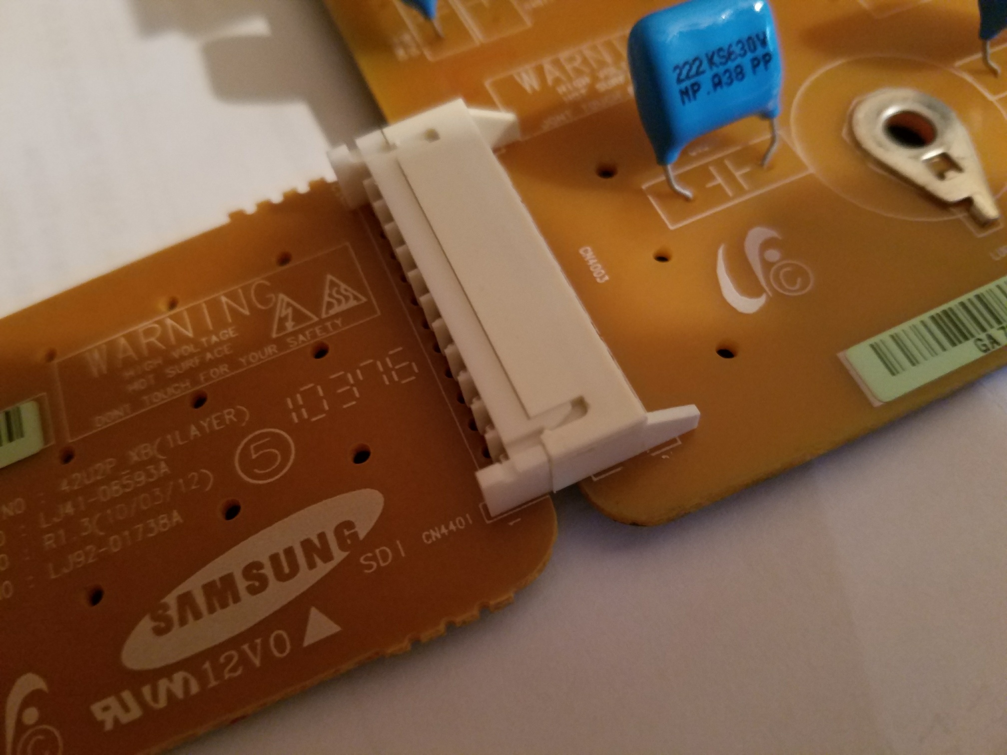

                      Got the X Main off to try and replace the FETs. There is a grey bar across the pins on the bottom. Looks like I need to pry this off, but not sure what it is and also assume I need to put it back when I am done. How delicate is this stuff and is there a suggested way to remove it (picture attached). Also the two FETs that need to be replaced don't have any solder on the top side of the board except for the forward legs which look to be soldered on both sides. Why is that?
                      Lastly, what is the point of the daughter board? It seems to just be an extension to move the connector further down and has a single cap. Also it seems to snap in, but not sure how to separate it.

                        #51
                        The gray bar is sort of a heatsink. Just peel it off and then stick it back on. The pin with the solder on top goes through a rivet hole. That one will be the last one you should remove( heat up and yank out the fet). Then clear out the hole. The daughter board is just an extension.

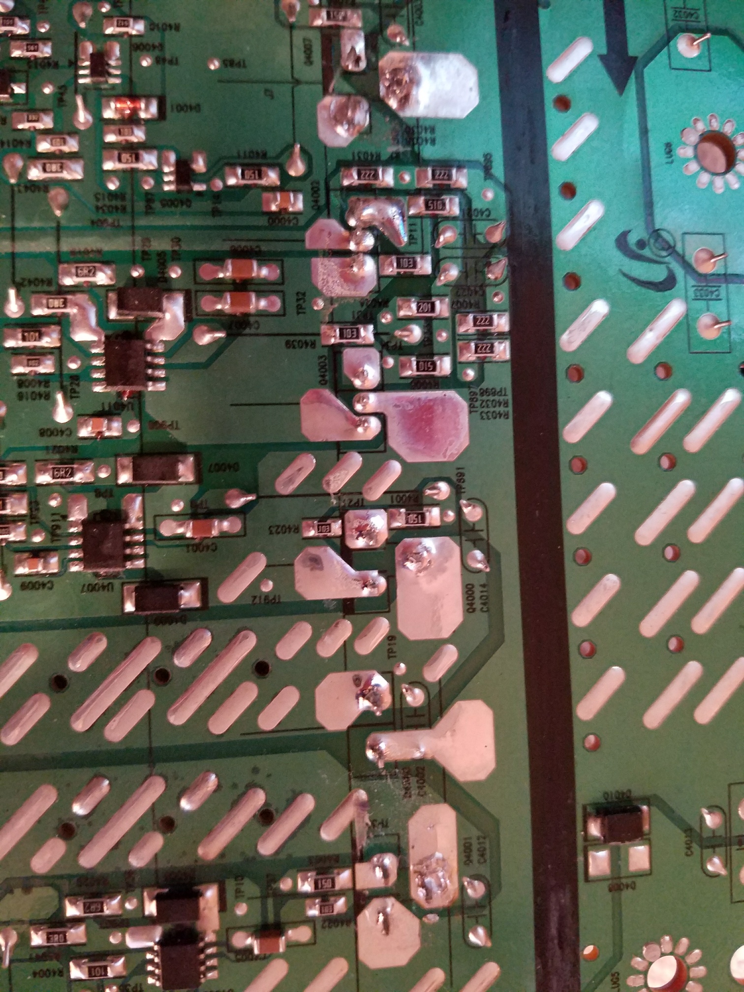

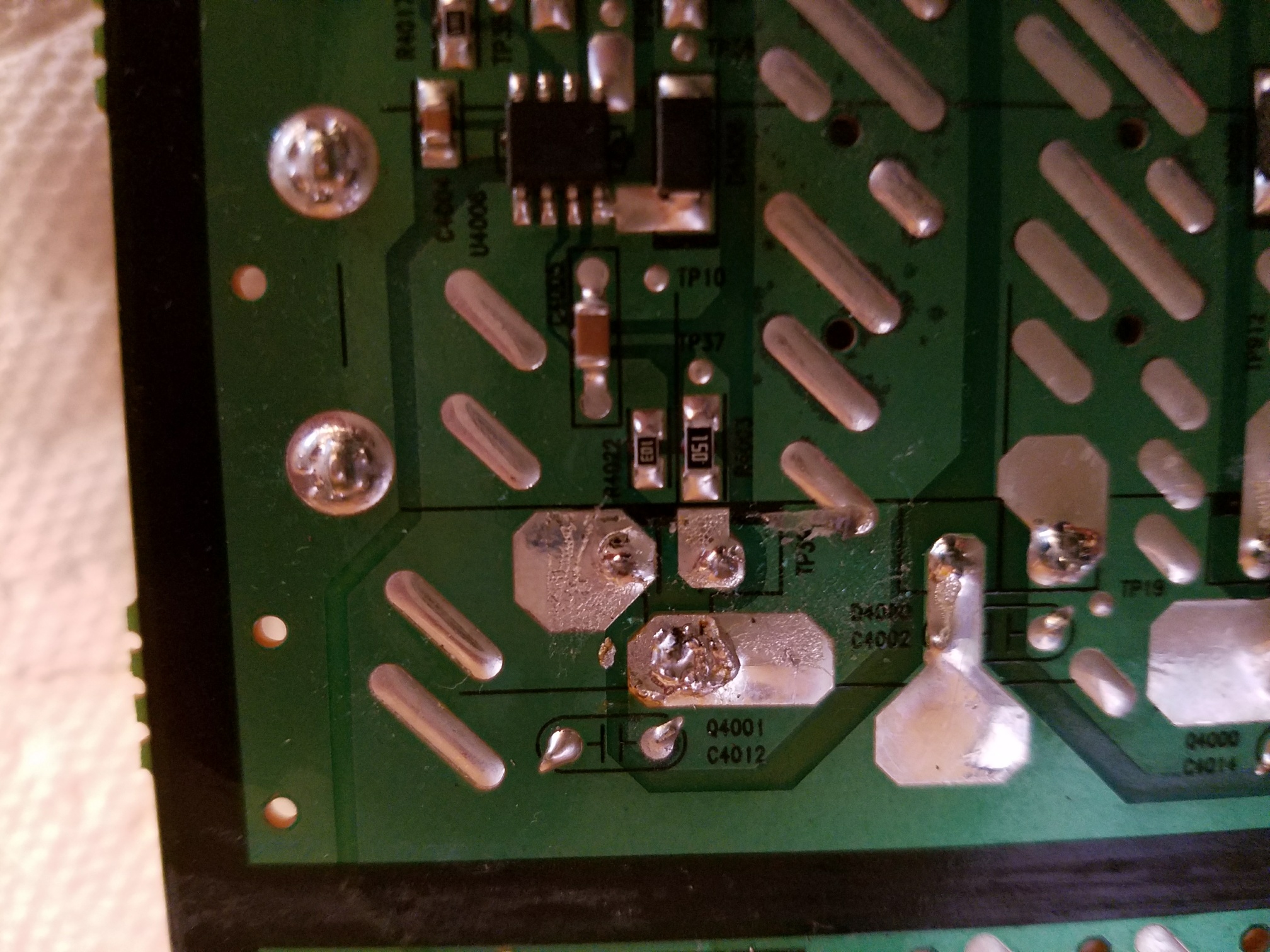

                          #52
                          I got the transistors and tried to remove the blown ones, but can't seem to get them out. I am using an inexpensive 30 W iron and the solder doesn't seem to melt. I have tried adding fresh solder, but even when it does melt a bit it seems to hard immediately once the iron is removed. Does this mean I am working with lead free solder? Attached are some pictures of the pads.
                          Also my vacuum solder sucker won't lock anymore. I have taken it apart and can't seem to find the problem. Outside the sleeve it will lock in position, but when reassembled it won't catch the plunger. Any thought here?

                            #53
                            Buy or borrow better tools.
