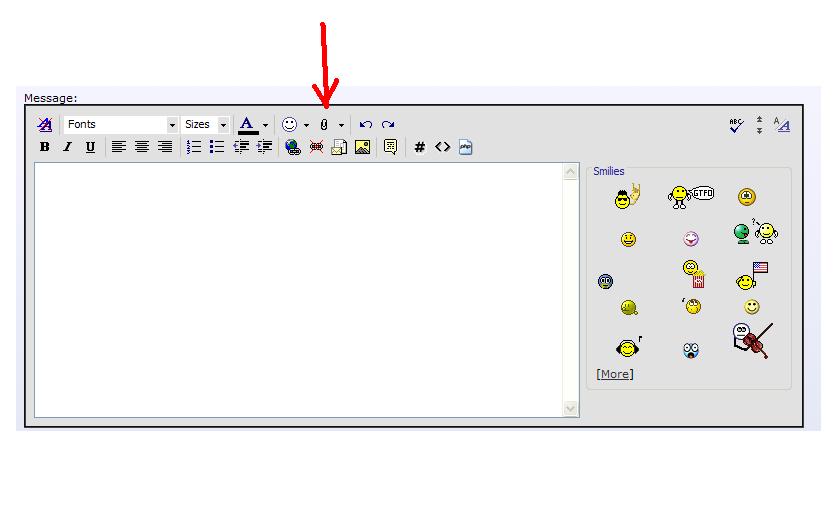

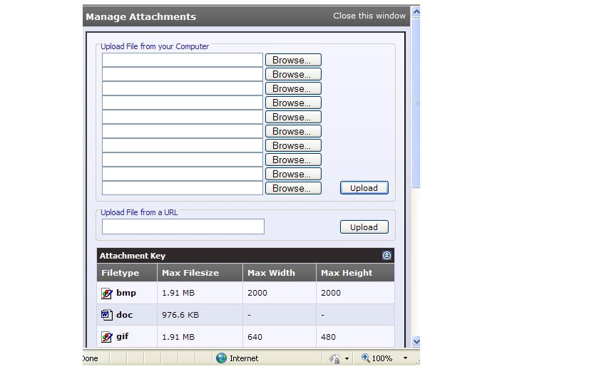

            To add your pictures click on Go Advanced, then click on the paper clip next to the smiley face, then using Manage Attachements, browse and add your pictures, then click Upload
