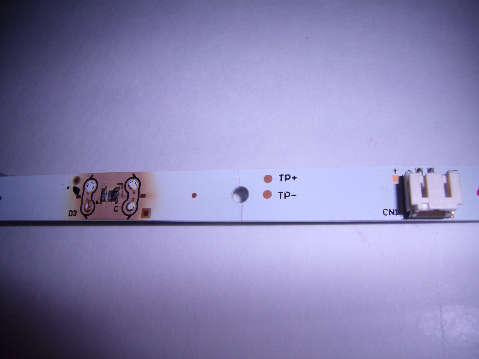

    hi im trying to do some trail and error trying to repair a led tv backlight board that had 5 bad leds
    i removed the led chips and would like to buy replacment led chips
    ..not sure what to look for when buying...ive seen some 6v ones on ebay for led tvs... the chips have 2 pads on bottom one larger than the other and are about 3x3mm size..very small
    just looking for something generic that would work with most backlight boards....doesnt have to be exact oem replacment..just something that will function
    what specs would i need to be looking for? voltage? watts? etc etc

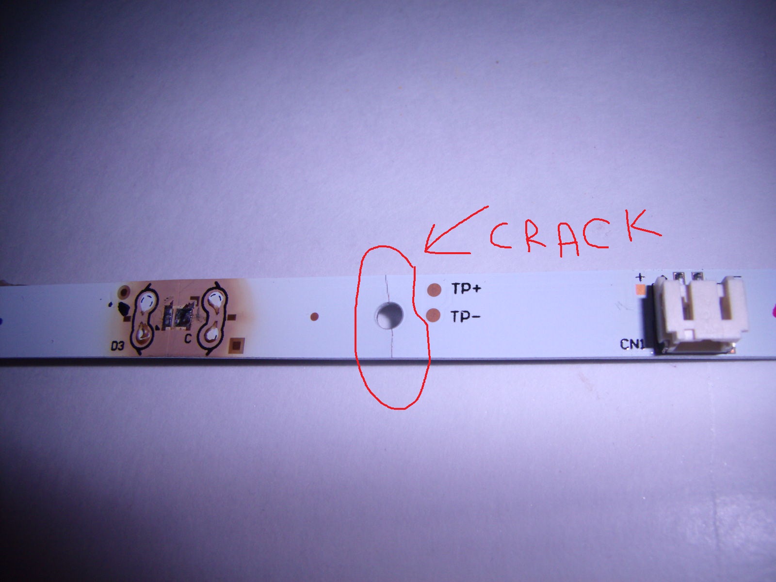

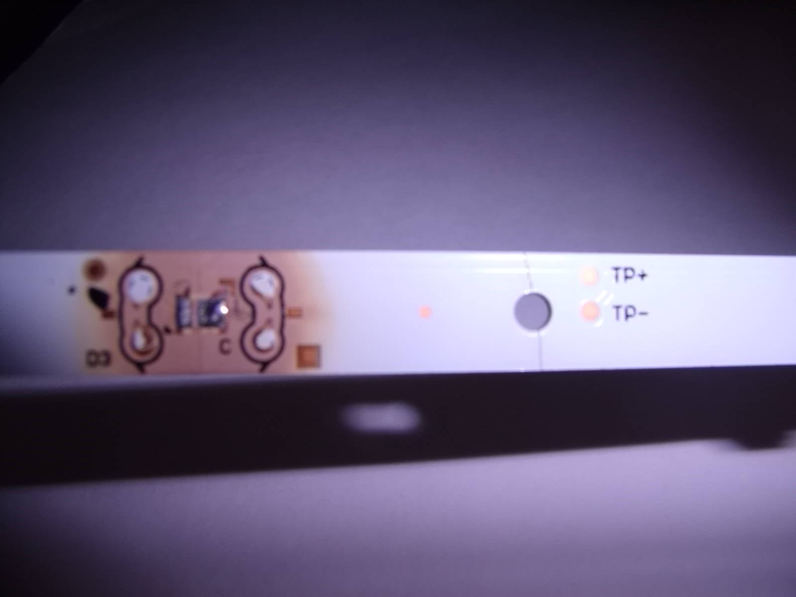

        Have you got a pic of the LED? it's difficult to see from your pictures.
        Do you have a backlight tester to check the voltage of the LED diode or strip divided by number of LED's?
        You will need to know the voltage.
        To find the correct LED you will need to measure as accurately as possible the width & length ie; 2.8mm x 2.8mm would be a (2828) type, or 2.8m x 3.5mm would be (2835) type so on & so forth.
        Secondly check the bottom pads against the ones you are buying they should be identical.
        Thirdly the top of the LED will have some variation but match as close as possible to the ones you have.
        Here are some examples of ones I purchase, they are very cheap so I usually buy a variety to keep in stock.
        https://m.aliexpress.com/item/324738...ddresstype=600
        http://s.aliexpress.com/ri6R3Eja?fro...y to Clipboard
        http://s.aliexpress.com/JJZbyIjY?fro...y to Clipboard
        With the snapped strip I would scratch some of the coating off & jumper together with wire.
