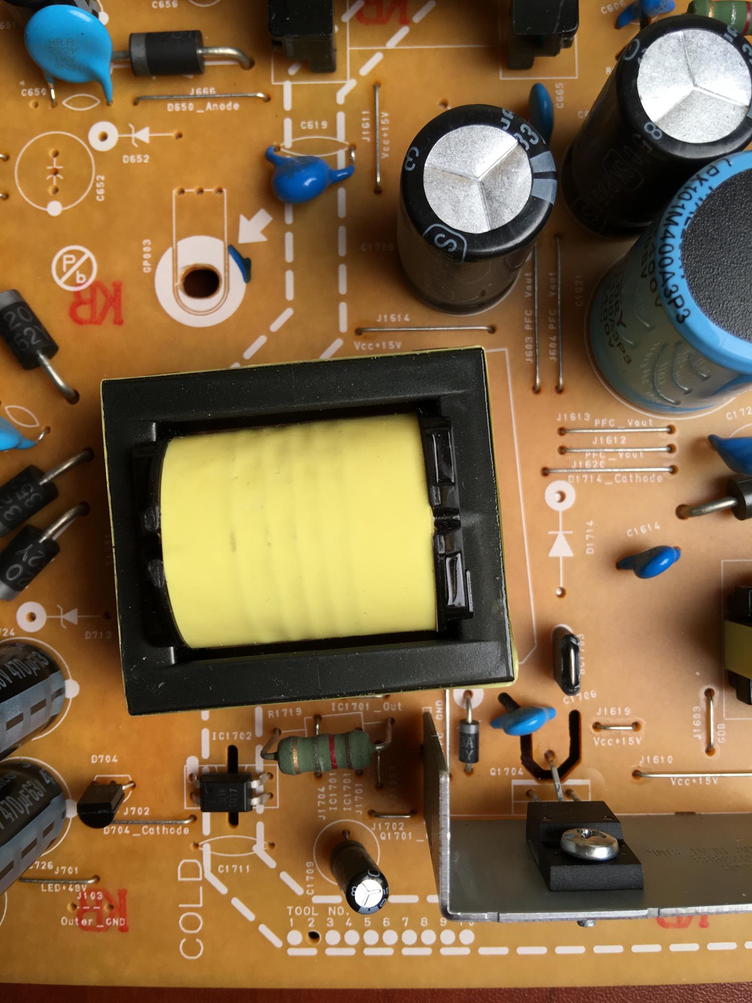

Before getting to the problem, I am not an electrical engineer by any means but I really want to learn component level testing/trouble shooting and I do my best to pick things up quickly, that being said...

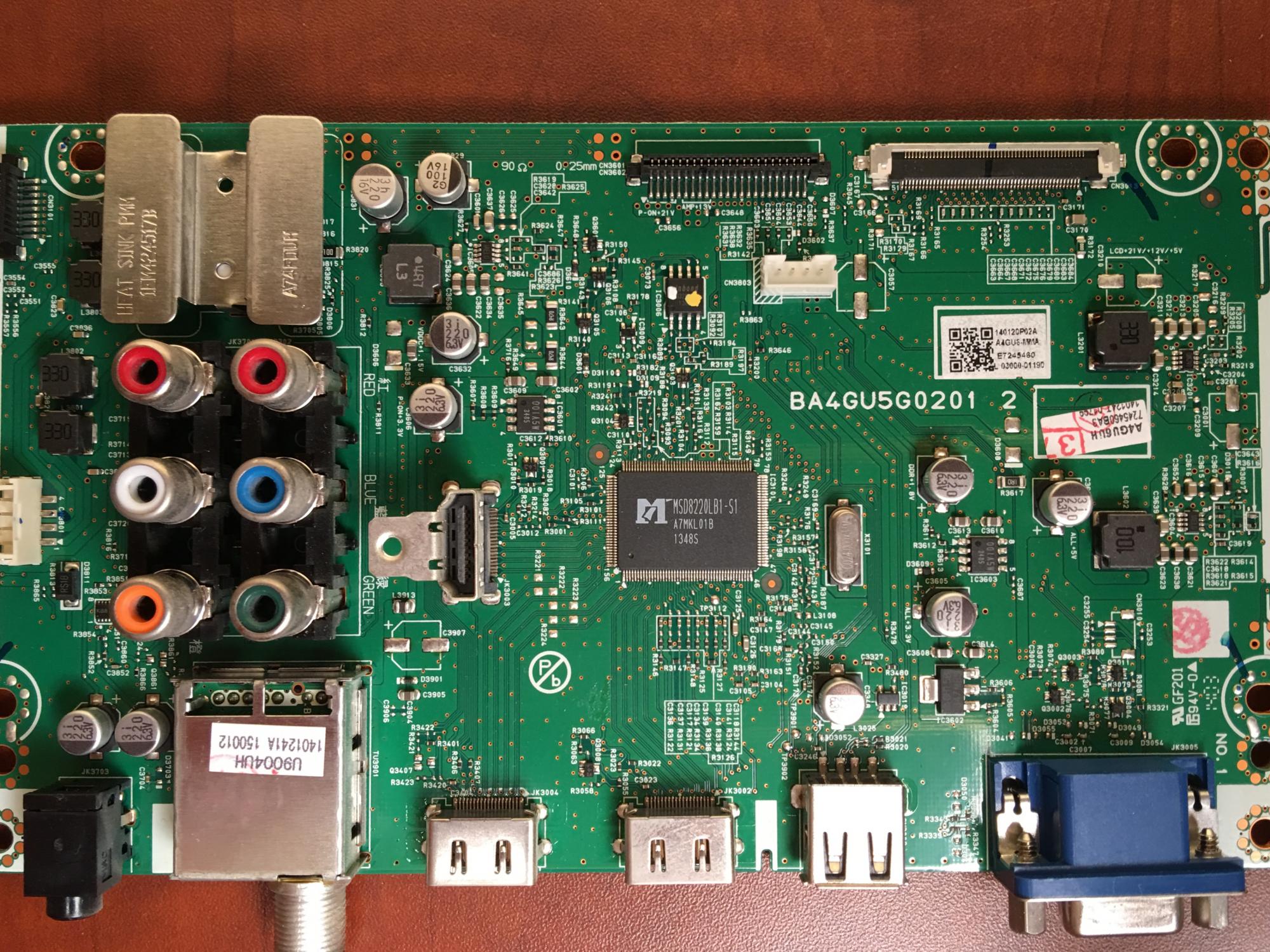

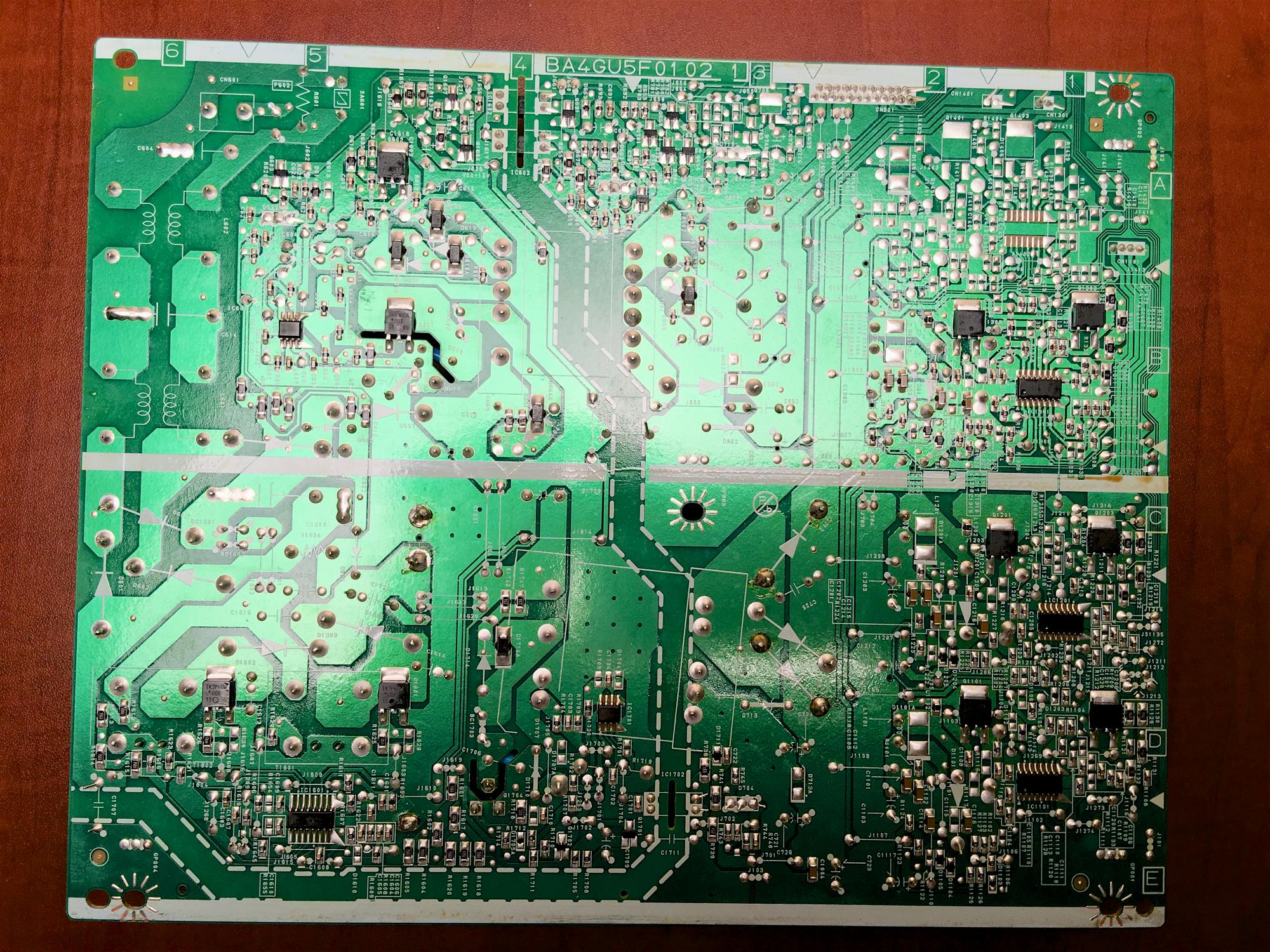

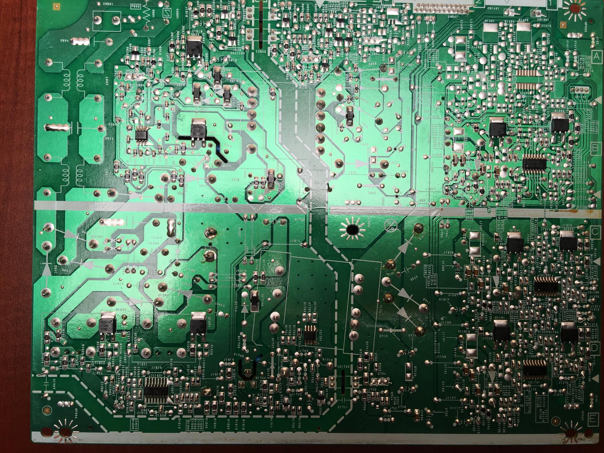

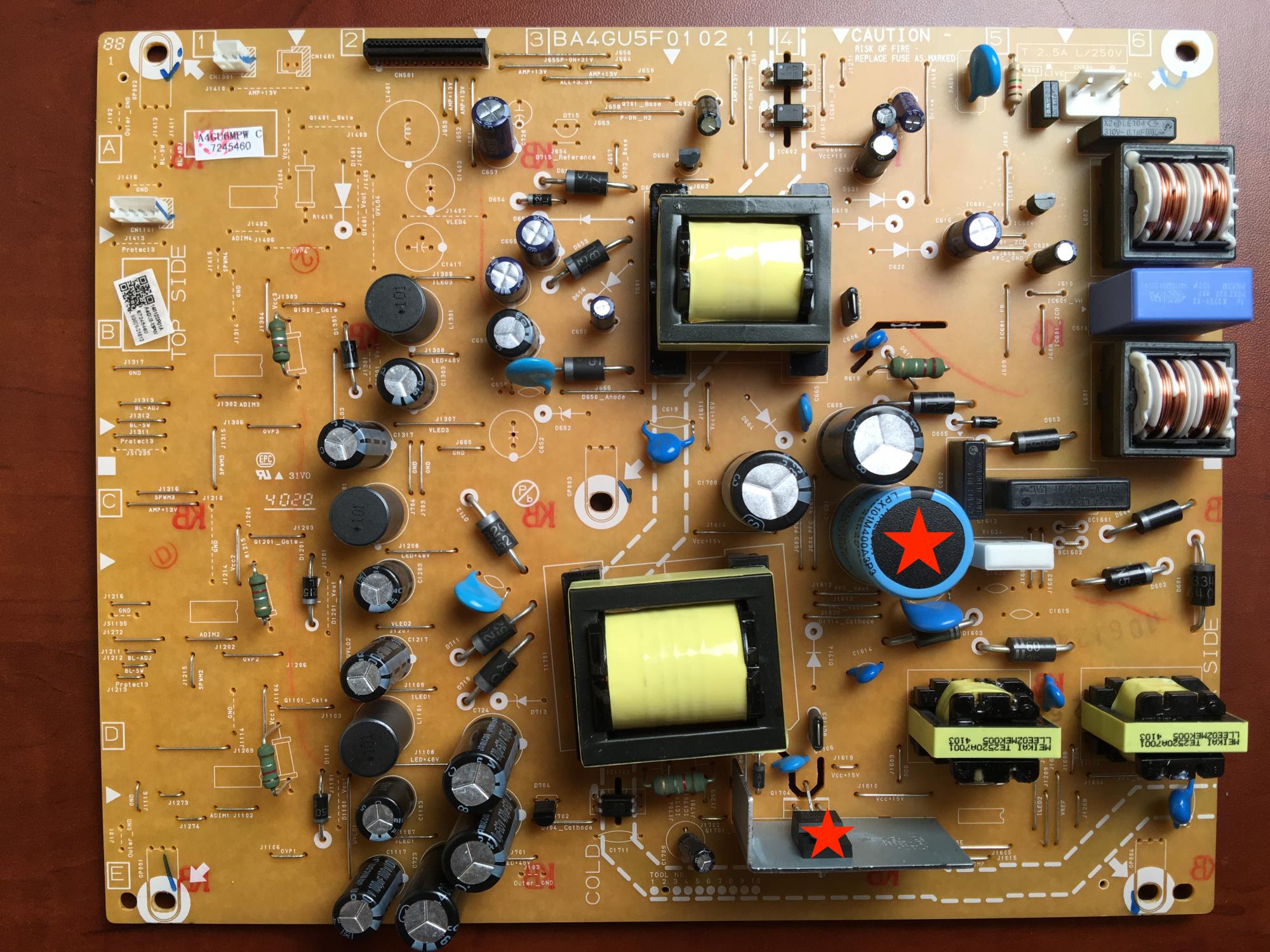

I have a Magnavox 50ME314V/F7 (the Model of the boards are "BA4GU5G0201 2". The power board beeps when it is plugged in and when the CPU board ribbon cable is plugged in.
I have replaced the 2 components with the red stars in the attached photo "PB TOP - Full". But it still beeps when powered and connected to the CPU board.

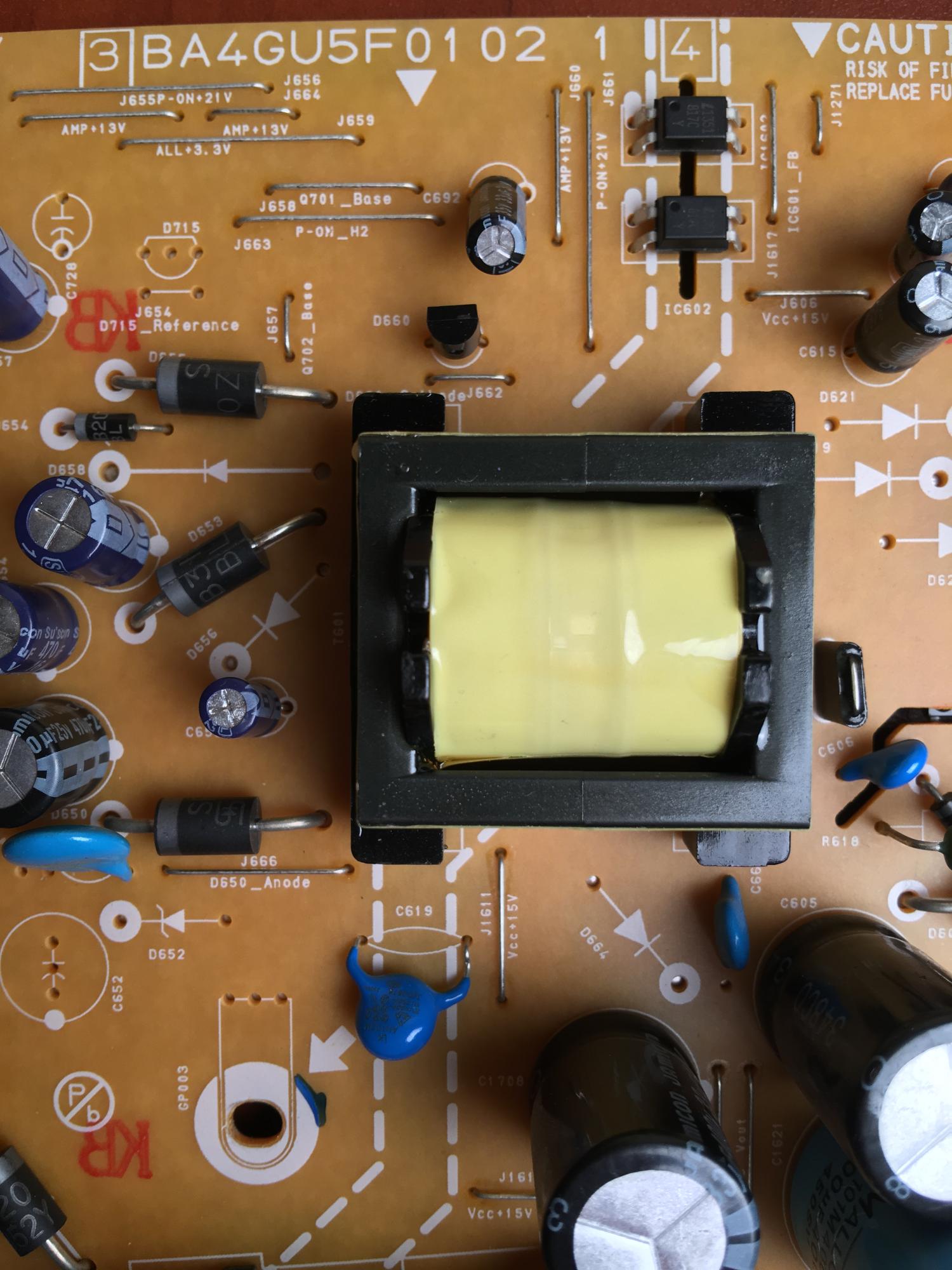

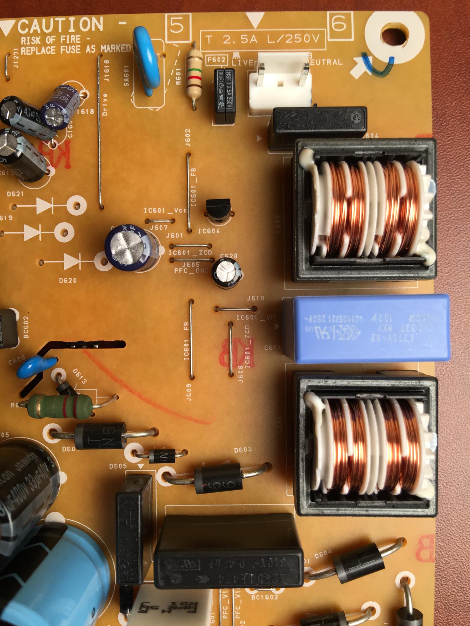

I am not sure which diode is emitting the beeping sound (I assume the beep happens when a diode gets stuck open or there is a short). I also can not find any schematic or service manual for this model tv. I do have a DMM and would be happy to post any test results that you guys think would be helpful to help me diagnose this issue.

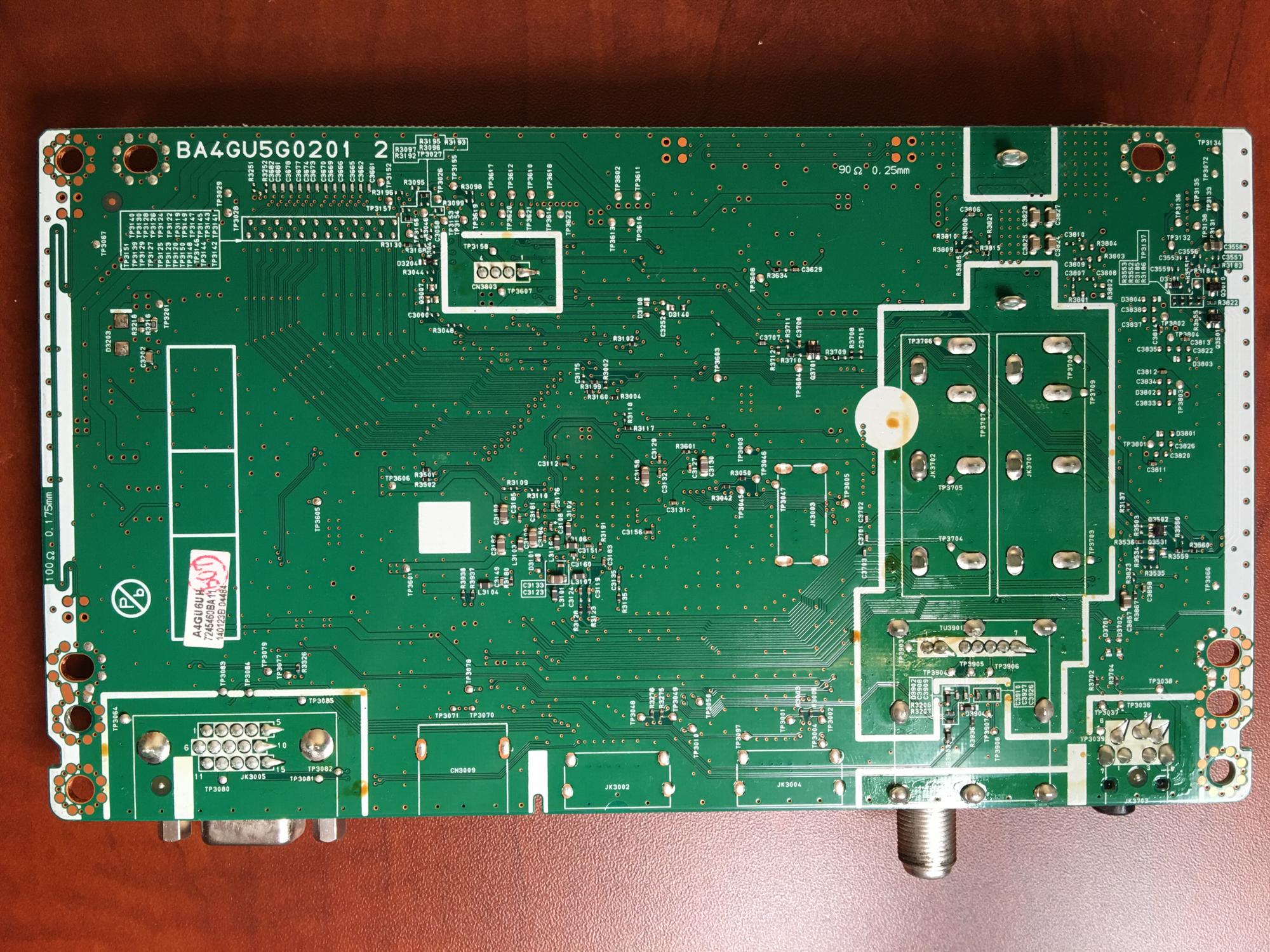

I am attaching photos of the Power board (PB) and the CPU Board (CPU).
Thank you all for any help or insights you can provide, I really appreciate the help and the ability to learn something I have been interested in for a while.

The PDF you attached earlier in the thread, has a Power board schematic that is close, but not the exact model and therefore in the trouble shooting section when it is showing all the components to test in that ALL +3.3V circuit, there are some components that are not on the board. That being said, the with the components I could find on this power board (some of the diodes listed in the trouble shooting section of that PDF, it says to test their voltage with power being supplied to the board. How do I test the voltage being sent to the diode properly so I don't short out/overload the diode?)
Should I have taken all the readings WITH the main board connected?
