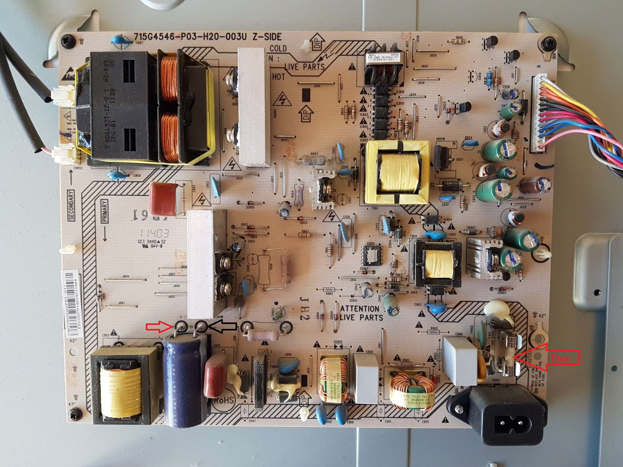

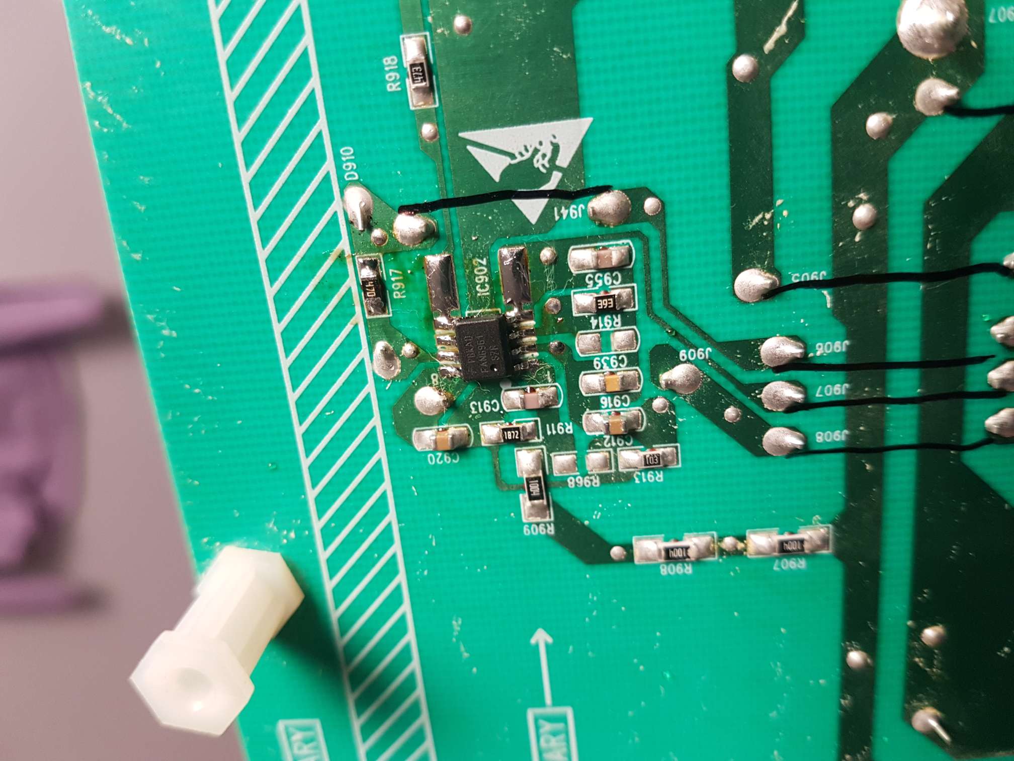

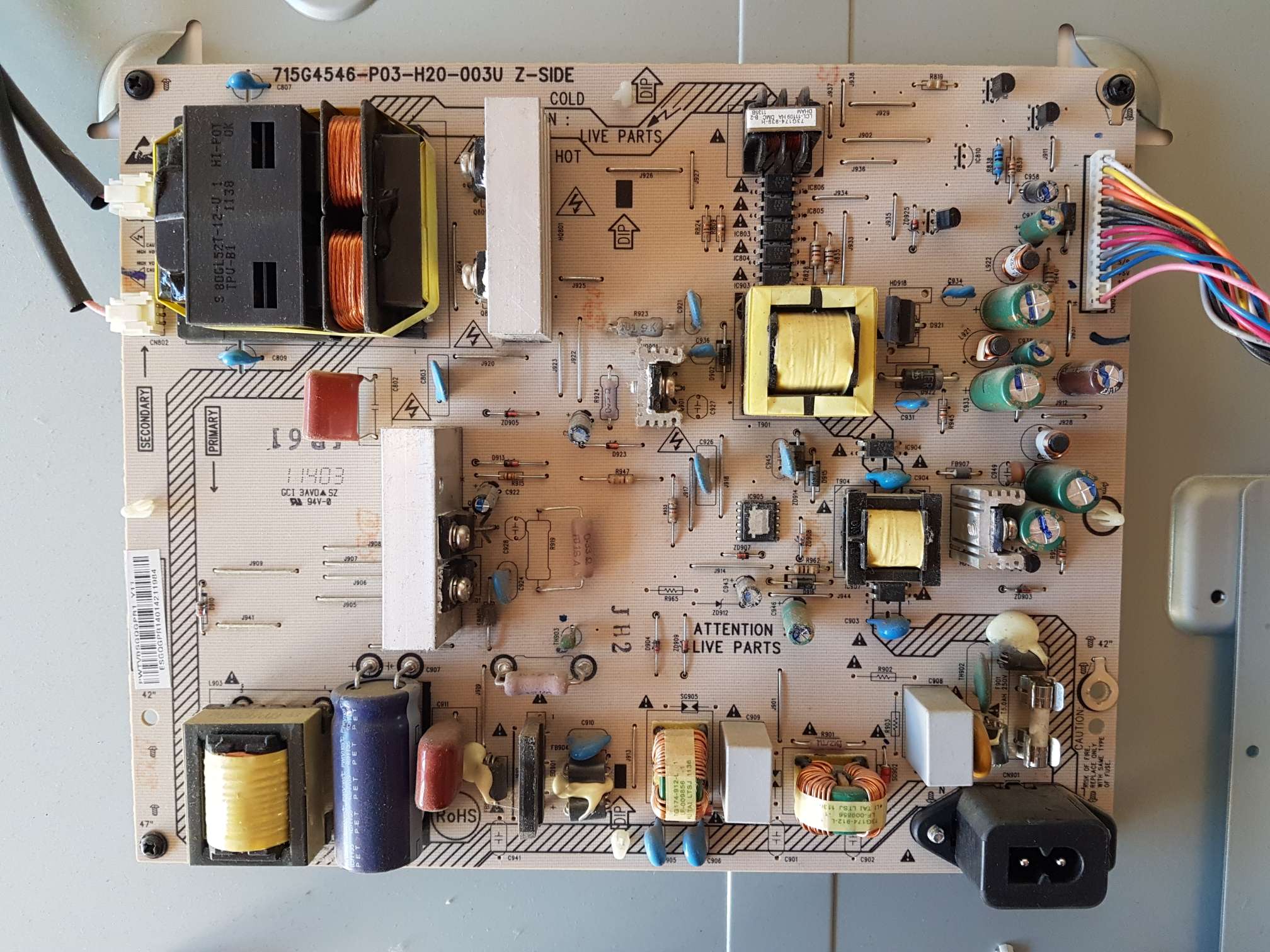

    Hi, I have LCD TV Philips 47PFL4606H/12 - there are any voltages on power supply.
    I chcecked fuse and it is OK, bridge rectifier (there are 330V DC), diodes, transistors and everything is ok - why PSU doesn't start at all? Maybe driver to produce voltages is bad? How to check that IC?
    Whole system drives 0.8W from wall adapter
    PSU board: 715G4546-P03-H20-003U

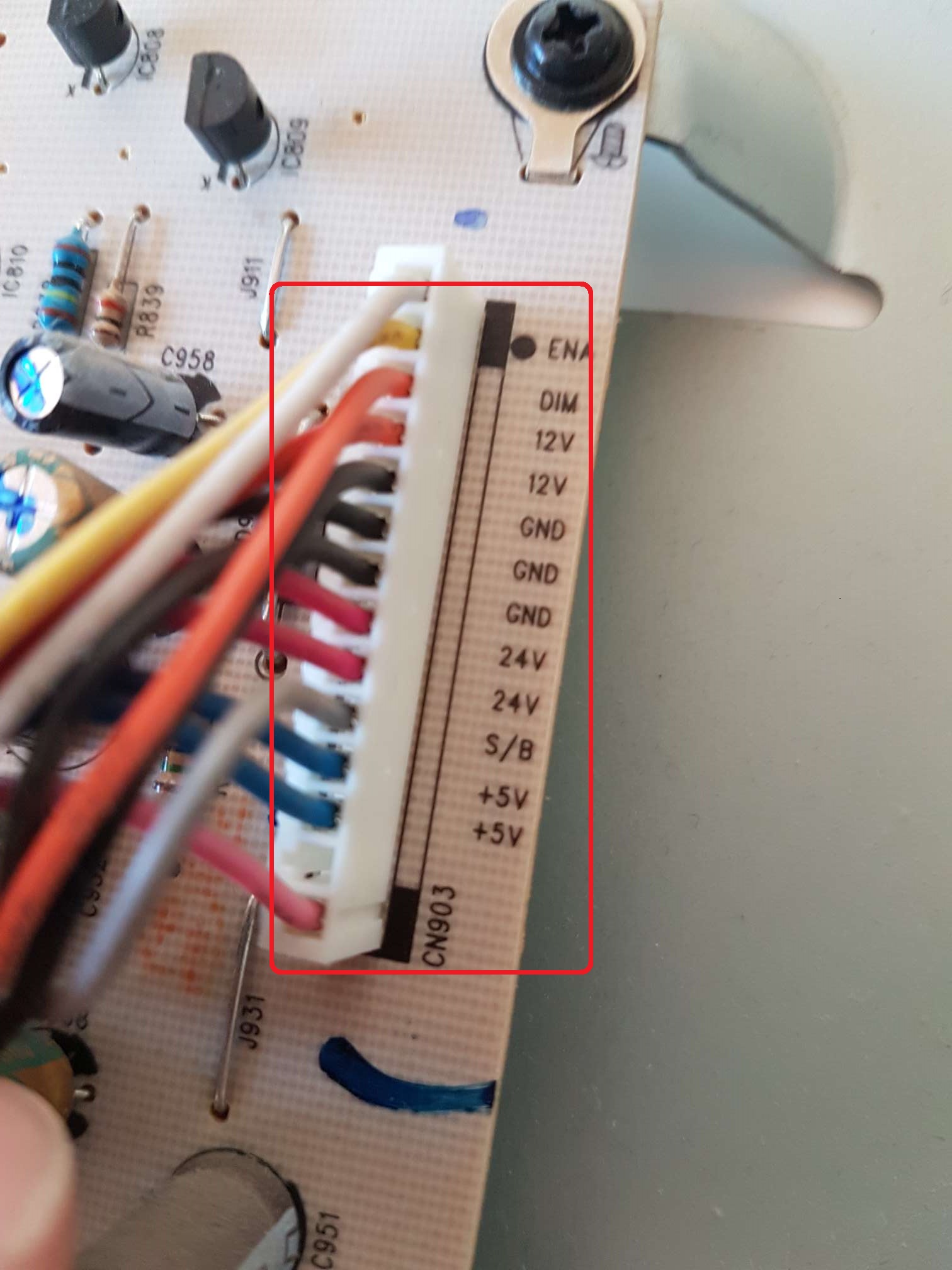

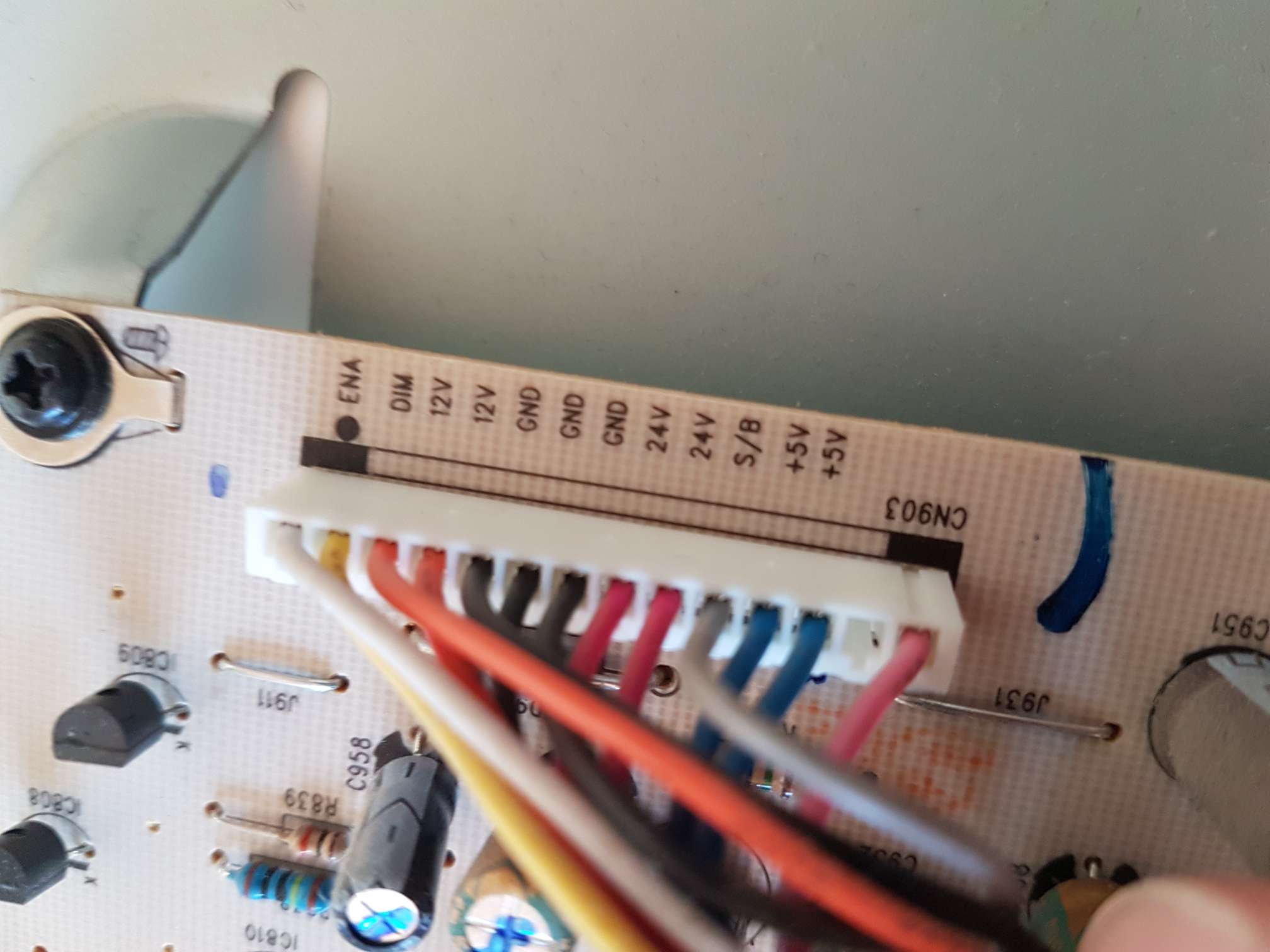

    Re: LCD Philips 47PFL4606H/12 - power supply doesn't start, no voltages
    on cn 903 (14 pic connector that runs from the p/s to the main board), can you let us know what voltages you have on every pin in stby and when the power button is pressed.
    eg
    pin no. desc. stby v. on v.
    1 ena 0.00 0.12
    2 dim 0.00 0.34
    3 12v 0.00 4.27
    4 12v 0.00 4.27
    5 gnd 0.00 0.00
    etc, etc
        eg
        1 ena 0.00 0.12
        2 dim 0.00 0.34
        3 12v 0.00 4.27
        4 12v 0.00 4.27
        5 gnd 0.00 0.00
        etc, etc
        On every pin are exactly 0.00V - so I think it isn't even in standby mode, also pressing button makes nothing change (there are touch panel, so I guess it isn't working at all because there aren't any voltage)
          Check the fuse and also what is the DC voltage across the two legs of the large capacitor.
          • Folxs
            • Nov 2016
            • 167
            • Poland

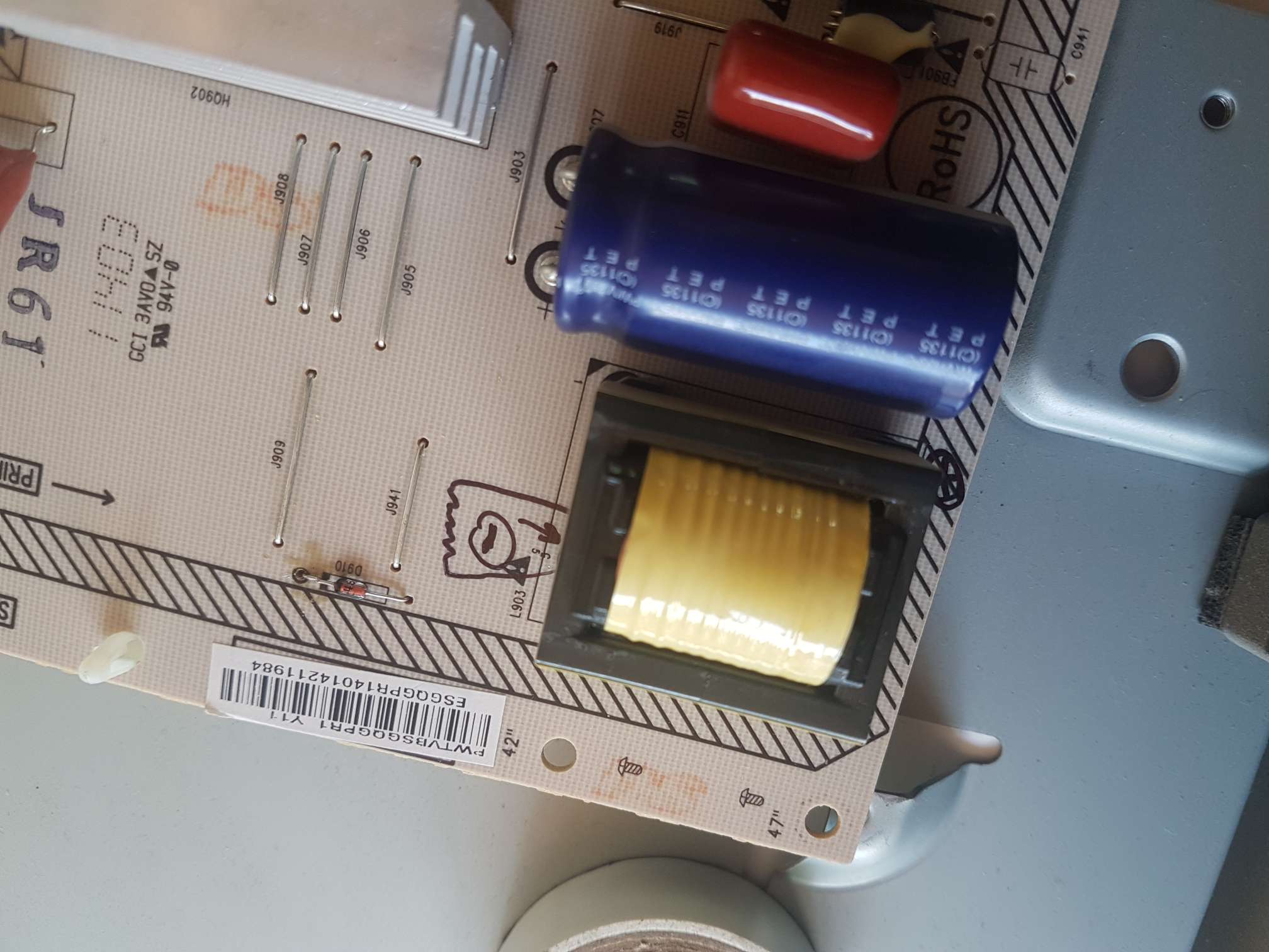

            Fuse OK, 330V on big filter capacitor

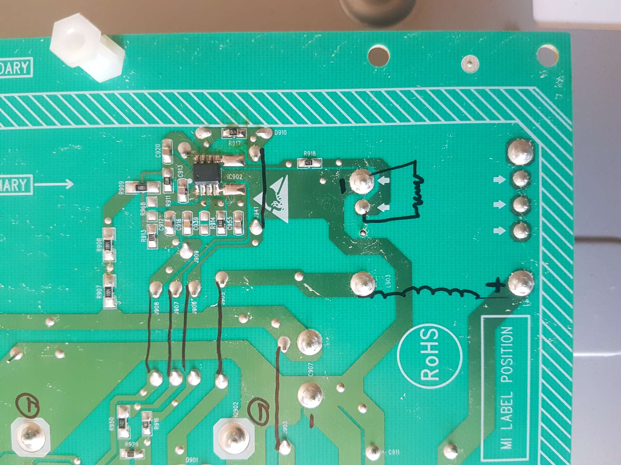

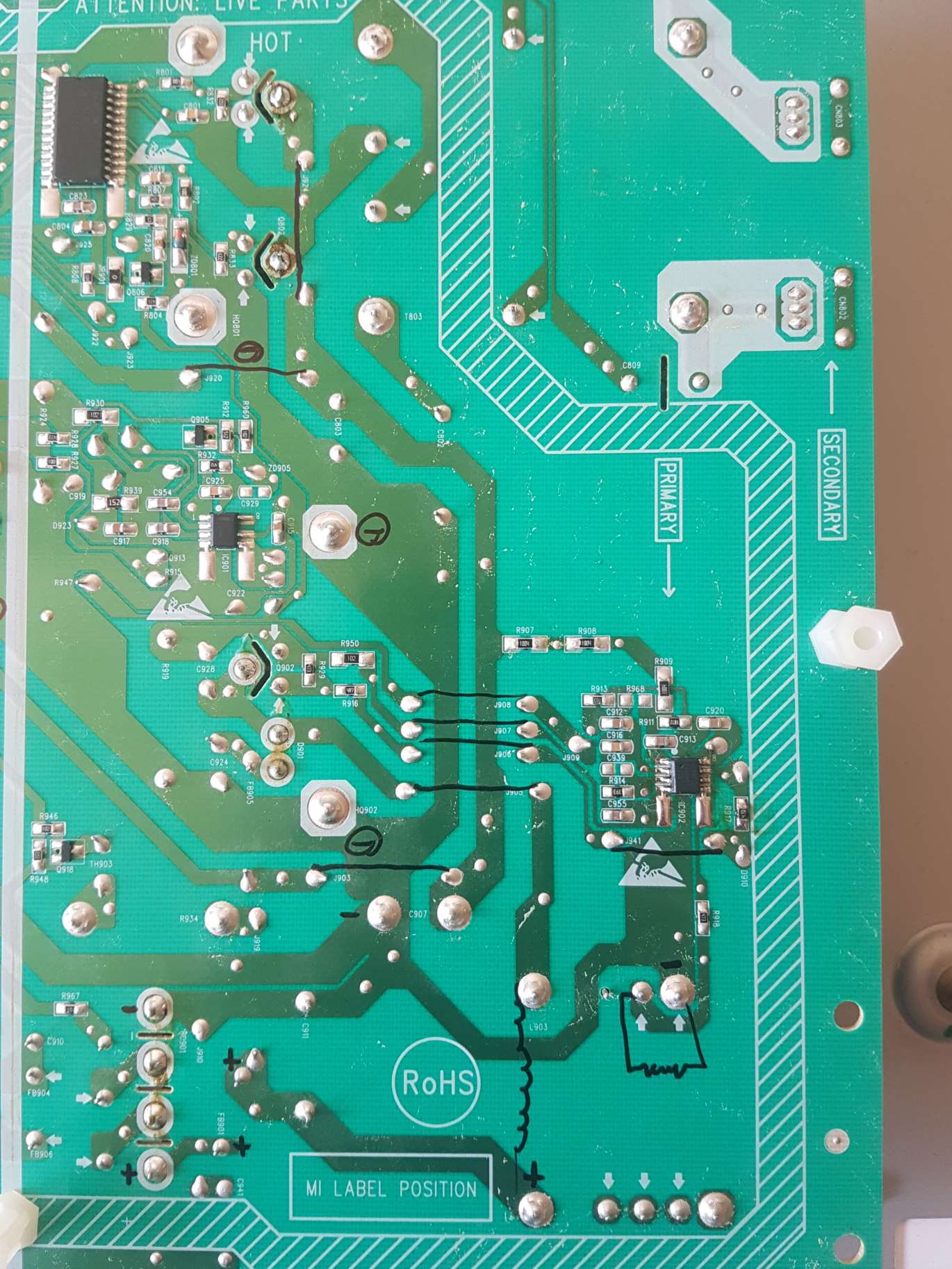

            There are transformer (with sharpy I made where goes windings)
            On primary there are 330V both sides of windings
            On secondary on one side is " - " and nothing is going on.
            This is connected to IC902 that is PFC controller FAN6961

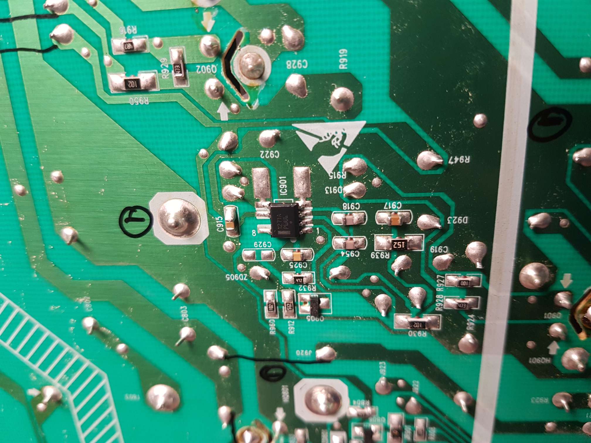

              What voltage do you have on the FAN6961 between pin 8 and pin 6 when you switch on out of standby.
              With the set off what is the resistance of R919 and what part numbers are the two mosfets.
              What has happened to IC905 and what is the part number
                1.
                I can't - because standby need to have standby volatage to power standby mode
                2.
                0.4V but in dead mode
                3.
                0.33 Ohm - measured 0.4 so it's fine (I have pretty crappy DMM)
                4.

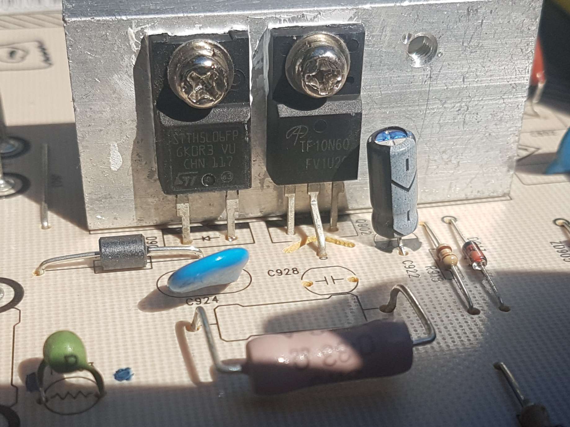

                Left one is Diode D901 - STTH5L06FP (Turbo 2 ultrafast high voltage rectifier) (Datasheet: https://cdn.badcaps-static.com/pdfs/...6525d4fea4.pdf )
                On the right we have TF10N60 ( 600V, 10A N-Channel MOSFET)
                (Dataseet: )

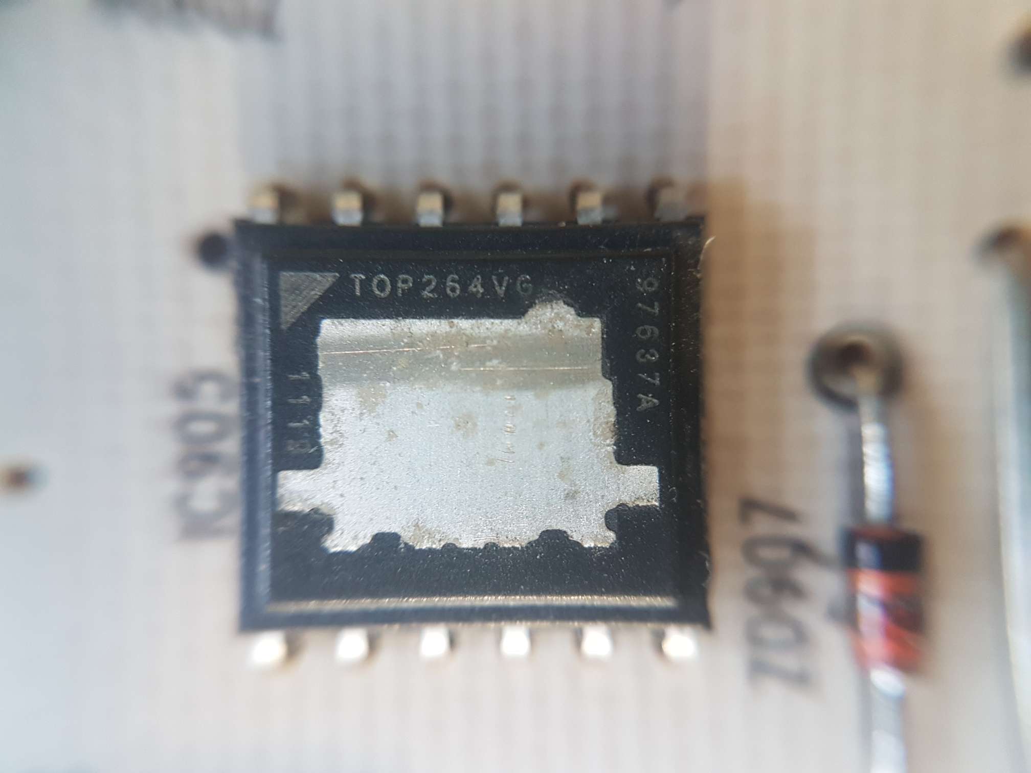

                5.
                This is original looking chip. TOP264VG (Integrated Off-Line Switcher with EcoSmartâ„¢ Technology
                for Highly Efficient Power Supplies)
                (Dataseet: https://cdn.badcaps-static.com/pdfs/...d132290b22.pdf )
                  I suspect the TOP264VG IC or circuitry around it is at fault because that supplies the +5V voltage. See page 54 of the attached manual
                    https://www.badcaps.net/forum/attach...0&d=1530882538
                    Try heating up or replace the two startup/running caps C943, 946 in the STBY power supply section. you should also check the Voltage right between the two legs of C943, 946 but you have to be really careful since they are in the hot deadly side of the circuit. You can test the power supply board by itself without having it connected to the other board, we just have to get the STBY power supply section working first.
                    Did you already check the rectifier diode on the heatsink to the right of the transformer T904 on the cold side of the STBY power supply?
                    BTW, did some one work on that power supply board before? It looks like there used to be heatsink on top of that IC905.
                      Can I test this IC somehow? Or just replace with new one?
                      Didn't helped - I measured them and both have good capacity and ESR
                      C943 0.00V
                      C946 - when I plug TV to wall there are 2.38V and slowly dropping to 0.00V (like a capacitor discharge)
                      Yes, it is double diode D917 - both diodes are good
                      I don't know, but i don't think so - there were no signs of even opening TV before me
                        This is an open top IC connected to the internal mosfet source connection.

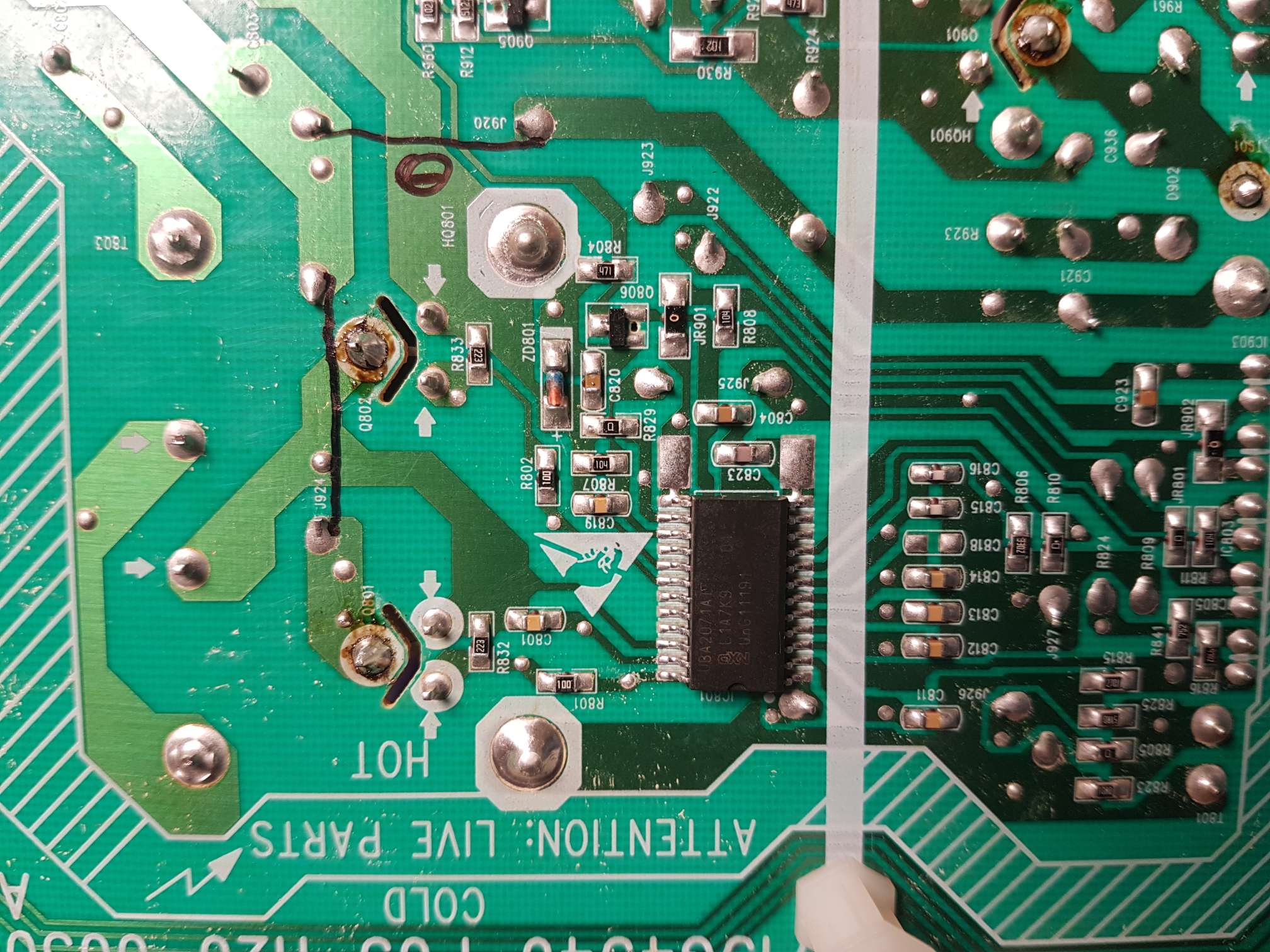

                            One more question - what is IC801 (UBA2071AT) on the bottom of PSU, this is for backlight?
                            And question about IC905 - it would start by itself, of something have to power that chip on first?
                            • dick_barton
                              • Aug 2015
                              • 6643
                              • Wales
                              It looks like it's a PWM to provide the 12V & 24V supplies. I believe it gets its voltage from T904 through R959, D916 & Q907 (which is switched on via the standby voltage).
                                      The first section to get working is the standby, You need +5VSB, Using [-] of C907 for ground (HOT GROUND) Check the voltage on pin 6 of ic905 (use anode of D915), then check the voltage on pin 1 (anode of ZD908) and pin #3 (zd907 cathode)
                                      Also check the voltage across ZD909, If it is 0 volts, check if the zener is shorted
                                      It is very likely that IC905 is defective if you don't have standby voltage
