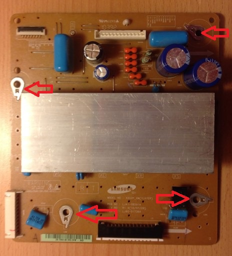

    Did you replace all the securing screws back in tightly before you powered up?
    When you replaced the components did you check there was no short circuit between VS and chassis and VA and chassis?

          Re: 42u2p y & x problem
          Originally posted by Mrnixdorf
          What's "securing screws back in tightly"??? where are they?
          Thank you
          As shown in the photo.
          • Mrnixdorf
            • Sep 2016
            • 119
            • Morocco
            humm, no i didn't touch them at all.
            Must i change them or remove them???
            They are well placed, and they are connected to GND. what's the matter there?

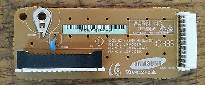

                          In results, im connecting all the boards and cable expect the 42u2p_xb board, the tv turn on normally with black screen, when i connect the 42u2p_xb board the same component burn again.
                          Please help me out

                            I connected the board without the ribbon cable connected, no issue, seems a problem with light panel, is there a way to disassembly the screen fron the light panel to check out?
