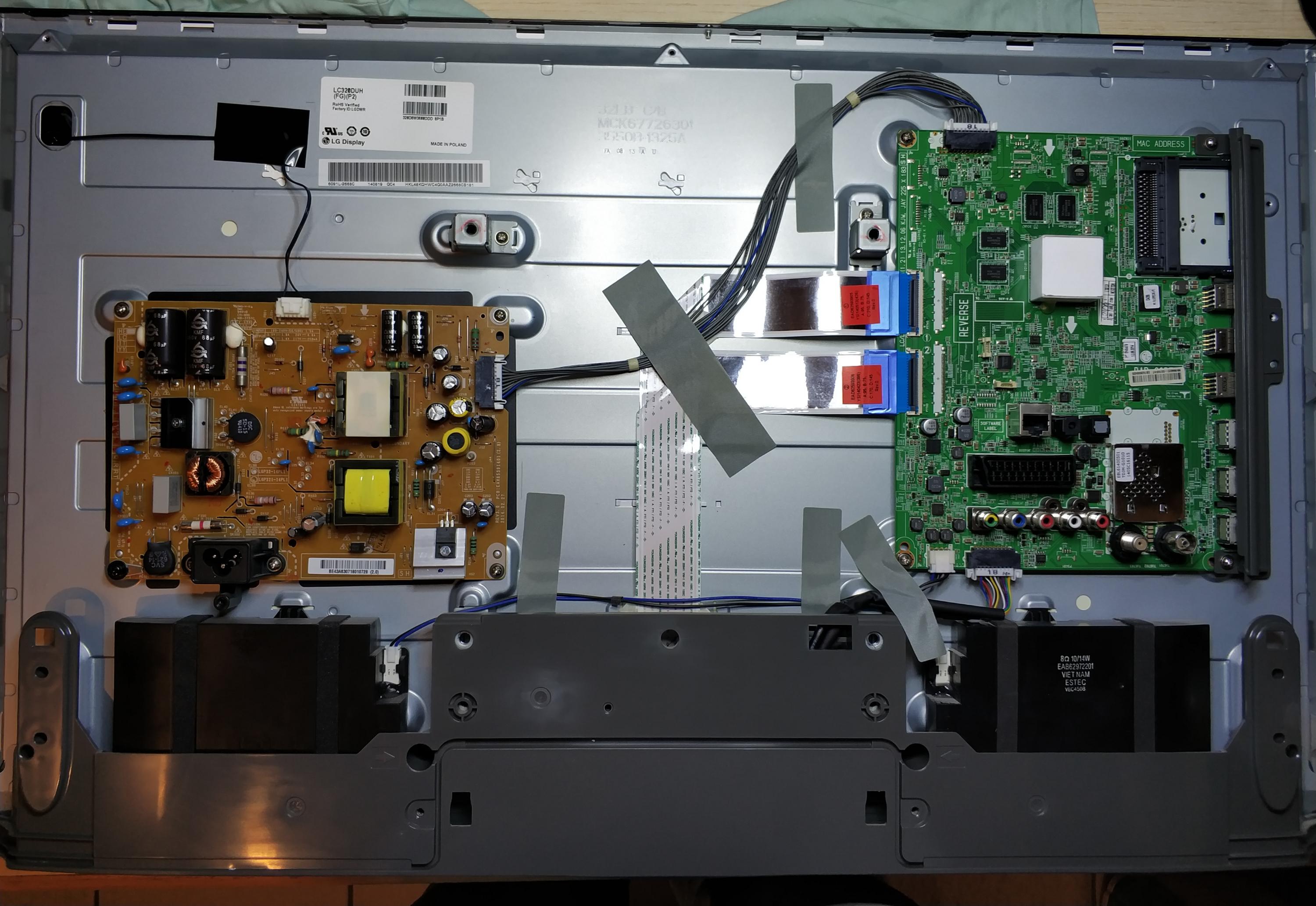

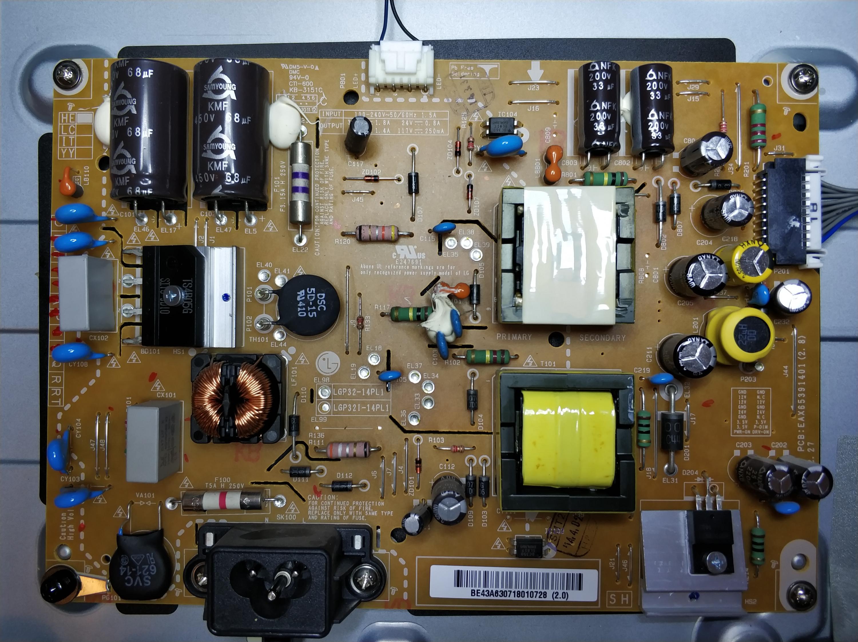

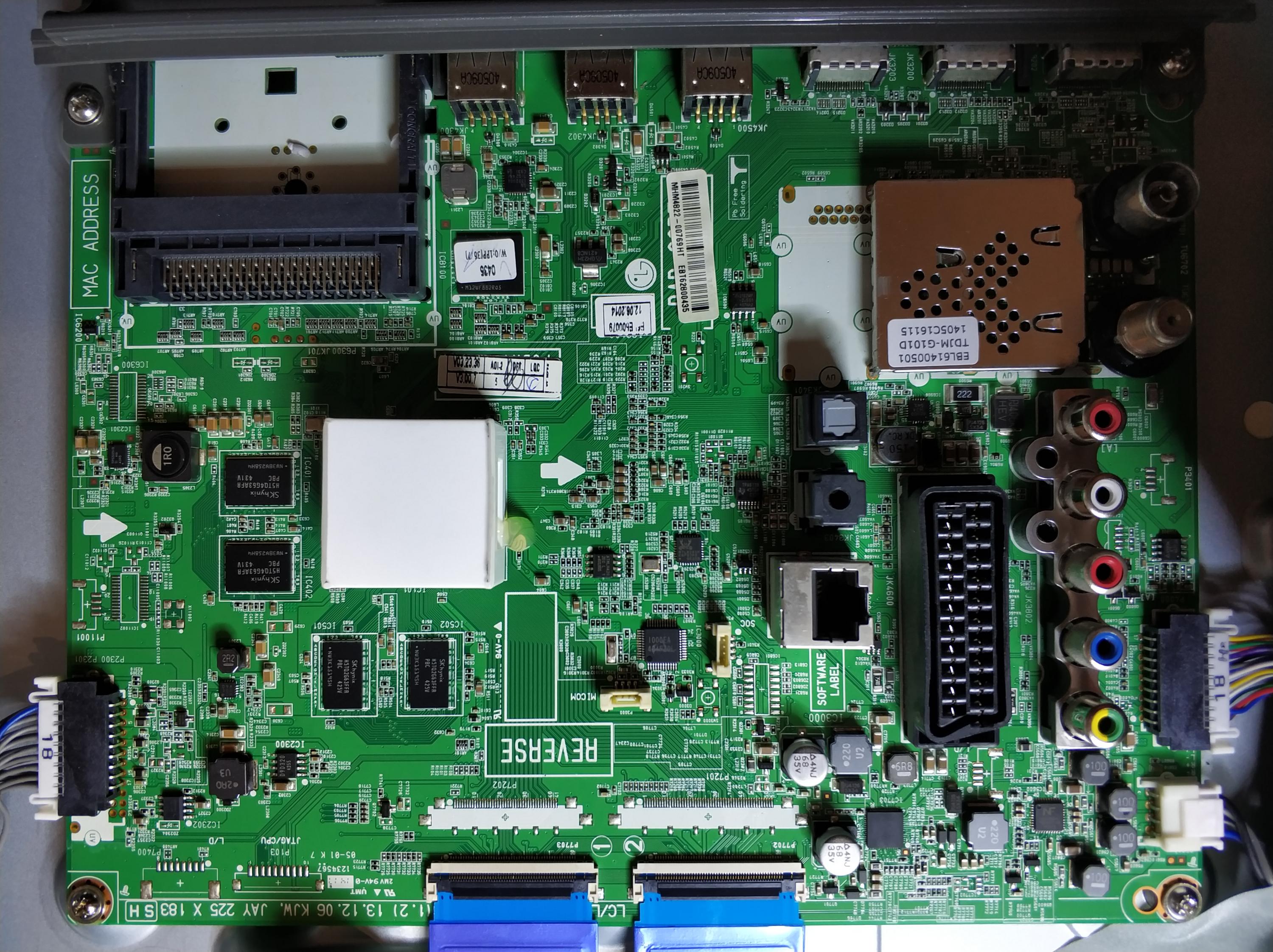

    Hi, I have this LG TV that doesn't work.
    When I plug a/c cord nothing happens, except the stand-by led that flashes 4 times (the first blink is faster than the others).
    I have tested the voltages on the power board and everything is fine.
    Is there something I can check to find the problem?

        From the reading you have posted it would appear the PSU and Main Bd are OK. Post pictures of the boards and maybe we may be able to help further.
          Re: Lg 32lb650v no video,no audio, nothing
          I have already posted pictures of the boards, you need the back of the two boards?
            OOPS!!..I missed that. OK so with the TV OFF, place the RED probe of your DMM on the +ve pin of the backlight connector and the BLACK probe on the chassis GND. Turn on the TV and record and post your findings. Then place the RED probe of your DMM on the -ve pin of the backlight connector and the BLACK probe on the chassis GND. Turn on the TV and record and post your findings.
