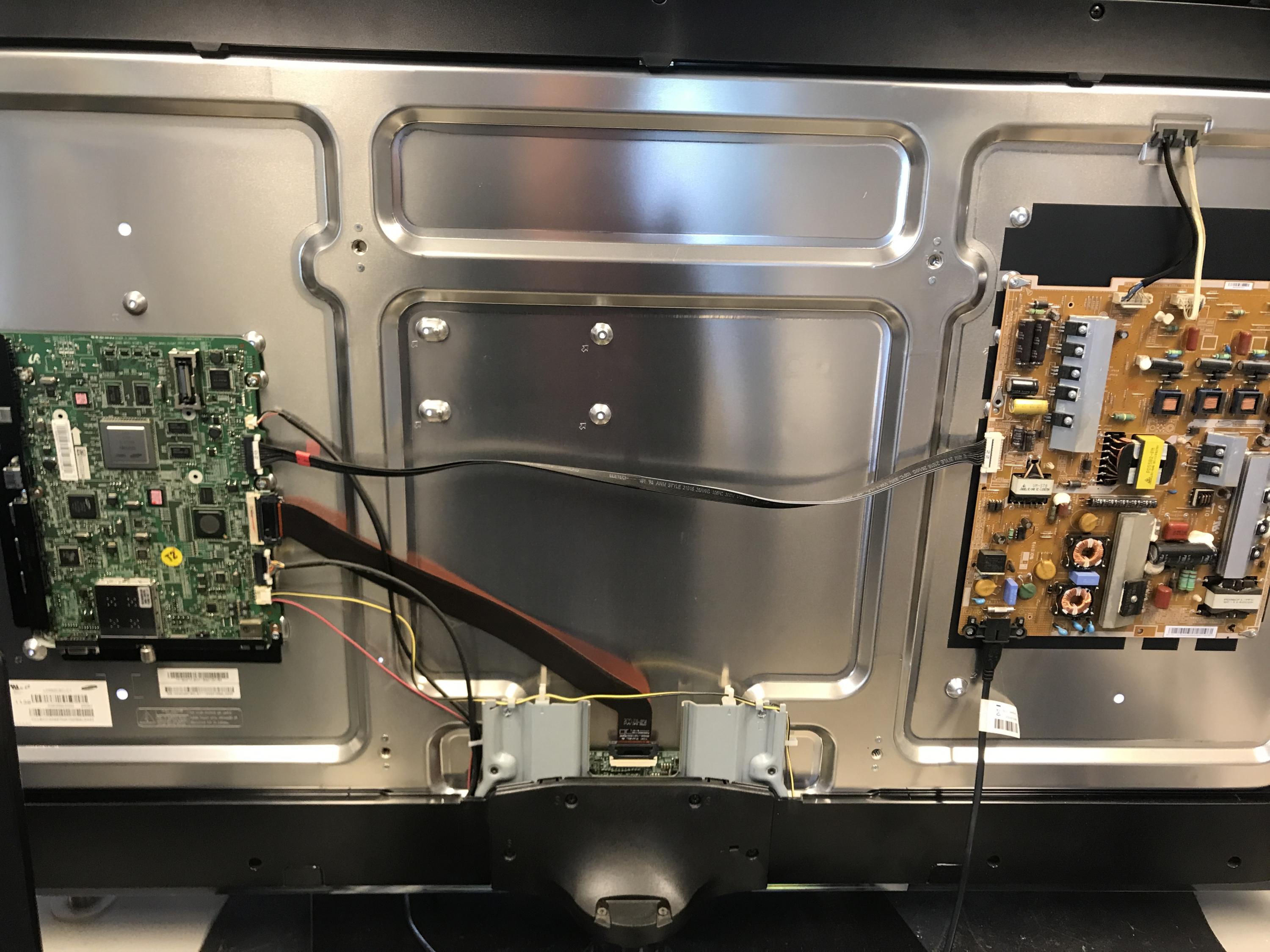

    Another freebie I got SAMSUNG UE55D6507 chassis U69A, but this one also looks like it will have to go the scrapyard, unless some of you clever people can give me a hint with some magic
    (I dont have the remote control for this one)

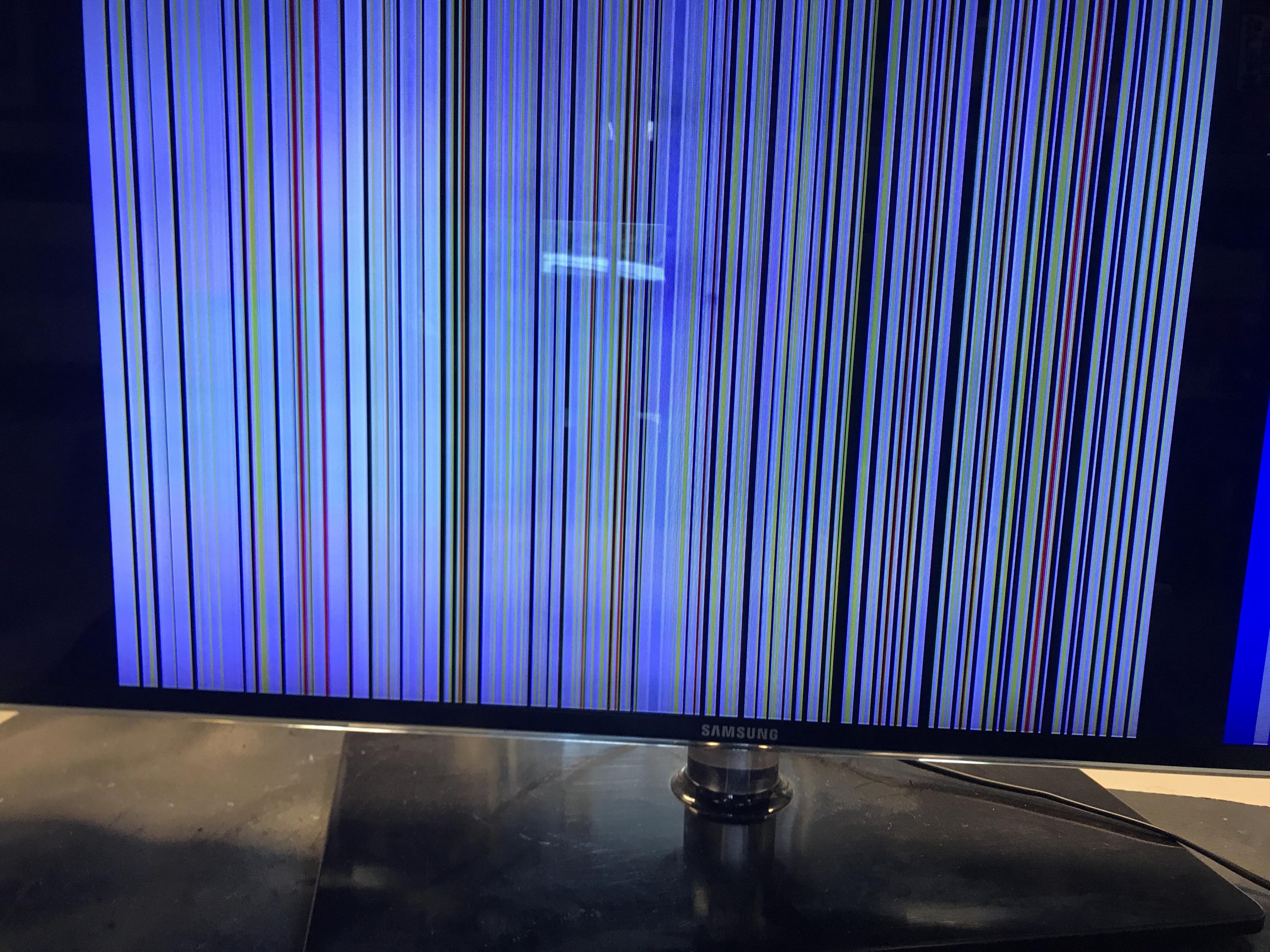

    Symptom : Vertical lines/bars at bootup, see attached picture

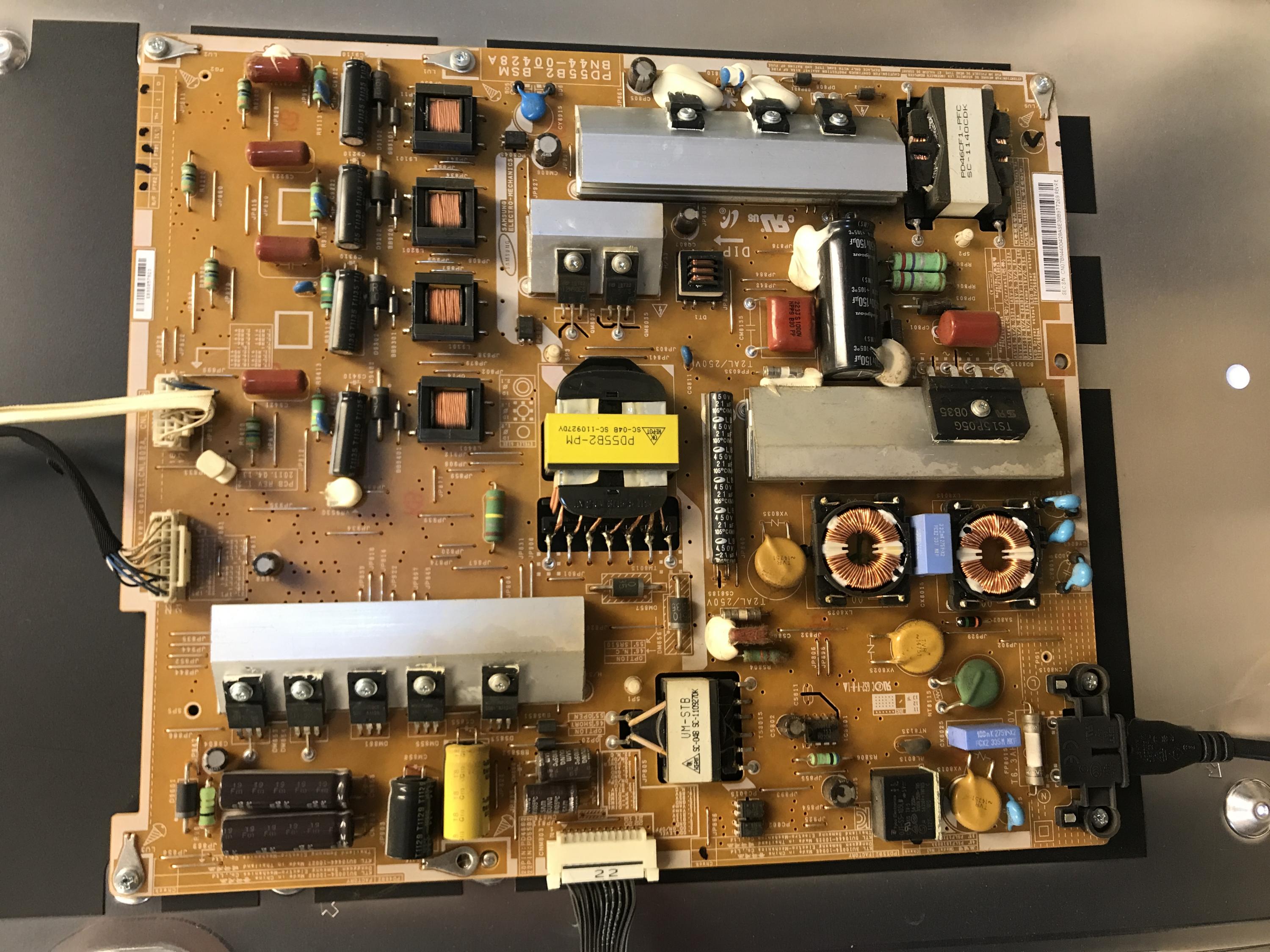

    All voltages from power supply OK
    Backlight OK

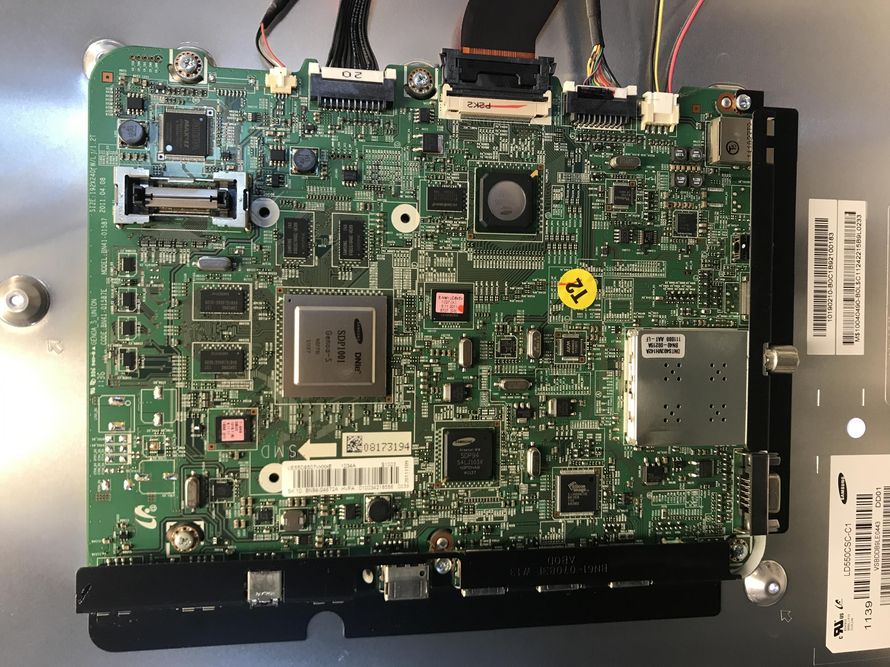

    My guess : Bad mainboard....
    I will be happy to be corrected
    Service manual + chassis pictures + screen picture attached

    Re: SAMSUNG UE55D6507 - vertical bars / lines
    Clean and re-seat all cables and connectors at both ends of each to and from the T-CON Bd. Yes it could be a Main Bd. issue or it could be a T-CON Bd issue, also. Not ruling out the Panel, as a last option mind you. Do you have an Oscilloscope??
        Do as I suggested in Post #2. Then we could test the LVDS to see if we have signals from the Main Bd.
          its panel fault 100% water damage
                Hello
                I had the same problem on a samsung UE48C6700.
                I solved it by pressing one of the motherboard chipset with an inner tube wedged between the chipset and the TV cover.
                Try on all the bga on the motherboard, mine works very well for 2 years now .
                In my house it worked.
