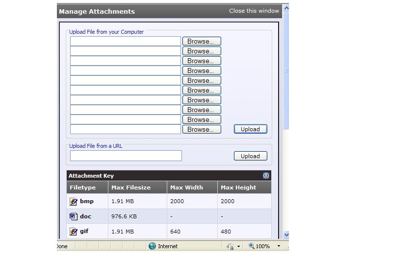

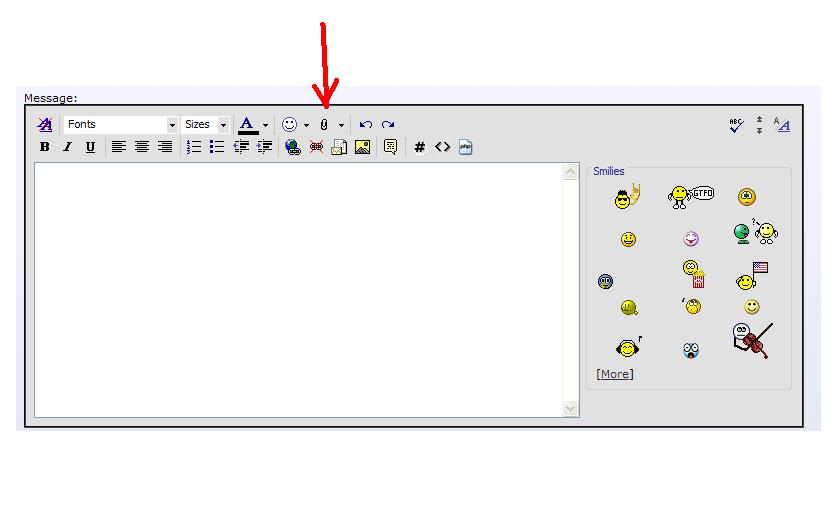

                            To upload a picture, click on go advanced and click on the paper clip next to the smiley face, then browse to your pictures, then click upload
