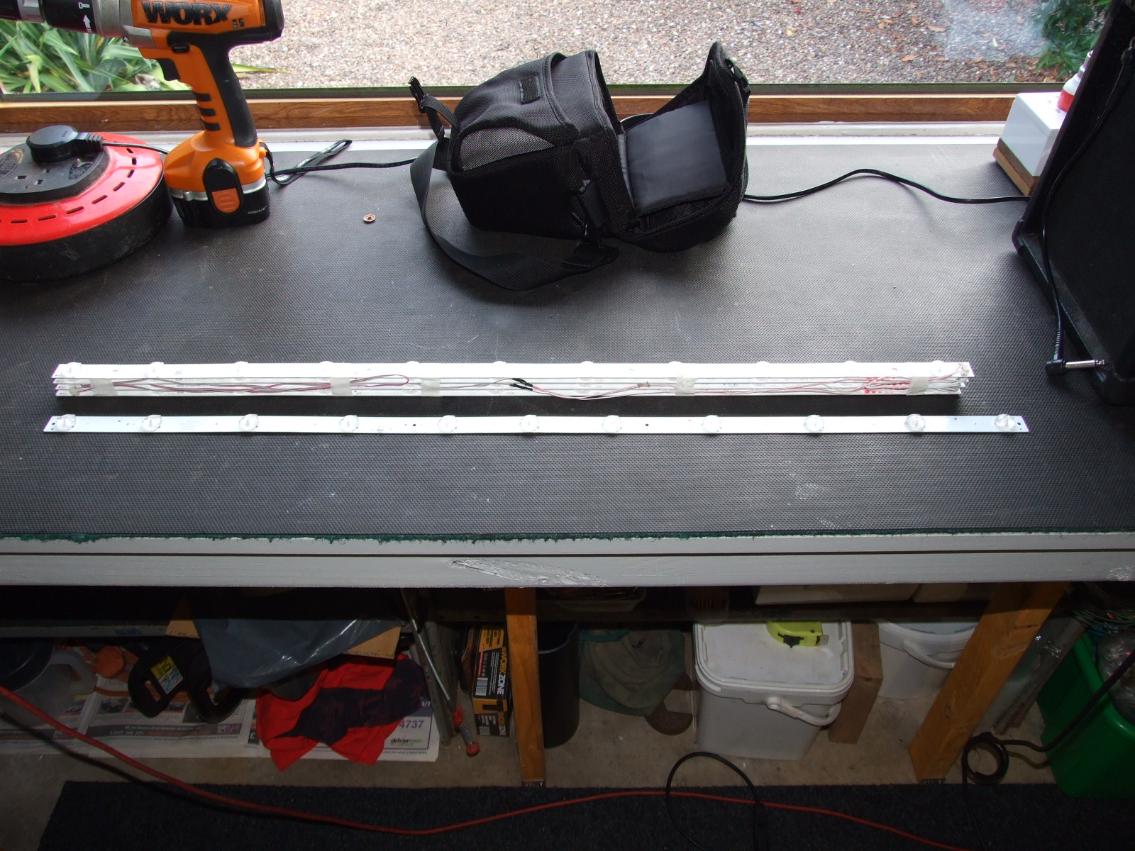

    Hi all ... below are photo's of the 4 x 11 LED strips.
    The TV is a no name 41.6" Aldi branded Altius A-400F.
    Fault is one strip is out so one or more failed LED's

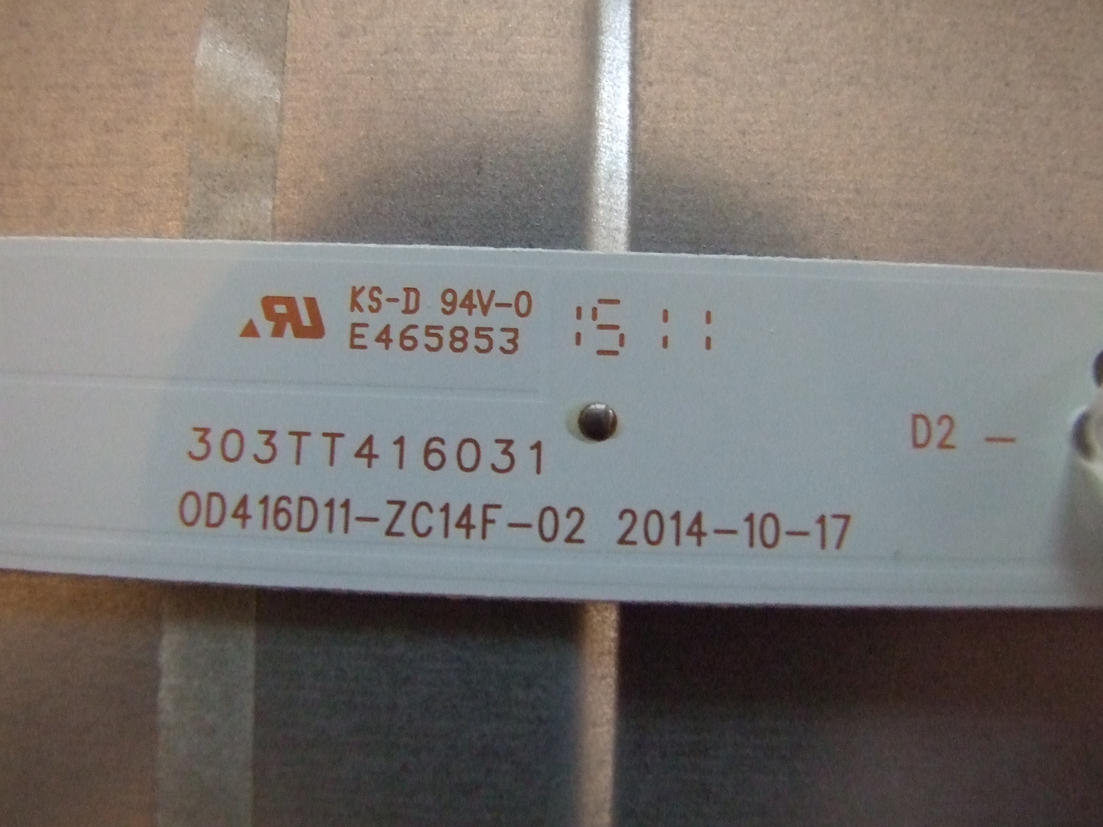

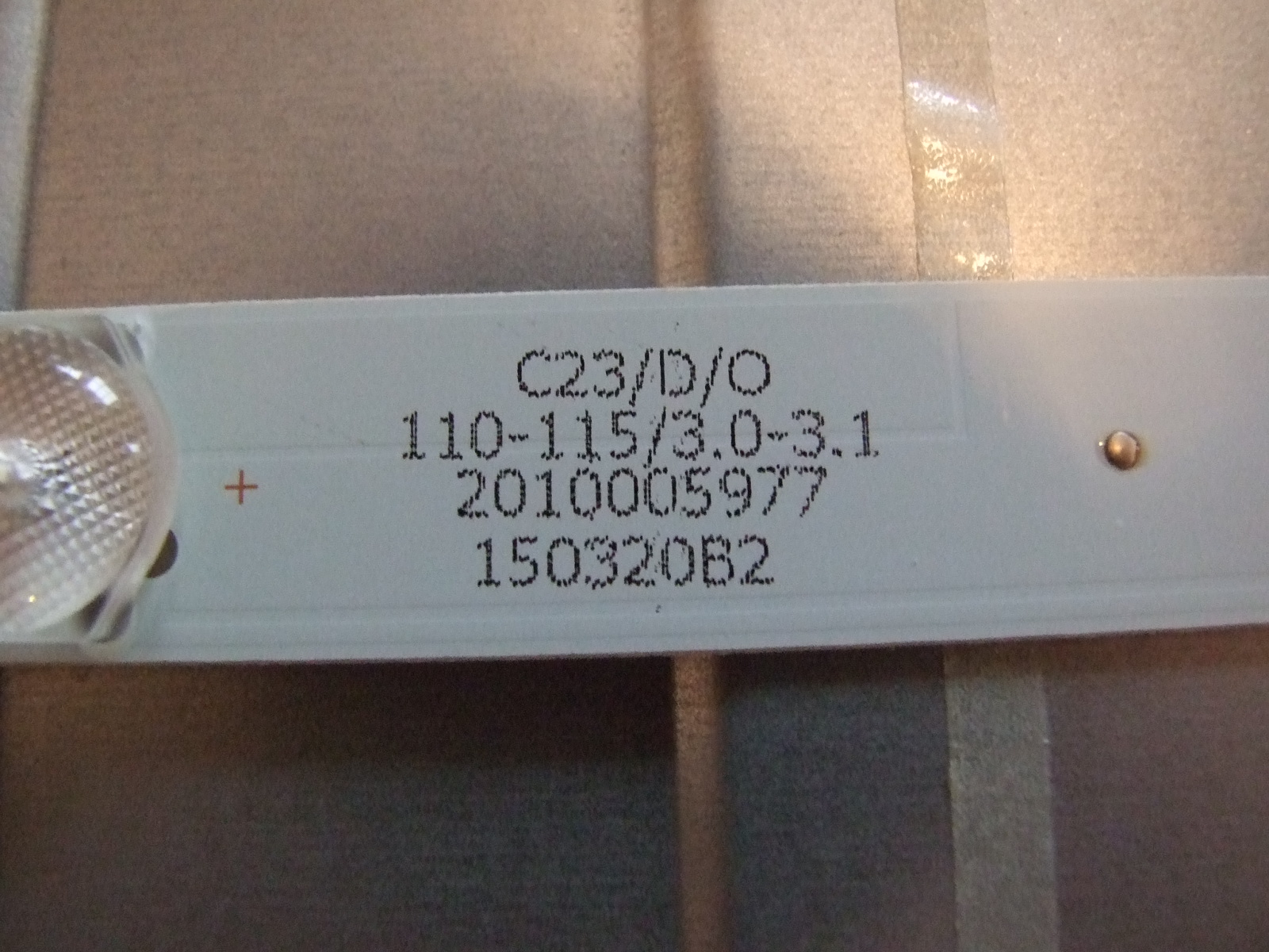

    Can't find a direct replacement or any info for the OD416D11-ZC14F-02 strips.
    Panel is a CHI MEI INNOLUX V420HJ2-PE6

      replacement exist, see here.
      Cheers, Janos

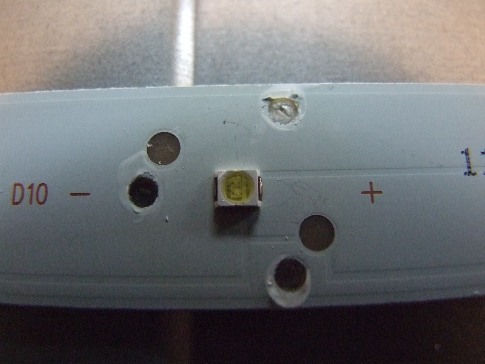

        Already did it ... in the pic below the LED width is 3.5mm and the height is 2.8mm.
        I know what you mean about the polarity for the SMD pads ... do you need me to take one off to see which is the large pad?

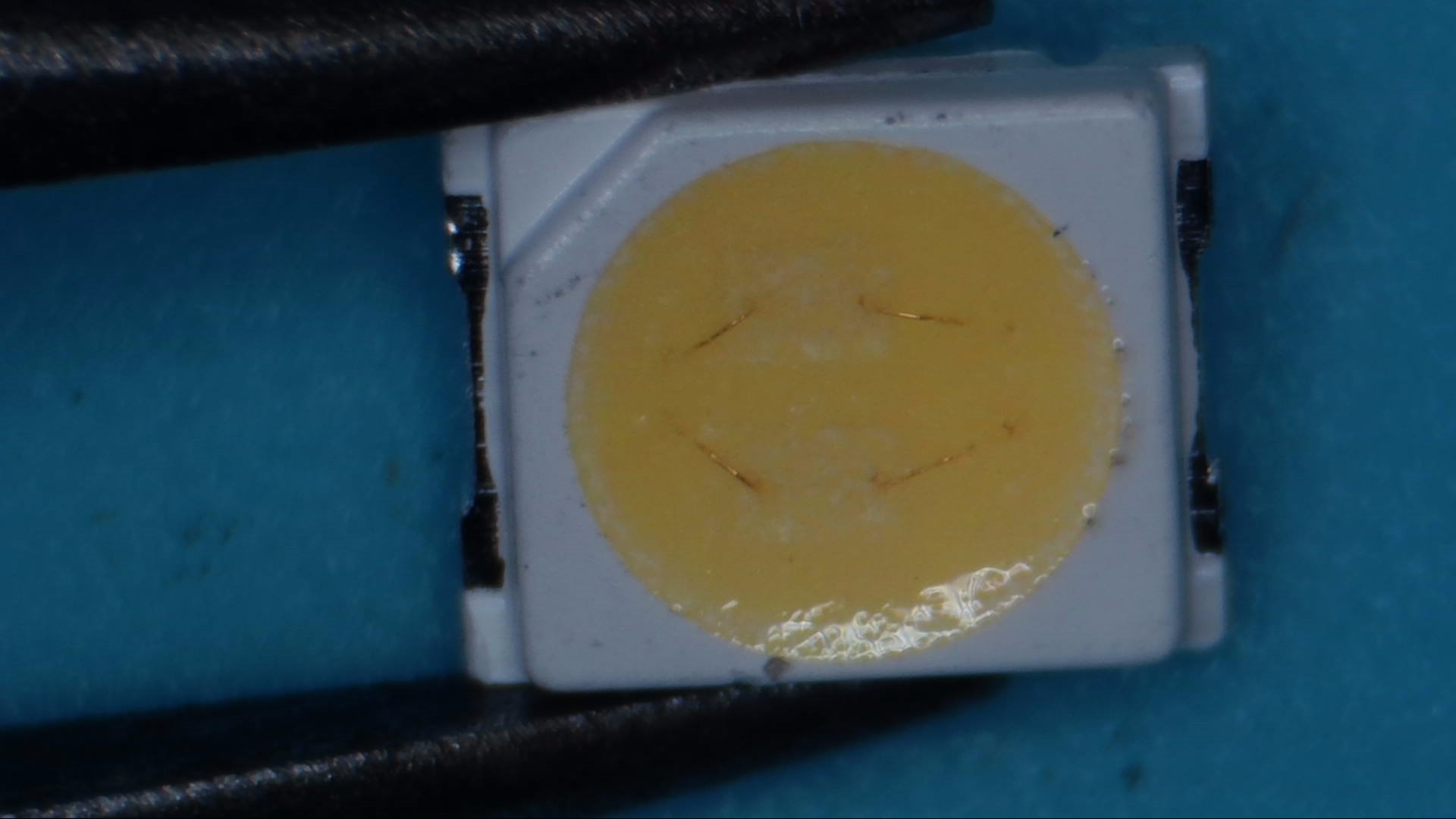

          What a nightmare this is turning out to be .....
          Ordered replacements from China as detailed above ... advert stated the correct serial numbers (as above) but they have sent the completely wrong parts: 4 x strips of 11 (HL-3F750A28-1101S-03 A2 E334789) the lenses look the same but the strips they have sent are for a 32" TV and the one I have here is 42" ....
          I've popped one of the lenses and the LED's although same size and very similar to look at appear to have a slightly diffrerent colour temp when testing them with my MM.

            The LED's I need are 3v 3528 or 2835 but seem to have two light emitting elements like the attached image (this pic is a lot clearer than my photo above).
            They are a cold (high) colour temperature when lit dimly with my DMM's diode test function.
            I've just wasted £30 trying to get replacements from China ... can anybody help me find replacements of the correct type from a reliable seller?

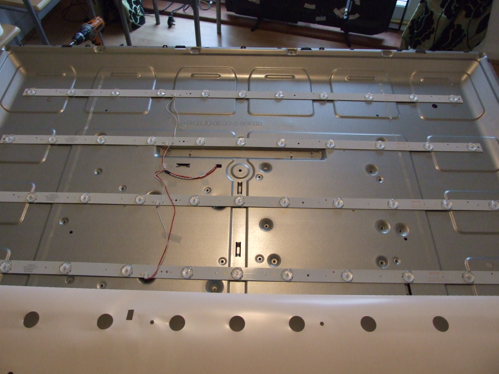

                Here's a turn up for the books though ... the chinese supplier has got in touch with me through the yoycart agent and is adament that although the set they sent are for a 32" TV they are a direct replacement for the correct original serial number and that is what they usually send out as a replacment for the 42" strips I was looking for.
                I replied that they do not line up with the holes on the back white reflector sheet that goes over the LED strips ... and he has said that instead of putting them behind the sheet with the holes in that I should stick them to it on the front of it instead.
                I have no experience with this ... what do you think?

                  Re: Replacement LED's for OD416D11-ZC14F-02 LED strip?
                  The LED strips get warm/hot so sticking them to the plastic backing is a silly idea IMO.
                  If you are going down that route then stick them to the metal backing as they were originally and cut new holes in the white sheet.

                    When laid side by and centre to centre there isn't a huge amount of difference between the two different strips ... the centres of the outside LED's on each end of the shorter strips are 22mm in from the ones on the originals when the centres are aligned... do you think using these would light the screen properly?
                    Looks worse with the two ends starting together ... but centre to centre the spread looks a lot better. Here's a pic to give you an idea of the difference. (original correct strip in front)

                      The Chinese replacements will work but as previously advised you would have to ct holes in the reflector paper for the lens to pass through. I have stuck strips on the paper before on other TVs and they are still working, but the better thing to do is cut new holes. Wherever there may be a gap the Diffuser sheet will spread the light out evenly so don't worry about that.

                            You can do it like this too. Stagger the strips placement. That is, put the 1st one fully left then the 2nd fully right and so on. The Diffuser sheet w3ill take care of the spread. It works don't worry

                                    Max. Forward Current: 350MA
                                    Max. Forward Voltage: 3.0-3.6V
                                    on the 3v leds i brought recently
