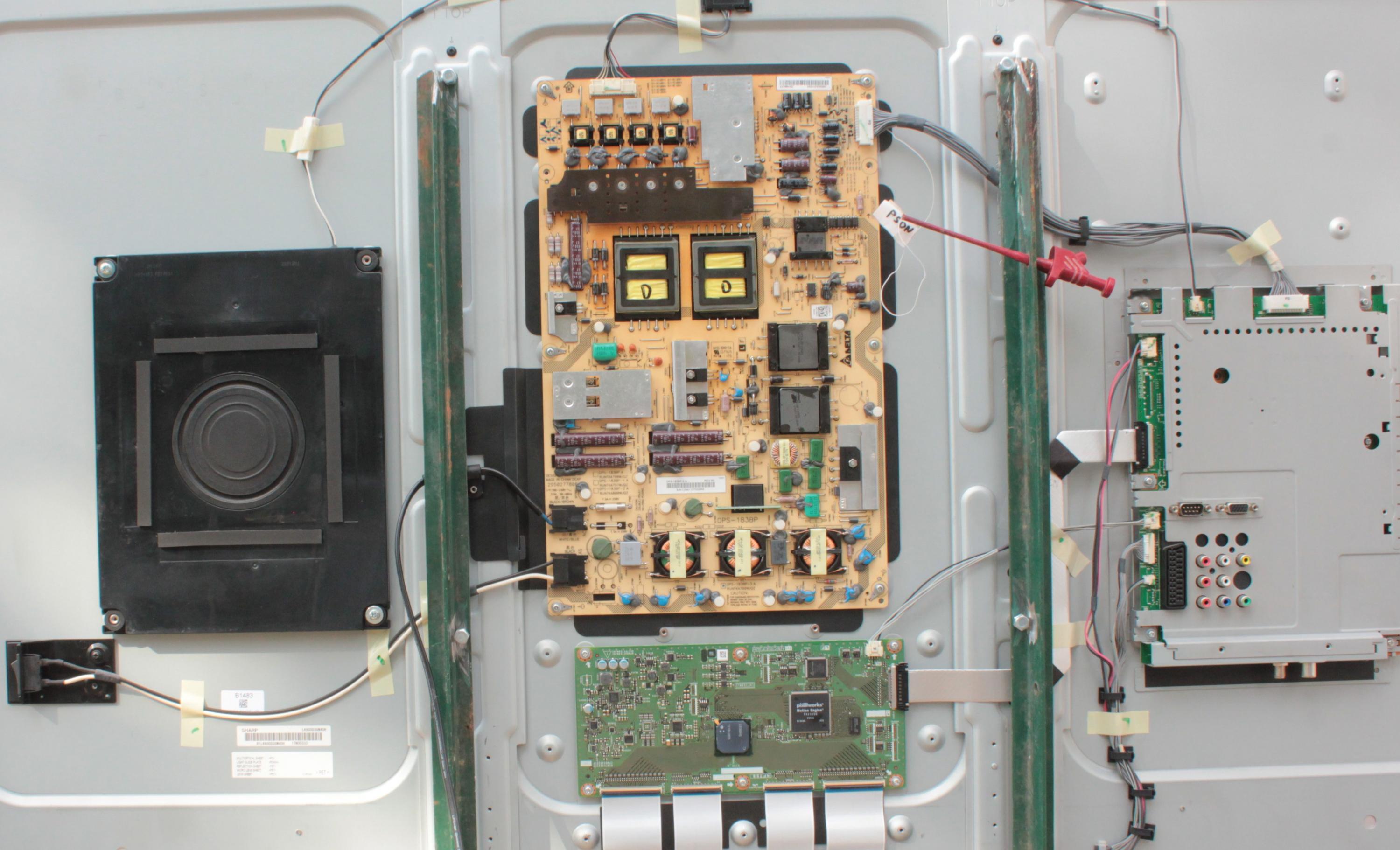

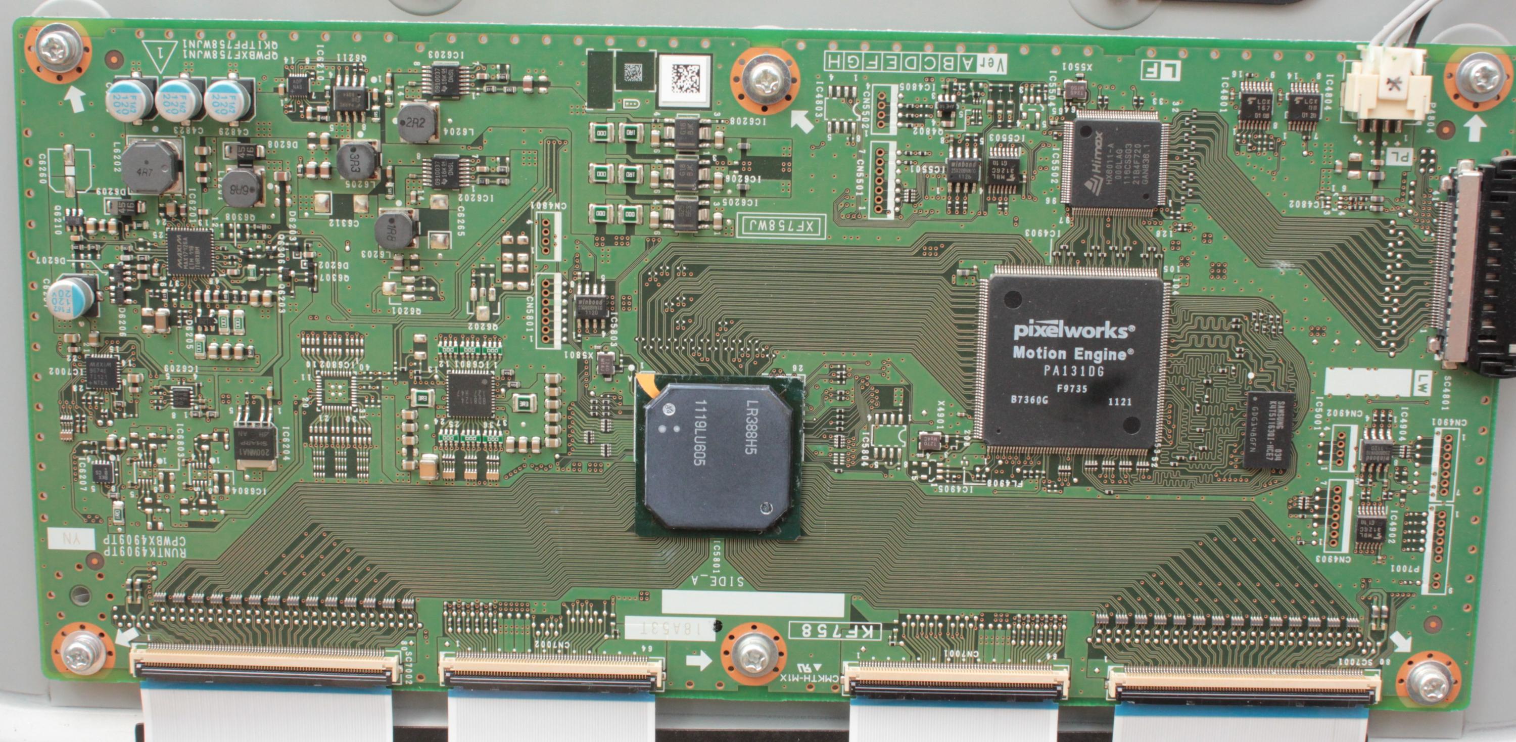

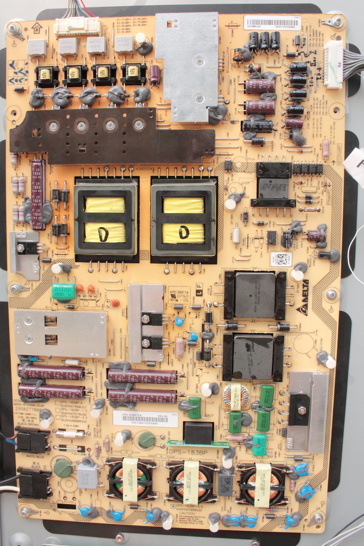

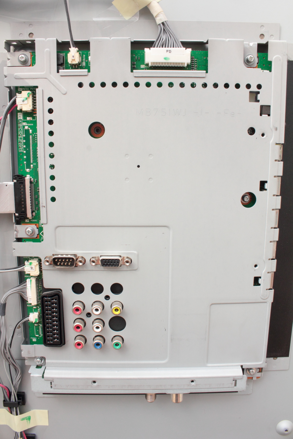

    Re: LC60LE830E Error Lamp,No control
    Hello again
    some pictures of the electronic boards.
    If it can help, I still have no track since my first post.
    A track to follow, additional information has given?
    Regards ,
    Thierry
    https://www.badcaps.net/forum/attach...1&d=1529079895

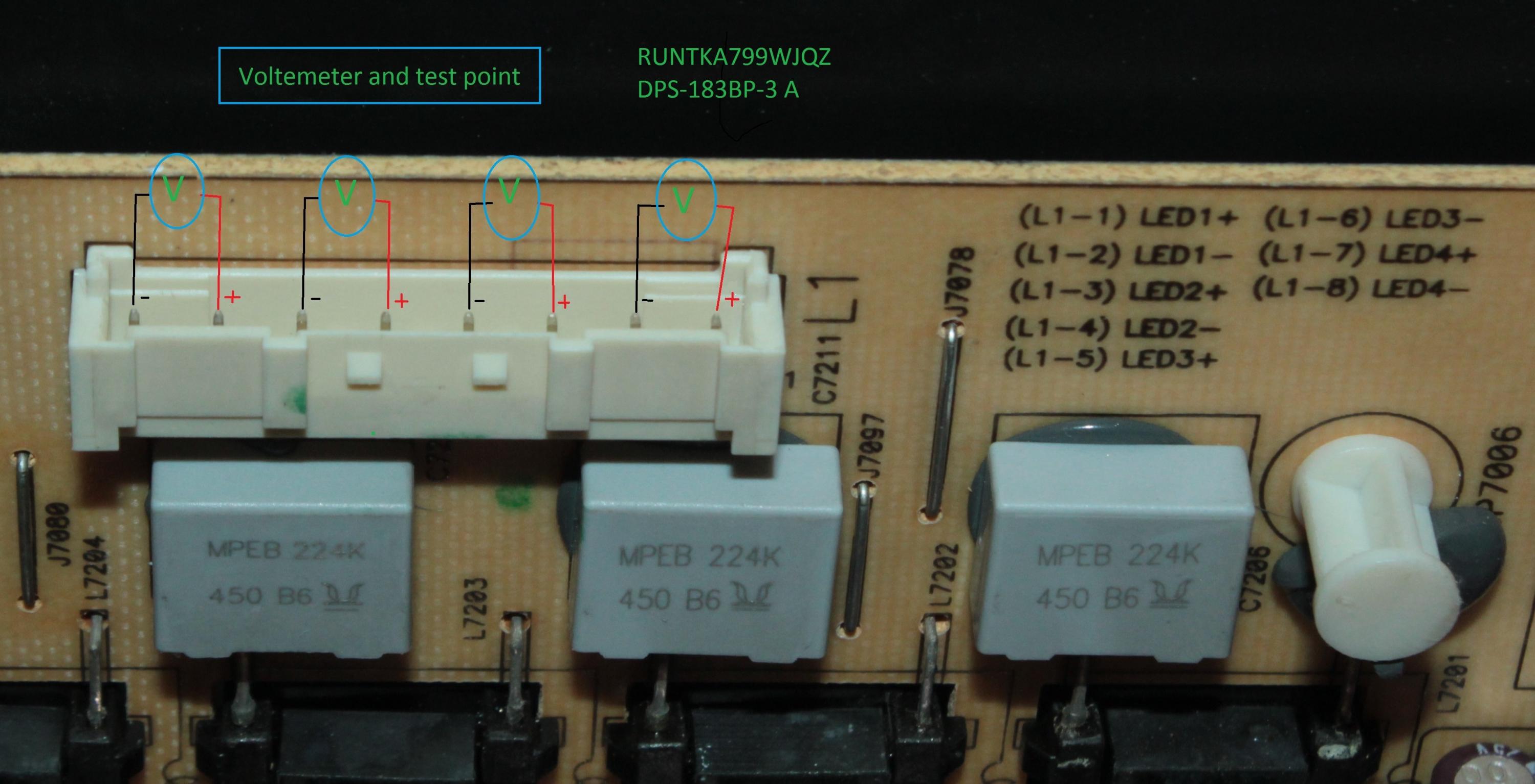

        Do you measure any voltage onplug L1, led1+ and led1- ? also check led 2,3 & 4 . voltage should comeup when first turned on then might drop off if there is an error (bad led)

          Hello Yohnsee and R J
          Thank you for your help.
          I made the four electrical measurements at the requested points
          See the attached photo by forcing PS- on each measure.
          There is absolutely nothing, none mounted in voltage even for a very short time.
          My meter is a Meterman 34X.
          I remind you that I never have a PS-ON command coming from the motherboard.
          So I unplug the PD conector and I force the power supply by connecting PS_on and BU5V (5 volts).
          On my first post, all measurements done are indicated
          But I have no AC DET in standby mode on the power supply.
          It's normal ?

                  AC_DET usually uses a 6 pin ic like ST9S101-T6G, there are a couple high value resistors off the a/c line that connect to the IN1 pin and and output on NDFPO pin drives the opto pin1. The ic FPO pin enables the standby ic.
                  On your board it should be IC7902
                  Since there are no schematics for these boards, one must use other versions of delta power supplies and good pictures to trace the circuits. and yes it's a pain in the ass.
