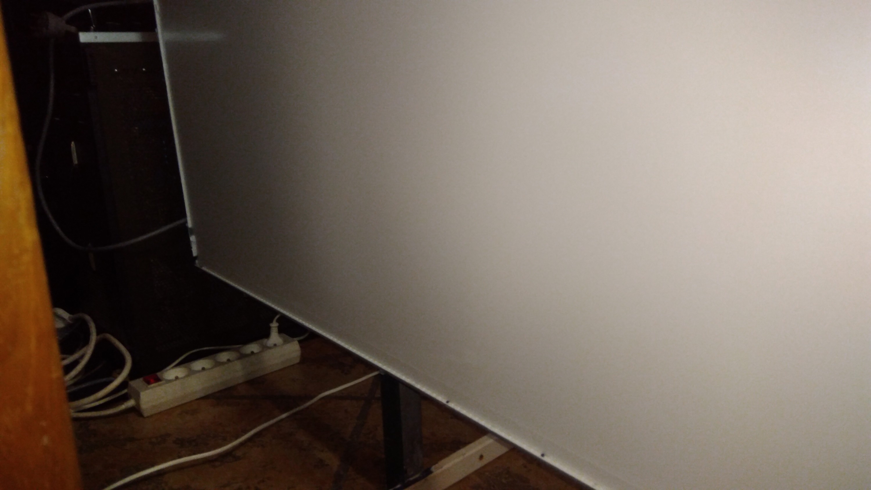

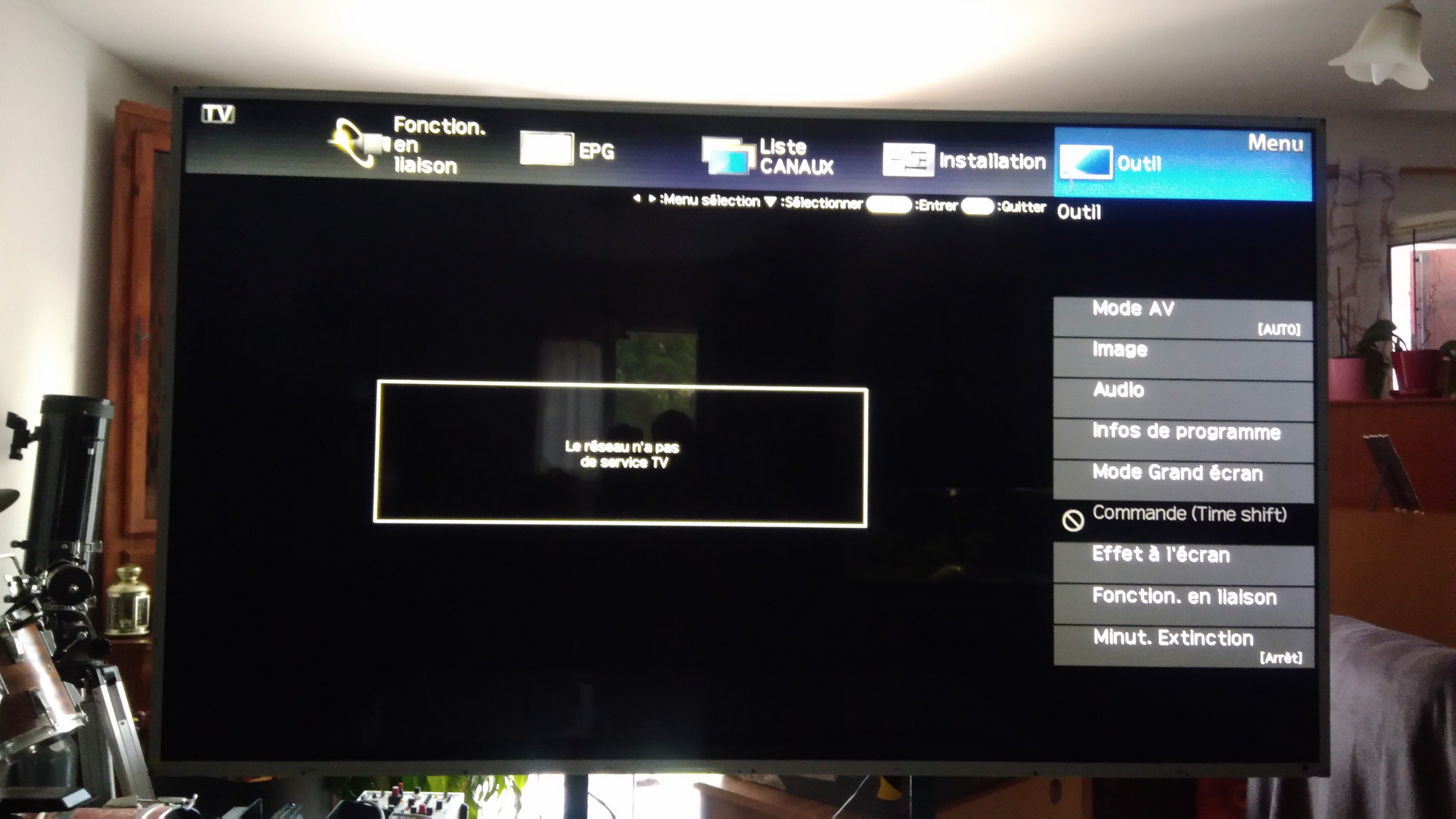

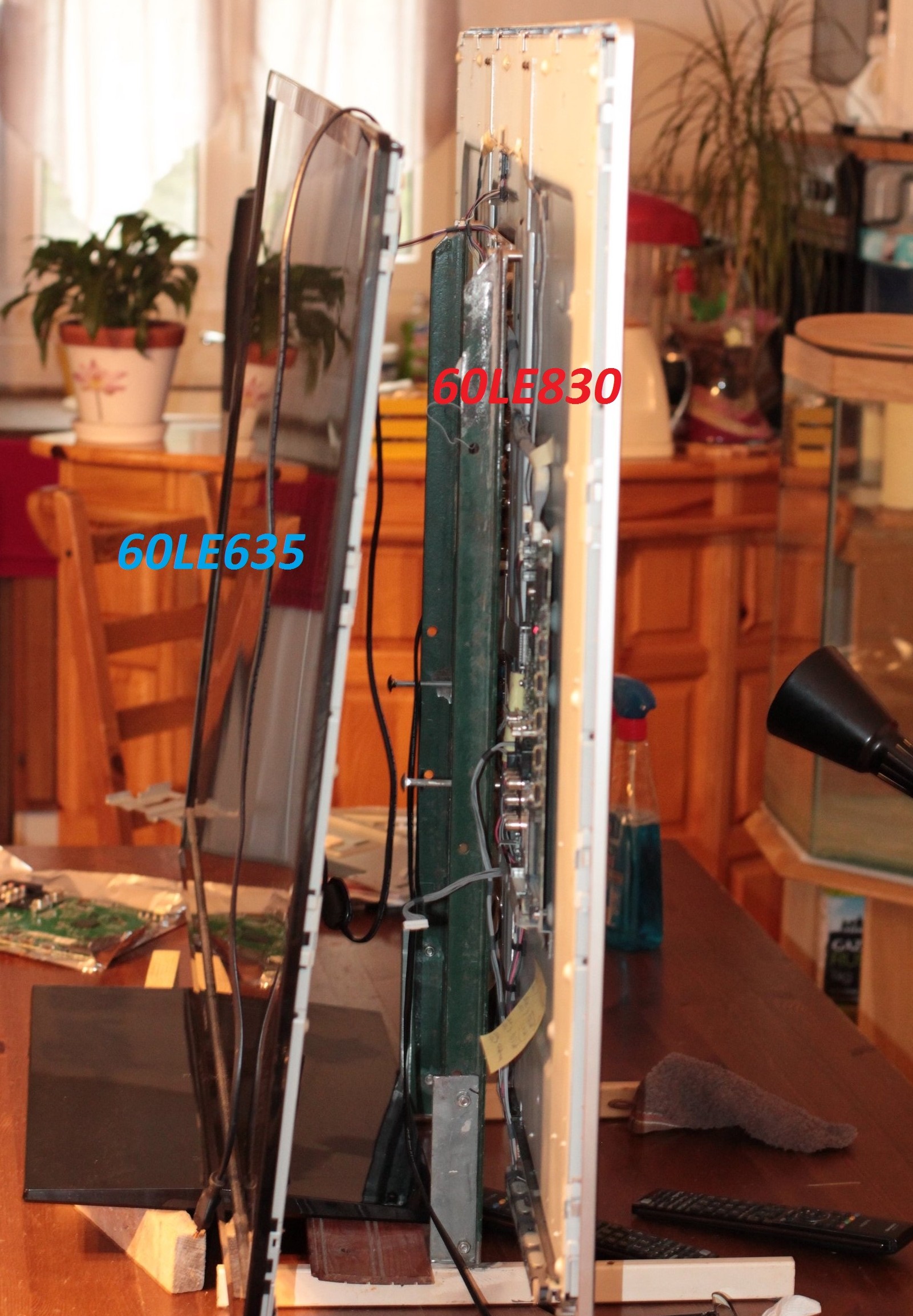

          Thanks to my tests on the L1 connector of the power supply DPS-183BP-3A and the anomaly found on the LED2 strip, I decided to connect the socket of the L1 connector of the 60 LE830 to the backlight wires of the 60LE635 I know good and similar.
          By this test, I wanted to make sure that the repair of my backlight was one of the solutions to get to repair my Sharp TV.

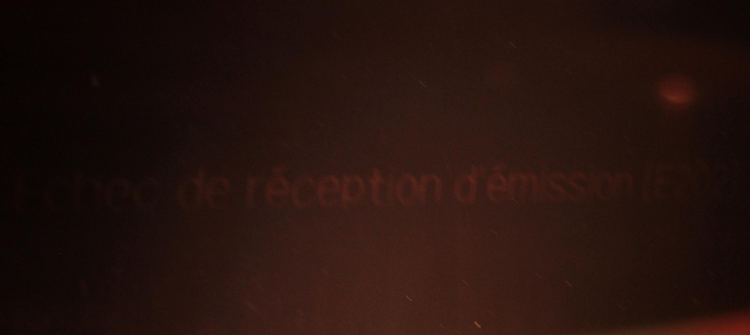

          At the start of the tv by the Power button plus the connection of the power cable, Jai at the beginning the same symptome as the video, it flashes quickly for 35 seconds then the light turns on but does not get off.
          The backlight of the 60LE635 will illuminate.
          We can then see by approaching a lamp of the panel of the 60LE830 in the center of the screen and in a frame a message
          "Emission Reception Failure (E202)
          This message is in the center of the panel, so I can say that the panel is working properly left and right and the Tcon card too.
          So there is as I thought for a moment, a failure on the original touch keyboard and a failure on at least one led strip.
          Because of damn HS keyboard, I buy a motherboard because it was impossible to wake up by manipulations' error lamp and other ...
          Here are pictures to better understand what I did.

            I replaced the 4 ramps backlight.
            the LED bars are fixed 2 by 2 to an aluminum bar.
            There is only one broken down but it was easier.
            It was late and I wanted to do it quickly.
            I put the one of 60le635.
            I will repair them later when I take care of the 60le635.
            For the dismantling of the slab, I did an experiment.
            For fear of breaking the lcd slab, I laid the slab flat on a rigid board
            and I dismantled all the screws fixing the back panel of the tv to the front part which maintains the screen and the diffuser of light.
            So I removed the set backlight and back panel together.
            The slab did not move, no manipulation on the fragile connectors.
            I just disconnected the Tcon cables.
            The light diffusers remained flat and we were not moved.
            Otherwise, it was difficult to reassemble all properly.
            After replacing the LED light bars, I did the operation in the opposite direction.
            Result, I finally have a visible image.
