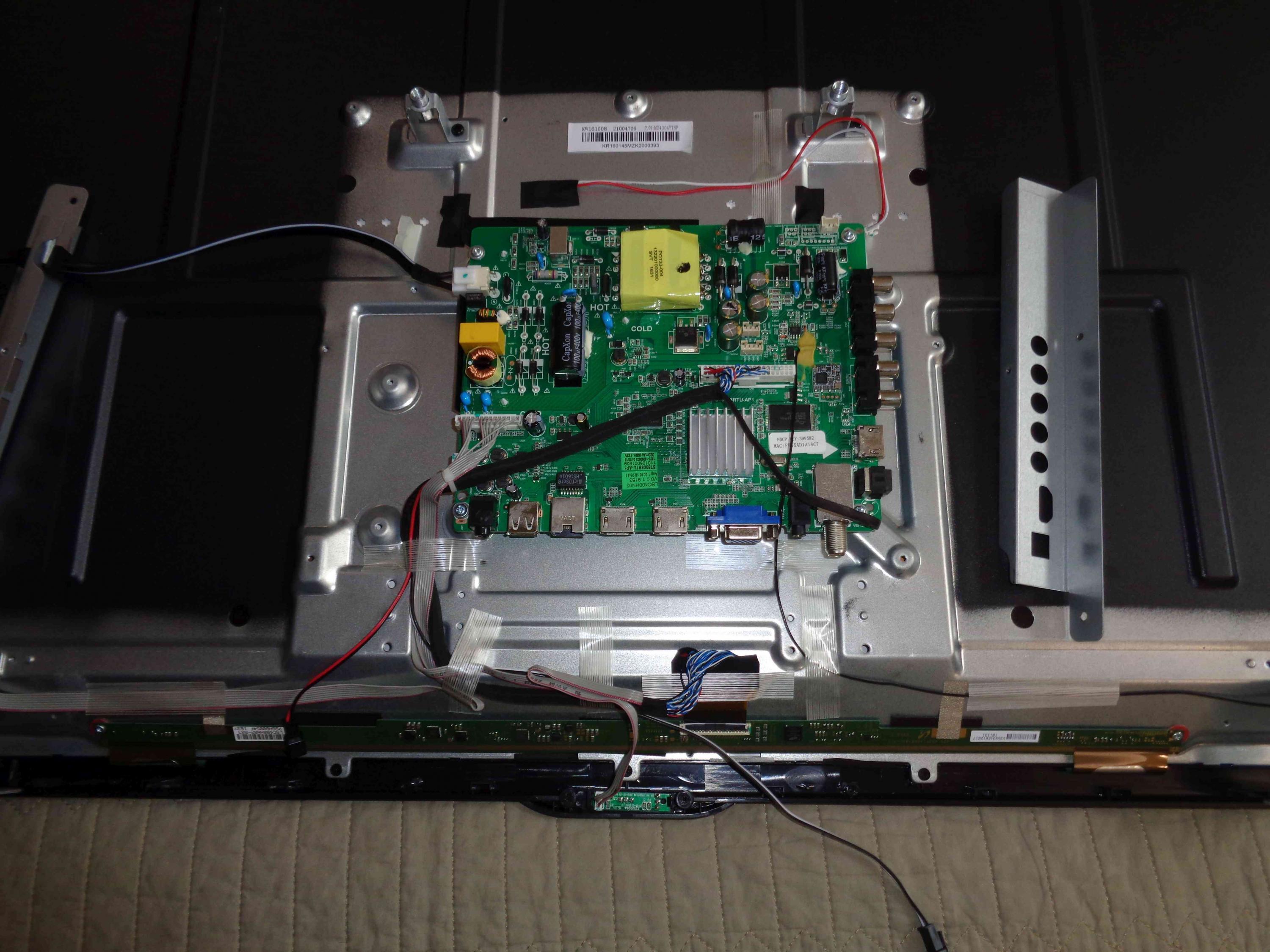

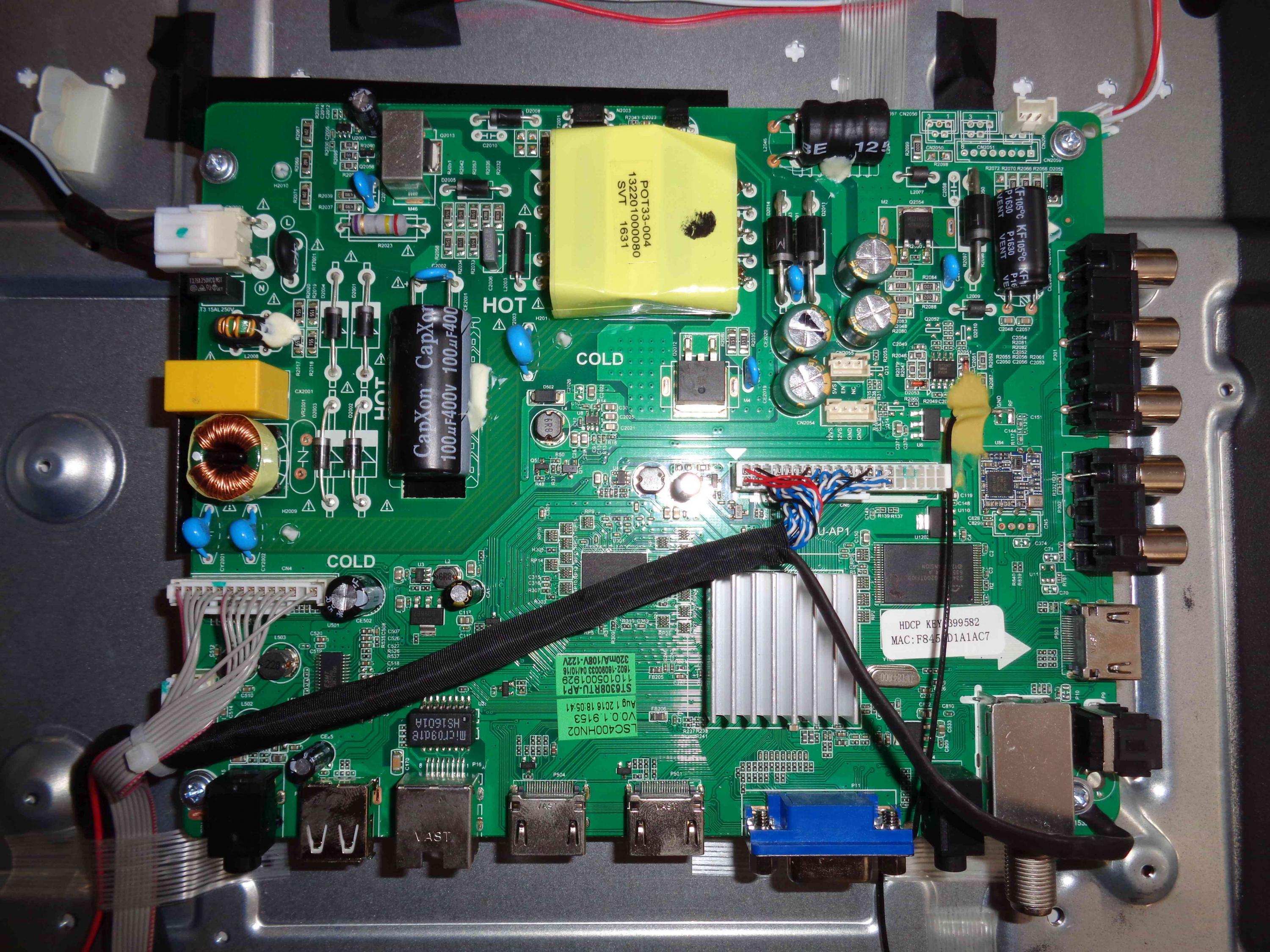

    If you upload good clear pictures of the boards and how they are all connected together that will be a good start.
    • Mr_Slim
      • Jun 2018
      • 23
      Re: Westinghouse WD40FW2490 not powering up
      Thanks, here's a big picture view of the connections, and a couple of closer ones, flash and no flash.

        This is one of those Chinese universal boards. So you will not find any service information per say. These boards are used in other TVs and can different software are used for different Panels. Since you have no Standby voltage that would be the place to start. Are you getting 125Vac in? What voltage are you getting across the big filter cap and are the fuses OK?

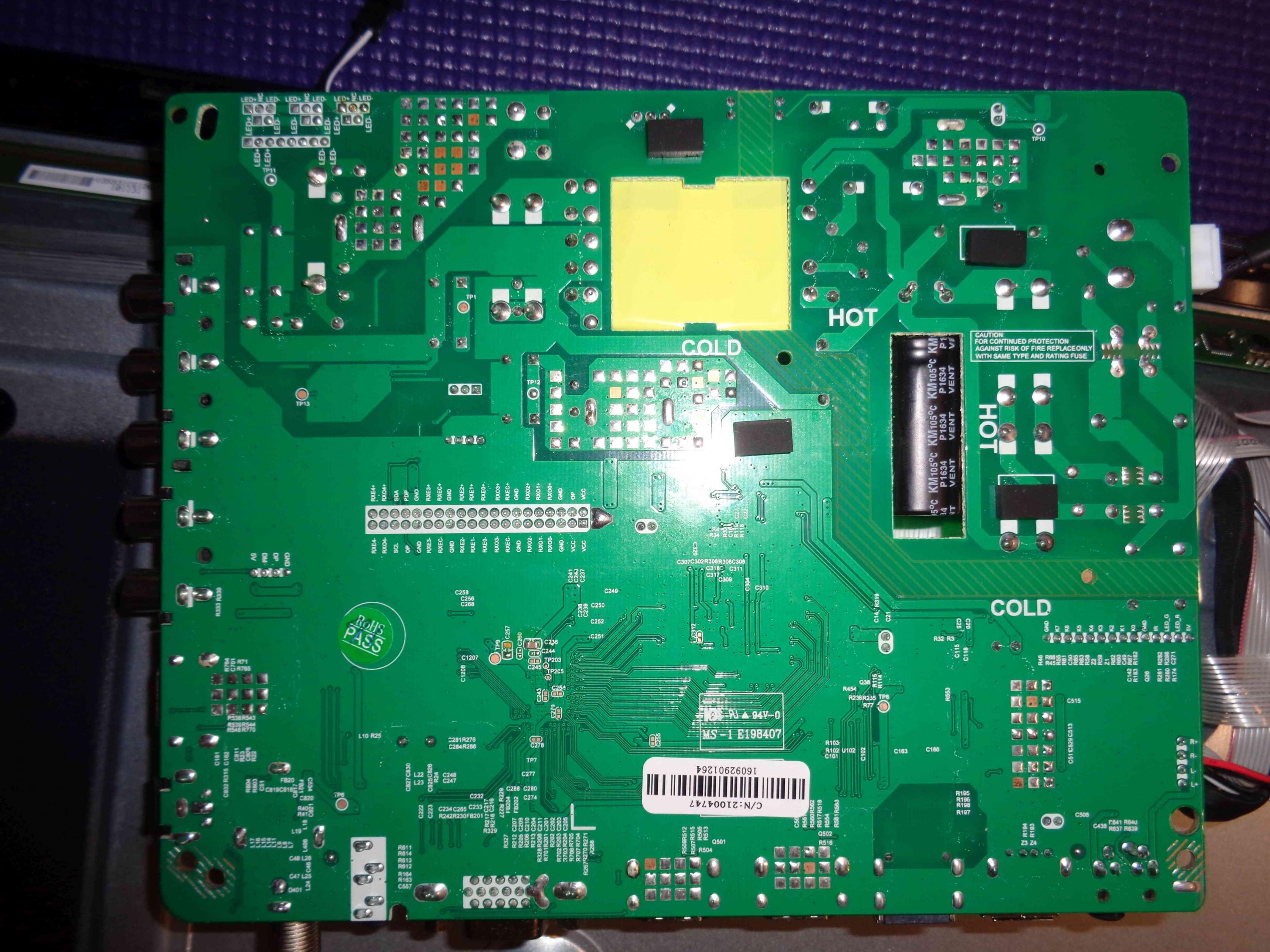

            Test the HOT/Primary side components for any faults. I believe this is an always ON type PSU. We would need to see pics of the board's underside, also.
