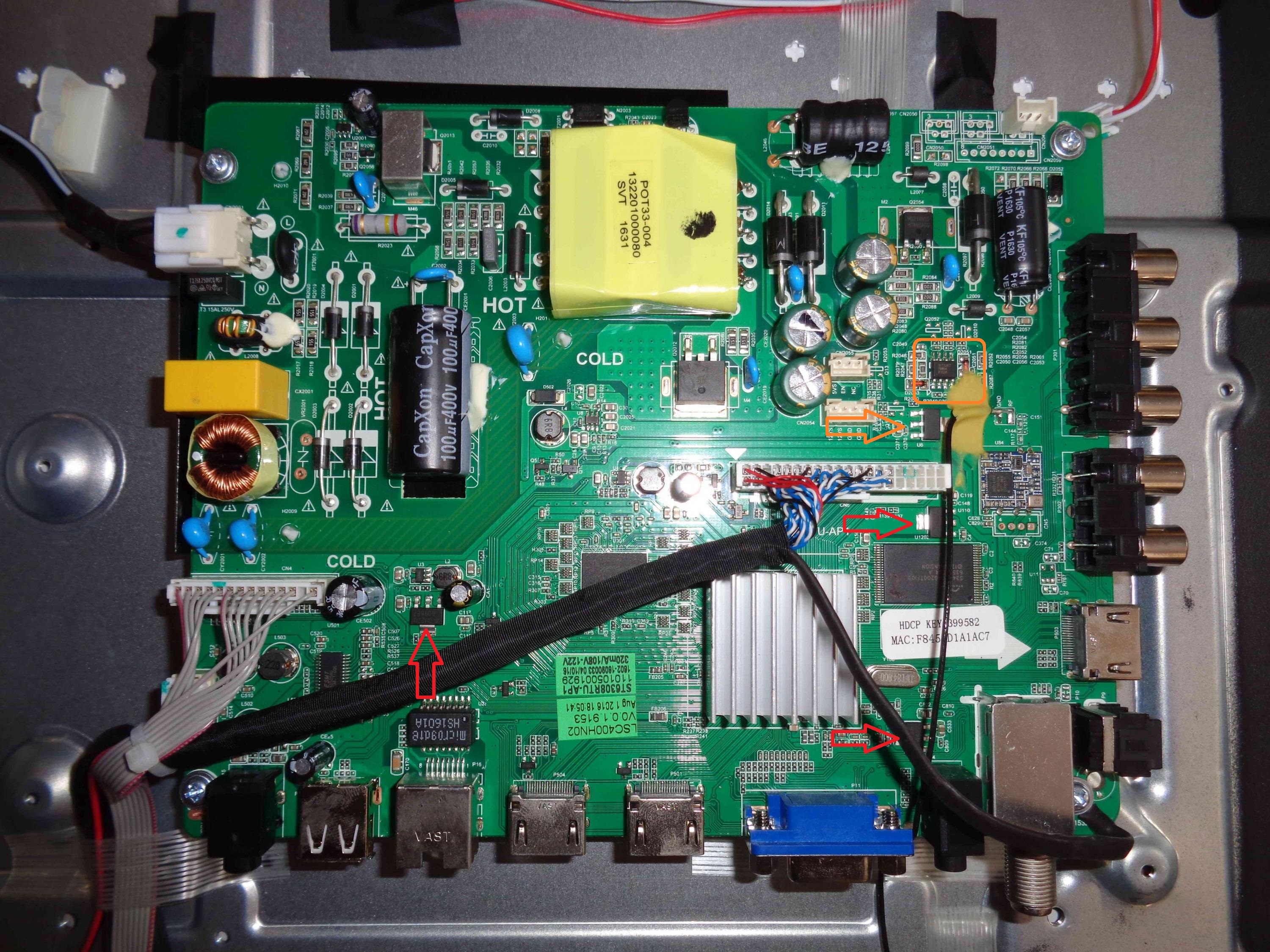

    .8 drain to source is is not good but it may not be the component that is shorted. Yes, center pin is connected to tab. Have you checked the large diode to the right of Q2054, also check the resistance across that large cap next to the diode. You could lift the source pin of that Q2054 but sometimes you can damage the transistor. so check the other parts first

      Re: Westinghouse WD40FW2490 not powering up
      OK, in circuit, the big diode measures about 2.8 ohms in both directions. The same with the Cap. I pulled the diode (marked "HER304") and it still measures the same out of the circuit. The cap now measures more like a cap should, with the resistance changing as it charges/discharges.
        Looks like you found the problem, you can replace it with one thats a bit better like a HER306, HER307 or HER308
          One more step down the road...
          I replaced the HER304 diode with an HER308 and was still getting a short across it. I was able to lift the source leg of Q2054, which is an MDD14N25, and the short across the diode went away. With the source leg lifted, Q2054 was still a short between source and drain (the big tab), so I figured I might as well go ahead and order it. It finally arrived today (from the UK), and I installed it.
          I now get a Red light on the front panel once I plug it in, and hitting the power button gets me a Blue light. I now get 4.9V on the connector with the 5 volt pin and 11.9 on the connector with the 2 x 12 V pins, so Im making progress.
          I also can see that the led in the Toslink connector is also on.
          I'm still not seeing anything on the display when I try the menu or source buttons.
          What's my next step?
          John

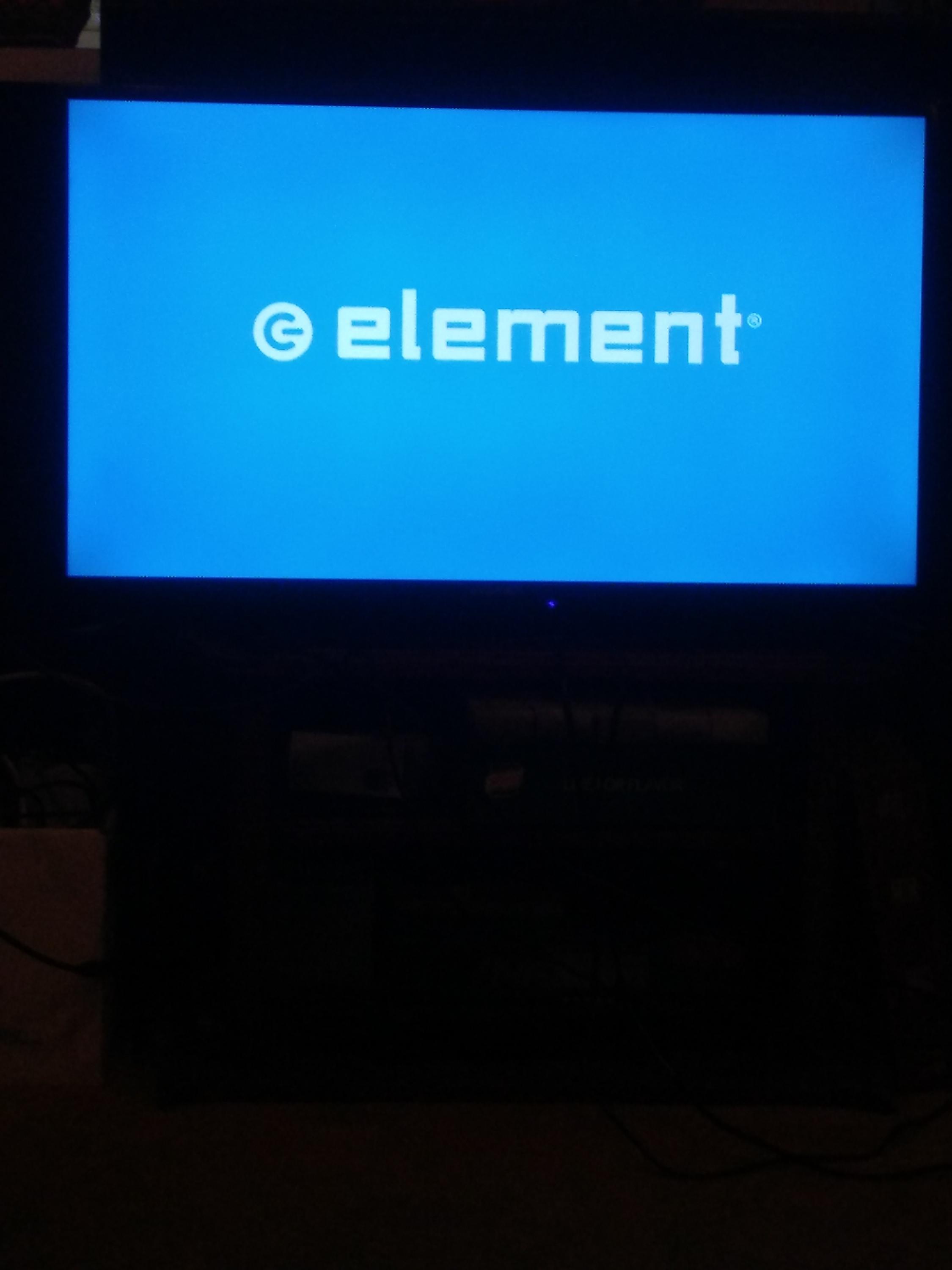

                            I have same curbside special model, board model ST6308RTU-AP1. Turning on only displays the Element logo. Do not have remote. Only the power button on the panel turns it on but not off. All inputs not tested, because cannot switch inputs using the panel buttons. Have plugged active VGA and HDMI with no change. Large cap 172 vdc before pushing power button. Large cap 165 after pushing power button on panel. Only normal ELEMENT logo shown with full back lights. CN2054 shows 12vdc and CN2055 has 5vdc. D2012 has 12.3 vdc between both legs and chassis when powered on, temp is 105F. Main aluminum heat sink has 98F. Any ideas?
                              Example, see pic
                                  You have a few voltage regulators on the mainboard you could check. What is the number on the top of the 8 pin iC near to U6? Possible EEPROM reading issue.
