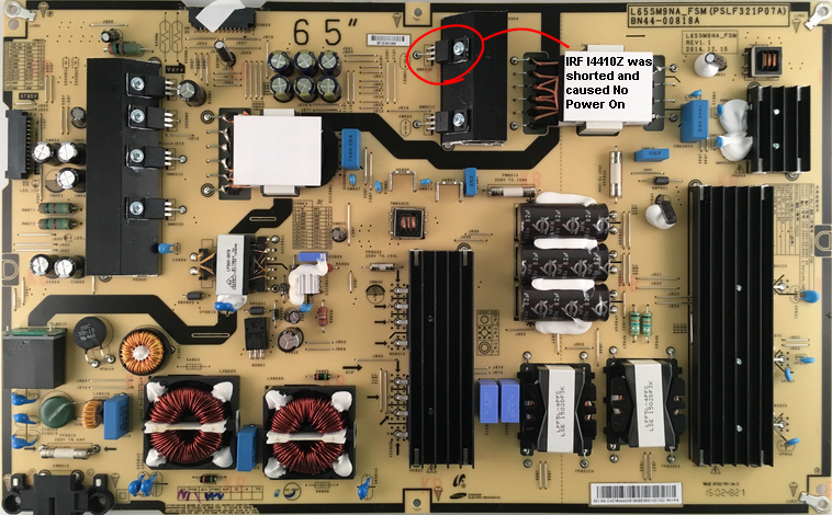

    Samsung UN65JS9500 No Power On
    I was given this Samsung 65 inch that was around $5000 new
    I found little to none service information it but managed to find the problem
    as shown in the image
    I had standby and B13 voltages with no fuses blown, so it through me
    for a while.
    I now have a $2.39 (top of the line) TV and just wanted to pass it on

    I have the same TV but when my PS shorted it took out all kinds of stuff including the fuse. Wish I had your luck!... and thanks for info.

          Same model.
          Same fault.
          Same failed MOSFET.
          Part price went up to $2.47 though
          Thanks for the heads up.

                    How did everyone determine it was this specific mosfet? Remove it and hope you got the right one?
                      Re: Samsung UN65JS9500 No Power On
                      You check for short circuit, fuse is blown due to over current so you look for shorted out power device.
