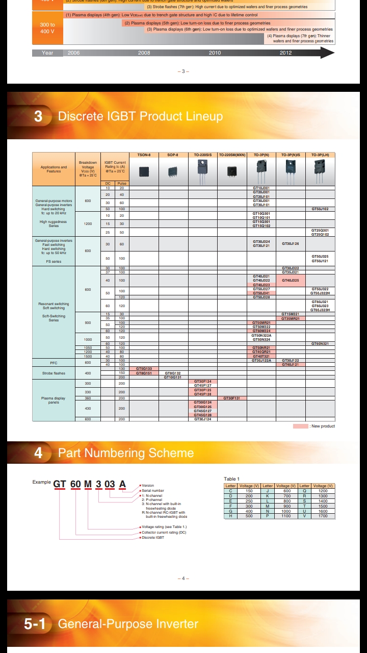

Any MOSFET equivalent of RJP63K2 ...found blown in a SAMSUNG plasma TV SMPS?? IF there is ..Please help.. many thanks..
MOSFET Eqivalent of IGBT RJP63K2 in SAMSUNG PLASMA TVC SMPS
Re: MOSFET Eqivalent of IGBT RJP63K2 in SAMSUNG PLASMA TVC SMPS
Funny I have a Sammy right now and those same IGBT's out of circuit for testing.They call me......."threadkiller"
Part Number : RJH30E2
Manufactures : Renesas
Function : 360V 30A IGBT
You can use any of the last 5 in the plasma panel list at the bottom.Attached Filesif you find these attachements useful please consider making a small donation to the site
Was able to get the last one on that list which is GT30J124
Type of IGBT Channel: N-Channel
Maximum Power Dissipation (Pc), W: 26
Maximum Collector-Emitter Voltage |Vce|, V: 600
Collector-Emitter saturation Voltage |Vcesat|, V:2.4
. hope is not too much for it sir
Maximum Collector Current |Ic|, A: 200(pulse)Comment
