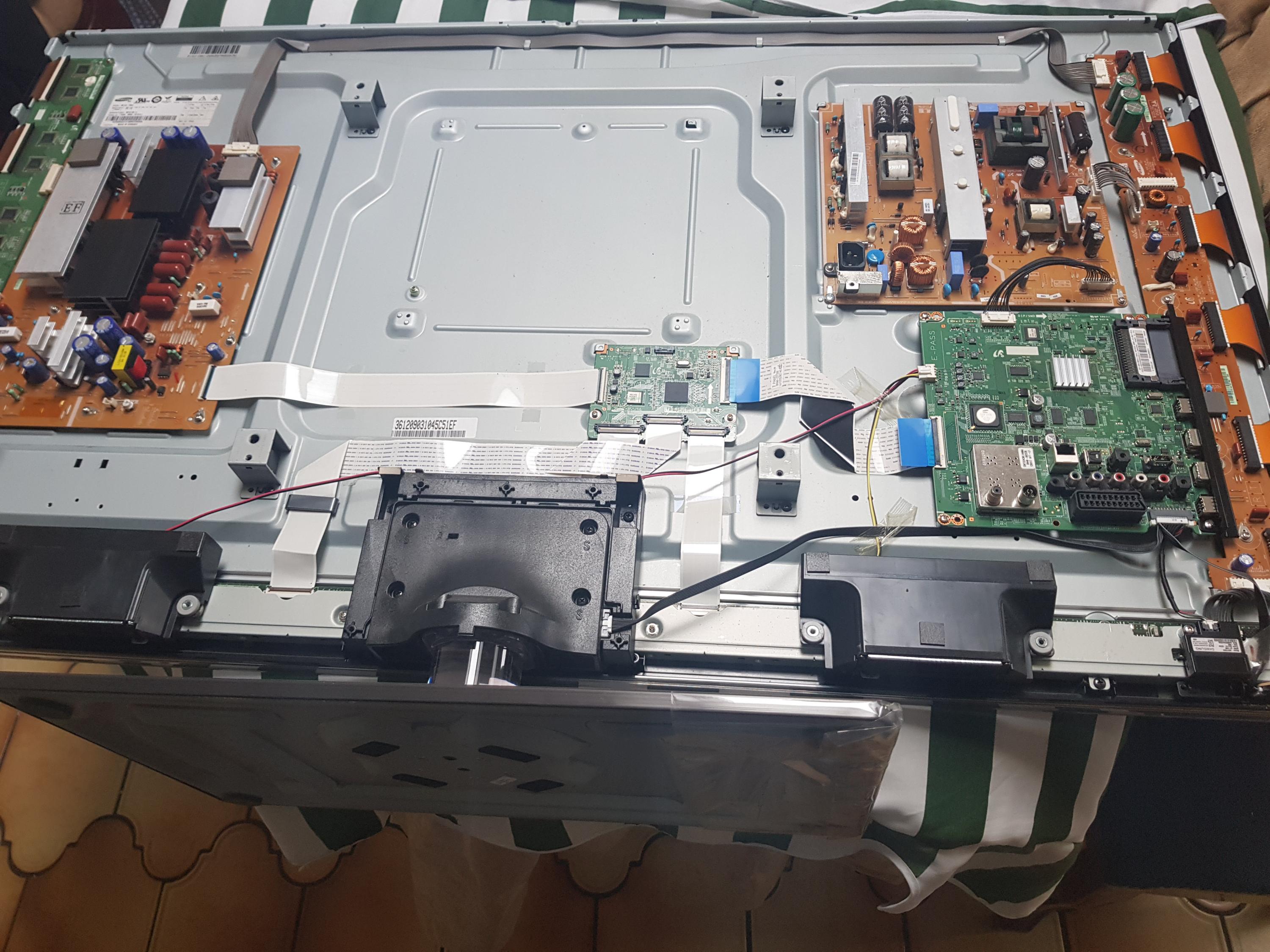

    Hi there people, so my Tv is about 7 months outside of its 5 year warranty (originally from john lewis).
    Apprantly the tv was on and then the noise came and tv went blank, family tried to turn it on but nothing just the red led flashing.
    Now as there is o warranrty left and me being me i dont want to part with it yet i opened it up and had a lool.
    I think there is a blue component on a rectangle board on the left side (think the y sus board).
    But i have checked the power board and with the negative from meter going on the tv chasis / ground or whilst touching a screw in the tv and the red going on the vs and va terminals there is no reading, have also checked on the 2 ribbon cables coming off the power board on vs and va and again no reading on meter
    Does this mean the cause is more than likely a power board?
    Any help is appreciated, thanks

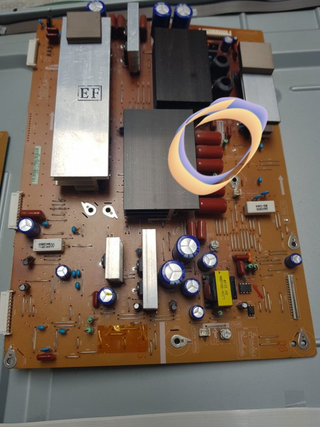

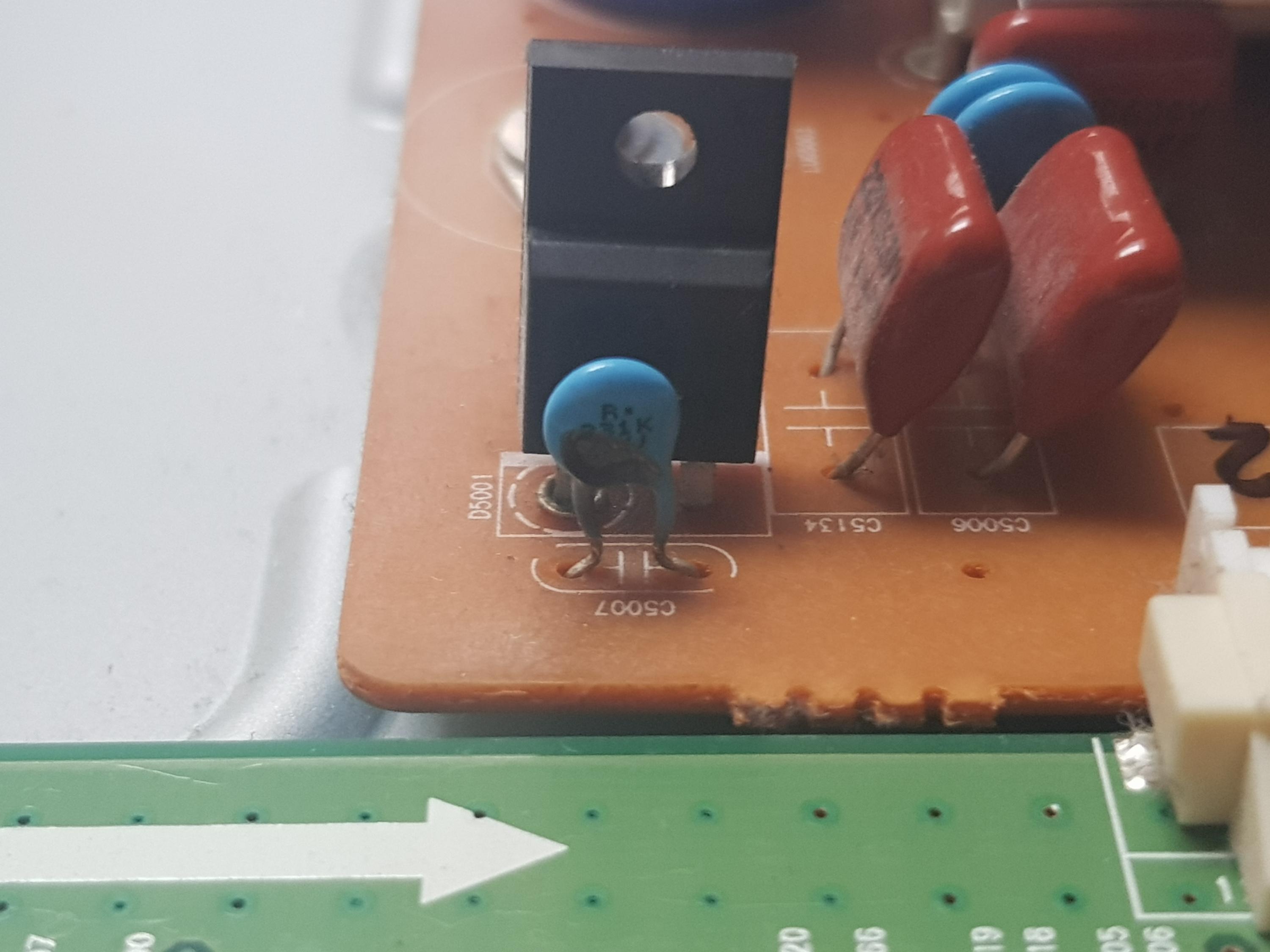

        Hi there people, please the attached pics
        The 2nd pic shows the vs and va terminals that when checked with my meter shows nothing, both with other boards connected to the power and without
        The 3rd pic shows the only component that could be burnt out on the far left board I think the y sus. So could it be both he power and y sus boards I need to order??

            Re: Samsung PS51e6500 plasma tv, bang then no picuture
            I would check the diode behind the cap. and change the cap. or at least remove the cap if it is shorted, You may get lucky and the cap is the only problem. If there is a short somewhere on the ysus, the power supply WILL shut down.
            That burnt cap. does seem to be across the vsc

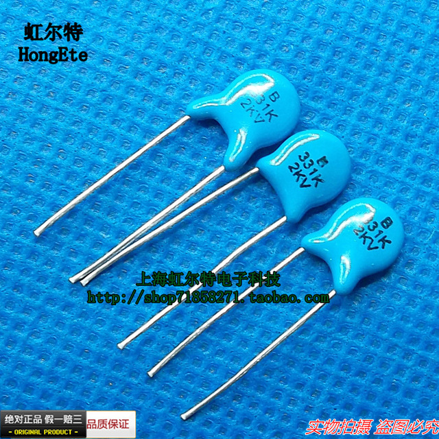

              Also that blue thing in the 3rd pic is that a capacitor? If that has blown on the y sus board then can that cause the power board to stop showing voltages, surely not if the ribbon cable is unplugged?

                That "blue thing" is a disc capacitor. ?31 is the value (I can't make out the first number, is it a 3?) it is likely 1kv or 2kv voltage rating.
                That cap is BAD. if it is shorted it will kill the power going to it. Did you at least check if that part IS shorted????

                  thanks rj, have just double checked and that cap is shorting out, have checked others aswell and they are fine so thats 1 thing.

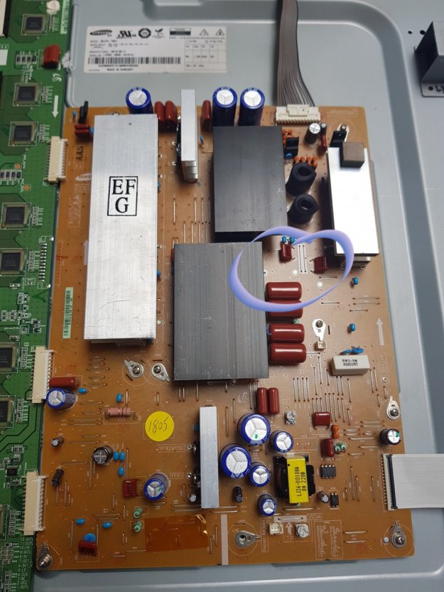

                    ok people, i ordered a y sus board, got it this morning put it in but again nothing just the red led flashing twice than 1 sec pause then twice again
                    1 thing i noticed when turining tv on there was a whiring or buzzing sound from new board but then that went away.
                    Also still getting no power on va or vs terminals
                    And there is a slight difference between my board and the new one but it might not matter, plz see pics attached

                      Hopefully you replaced all the screws securely back into the board before turning on the set otherwise you may well have damaged the replacement board which I suspect has happened.
                      The boards do look different but I don't know if this would be the issue. There's a second heatsink with a transistor/mosfet mounted on it at the bottom of the picture of the old board (to the left) which is not on the new board

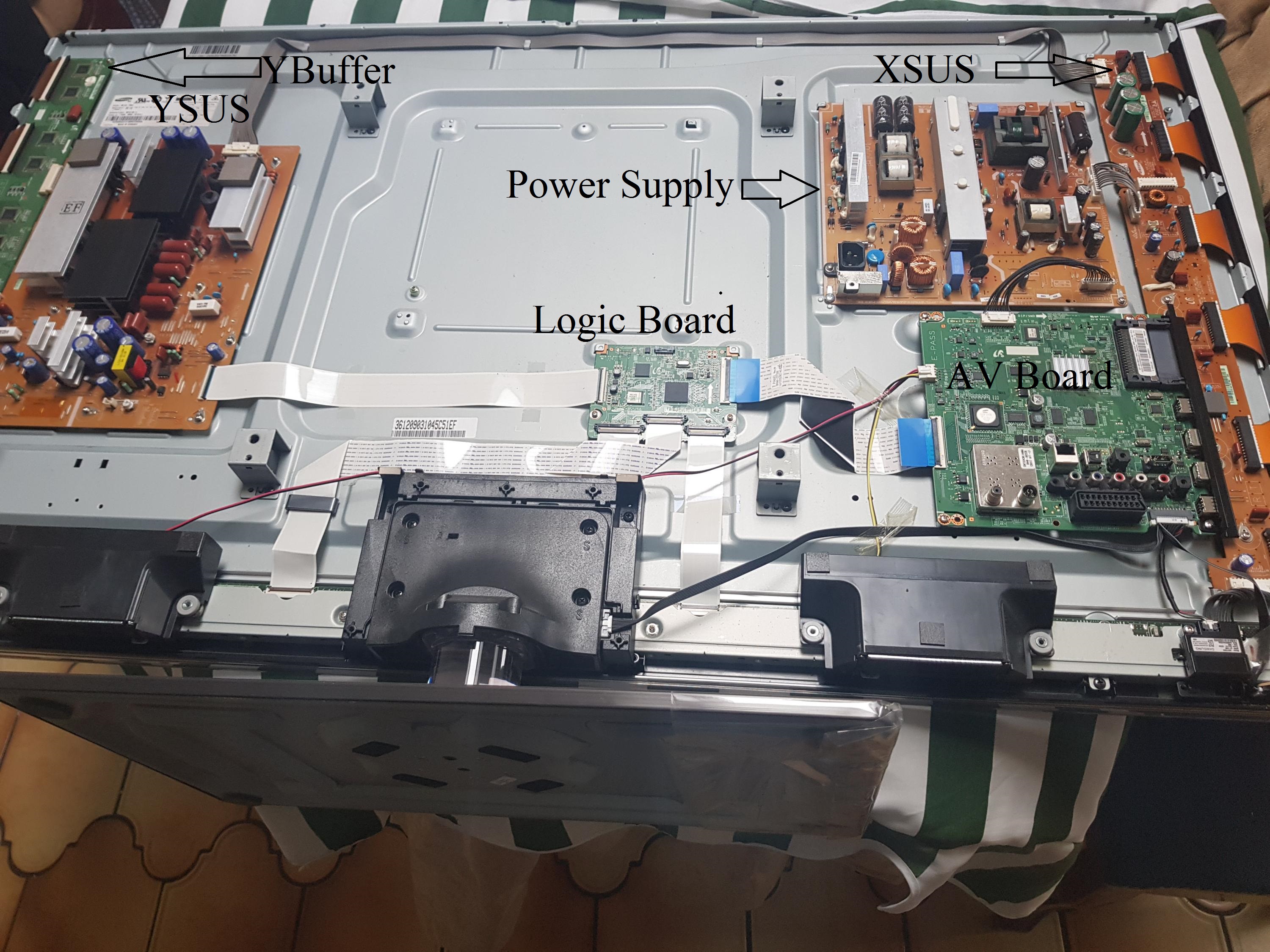

                                so when there is a short and i disconnect the ribbon going to the y sus (but keep the wire from the power to the right hand buffer) the short clears
                                Also if i disconnect the y sus from the buffer next to it (on the left hand side) the short is still there but again if i disconnect the cable going to y sus short clears.
                                This is on both y sus my old 1 and new 1
                                so have i been sent out a dodgy y sus?

                                  So when you checked the VS to Ground on the YSUS with the power cable removed the short circuit is still there.

                                    No short after i disconnect the cable going from xsus to y sus
                                    Even if i disconnect y sus from y buffer the short is still there only when i disconnect the y sus short clears from vs to anywhere on chasis of tv on loop or resistance on meter

                                      Ok people, update on this.
                                      Ordered a new Y sus, exactly the same as my old 1 including the AA2 version number, no short on this when testing.
                                      Turn the tv on and this time the standby light doesnt flash red every second, BUTT no picture only sound when i connect via hdmi to my sky box
                                      Could the buffers be damaged?

                                        With the new board in place are all your voltages as per shown on the panel. Va, Vs, Ve, etc.
                                        If they are then try the panel self test.
