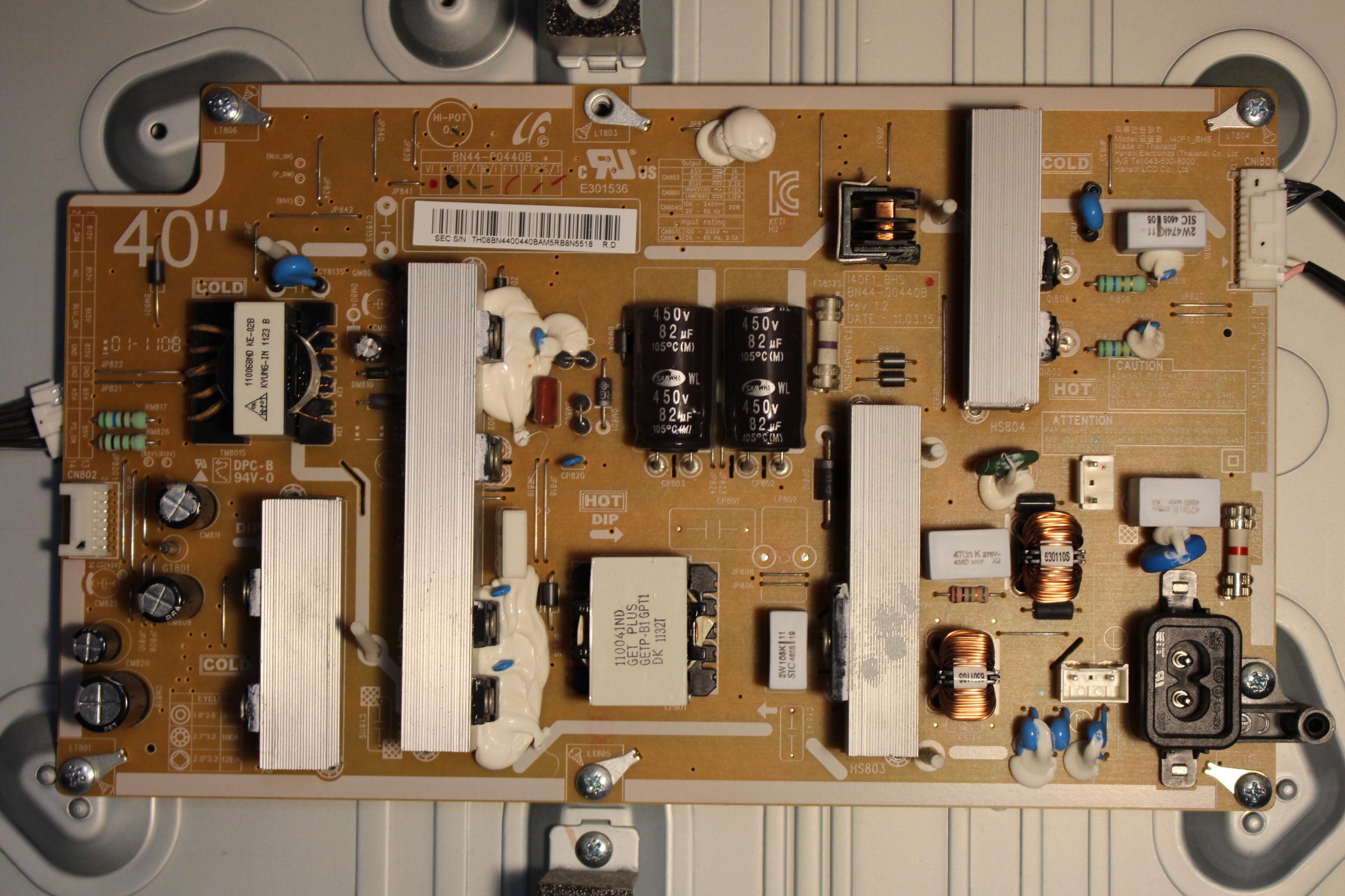

    I'm having trouble with a Samsung LN40D550K1FXZA where the backlight does not function properly. When I turn the television on the backlight flickers on momentarily and I can see the Samsung logo for half a second. The backlight then turns off.
    The main board does seem to fully boot. I can hear sound when the television is on. I can also see picture doing the flashlight test.
    I tried disconnected the main board to test the backlight as suggested in the troubleshooting manual attached to post https://www.badcaps.net/forum/showthread.php?p=792496. I get the same behavior when I connect power where the backlight just flickers on then turns off again. I'm attaching a picture of the power supply board. I don't see any visibly failed components or bulging/leaking capacitors.
    Does anyone have any suggestions on where I should go from here? I would appreciate any help or advice.
    Thanks!

    So the backlights do not come on as per the fast-track guide, so possible inverter fault or / lamp fault.
    Can you measure the voltages at CI801
    Can you post pictures of all the circuit boards at the back of the set and how they connect to each other?

        If your power supply voltages are all good, probably a bad ccf/lamp or bad transformer on inverter board or something else wrong with inverter board, you could grab an inverter board and try it, usually pretty reasonable prices on them BUT won't fix issue if it's a bad ccfl/lamp, there's some good videos on testing inverter boards on youtube, also check any fuses that might be on inverter board, fuses will start with F on label next to them.

            Thanks for the link to the other thread neilc6. Are the capacitors I highlighted in the attached photo the "main filter caps?" I'm getting 163V across them. The other thread seems to say that I should be seeing 380-400V.
            Neilc6 I see you had a similar problem and replacing ICP801 fixed it. Is there anything I can do to verify ICP801 has failed before I order a replacement? Thank you everyone for your responses and suggestions.

              Yes those are the main filter caps. Voltage is measured with black on the negative lead and not chassis ground. In my case, the PFC voltage spiked up when first plugged in going into an overvoltage situation. If your backlights do come on momentarily, it would indicate the PFC voltage comes on. You will need to monitor it when the TV is both turned on and plugged in. Be careful, it's high voltage and alligator clips would work best.
              I would also check the usual suspects CP820, CI818 and DP810 assuming the designators are the same for your power supply board.

                    I did more testing and the voltage across the capacitors does jump to ~400 for a split second before dropping down to ~160. Is there anything else I should verify?

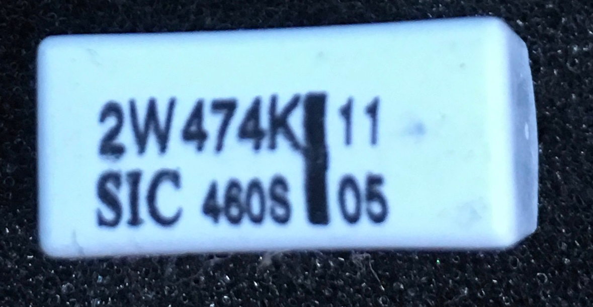

                        I removed CI818 and tested it and was getting ~.47-.5. It should be a .47uf capacitor right? I'm attaching a picture for reference.

                            Yes, 2W474K value is 0.47uf 450VDC Polyester Film type.
