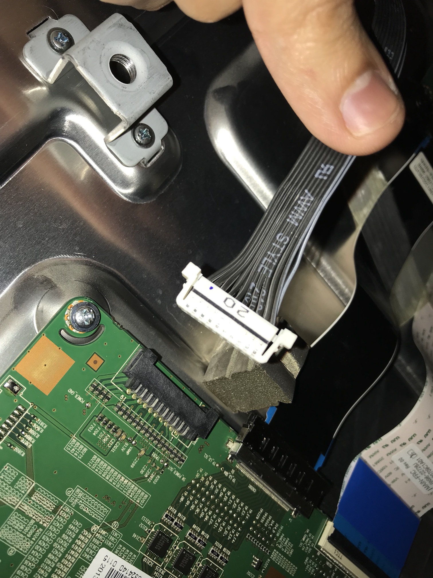

    Thereafter, I studied a little more about the issue and tried starting the TV with the main board disconnected as shown in the picture below and then took a video of it. In the video, you'll see that as soon as I plug the TV to power, there a slight flicker at the bottom of the screen and the TV does nothing and stays blank for 20s or so and then it all lights up white with yellow and green smudges at the top and bottom.

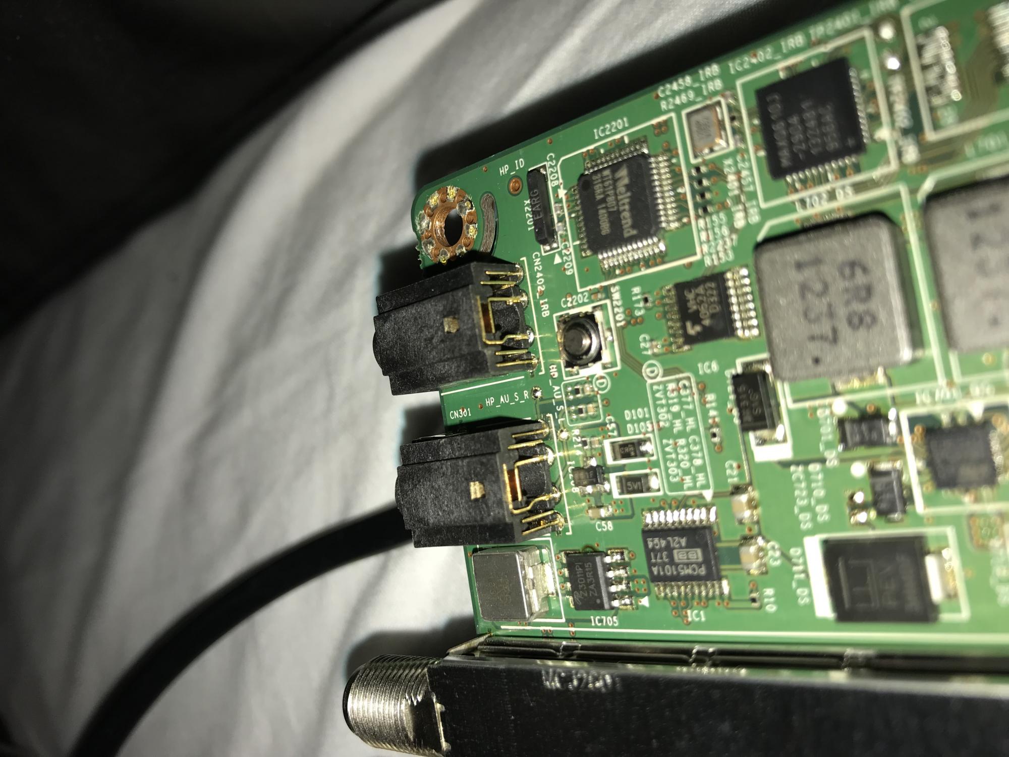

    What I tried next was really interesting, I got the TV to show something other than the SmartTV logo for once. On the OCB's PCB, there is a little grey button which I believed to be the reset or ON/OFF, I held that in and tried turning on the TV. It showed me the 4 different smart TV logos for a while and then went back to clicking and endlessly rebooting. However, I could never again replicate this with OCB's grey button again.

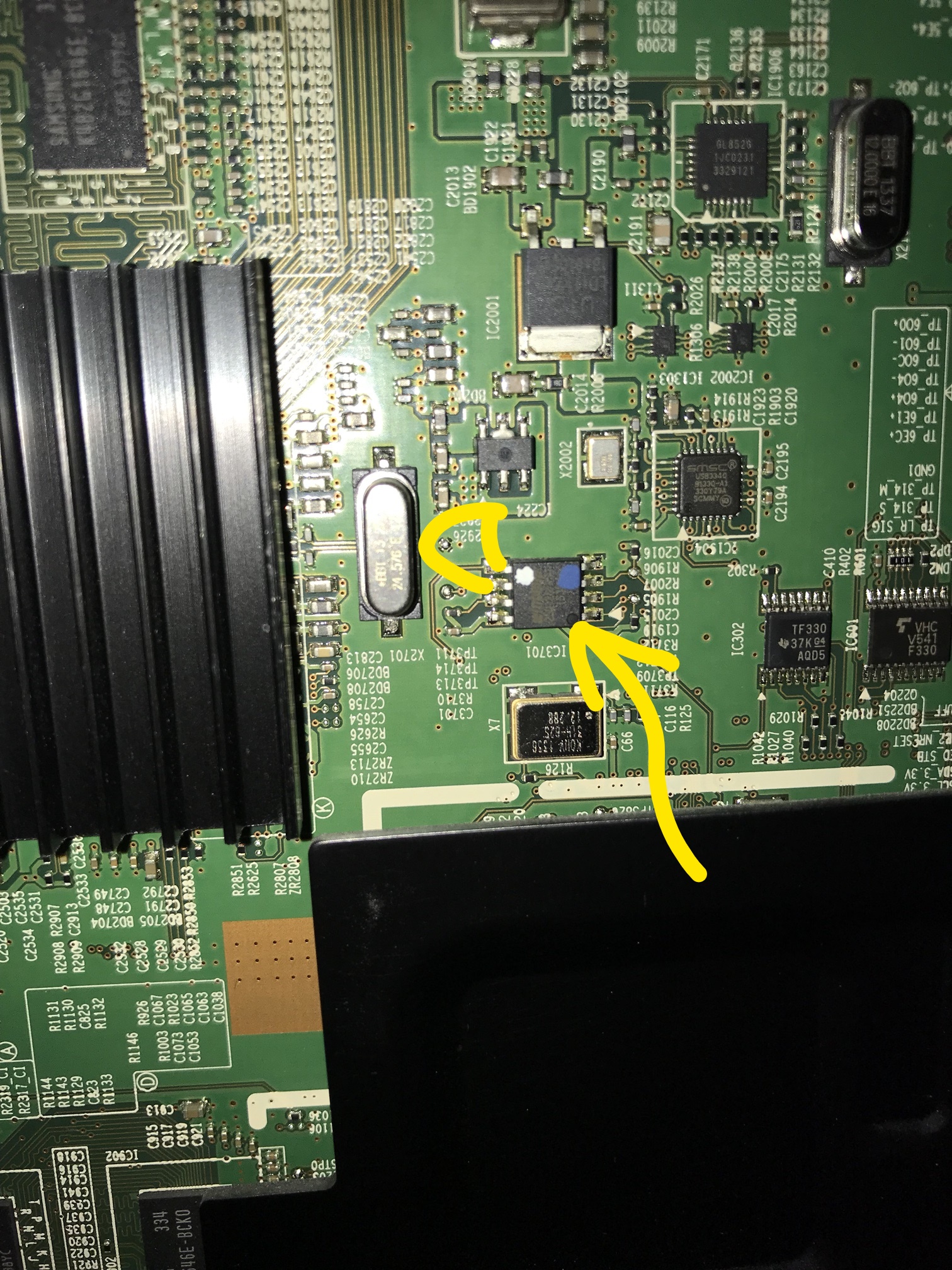

    However, a couple of days later, yesterday, I shorted the IC3701 on mainboard on pins 5 and 6 as it said on this forum and I can get the TV to show those four logos as showed in the video EVERY time I short this IC, unlike with the OCB.
    Picture of the grey button on OCB's PCB (ref SW2201).
    Picture of the IC3701 on the mainboard that I shorted every time to get the 4 separate logos to display.
    The video of what happens when I short the IC3701 on the mainboard.

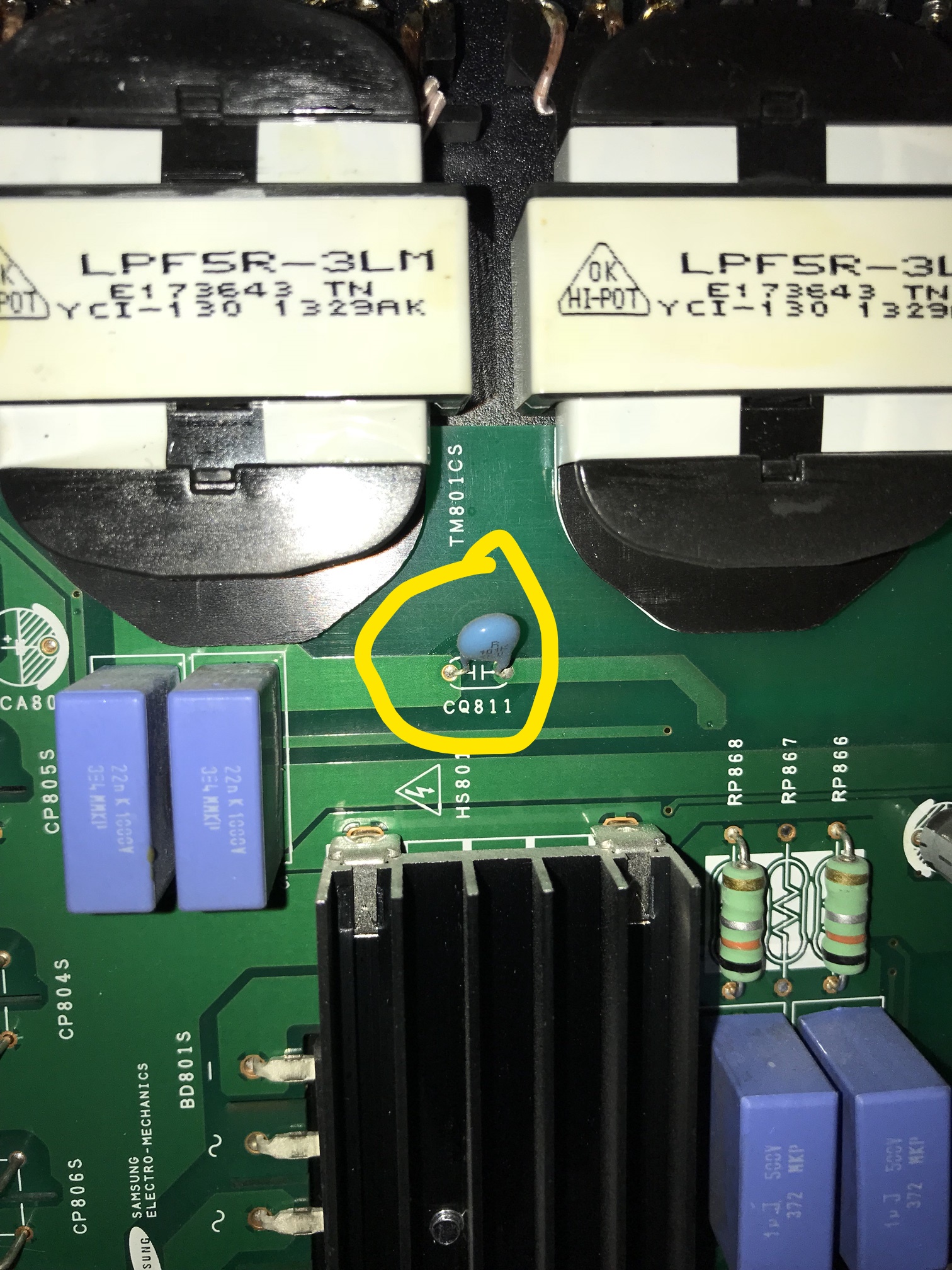

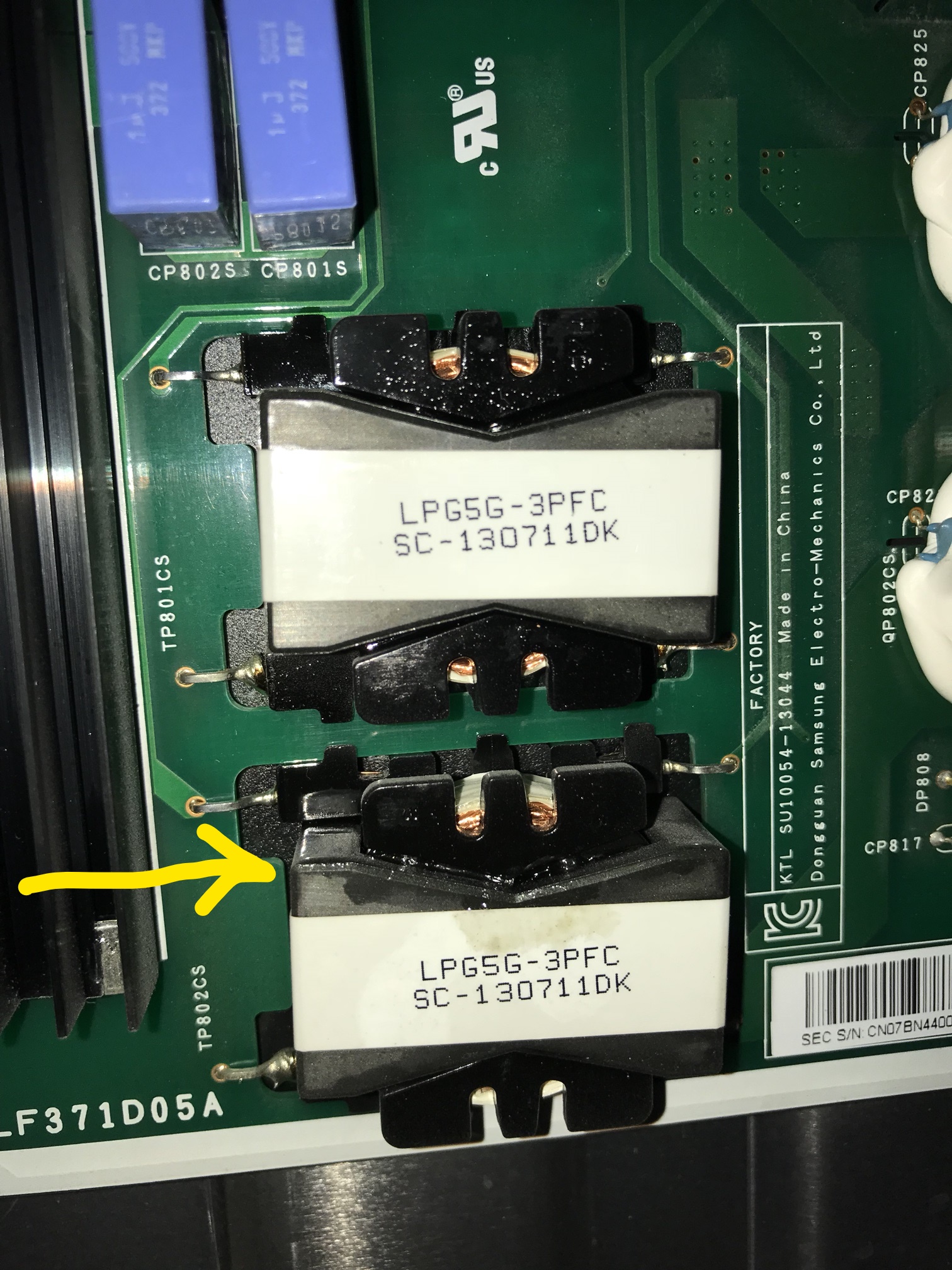

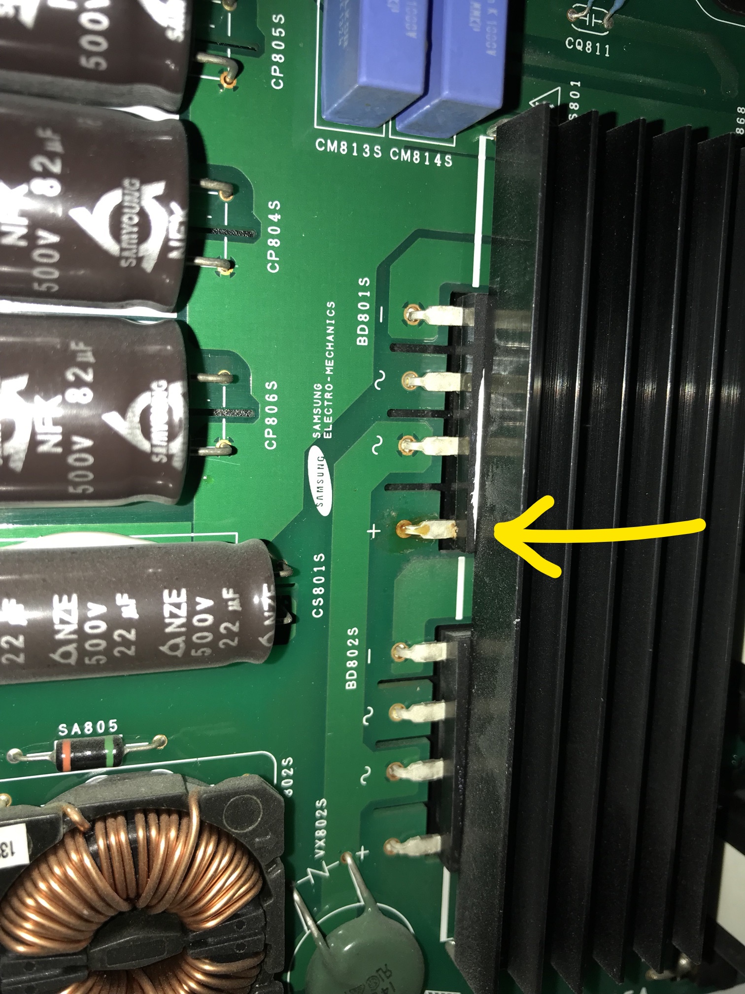

    On looking at the power supply, I found a few components that looked suspicious to me. Oddly enough, all the capacitors "look" healthy. Below are some pictures of what seems wrong to me.
    One of the terminals of ONE bridge rectifier seems corroded or has some liquidy substance as shown.
    One of the disc capacitors has a round liquidy sweat on the board right below it. Look carefully in the picture below.
    One of the transformers (?) has a sweat on it, could be the insulator that leaked out? Just guessing. All the others have spotless white labels on them.

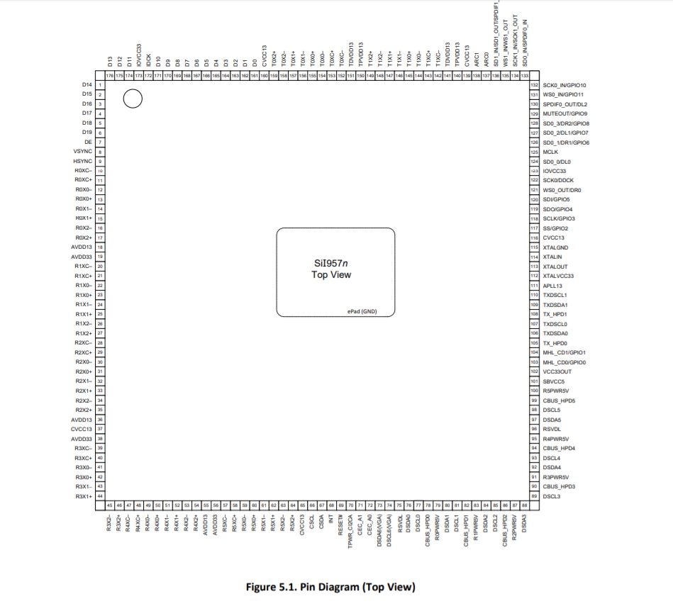

              Hello there,
              Spent some time with the OCB board and it seems like a few pins on the Silicon Image SII9575CTUC are shorted to ground. Do you think this is it? The pinout says that there's a pad beneath the chip which is a ground but a few pins are shorted to ground from what I see. Should I replace this before doing anything else?
              Could this explain the endless reboot I had before?
