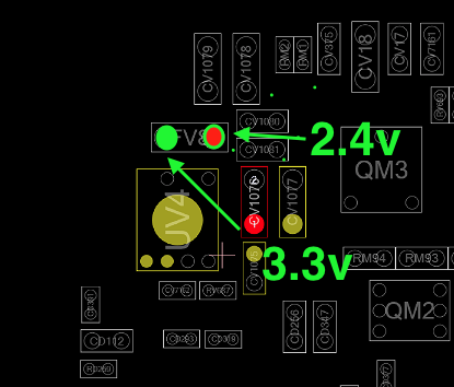

    Here are some interesting finds.

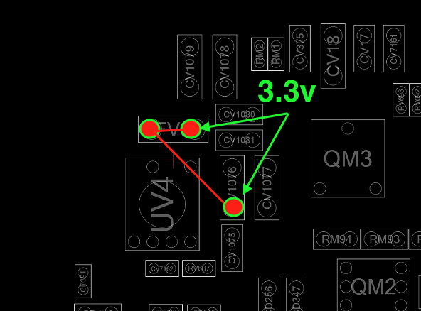

    When I connected 3.3VAW to Pin 1 of the FV8 - the 2nd pin of FV8 became 2.4V. Then I connected a wire from 3.3VAW source to Pin 1 and Pin 2 of FV8 - I had 3.3V altogether. The FV8 is good - no issues.
    LCD Display error still showed.

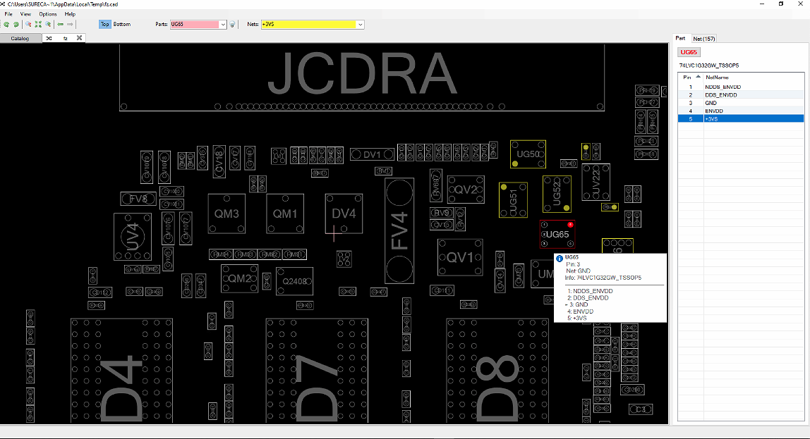

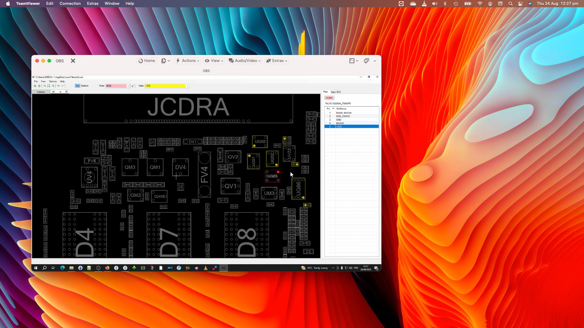

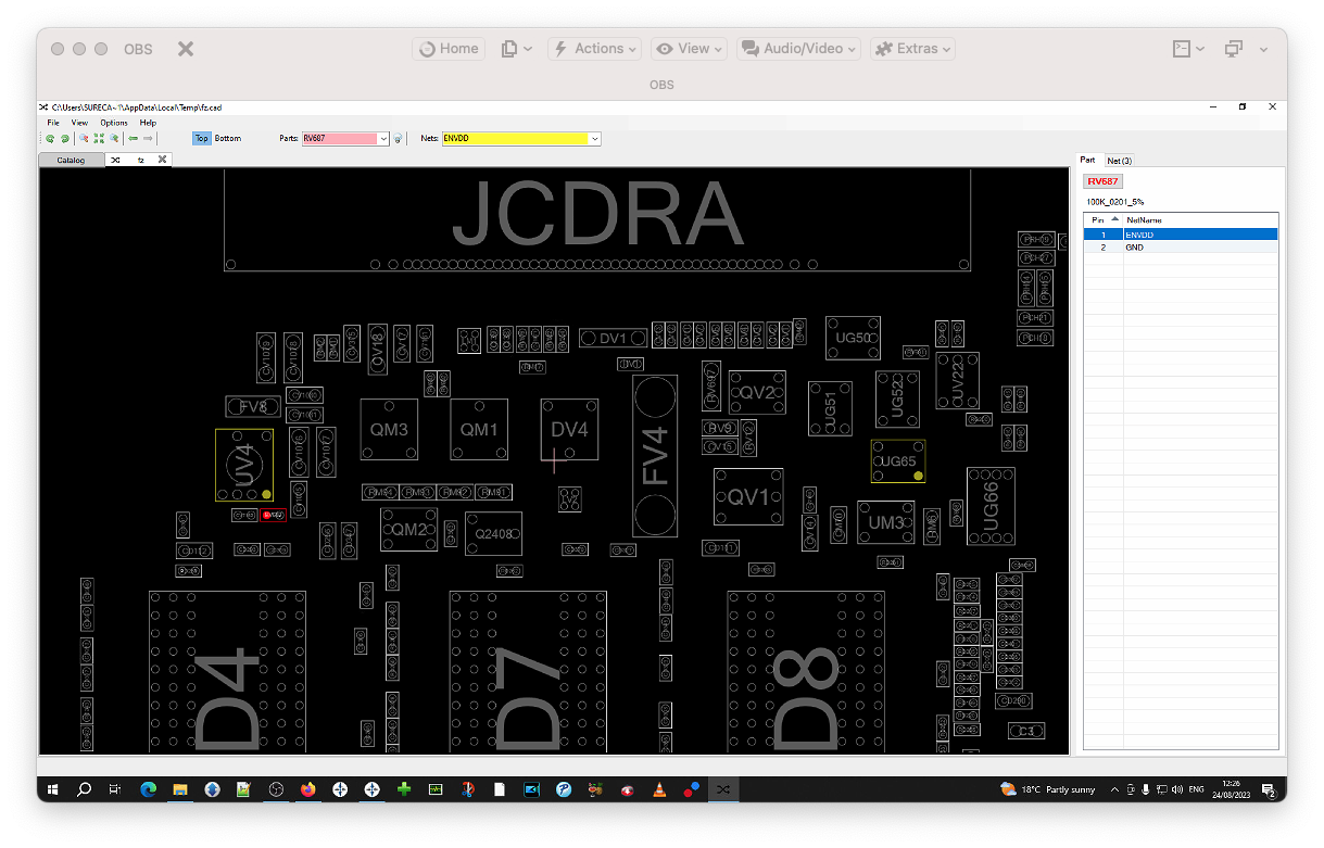

    ENVDD comes from UG65 as pictured. UG66 Pin 5 has it;s +3VS signal. But No V on Pin 1 and Pin 2 which are NDDS_ENVDD and DDS_ENVDD.
