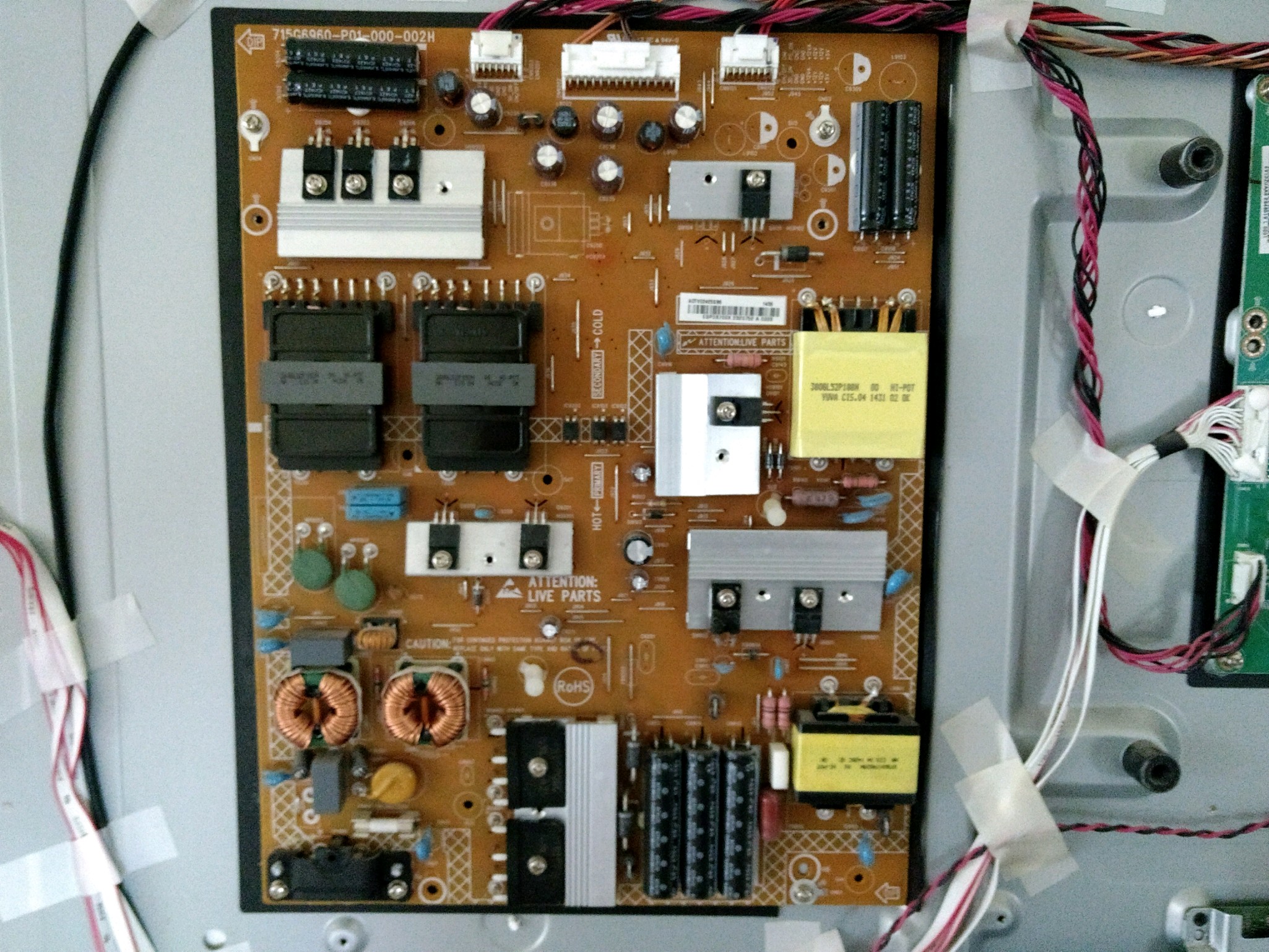

    It will also help if you up load good clear pictures of the whole back side of the TV showing all your boards.

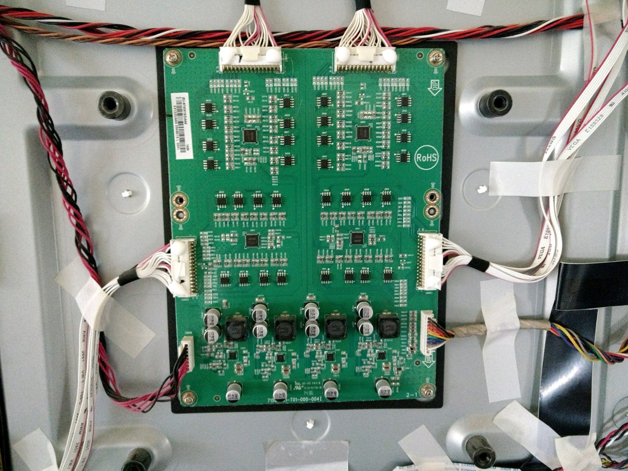

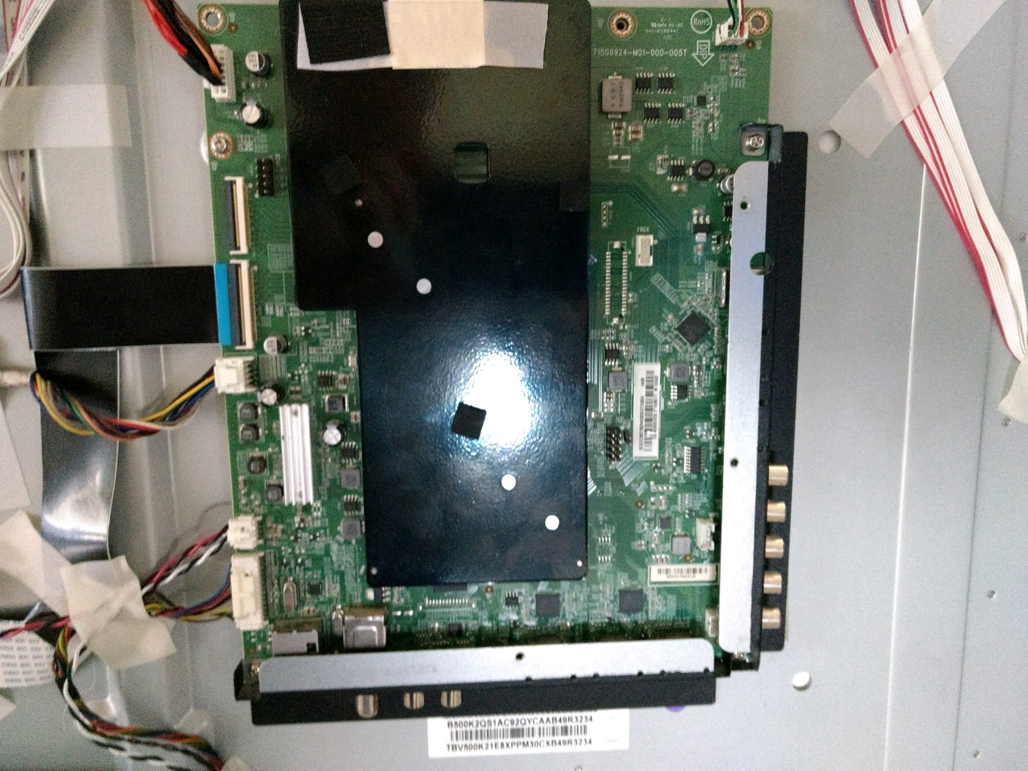

            Ok so I took pictures of the board arrangement and the boards, plus made an interesting observation:

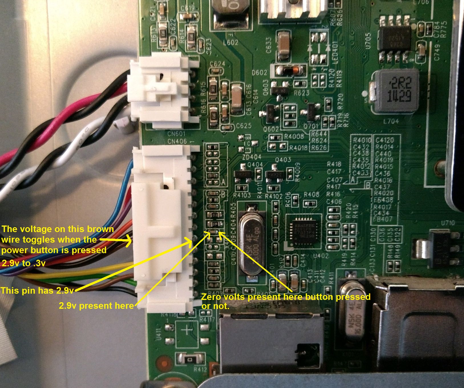

            Like I said when I toggle the switch at the switch connector (input) on the main board I see 2.9 open and .3 closed. When I go to the other side of the connector I have the same. When I trace away from the connector there's a surface mounted component, not sure if its a cap or fuse.
            On the connector side of this component I have toggling voltage, but on the other side I have nothing, zero regardless of whether the switch is open or closed.
            This looks like a good reason for no PS_on toggle to the power supply. My theory: if this component is open there's no way the processor "sees" the power button is being pressed?

                Okay let me try to explain. On the annotated picture, the brown wire with the arrow comes direct from the power button. The black wire right next to it also comes direct from the power button.
                When I press the power button voltage drops from 2.9 to .3. on the brown wire, connector side.
                When I check the pin on the other side of the connector associated with the brown wire, on the circuit board side it also goes from 2.9 to .3 when I press the power button.
                When I trace that circuit I come to a fuse or ceramic? cap, surface mounted. On the input side (towards the connector) the voltage goes from 2.9 to .3 when I press the power button.
                When I go to the other side of this fuse or cap I have zero volts at all times, power button pressed or not.
                This surface mounted component appears open and is on the circuit directly to the brown wire that leads to the power button.
                It does the same with the remote.
                They call me......."threadkiller"
                  Re: Vizio P502UI-B1E, quick question about PS_on
                  Well that is capacitor, one end is connect to GND this why you get 0V, so that is not the problem.
                  So when you see 0 V on one end of the part, then you should find out if one end is connected to GND or not by using simple Ohm meter to find out.
                  Since the power switch signal does toggle then there is no problem with the power switch, it also means the switch isn't stuck. The signal from the switch is fed to the controller which then will send out a bunch of control signals such as PS-ON , BL-ON , DIM, T-CON on, etc. So at this point I do not understand what you are trying to do.

                    I think I'm doing a really lousy job explaining this. Let me try this:
                    When I press the power button voltage drops from 2.9 to .3. on the brown wire, connector side. When I release the button it jumps back up to 2.9
                    When I check the pin on the other side of the connector associated with the brown wire, on the circuit board side it also goes from 2.9 to .3 when I press the power button. When I release the button it jumps back up to 2.9
                    The PS_on wire from the main board to the power board remains at 2.9v power switch open or closed.
                    Perhaps the easiest thing to say is something on the main board is bad?

                      "Perhaps the easiest thing to say is something on the main board is bad?" YES! that is about the 4th times.
                      As I already explain: the power switch is doing its job by sending the LOW signal to the micro controller but at this point the output of micro controller is not changing state when its input is getting the signal from power switch.
                      PS-ON signal pin is not connected DIRECTLY to the power switch! All the switches are connected to the input pins of the micro controller.

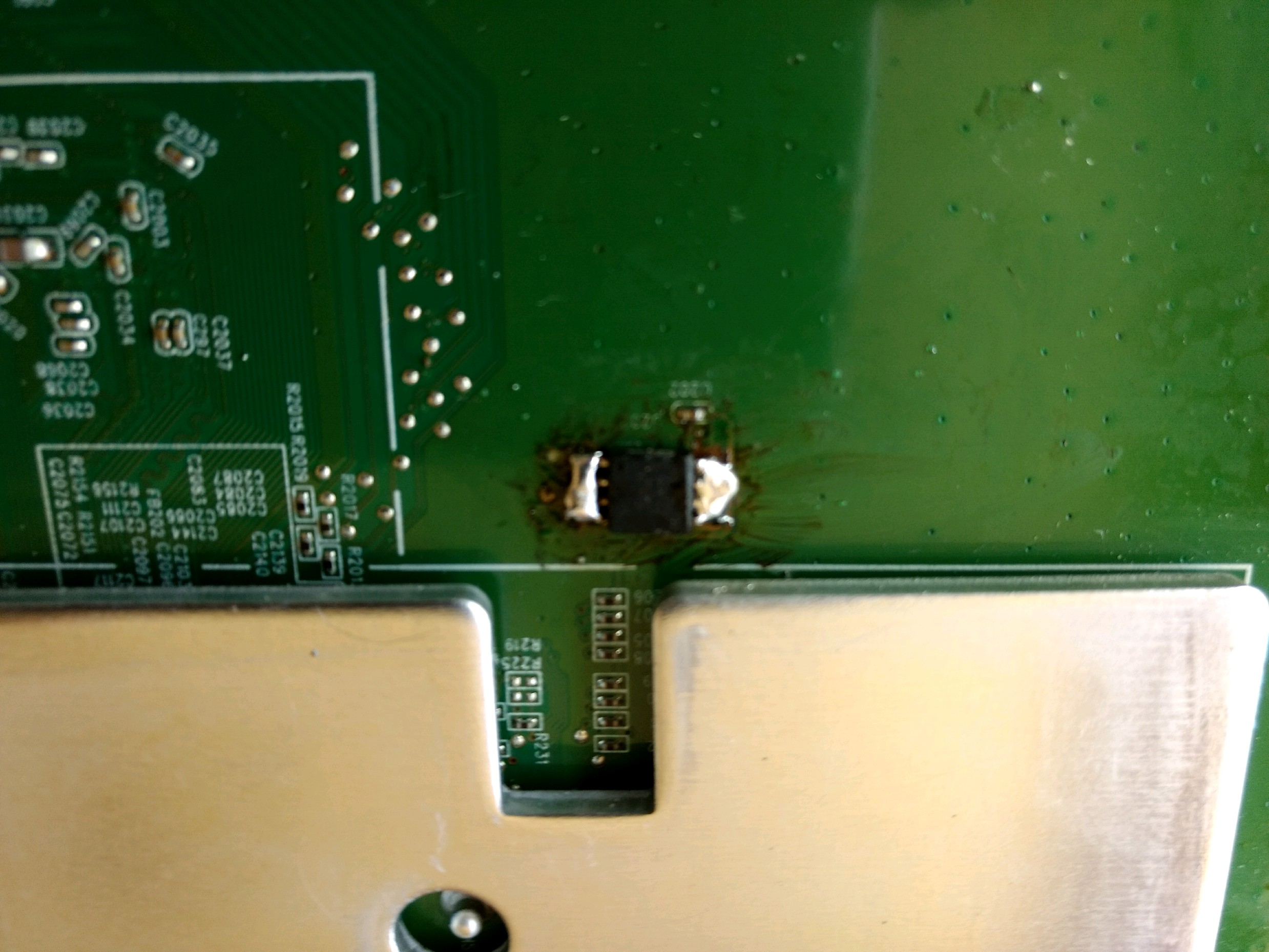

                          Well I was going to heat up the eeprom in this TV to see if it would boot, but I found this:
                            It looks like some trying to remove the chip but gave up on it.
                            BTW, where did you get this TV from?
                              I saw a video, think it was from norcal715 on YT....that was the first thing I thought of when I saw that.
                              I actually removed that solder, made sure the pins were still soldered on, powered it up and noticed a change of state. The power light actually came on and the TV responded when I hit the power button. The light flashed, stayed on for a few seconds then trailed off to a trickle, very dimly lit. The power button then became unresponsive until I unplugged and hard reset the TV.
                              I also tried heating up the eeprom with no change in the light sequence above.
