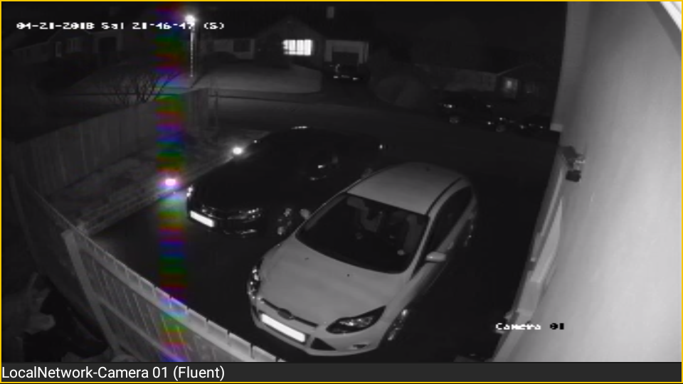

    Hi guys. I have installed an AHD CCTV system (Hikvision) at my house. I have used solid copper cat5e cable coming from the 4 cameras into a 4 channel balun in the roofspace. Then I have ran a length of cat 5e cable from that down to the DVR. The DVR is connected to the TV via HDMI. The cameras transmit using TVI.
    The cams are powered using a single 12v 5a psu and 4 way splitter in the loft.
    When I have only one camera connected to the power supply the picture is perfect and very impressive. This is the same for each camera if only one is powered at any one time.
    As soon as I power two or more cameras the interference appears. The main problem is the vertical scrolling coloured bars going from right to left and very slight ghosting. Sometimes I notice when i view one particular camera full screen that a ghosting images from another channel rolls across the screen. It is ever so slight. But the main concern is the coloured rolling lines. They keep triggering my motion detection.
    I am not sure whether to try individual power supplies or a ground loop isolator on all 4 channels. I want the images as perfect as possible so it doesn't trigger unnecessarily.
    The cams are plastic body mounted to pvc facia. The votages are perfect at each cam and wiring all good. 3 pairs used for power and 1 pair for video per cam.
    Have any of you come across these annoying lines and how did you solve it.
    Finally I am using a 4ch passive balun in the loft so I can send the 4 chanels down one ethernet cable to the dvr. Should there be baluns at the camera and the dvr? Even though there is a 4 ch balun in the loft? Wasnt 100% on that.
    Thanks for any input

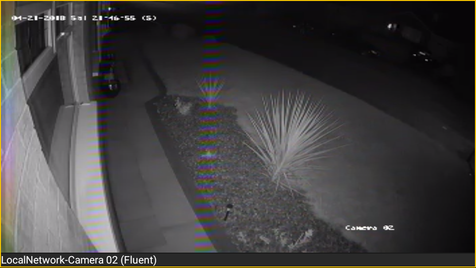

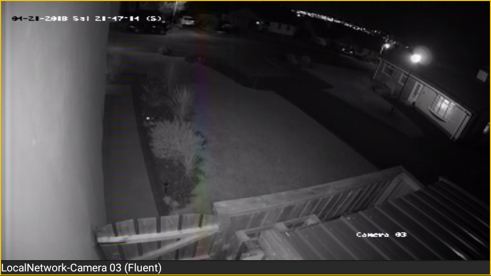

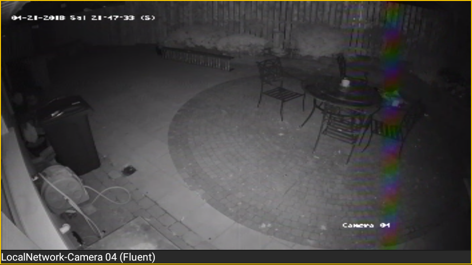

    Forgot the images. See attached. This is night time but it happens in daylight too.

      Re: CCTV Vertical Coloured Lines Rolling Across Screen Interference
      Hi
      I am probably resurrecting a long dead thread. Do you still have this setup and problem?
      I do not have working experience with TVI, but have worked with analogue.
      Do I understand correctly that you have only one 4 channel BALUN? No other? You should have BALUNs on the camera and DVR side for correct working.
      I have come across some very bad 4 channel BALUNS that allowed for cross talk between channels.
      I would get 4 single channel passive BALUNs together. Connect two cameras using the 4 BALUNs (one at each camera and two at the DVR side). See the result. Next, try a single channel BALUN at each camera and the 4 channel BALUN at the DVR side. See the result.
      Use UY connectors on the CAT5 to assure proper connections where you want to connect two CAT5 cables together. They are worth their weight in gold.
      As long as the power supply is of good quality, I cannot see it causing your issue. Make sure to measure the loaded voltages if you measure. Most analogue cameras allowed about 10% variation in voltage before the images started to degrade.

        Hi thanks for the reply. Yes i must say there is certainly crosstalk between the different display images when viewing. At the minute i am uaing baluns at the cameras the cables run into the loft into a 4 ch balun. The only reason i did this was to send all 4 channels down the one ethernet cable. I have no baluns at the dvr but did try them to no avail. I also tried the ground loop blocker but nothing works.
        You may be onto something with the cheap 4 ch balun. It was an ebay special (lol). I might do a join as you say and just put baluns at the dvr instead. I will send away for the uy connectors. I will report the results. Many thanks

          You can try to run without any BALUNs for a test. There will be some impedance mismatches, but if the cross talk stops, then the 4CH BALUN is most likely the culprit.
          Ideally the setup should look like the attached document.
          Some BALUN manufacturers have special models for AHD, TVI and CVI cameras. I never opened them up to compare to those for SD CCTV models. Maybe someone else can comment whether it is just a trick to charge more for the same thing or if there is actually improvement to be had?

                I am wondering why you use Cat5e cable for what is a single ended analog signal that must be sent along 75 ohm cable. It needs to be transmitted along a shielded coax cable with the correct impedance and terminated into the correct impedance as well. I suspect the cable is picking up cross talk from your other cameras - the rolling bar is the colour burst signal in the adjacent camera feed which is being detected as colour video information.
                AHD is virtually identical to PAL video but with non interlaced video and higher line count. I have some 720p AHD cameras that work quite well but they use BNC and coax cable. I wouldn't want to send that video along a Cat5e cable because it's an analog signal and susceptible to interference.
                If you want to send power at the same time then you will need to get a cable that combines both power and coax video feed, but that cable must use separate power and ground feeds for each camera (it should NOT use the video ground.)
