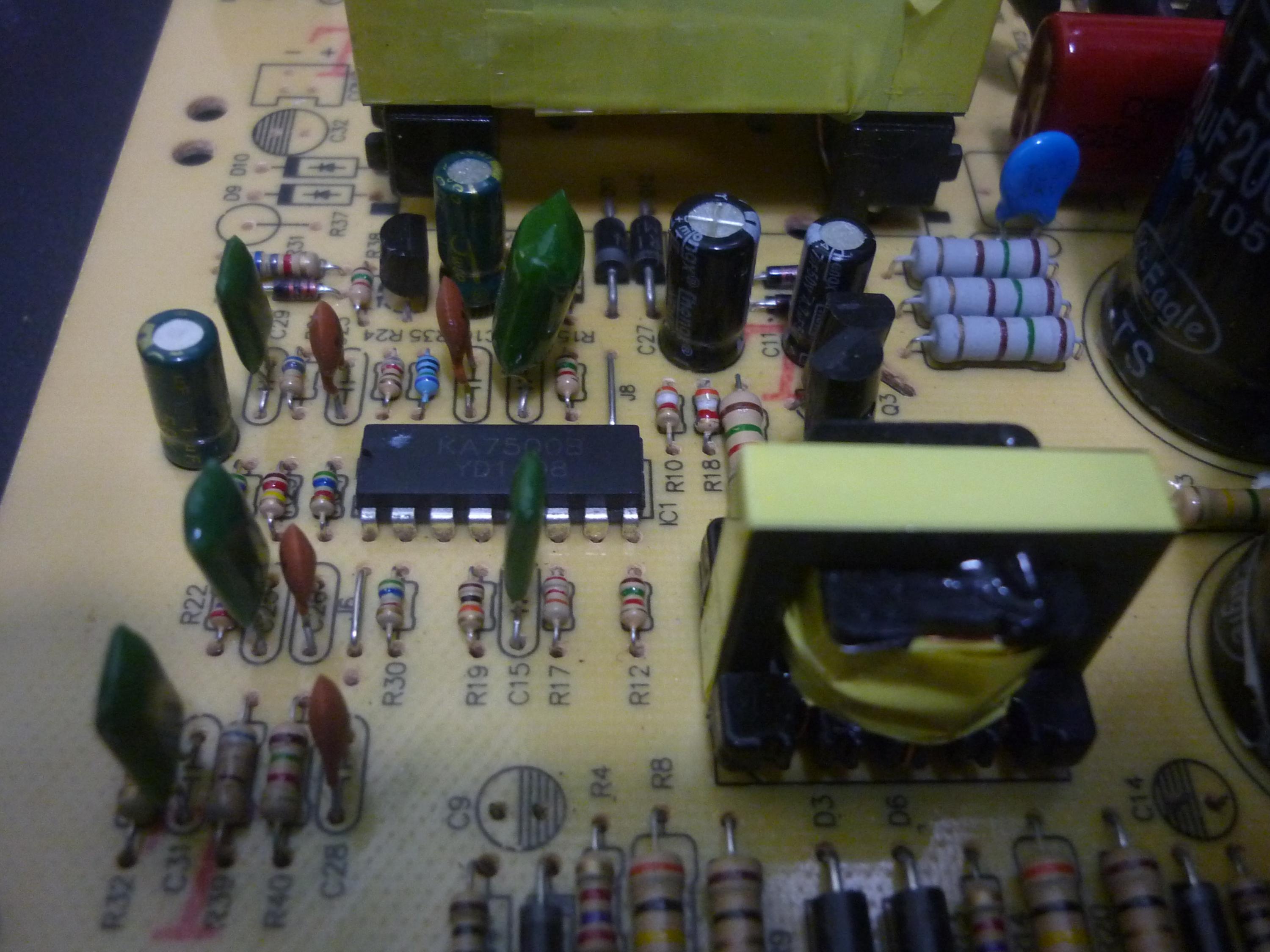

    Hi all.
    Receive a warm greeting.
    I have a centralized power source for CCTV. Model SP200B S88
    New, zero use.

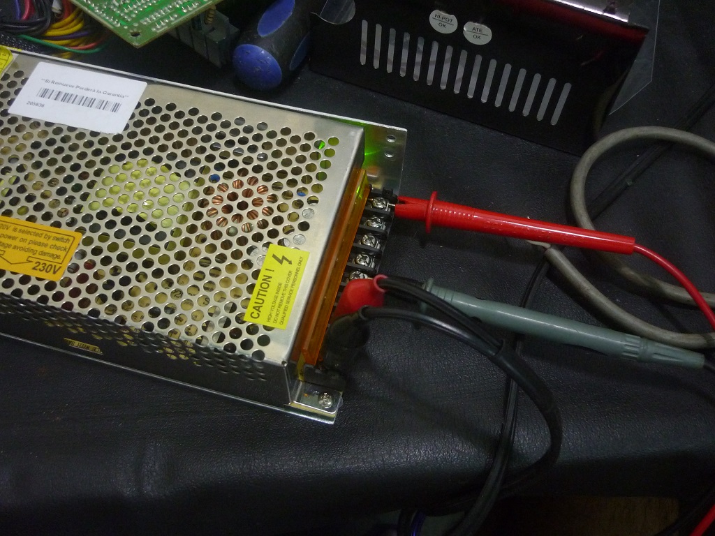

    It turns out that the CCTV HD cameras were connected, most of the cameras present noise in the image seen on the monitor.
    Check, grounding, interference with other electrical cables in relation to the video cable, etc.
    The source was replaced by another and the cameras worked perfectly.

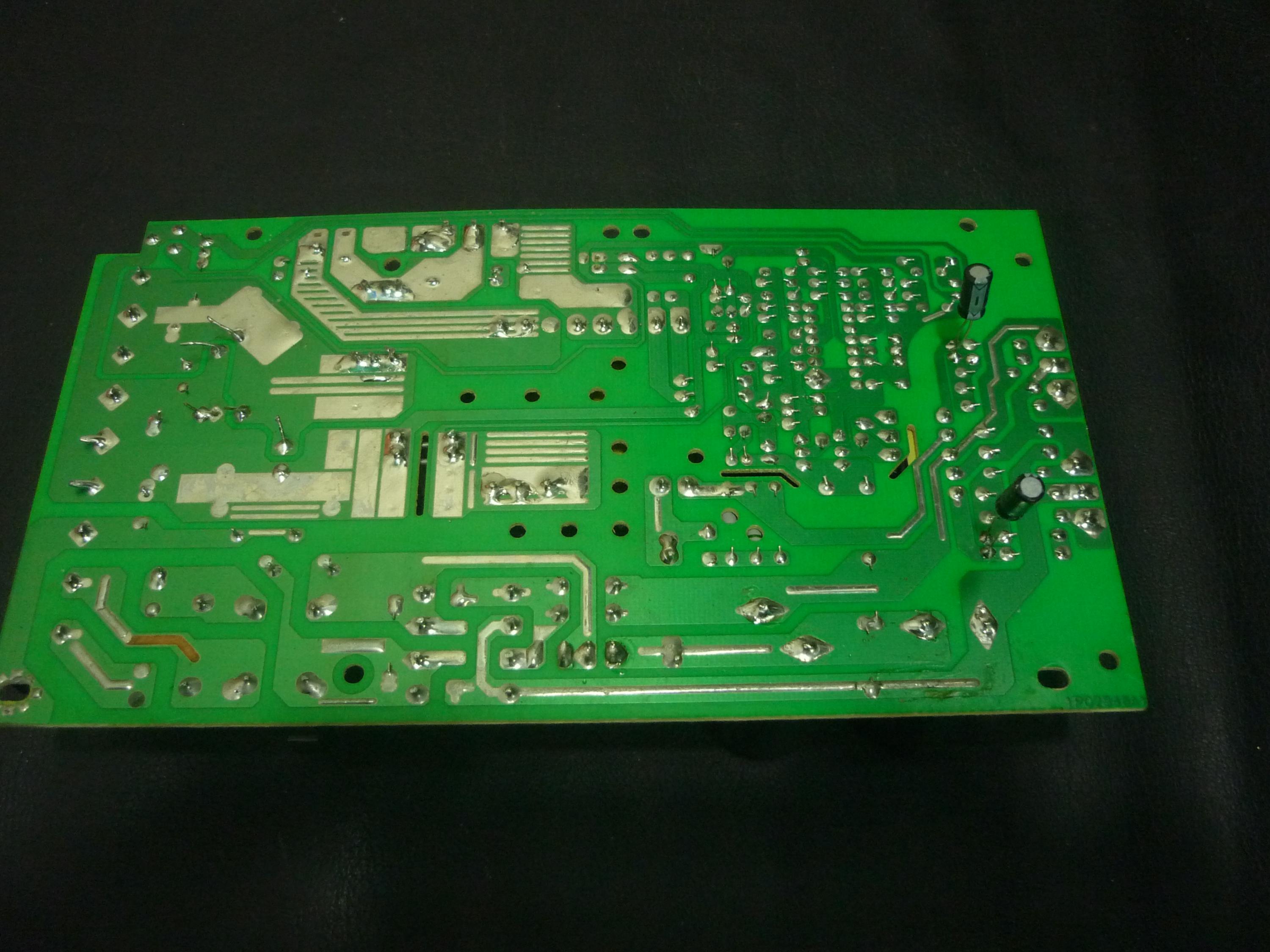

    Now checking at the plate level this source, everything looks good, suspecting that it was a problem of line filtering, replace the 3 capacitors of the output. (2200uf x 25v). It did not solve the problem.

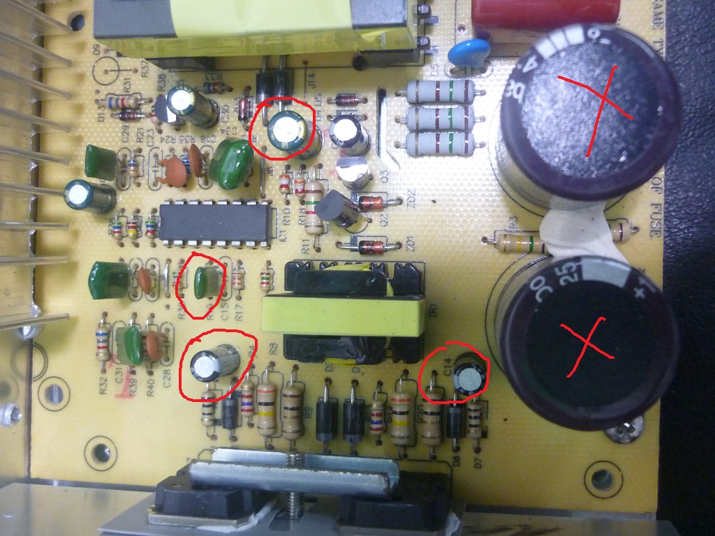

    Then I went to the primary session, replace the capacitor (CT) of the KA7500B that sets the working frequency. It did not solve the problem.
    I also changed the capacitors of the primary 470uf x 250v x 560uf x 200v which was the ones I had at hand (Then I install the originals).
    Change the capacitors that are associated with the primary transistors / mosfet. 4.7uf x 50v.
    In red of one of the images, mark the components that I changed.
    I consult here because I do not want to disassemble half of the source and affect the PCB tracks, just because I am doing trial and error.
    They have any suggestions that may cause the interference problem.

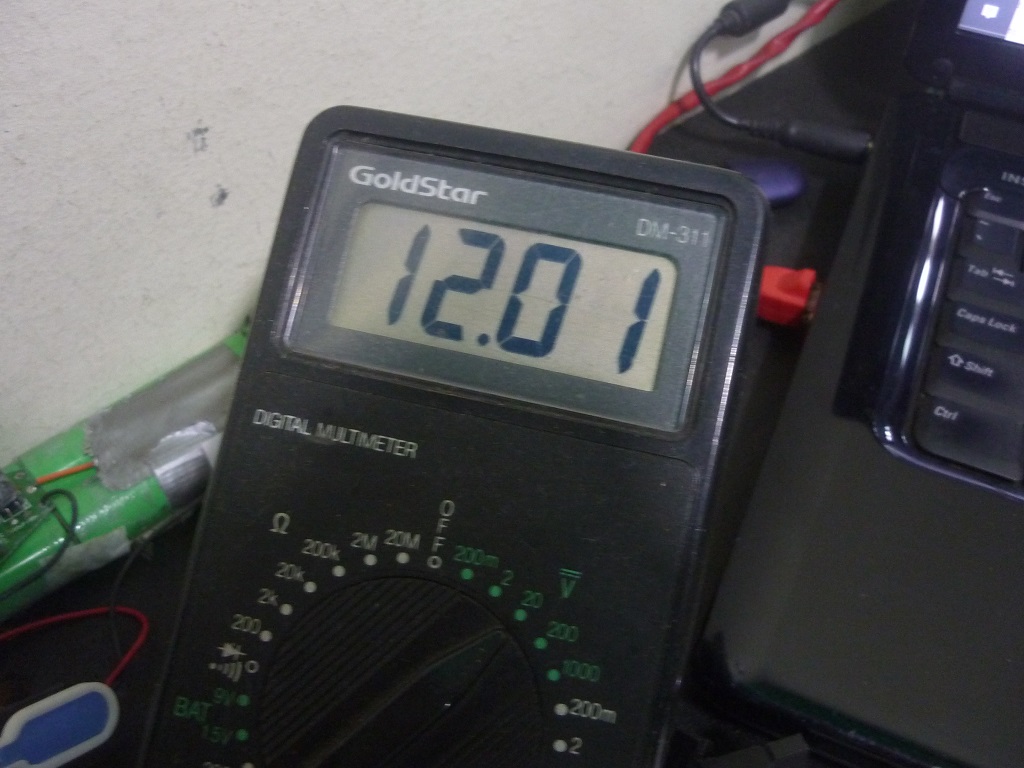

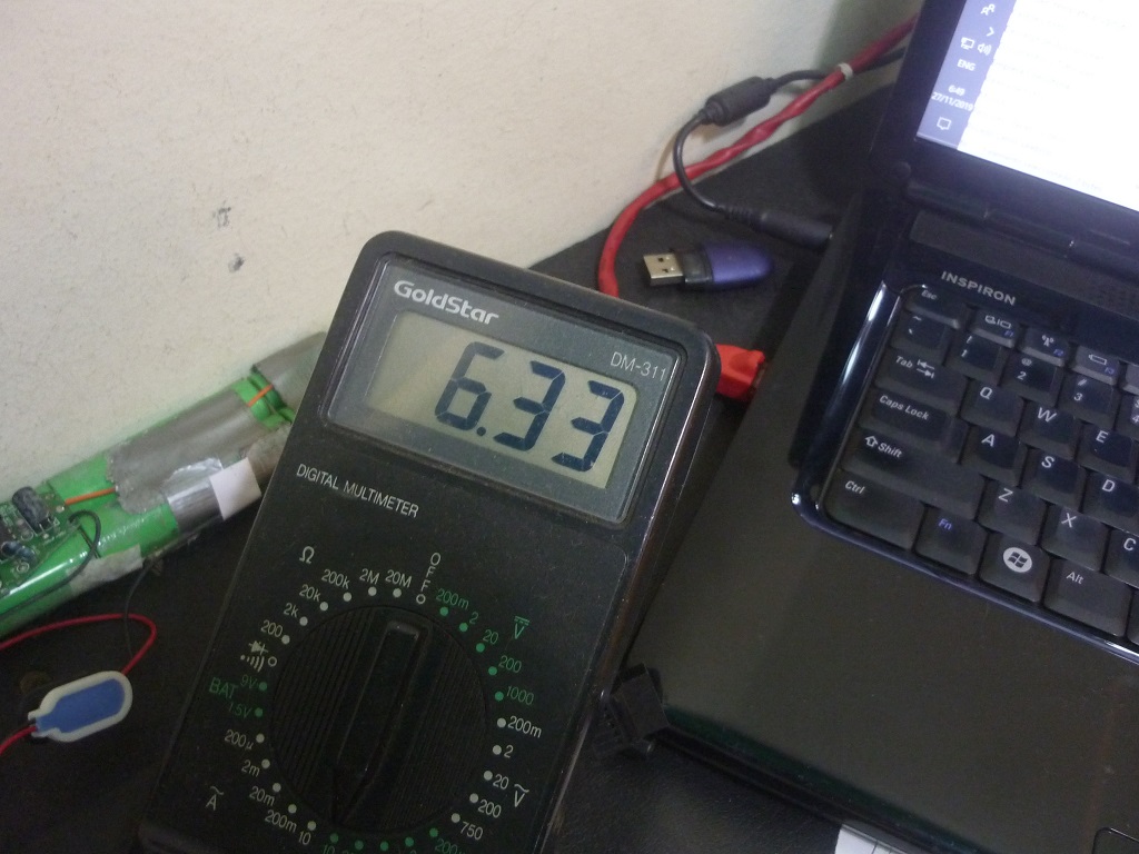

    Note: The power source does not vary the voltage before a load of more than 6 amps. The voltage is very stable, zero noise, hum or others.
    Thanks.

      But the probe in my test bench connected to a CCTV and the cable measures less than 1 Meter the noise is the same.
      I also connected it to another camera that brings its original cable (Video-Audio + Power) and connected it directly to the source with a Plug connector. Same noise.
      Y recalco que cambiando esta PSU por otra en la instalación de las cámaras del cliente, el ruido desaparece, es esta fuente que tiene el problema.

        Re: PSU For CCTV - noise or interference in the image seen from the camera
        Can we see the whole psu? Did you replace this psu with the exact same psu, or a different one?

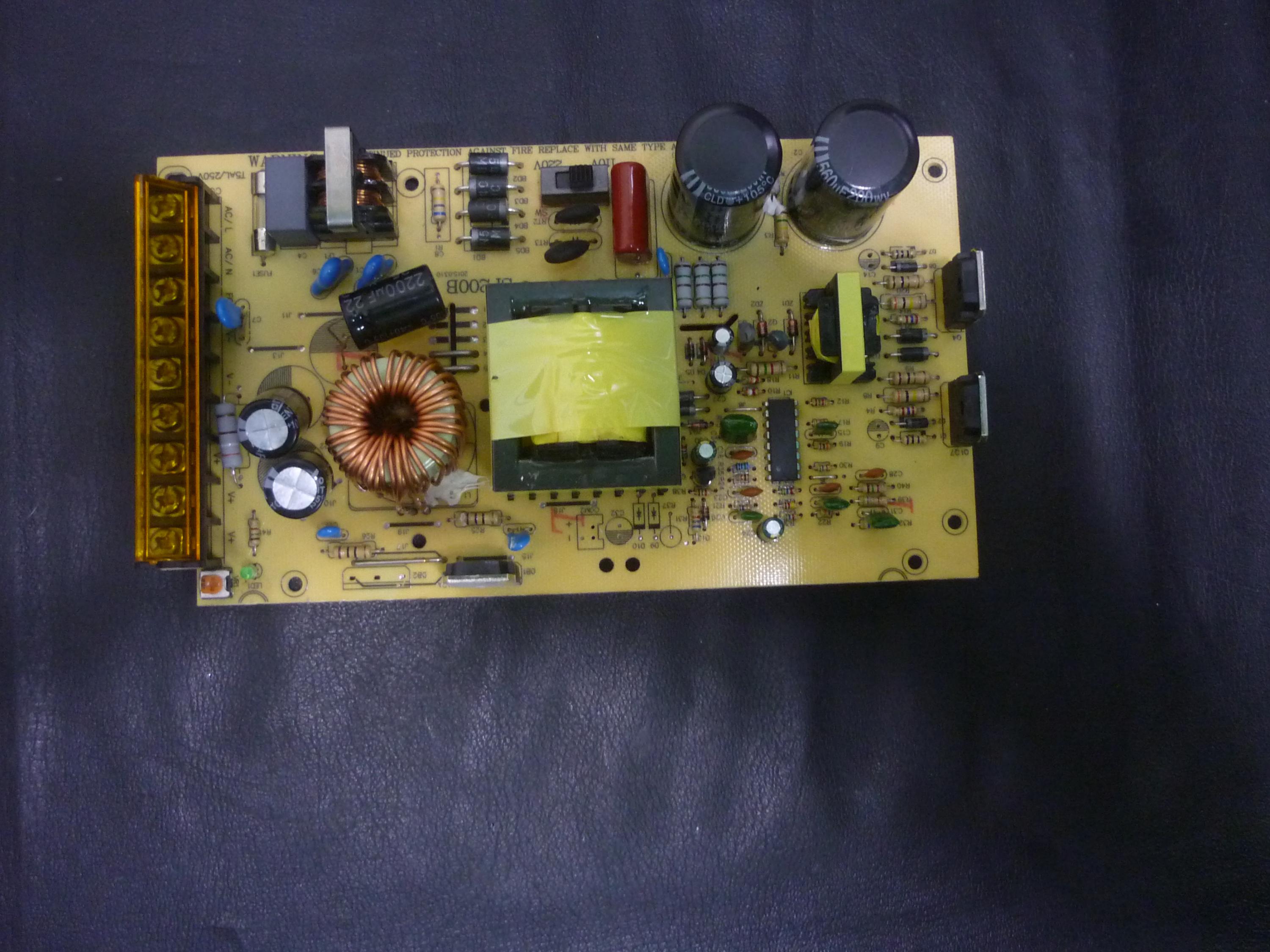

            I'm going to find out which PSU model they used as a replacement, since I didn't do that, if not the installer and owner of the PSU
            I attach photos of the complete source.
                    It looks like a bad design power supply, noisy and high EMI. chinese special low cost.
                    There is no opto-coupler? So I'm not sure how it isolates and regulates.

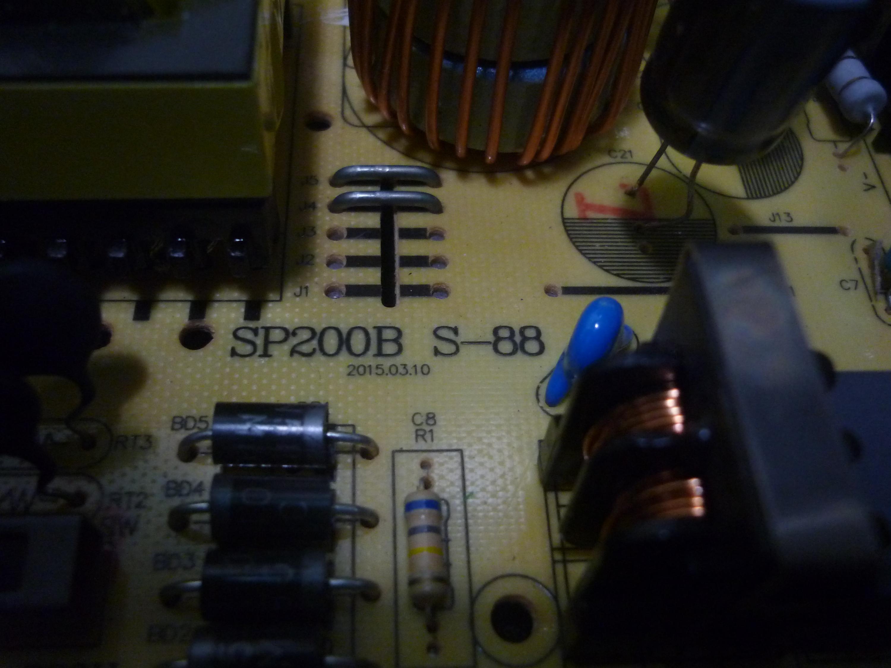

                    I would put in a larger Y-cap C7 at least 2200pF, and ceramic cap across the output electrolytics, like 0.1uF. It is missing HF filtering there.
                    X-cap C8 is for additional mains filtering to prevent noise from coming out there. C8 should be around 0.1uF 275VAC X2 if you want to try it.
                    Try put an AM radio close to it and see how noisy it is. Sometimes the feedback loop is unstable and the output voltage extra noisy, especially with a light load.
                      Stj. Yes. i tried but my oscilloscope (pencil type) is very basic and does not allow you to see anything in detail. Attach one of the images. (Output without noise.jpg)
                      I will test the radio, before starting to review the source, the first thing I did was to place a ceramic capacitor in each chamber, without results, then I tried to add a 2200uf capacitor directly at the exit to the cameras, since I also suspected that it was a filtering problem
                      And finally I replaced all the output filters.
                      Sorry redwire, the capacitor numbers on my board refer to the 103 x 1KV capacitor. That makes ground connection.
                      C8 is not installed on a board, there is a resistor in place, do I place the capacitor on that resistor?
                      Please confirm me, to proceed with these capacitor tests
                        Hi. following the recommendations of Redwire.
                        I removed the resistor that was in the C8 position, and installed the respective capacitor.
                        No changes, same noise.
                        By the way, yesterday the CCTV installer told me, that the source used for the cameras that replaced this one I am reviewing, is the same model and is presenting the same noise problem in the images captured by the cameras.
                            I'm pretty sure the noise problem is common-mode appearing at the 12V output.
                            Are the cameras or their video cable (shield) or the video monitors connected to earth ground? The whole system is grounded somewhere?
                            I would add bigger Y-cap from 1,000pF to 4,700pF to the PSU, from +12V to PE, and -12V to PE.
                            You could try add ferrite clamp-on at the output lead pair too. Or a few turns in toroid common-mode inductor.
                            C8 would only help with noise on mains, which must no be where the noise gets out.
