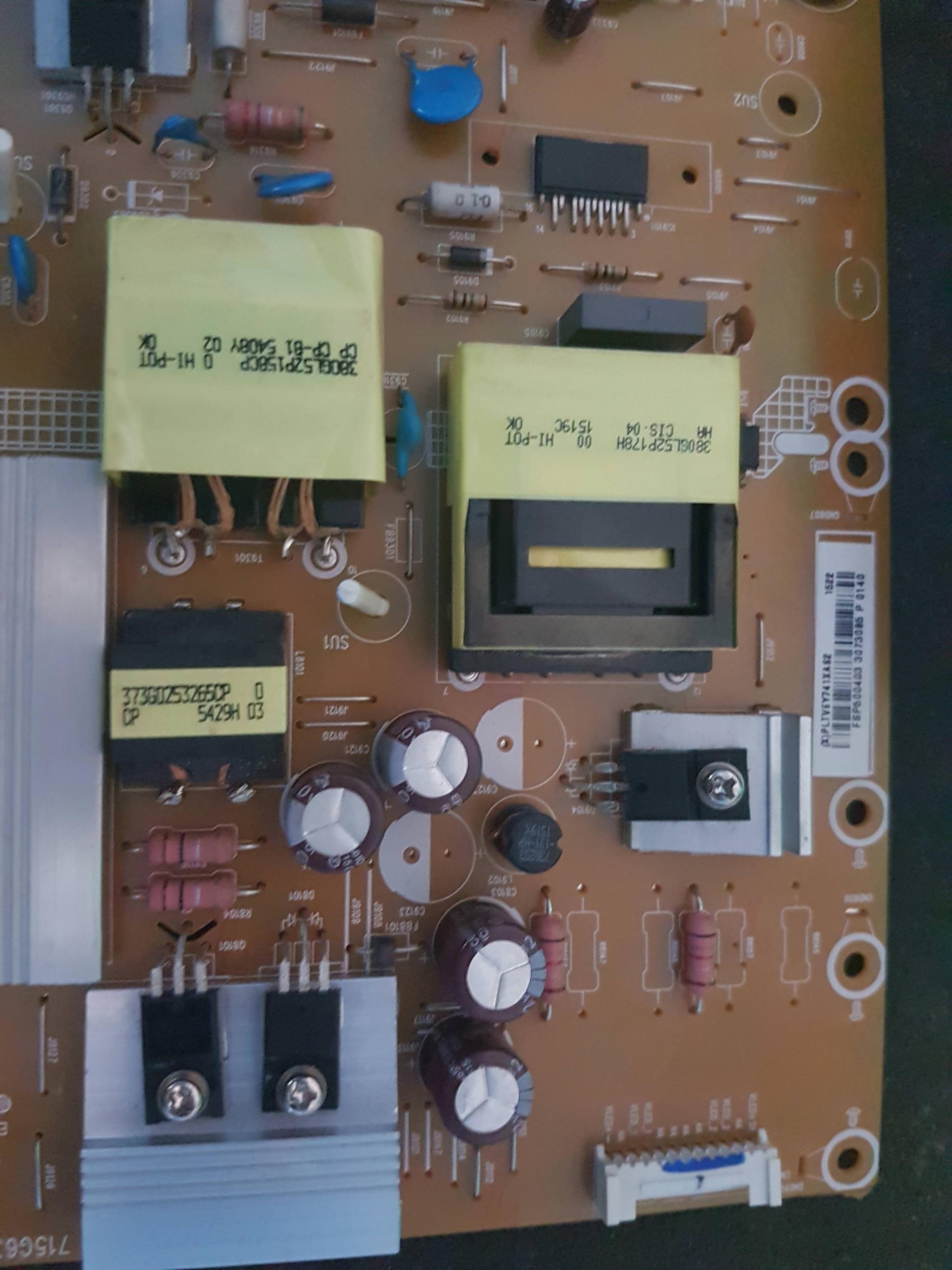

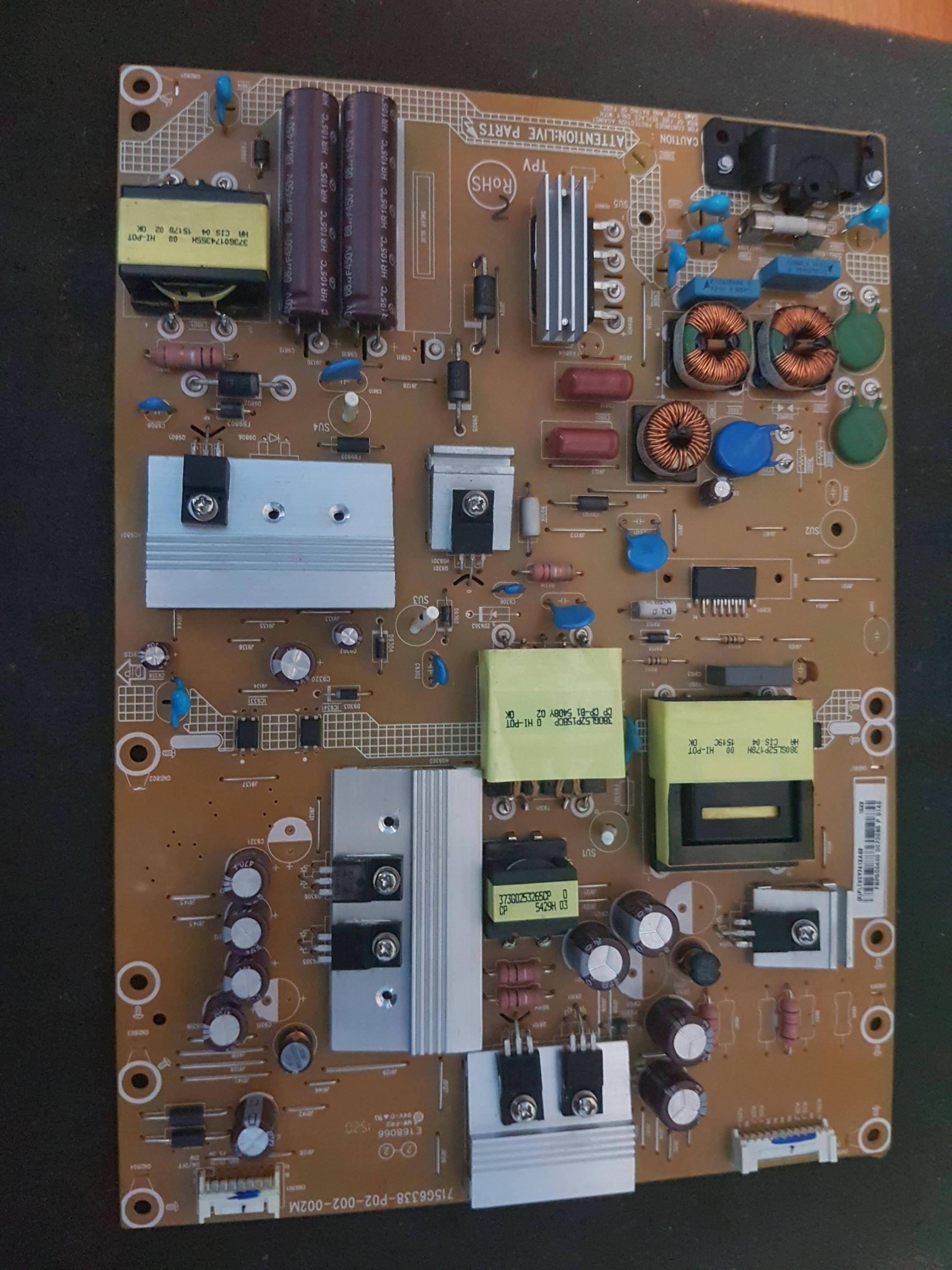

    I have a 55 inch Phillips TV thats powering up just fine but no voltage on the socket thats connecting to the LEDs. I have used a torchlight to the screen and theres image on the screen. So its clearly the LED voltages missing. When i use a multimeter to measure the voltage, the voltage starts high and then fades to zero voltage. Weird. A sign driver IC failing? I have tried high and low to find the service manual but failed. Anyone happens to have a service manual for this?
    PS : Ive tried another power supply borrowed from a friend and the panel works fine.
    Model Phillips 50PFA4500S

                If your power supply is model 715G6338 then schematic found on page 33 of the attached manual.
                What are the voltages on the 3 pins of DP8101

                        I managed to replace the led driver IC, it worked, there was picture light and everything. for 1 minute. Then the IC died and back to no light and no voltage

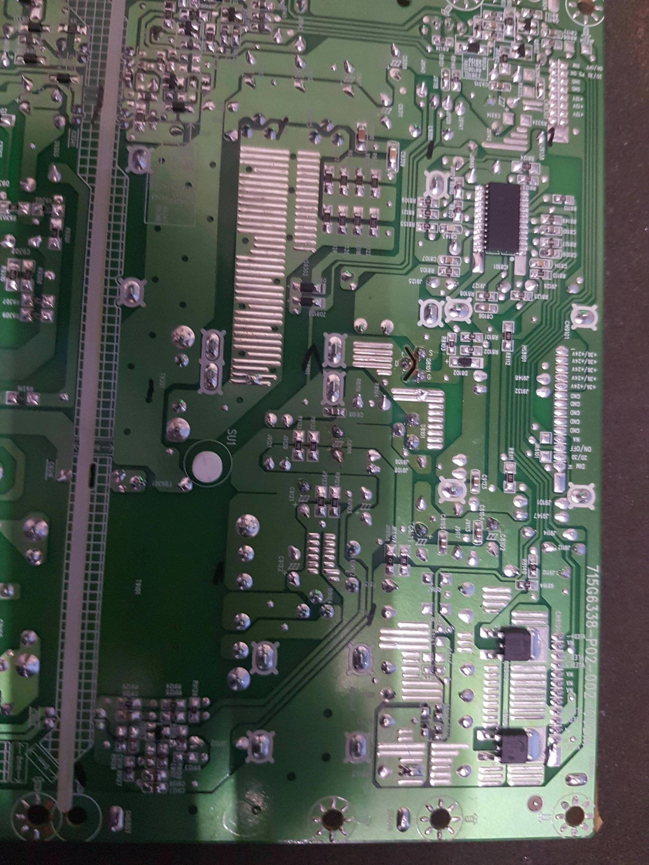

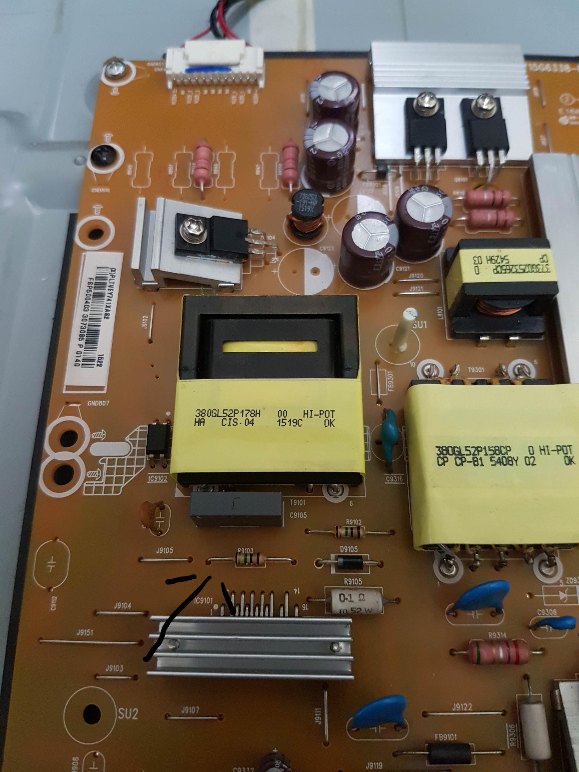

                              After soldering a few smd components. The backlight is stable at every on and off. Led output Voltage is stable at 70.1V. When i put to standby, voltage goes to zero. When i turn on again, backlight comes on, voltage steady at 70.1V
                              If i keep it on standby like 10 or 20 mins and then turn on again, the backlight fails again to turn on as theres no voltage. So this time i tried probing where the voltage stops, i use my digital multimeter on AC mode and stick the black to ground and the red to one of the resistor thats R9103 leg as in the picture, suddenly the backlight comes back. Now isn't thats weird?
                              If i kept it turned on with the backlight, it works for hours without any problem. Sounds like it needs a kickstart.

                                Check the values of the following components are within specification
                                R9101 1M +/- 1%
                                R9102 1M +/- 5%
                                R9103 1M +/- 5%
                                R9104 22K +/- 1%
                                C9101 10nF
                                C9102 100nF
                                and also the solder connections of IC9101

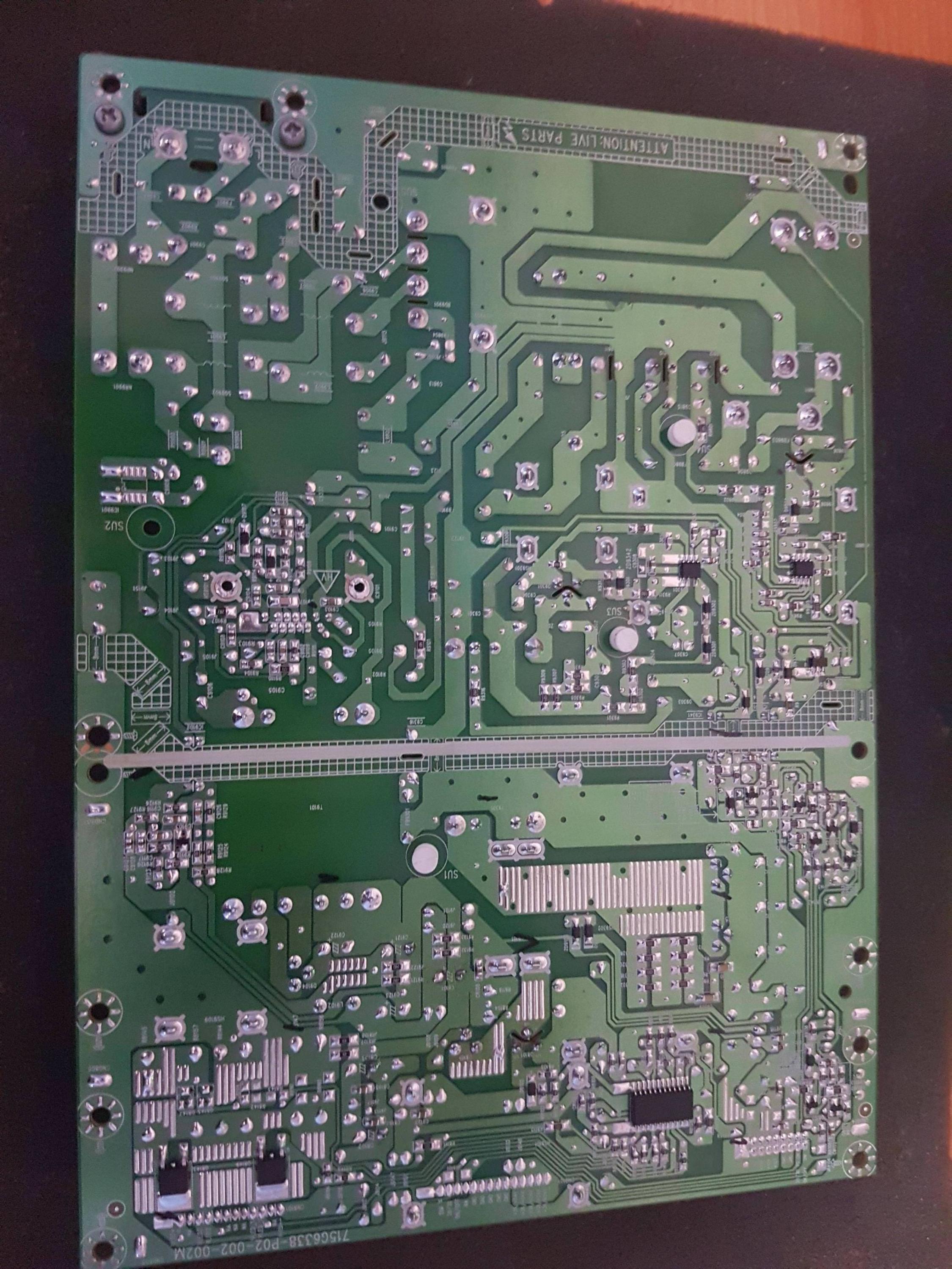

                                  R9101 1M +/- 1% - 984M
                                  R9102 1M +/- 5% - 984M
                                  R9103 1M +/- 5% - 943M
                                  R9104 22K +/- 1% - 19.9K
                                  C9101 10nF - 8.86NF
                                  C9102 100nF - 105NF going down really slow 1 by 1 digit
                                  IC9109 has been replaced with new IC.
                                  When turn on for the very first time for the day, it works. Standby and turn on again backlight gone. While in ON mode, touch the resistor leg of R9103 with multimeter on AC mode, the backlight comes back
