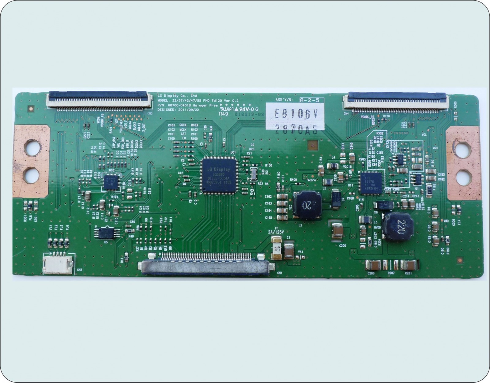

              Re: TCL L65F3500FDS issues - Tcon, panel, or ?
              A picture of your tcon would assist in getting help. Test points for gamma may then be seen and the fuse will be near connector for lvds strap coming from main board. You do have a multimeter? They are cheap. You will need to search for a tcon at the right price and TCL may have to look at China outlets Aliexpress DHGate etc. Having a go can be a trial so much to cover and all new but it gels after awhile and there are feel good moments when it comes together.
              Last edited by maxvalutech; 04-14-2018, 11:20 PM. Reason: The pic I put up is not of your board but shows fuse and likely gamma test points top left.

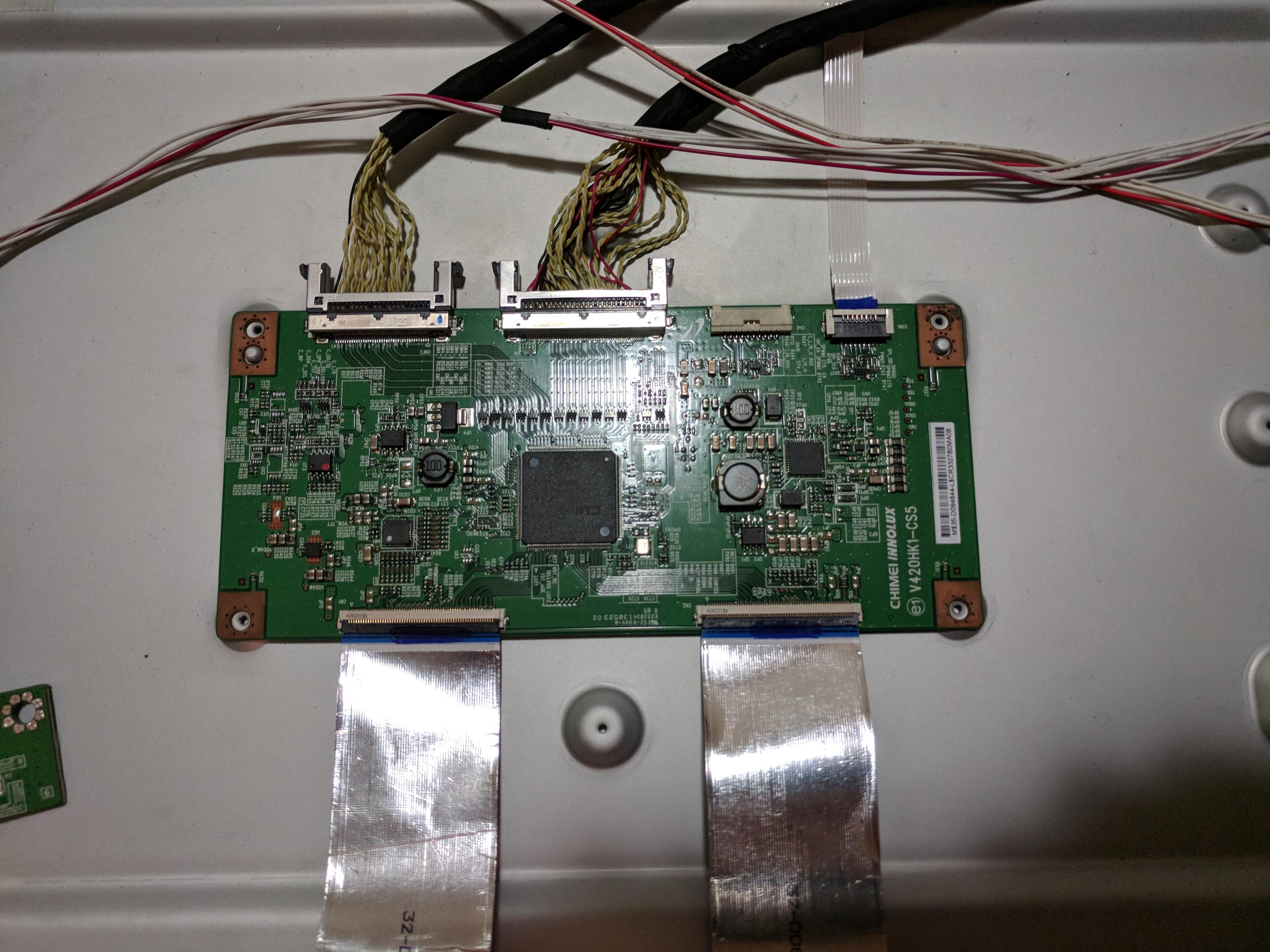

              • skkunx
                not dead yet
                • Apr 2018
                • 12
                Attached an image of my tcon.
                I do have access to a multimeter, but I can't say that I'm incredible well versed in how to use it. Nothing an hour on YouTube cant change though.
                There's an Australian option to buy at 100 (less than a week to arrive) or an American option at 60 (up to a month to arrive)

                  Getting there. The screws should all be put firmly back into the tcon as they act as earth points. The lead to con1 needs to be closely examined for any damage and correct fitting. Looks like the gamma points are marked but would like someone more experienced to add comment and point you to how to measure. Keep at it.

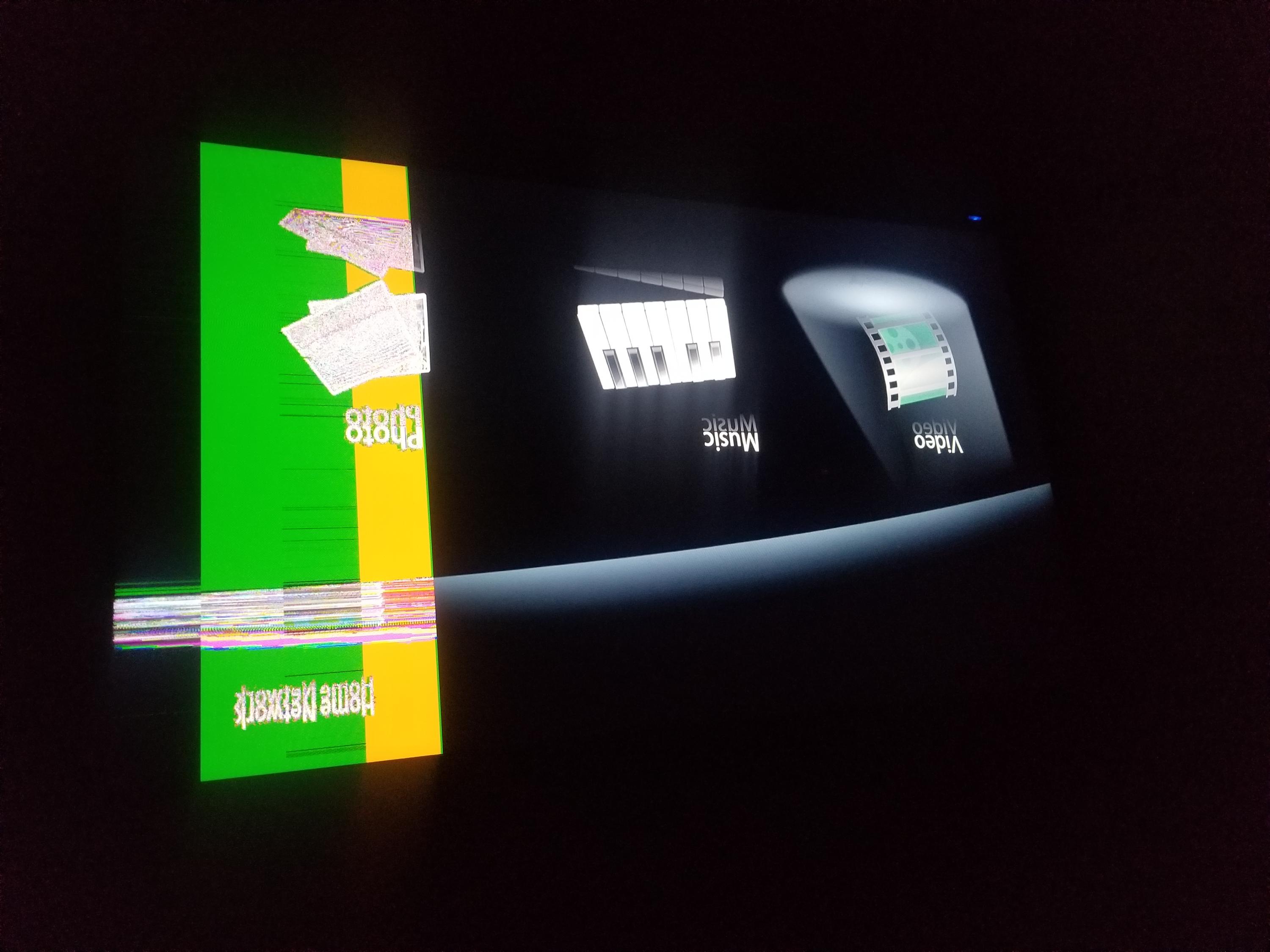

                            • skkunx
                              not dead yet
                              • Apr 2018
                              • 12
                              Yes, I recognize that I bit off more than I can chew; and I don't have the capacity/patience to test every little connection. I am going to just try to sell as is.. and if i get no offers then I will make a further decision to either harvest for parts, or buy the Tcon board and hope for the best.
                              This gif more clearly shows the problem(s).
                              again, using the highly accurate manual wiggling/prodding technique:
                              -movement at the panel edge tabs does nothing
                              -wiggling the ribbon cables at the connections changes and erases the display issues, but never to a point where the whole display is in perfect working order.
                              • freakaftr8
                                • Oct 2012
                                • 3743
                                That's tcon failure! Look at the sharp I replaced the tcon on the other night. Now after the tcon replacement it flickers every once in a while which I believe may be panel failure ( side gate tabs)
                                I believe the bad gate drivers probably took out the original tcon
