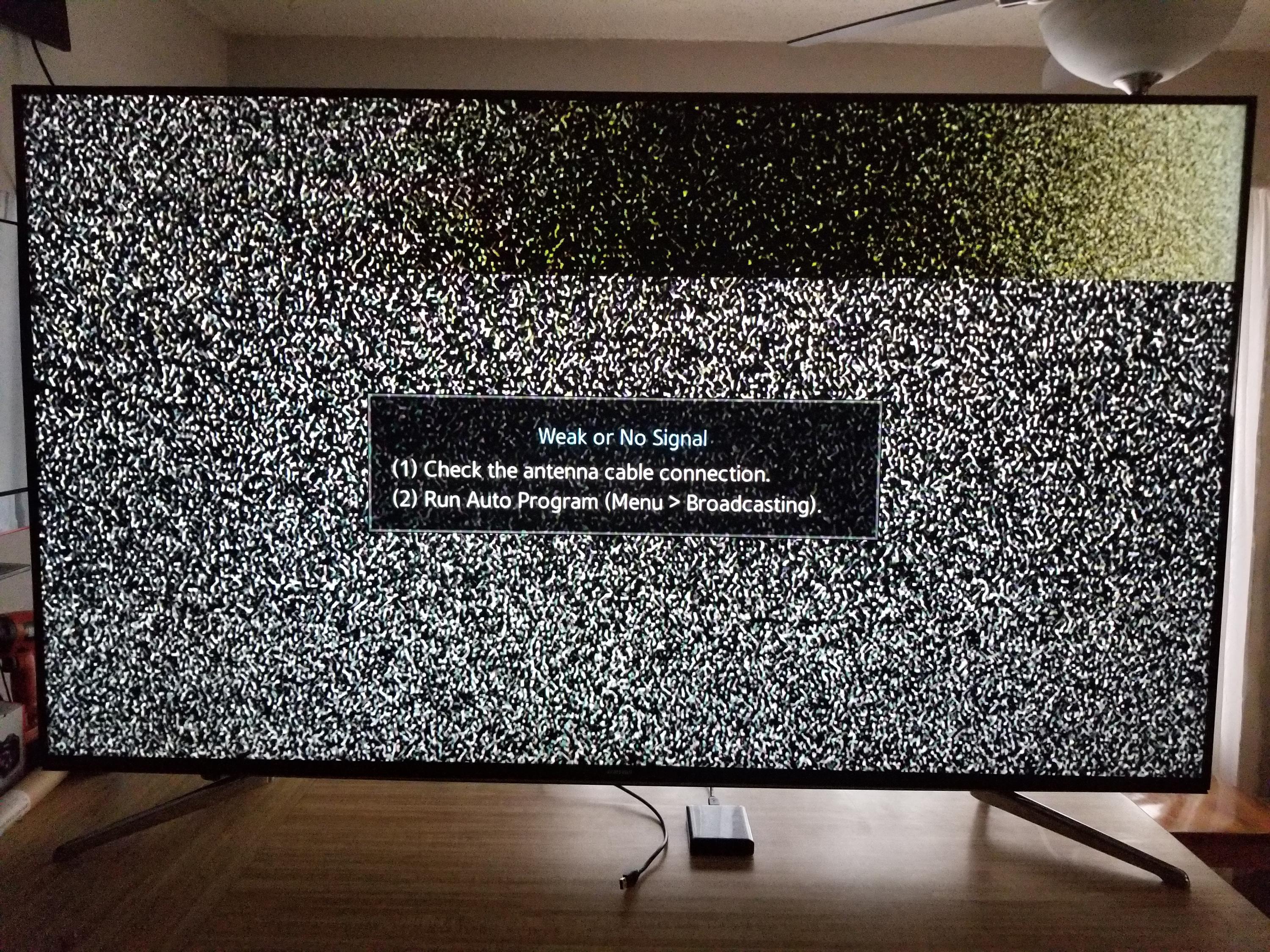

    Black horizontal bar at top of lcd panel
    Hi I have a Samsung un75h6300, the lcd panel has a black bar at the top of the screen about 1/4 to 1/3 of the screen, I recently took the tv apart to replace bad LEDs, after reassembling I got this issue, I'm confident that I didn't damage any tabs on the lcd panel. When I disconnect the t-con from the power board the screen goes black and the line goes away. Is there any chance that I may have damaged the t-con board with a static discharge?

    :-(... its more than likely you caused an issue with the tabs in the top section of the panel on that side. You might want to remove that bezel again and check things out... crossed fingers.... maybe try a bit of pressure on the appropriate tab to see if it changes anything. good luck.
      Re: Black horizontal bar at top of lcd panel
      Panel problem, not T-CON.
        X2. You may be able to press on the tabs on the bottom outer corners to see if it fixes the issue.
